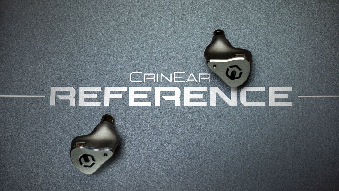

Build, Comfort, Design & Accessories
In the box, you get the IEM, a rather fetching zip case, four types of tips—two silicone narrow bore tips of different bore lengths, “shortwide” silicone tips (KBEAR 4540/Coffee tips), and a single pair of foam tips—the included 2-pin to 3.5mm right-angle cable, and a 4.4mm adapter. The case is lovely, one of the best included cases I’ve received with an IEM. It’s white leather or leatherette-wrapped, with just enough space in there for the IEM, cable, and some ear tips, and importantly, it’s actually pocketable. Another underrated detail about the case is that it can actually stand up straight on a flat surface if you need it to.
Crin clearly learned some lessons from the Daybreak and now offers a healthy complement of eartips in the box with Reference (including the “Coffee” tips most people agree made Daybreak a more palatable listen). Additionally, the included eartips actually have significant acoustic differences, such that I’m confident that most people will be able to find something that works well for them in the treble with this IEM—especially because its treble response is so reasonable that it’s unlikely people have many glaring issues to begin with.
Of particular note is the inclusion of the Standard tips, but also a version of the same exact tip but with a shorter core (Short tips). This allows for people to experiment with the ergonomic profile without really changing the sound, and I’d love to see other brands do something similar going forward.
And finally, the cable is much more soft and premium feeling than the thin, plasticky cable that came with Daybreak. It actually reminds me quite a bit of the cable that came with the Prisma Lumen, but slightly thinner and with a swappable right-angle connector instead of a straight-angle one. I typically don’t love cables that are quite as thick as this one, but because the earpieces are thick and moderately heavy, I actually feel the pairing makes a decent amount of sense & I find myself having no issues with the weight of the cable causing the “imbalanced” feeling that I got with Lumen.
Overall this accessories package is great. For $350, this should be the standard; a diverse collection of eartips with different lengths and bore sizes, a nice pocketable case, and a cable that is neither too thin nor too heavy for the earpieces it’s attached to. I think people will be pleased with what they get in the box here.
Touching on visual design, so far this is my favorite looking CrinEar IEM, almost entirely because Crin opted for a relatively less obtrusive logo instead of the ugly/somewhat “gamery” text branding on things like Daybreak and META. While the lack of text here is preferable, and the all-silver metal shell itself is handsome, I am still not a massive fan of the branding and polishing here. The logo itself is still rather “gamery,” and communicates little about the brand/product. If I had my druthers, there wouldn’t be a logo on the faceplate at all; he’s gone the lengths to offer a handsome full metal construction at this price, I think it’d be best if he let the shell speak for itself.
Speaking of construction, Reference is also CrinEar’s most solid-feeling IEM to date. Obviously the slightly heavy aluminum shell has a big part to play there, but I think subjectively the fact that it’s all one color and its (as far as I can tell) CrinEar’s largest IEM also contributes to the IEM looking and feeling more robust—both more robust than past CrinEar designs, as well as more robust than similarly priced options that lack metal shells.
Comfort-wise, Reference is pretty good, particularly when it comes to its nozzle profile and molding. There are a few things worth noting, though. As said, it’s a pretty large shell. Not as large as the Thieaudio Monarchs or Elysian Annihilators of the world—and certainly not as poorly molded—but it’s quite a tall shell that protrudes significantly out of the ear when worn with standard tips (less so with the shorter included tips). If you aren’t getting a deep enough insert, it has a bit of an issue where it doesn’t quite nestle neatly into the curvature of the ear. This can feel a bit precarious considering the tallness of the shell causes the weight to sit a bit further from the ear than usual as well.
However, because there are a variety of tips here—all of which have different bore lengths—users can tip-roll to move the shell slightly closer (Short tips), much closer (Shortwide tips) or further (Standard tips) based on their needs. The Shortwide tips do a fantastic job moving the shell closer enough to my ear to basically entirely mitigate this issue for me.
In summation, I have basically no real issues with the build, comfort, design, or accessories for this IEM. Crin is clearly listening to feedback and it’s evident in the package here that he put real thought into making this as universal and unproblematic a package as possible, so for that he collects a well-deserved win in this section.
