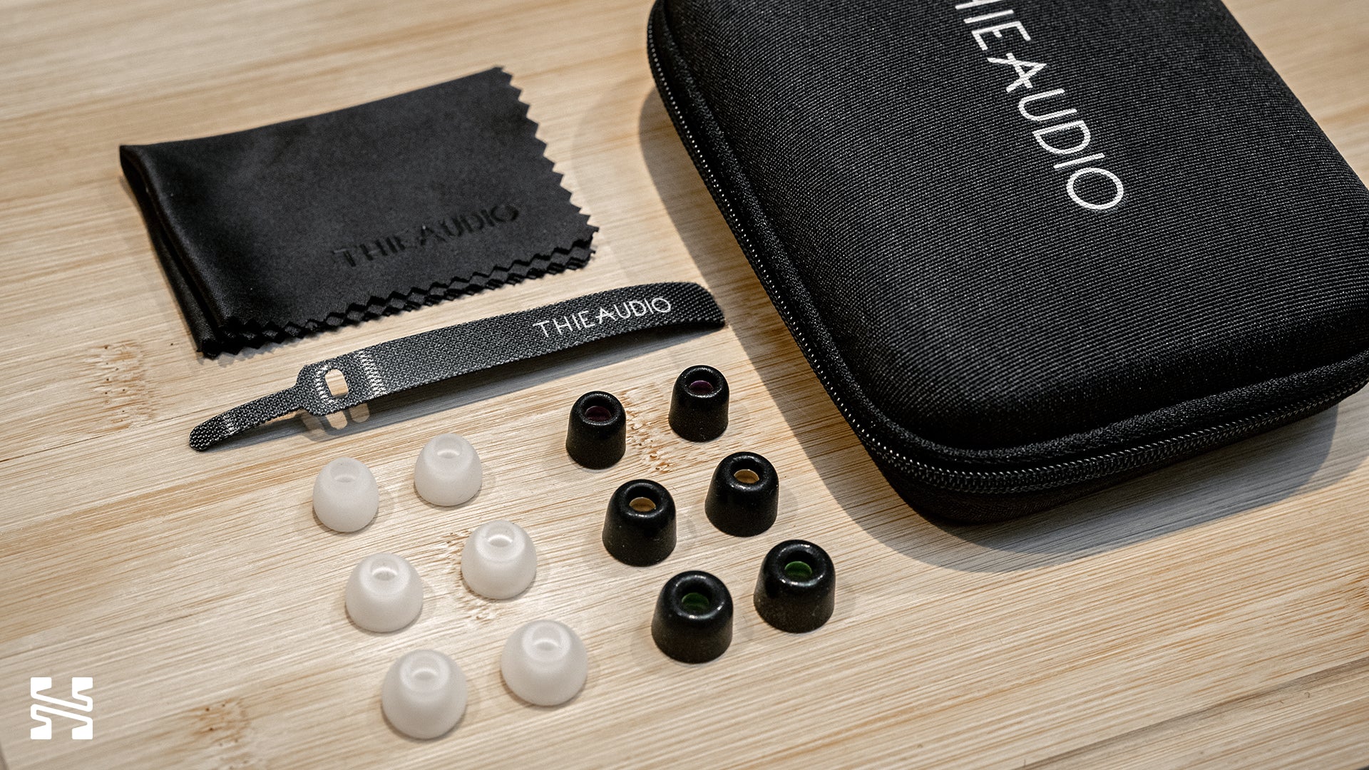

What’s in the Box?
The packaging of these Hype IEMs are almost identical to one another. The only difference is the included cable. For accessories, you get:
  1. 3 sets of S/M/L foam tips.
  2. 3 sets of generic white silicone tips.
  3. A microfibre cleaning cloth.
  4. A large zippered carrying case.

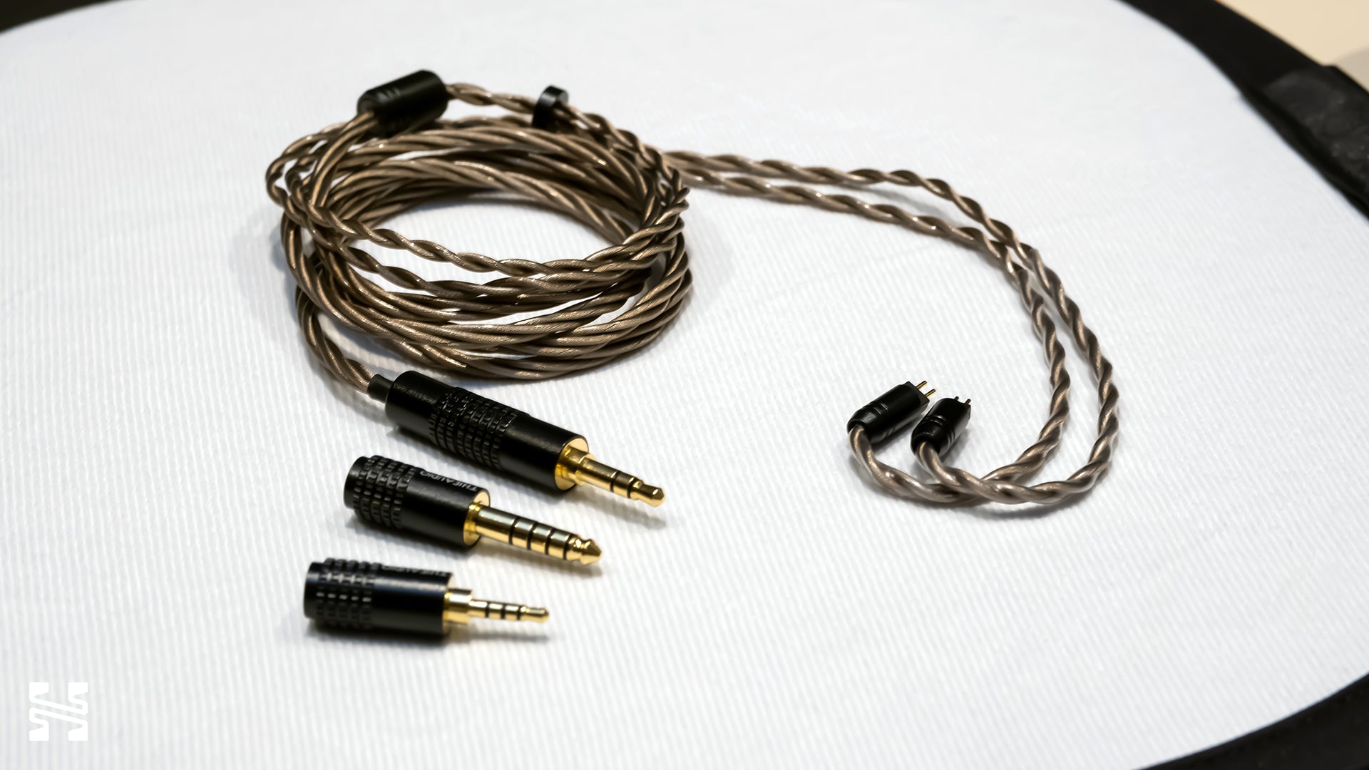

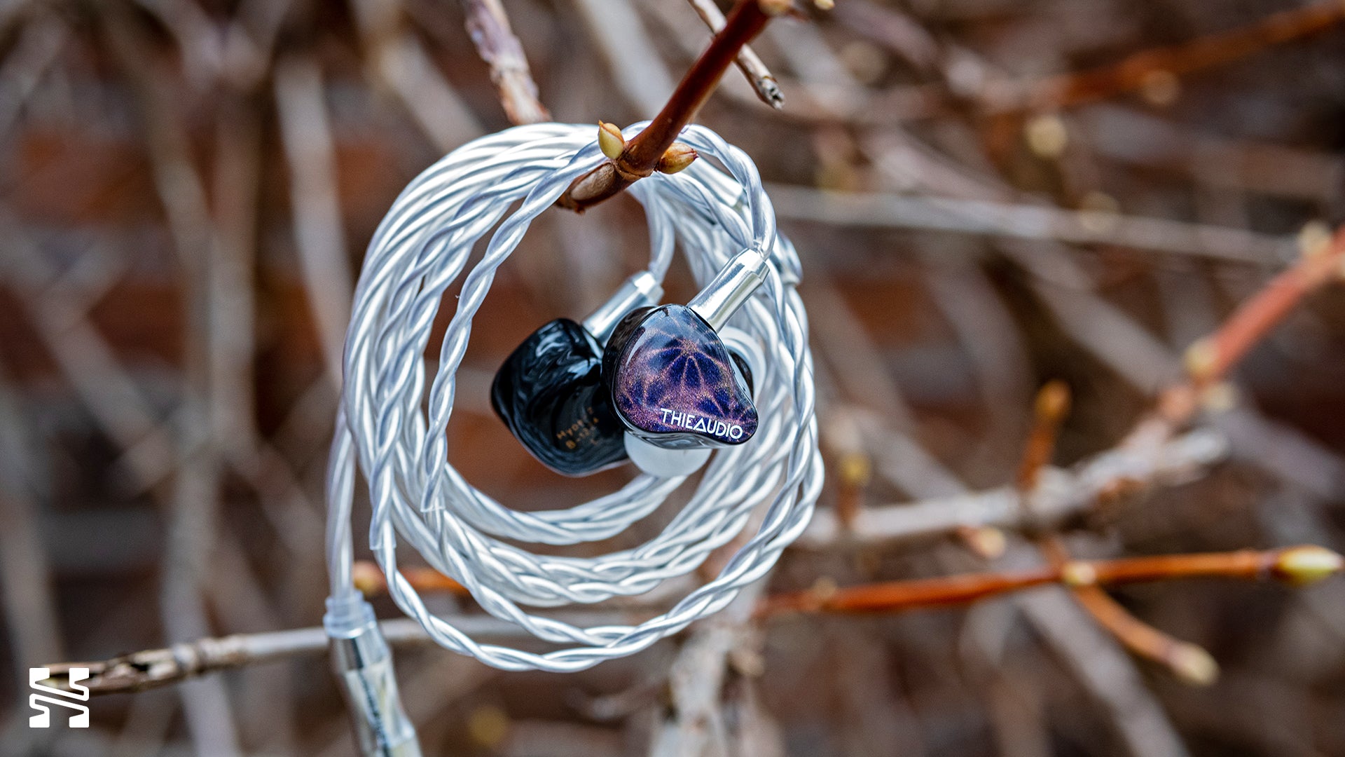

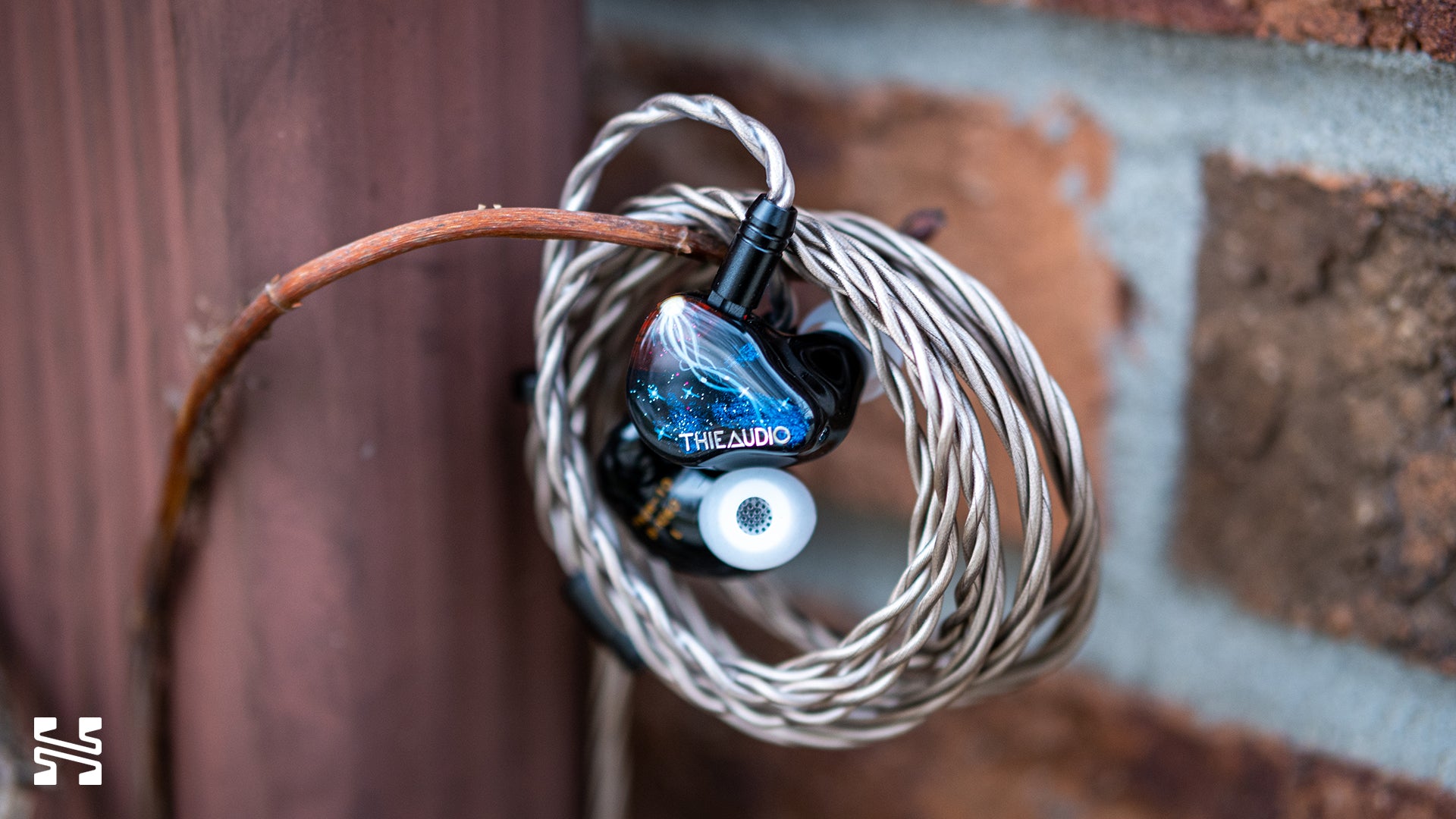

  5. The stock cable. The Hype 2 has a silver looking cable. It’s alright, a bit stiff. The Hype 4 has a grey-brown cable that’s a bit better and softer than the Hype 2’s. The Hype 10 has the same nice cable as the Monarch MkIII with interchangeable 2.5/3.5/4.4 mm terminations. It’s a needed upgrade considering how much it costs in comparison.

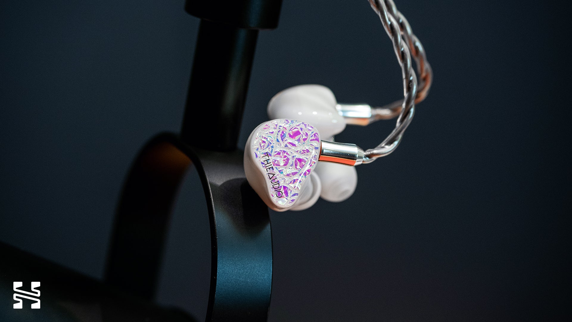

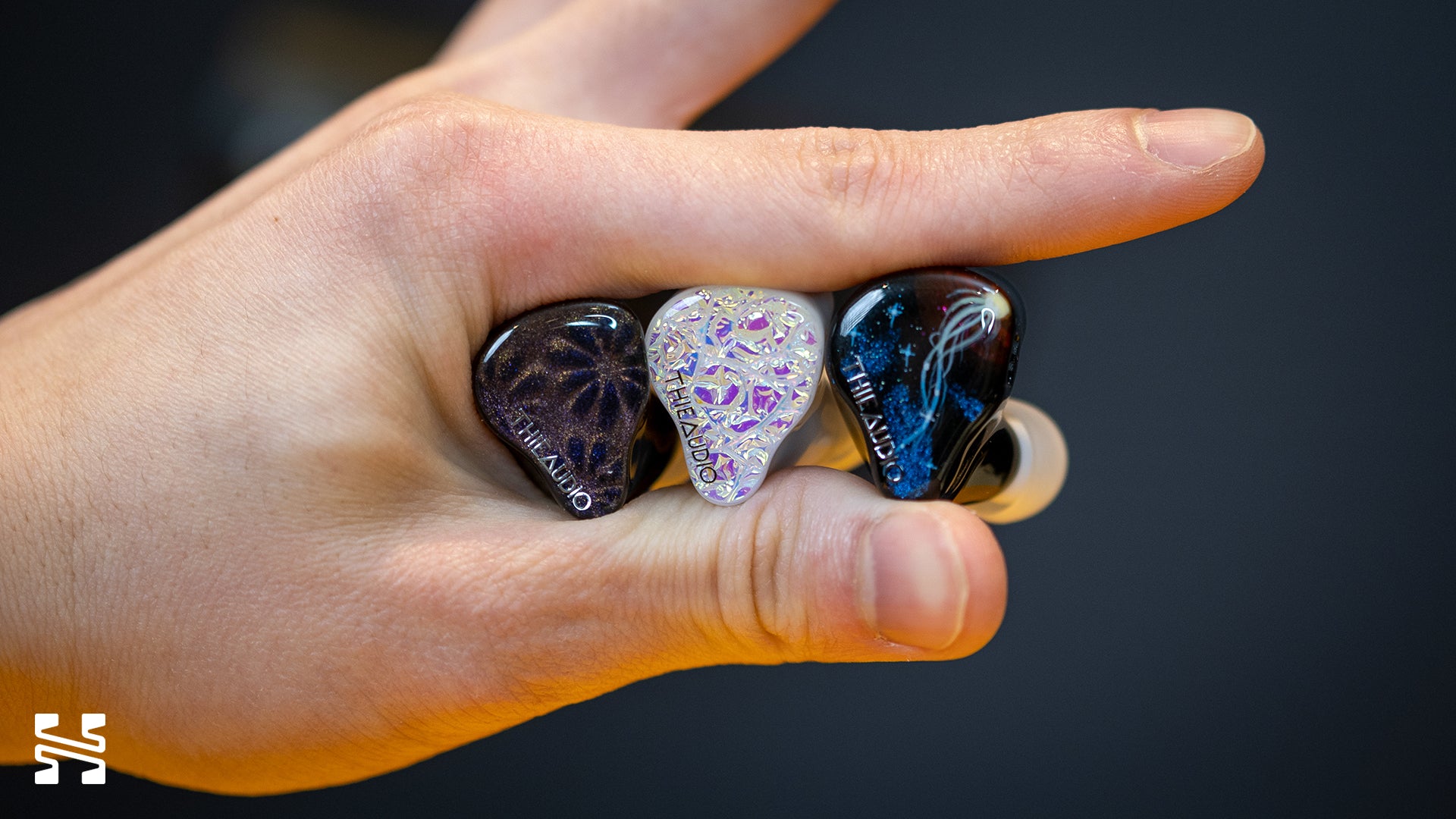

The shell of the Hype IEMs may be a problem for some. They’re big and bulky, increasing in size with the number of BAs crammed in there. For all of them the nozzle diameter is 6.3 mm and its length is quite stubby, only enough for the tips and that’s it. You’ll feel the shell pressing up against your ear if you try to push it even moderately deep. It isn’t the most comfortable experience, especially for the Hype 10 since it has the largest shell. The faceplates are pretty though - the Hype 4’s purple patterns look gorgeous in the right light and the Hype 10’s galaxy swirls are downright celestial.
A funny little anecdote about the Impact2 drivers is that they have driver flex. But not in that crinkly tin-can crunching and popping sound. Instead, it makes a bouncy “do-ing” sound that I can sometimes hear when inserting. These IEMs are vented which is what makes this driver flex unexpected but in any case, it’s not something to worry about.

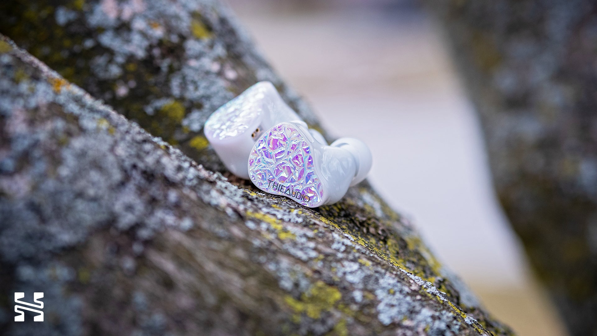

Thieaudio Hype 2

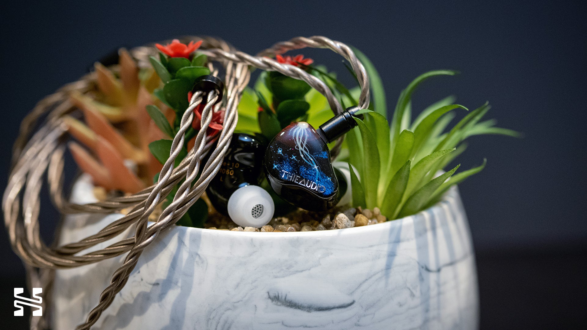

Thieaudio Hype 4

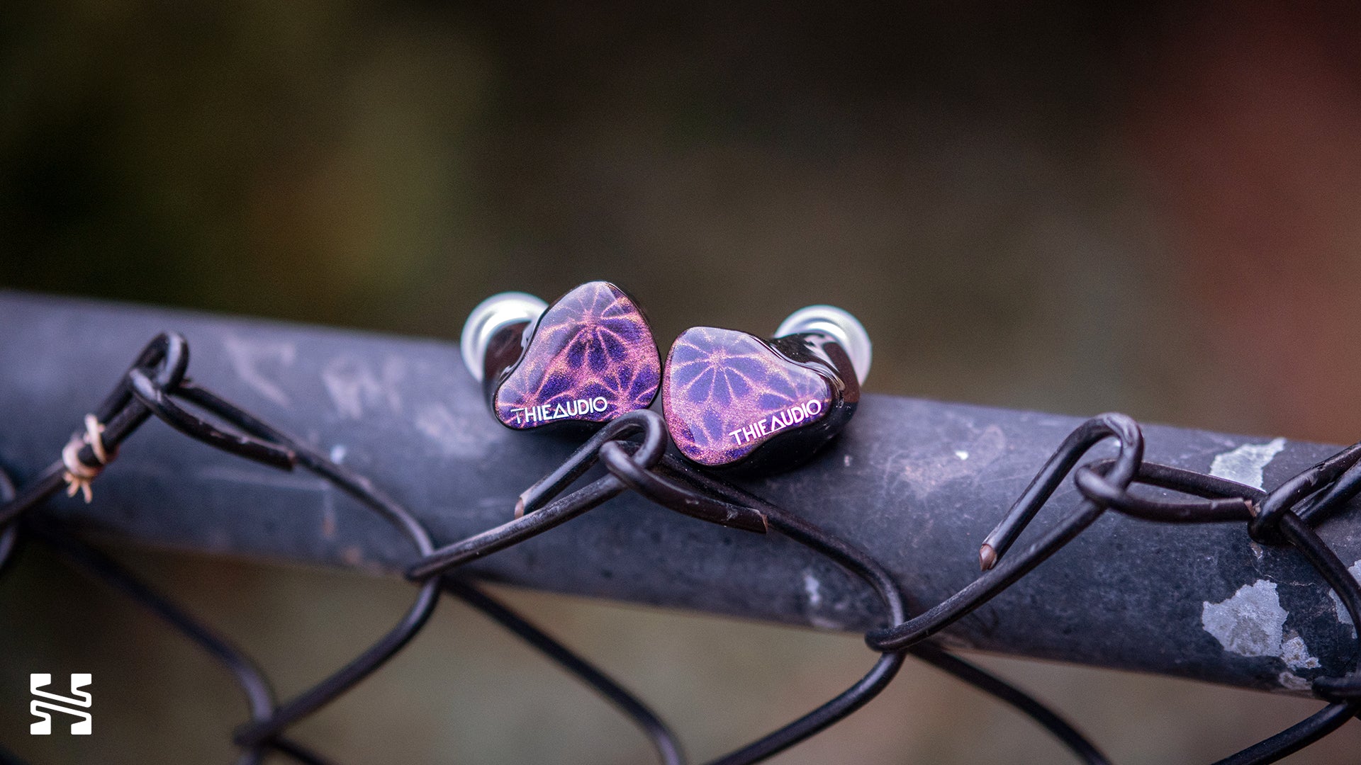

Thieaudio Hype 10

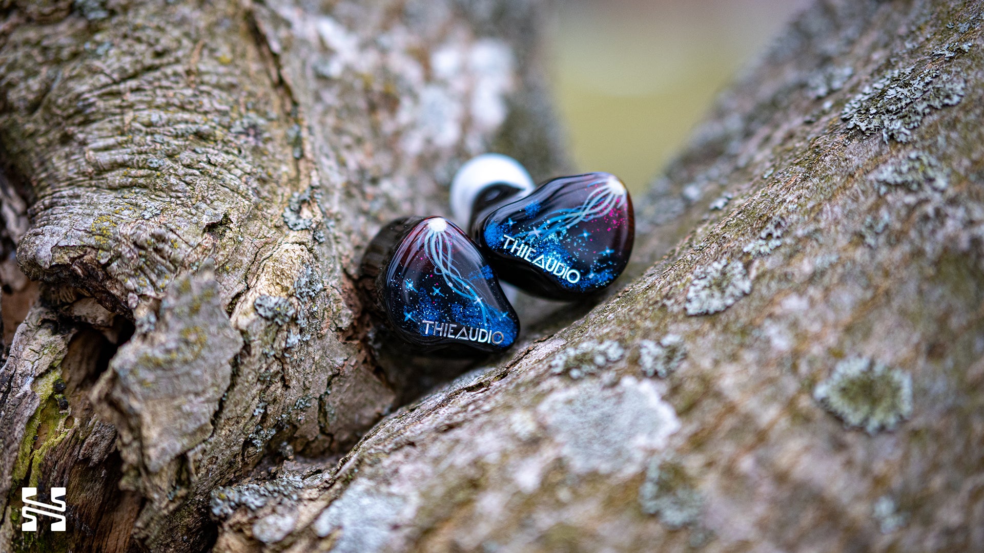

The Hype 10’s treble is very similar to the Hype 4’s, except it doesn’t have the same exaggeration. It’s what the Hype 4 should have been to begin with. Treble notes are much better blended into the mix. Though interestingly, they have more shimmer and sizzle than the Hype 4 did, giving the hats and cymbals more character.
