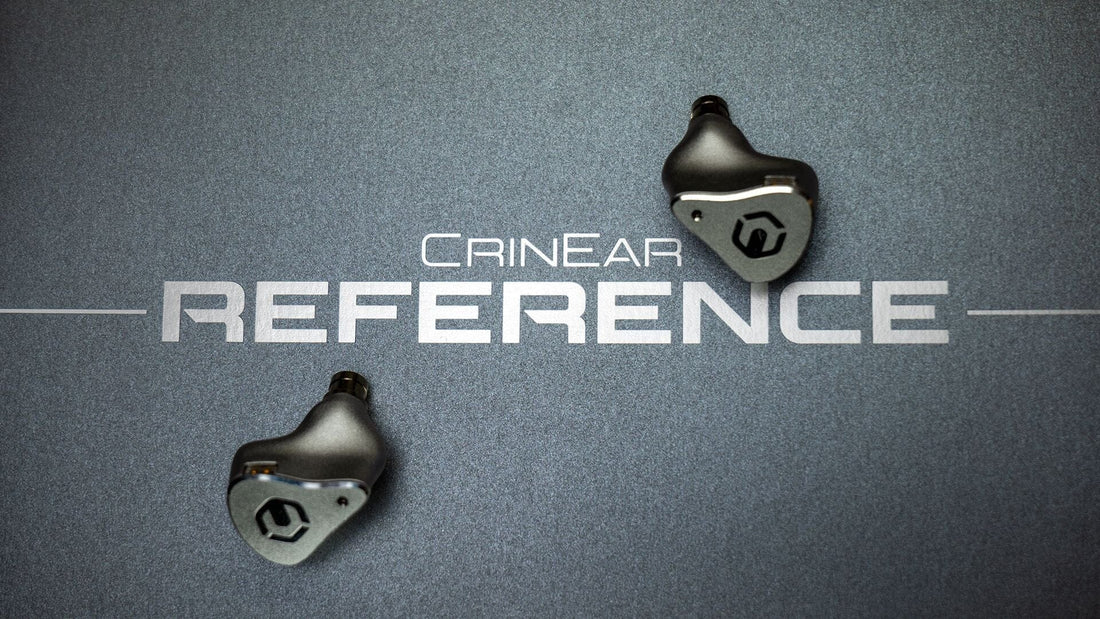

Touching on visual design, so far this is my favorite looking CrinEar IEM, almost entirely because Crin opted for a relatively less obtrusive logo instead of the ugly/somewhat “gamery” text branding on things like Daybreak and META. While the lack of text here is preferable, and the all-silver metal shell itself is handsome, I am still not a massive fan of the branding and polishing here. The logo itself is still rather “gamery,” and communicates little about the brand/product. If I had my druthers, there wouldn’t be a logo on the faceplate at all; he’s gone the lengths to offer a handsome full metal construction at this price, I think it’d be best if he let the shell speak for itself.
Speaking of construction, Reference is also CrinEar’s most solid-feeling IEM to date. Obviously the slightly heavy aluminum shell has a big part to play there, but I think subjectively the fact that it’s all one color and its (as far as I can tell) CrinEar’s largest IEM also contributes to the IEM looking and feeling more robust—both more robust than past CrinEar designs, as well as more robust than similarly priced options that lack metal shells.
