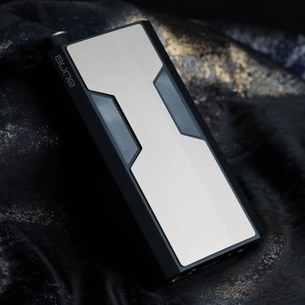

The Aune BX2 Magnum is a portable headphone amplifier with two Korg Nutube 6P1 vacuum tubes, a fully balanced four-channel discrete circuit, and up to 5 watts of output into 32 ohms, all running on its own seven-cell battery.

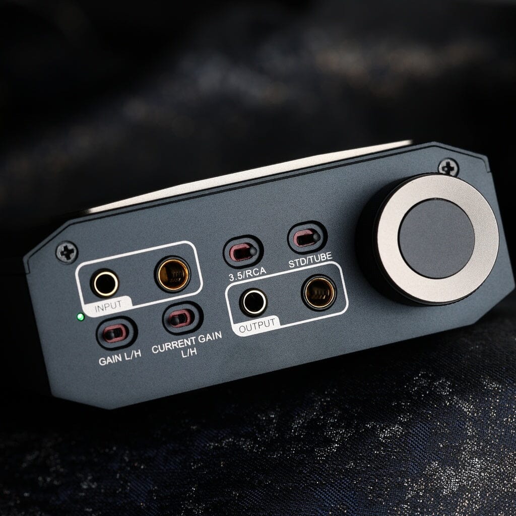

The BX2 Magnum is for listeners who want one amplifier for the desk and the bag. Feed it from a DAP, portable DAC, or desktop source through 3.5mm, 4.4mm balanced, or RCA inputs, and it drives IEMs and full-size headphones from 3.5mm and 4.4mm outputs, with a choice of tube or transistor sound.
Tube Mode and Transistor Mode
A physical switch selects tube mode or transistor mode. The two signal paths are fully independent, and latching relays handle the switching so the unused path stays out of the signal. Transistor mode is fast and linear, with THD+N of 0.0003% from the balanced output. Tube mode routes the signal through the Nutubes for the warmth, body, and harmonic richness people buy tube amplifiers for, and its distortion rises to as much as 1% as a result.
Two gain levels and two current settings add more options. Between mode, gain, and current, the BX2 Magnum has eight combinations to match different headphones and music.

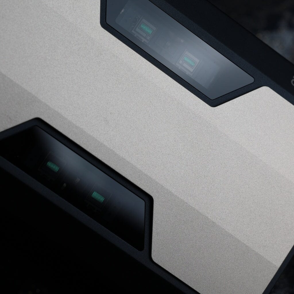

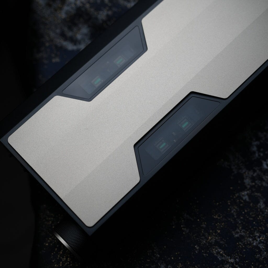

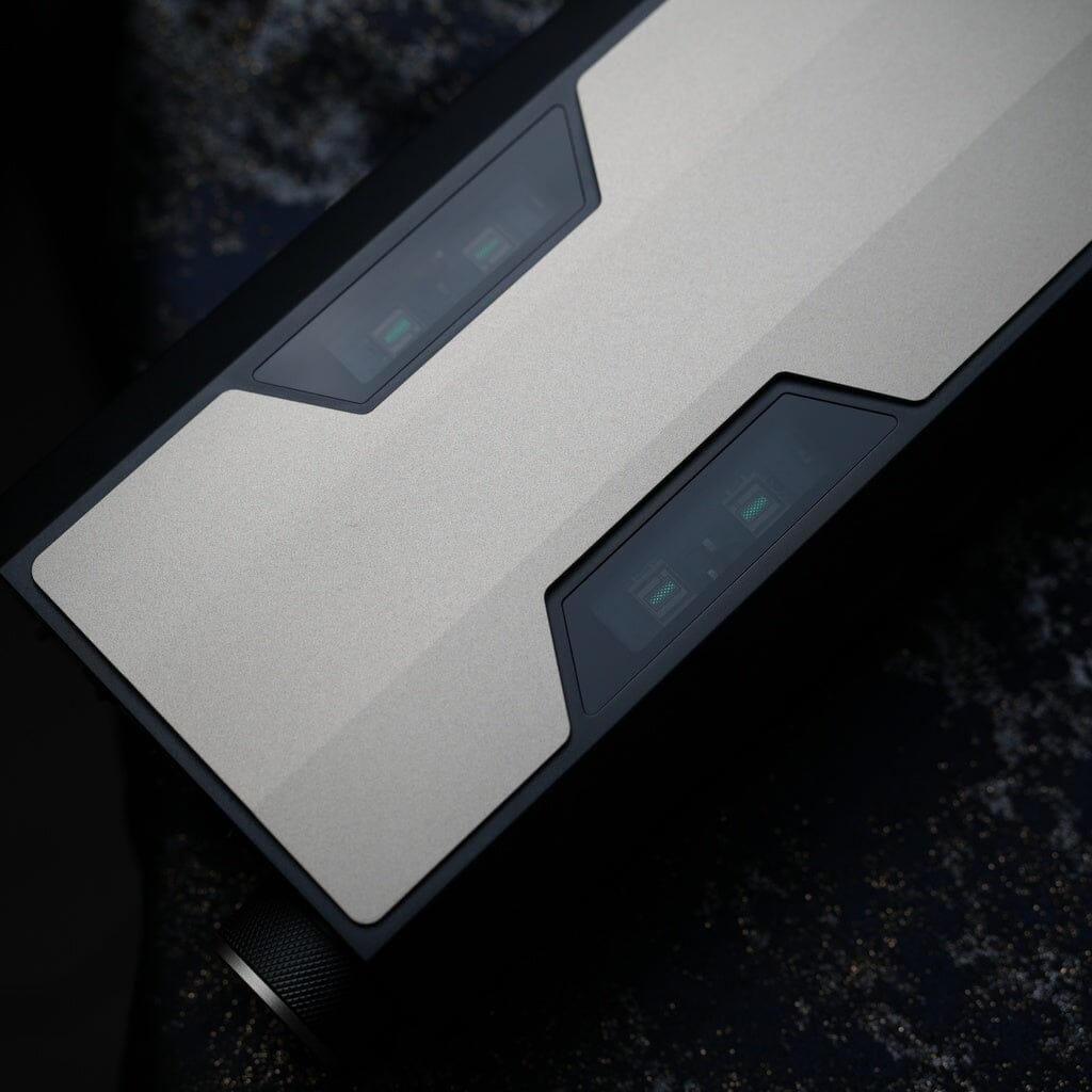

Korg Nutube 6P1 Tubes
The Korg Nutube 6P1 is a dual-triode vacuum tube, and in the BX2 Magnum both tubes do real work in the amplification stage. A dedicated 30V anode supply runs them in their linear range, which gives them more voltage headroom than most portable tube stages have. Ahead of the tubes, a twin JFET input stage adds its smooth transfer characteristic, and the fully balanced four-channel layout keeps left and right separate for precise imaging.

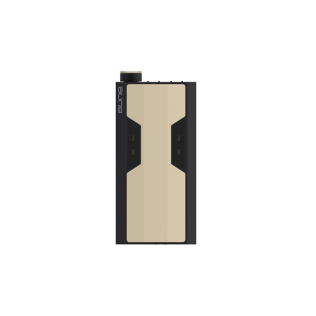

Battery and Power Supply

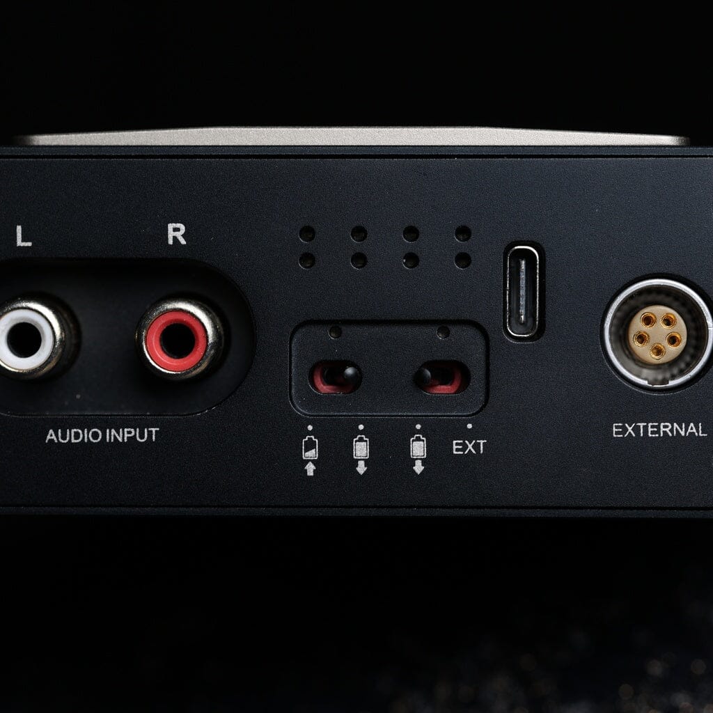

The BX2 Magnum's 14,000mAh battery is made of seven separate 2000mAh cells. Six of them form a plus and minus 12V supply for the analog circuit, and the seventh runs the digital controls on its own, which keeps control noise out of the audio. Two four-segment indicators on the rear panel show the charge of both banks.
A full charge over USB-C takes about five hours and lasts up to 13 hours in transistor mode or more than 8 hours in tube mode.

A five-pin external power input lets the BX2 Magnum bypass its battery and run on plus and minus 15V from Aune's BP1 external power supply, sold separately in a matching stackable chassis. At the desk it runs on higher supply rails than the battery provides, and away from the desk the battery takes over.
