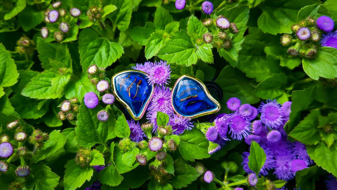

  • The MEST MkIII itself. While the size of the shell itself is actually fairly reasonable, nozzle diameter is yet another massive 6 mm affair and I did start to feel it after using them for a while depending on the tips I used. Annoyingly, the MEST MkIII also has driver flex. I had no issue with the weight though. Aesthetically, the gold-rimmed translucent blue shell makes it look the price, though I would say the carbon fiber streaks embedded in it are hardly noticeable unless you’re right up close.
In case you were wondering, the MEST MkIII sports an exotic driver combination of 4 electrostatic drivers (EST) + 4 balanced armatures (BA) + 1 dynamic driver (DD) + 1 bone conductor (BC) driver. In particular, Unique Melody claims the BC driver operates in the range of 500 Hz to 16 kHz. If you’re not sure what this all means, don’t worry. What’s important is how it sounds.
