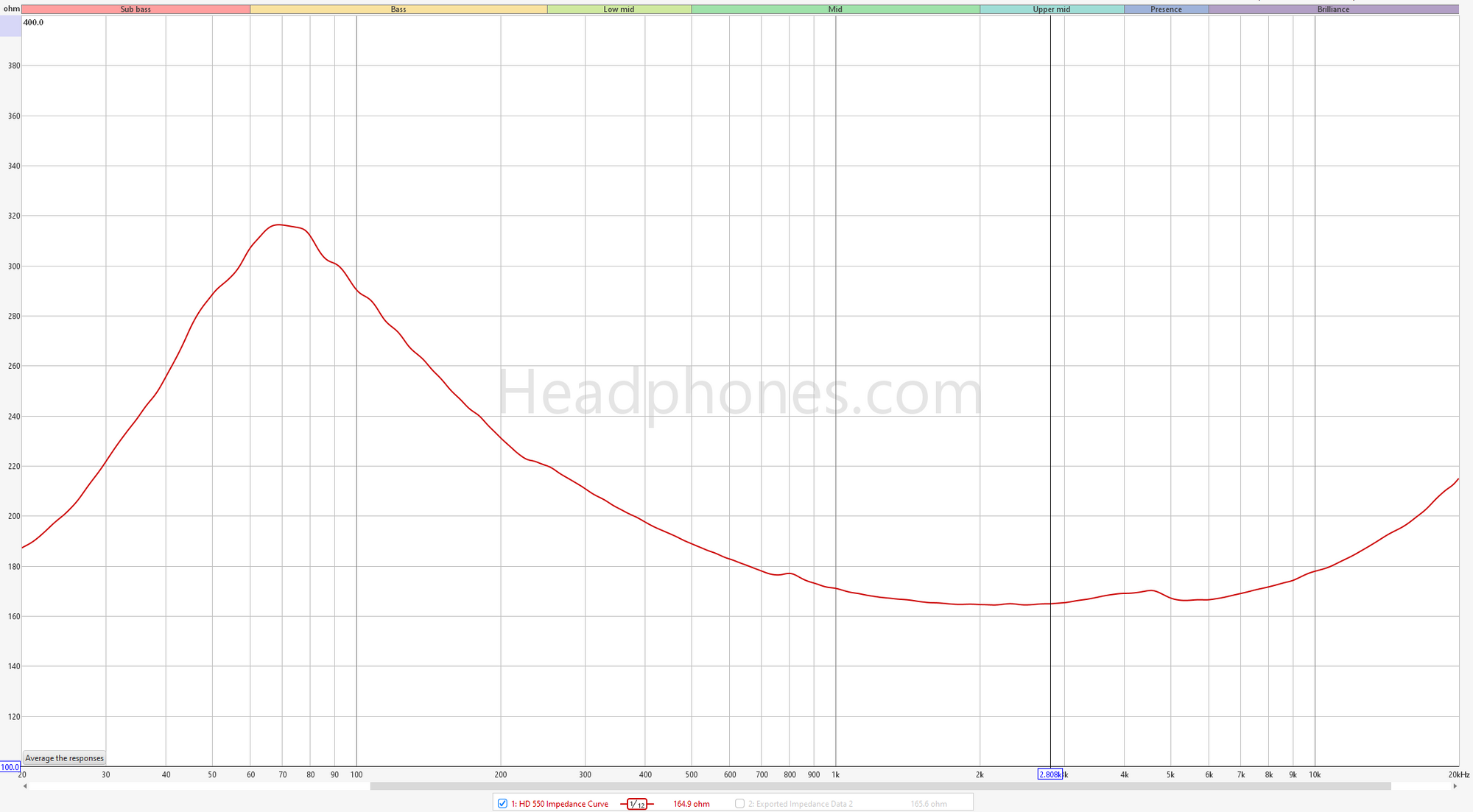

As mentioned, headphones and IEMs have an impedance number listed on a spec sheet. In fact, each driver within the headphone or IEM has their own impedance. But the impedance of a driver is NOT one fixed number. It changes based on frequency. This is because while I’ve used the words resistance and impedance somewhat interchangeably here, technically impedance is resistance plus reactance (which changes with frequency). We can see this visualized as the driver’s impedance curve which is yet another spec sheet.
Impedance curve of the Sennheiser HD 550. It’s roughly 170 Ω at 1 kHz, and 320 Ω at 70 Hz. Taken from the Sennheiser HD 550 Headphones Community forum thread.
So when a manufacturer lists the impedance of a headphone or IEM, it’s actually the impedance at a certain frequency. Typically, it’s done around 1 kHz where the bottom of that valley in the graph is (AKA the nominal impedance). And even then, it’s usually not an exact number. The Sennheiser HD 550 is listed with an impedance of 150 Ω, but in the impedance graph above, it’s closer to 170 Ω.

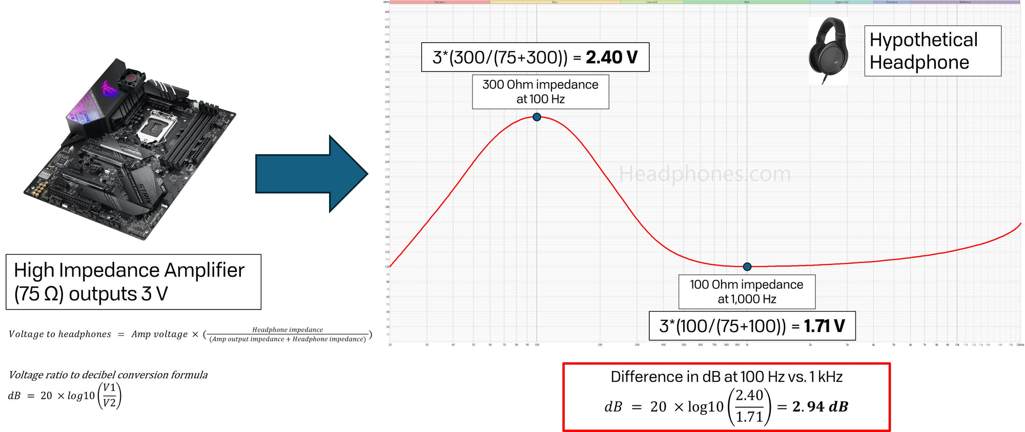

Here is where the voltage divider effect comes in. Remember that it’s the interaction between the amplifier’s output impedance and the headphone’s impedance. So what happens when you have varying impedance i.e. the driver’s changing impedance based on frequency?
Voltage that actually reaches your headphones as a result of the voltage divider effect can be calculated as:
The key takeaway here is that: since your headphone's impedance varies by frequency, the voltage divider formula tells us that we will have different voltages at different frequencies, depending on the impedance curve of the driver. Here’s a simple example:
  • Your headphone is listed as 100 Ω on the spec sheet. However, in reality it has 300 Ω impedance at 100 Hz in the bass, but 100 Ω at 1 kHz in the midrange.
  • Your amp is putting out a steady 3 V.

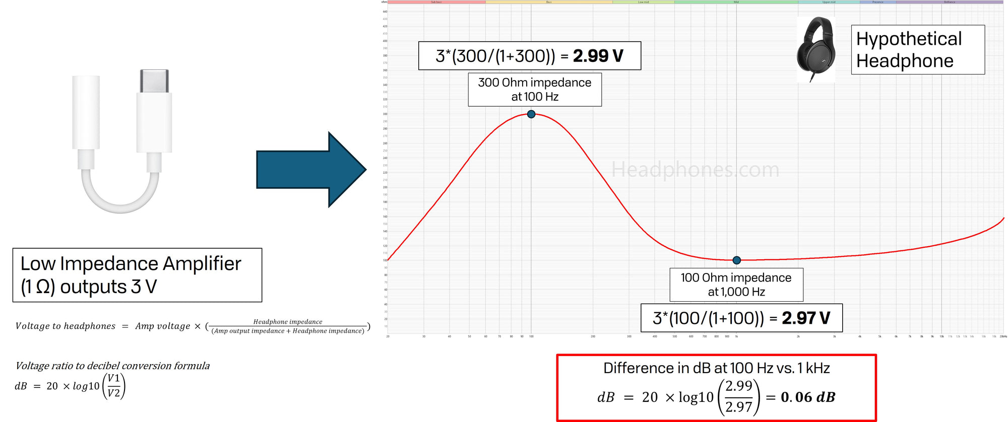

  • On a low output impedance source e.g. your phone dongle (1 Ω):
    • At 100 Hz (300 Ω), the voltage to your headphones = 2.99 V
    • At 1,000 Hz (100 Ω), the voltage to your headphones = 2.97 V
    • Converting that difference into decibels, we get 0.06 dB which is imperceptible.
  • But on a high output impedance source e.g. a computer motherboard (75 Ω):
    • At 100 Hz (300 Ω), the voltage to your headphones = 2.40 V
    • At 1,000 Hz (100 Ω), the voltage to your headphones = 1.71 V
    • Converting that difference into decibels, we get 2.94 dB. It means that when your headphone is on a high output impedance amplifier, the midrange will have almost 3 dB less volume than the bass. Or in other words, your headphone will be bassier than the manufacturer’s design. Enough to potentially sound muddy.

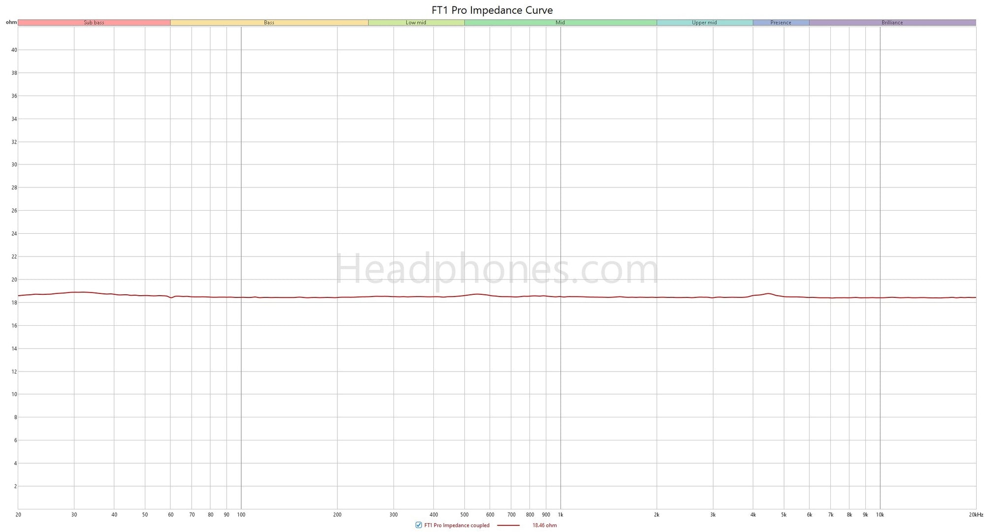

Alternatively, you could also look for products designed with flat impedance curves. The most common example are planar headphones - almost all of them have a flat impedance curve so it doesn’t matter what the output impedance of your amplifier is. For IEMs, companies like 64 Audio and Symphonium Audio specially design many of their products to have a flat impedance curve so you can safely plug it into any source device and have its sound preserved. That’s especially useful given that IEMs are used on stage with professional audio equipment which will have all sorts of output impedances.
The FiiO FT1 Pro is a planar headphone and has a flat impedance curve. The output impedance of your amplifier will not change its tonal balance, and the voltage divider effect is minimal. Taken from the FiiO FT1 Pro Headphones Community forum thread.

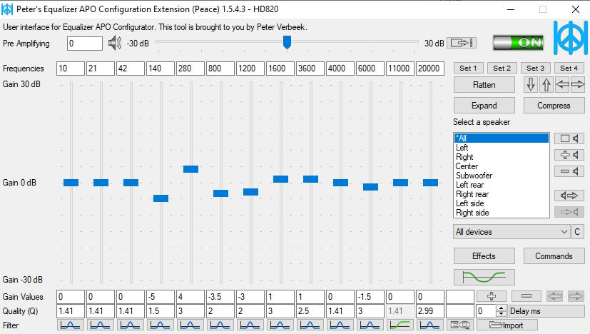

Now, it should be said that you can achieve the coloration effects of high output impedance through the use of EQ software. It takes out all the guesswork as you can surgically apply any tonal changes you want. To some extent, playing around with output impedances to match specific amplifiers with specific headphones or IEMs may be seen as a form of hardware EQ.
Peace Equalizer + Equalizer APO is the most popular method for EQing on Windows.
However, that doesn’t mean using high output impedance is entirely moot. EQ is a bit harder to set-up than simply plugging your audio gear in. It’s also not quite as universal as software isn’t always cross compatible between devices, nor is it free from glitches. Plus, part of the fun of being in this hobby is the audio journey itself - exploring different combinations and trying different things to find what you enjoy. It’s all up to you how you want to experience things.
