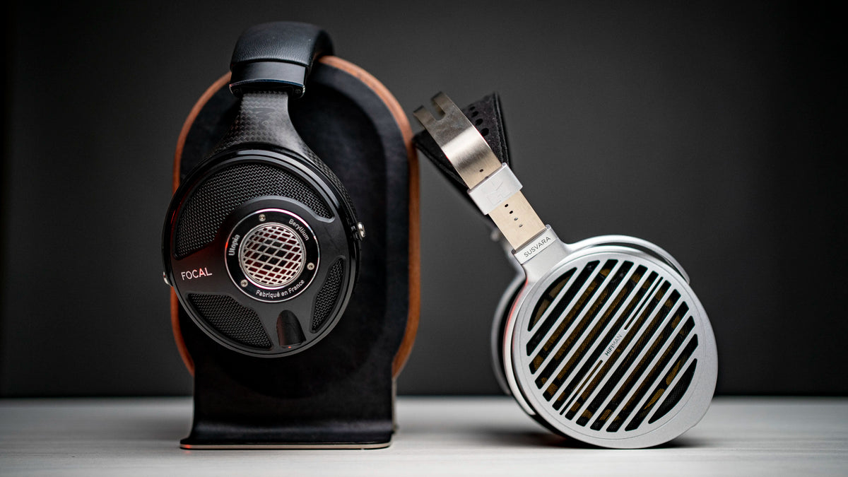

The Focal Utopia and HiFiMAN Susvara

HiFiMAN Susvara - $6000
Neutral
The pinnacle of HiFiMAN planar headphones. It’s the right combination of great tonal balance and detail, separation and space for my taste. It could be a bit more punchy, but apart from that it does just about everything right. Also it’s very comfortable.
Written Review / Video Review / Shop
What we like
- Balanced tuning
- Image separation
- Spacious sound
- Highly detailed
- Comfortable
What we don’t like
- Not the most dynamic or punchy sound
Focal Utopia (Original and 2022) - $5000
Neutral with slight mid forwardness
A well-balanced tuning that adds a bit of richness to the mids. It’s also the most technically impressive moving coil driver headphone I’ve heard to date, with an extremely punchy and dynamic sound to it. For the different versions, some people found the original to be a bit bright in the treble. I’ve never personally found that to be an issue, nor have I ever measured one to be bright, but the 2022 model is about 2dB more relaxed in the treble. Apart from that they’re basically the same.
Written Review / Video Review vs Susvara / Shop
What we like
- Highly detailed
- Extremely punchy and dynamic
- Refined mid-forward tuning
What we don’t like
- A bit on the heavy side
- Not as spacious sounding

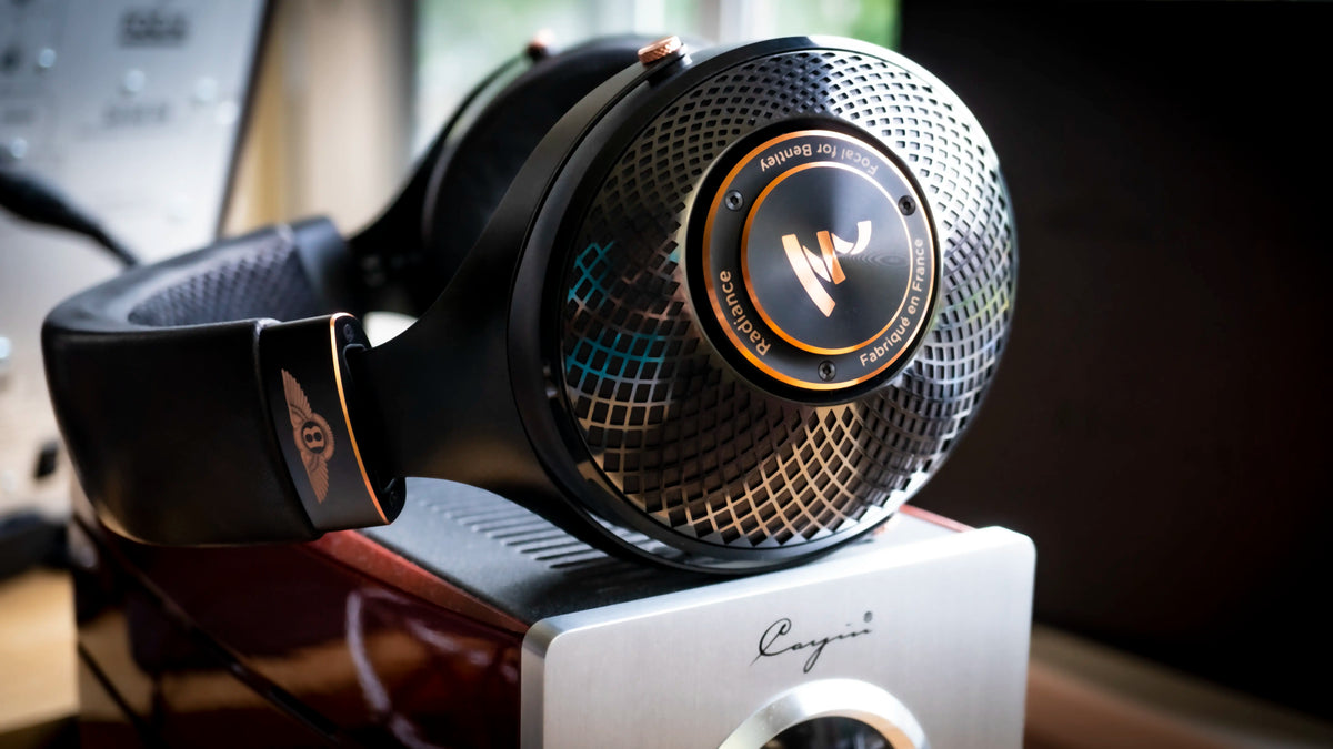

The Focal Radiance
Closed-Back Headphones
Focal Radiance $1300
Neutral
The Radiance is one of the better-tuned Focal closed-back headphones, and for me it’s also one of the more comfortable ones. Over time I found that the Celestee simply has too much clamp for my liking, so that’s why I go with the Radiance as my current recommendation between the two.
Written Review / Video Reviews / Shop
What we like
- Balanced tuning with a bass boost
- Detail/Resolution
- Punchy and dynamic
What we don’t like
- A bit on the heavier side
