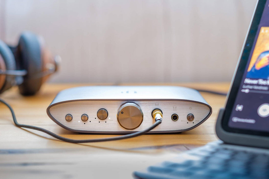

In common with the other ZEN Series products, the ZEN CAN sports a sturdy, smartly finished aluminium enclosure, neatly sized at 158x35x100mm (WxHxD). In the centre of the front panel is a smooth-acting rotary volume control, flanked by a range of sockets and buttons. On the left, beside the power button and input switch, resides a control for selecting the appropriate gain. Four settings in six dB steps – 0dB, 6dB, 12dB and 18db – enable the amp to precisely suit the connected headphones; unity gain (0dB) is useful to ensure low noise with sensitive in-ear monitors, while the higher gain settings make the most of tougher headphone loads, delivering excellent dynamic headroom.
To the right are a pair of headphone outputs – a 6.3mm output for headphones that have a standard single-ended connector (compatible with all headphones) and a 4.4 Pentaconn balanced output for headphones offering balanced connection. An increasing number of high-quality headphones and in-ear monitors either come so equipped or give the option of detaching the cable and upgrading to a 4.4mm Pentaconn connector, and this output makes the most of them (it is particularly recommended for high-impedance headphones).
Next to the headphone sockets is a button to engage the latest versions of iFi’s ‘XBass’ and ‘3D’ sonic tailoring options for headphones. XBass adjusts frequency response to enhance low frequency performance – particularly useful with openback headphones that ‘leak’ deep bass. 3D compensates for the ‘in-head localisation’ effect that often occurs when using headphones to listen to music that was mixed using a pair of speakers, effectively widening the headphone soundstage to deliver a more speaker-like experience. Both XBass and 3D engage purely analogue processing and may be bypassed entirely if preferred.
Around the back, the ZEN CAN offers stereo RCA and 3.5mm single-ended inputs, plus a balanced 4.4mm Pentaconn input. A 4.4mm balanced output is also provided, to connect to power amps and active speakers equipped with a balanced input – either a Pentaconn 4.4mm input, or XLR inputs via a 4.4mm-to-XLR cable. This balanced output can also be used for single-ended connection if no balanced input is available. All the ZEN CAN’s inputs and outputs are gold plated for optimal conductivity.
