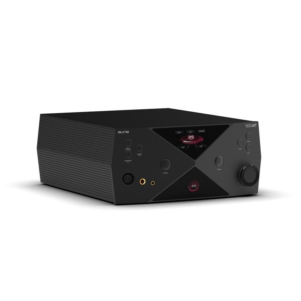

The Aune A17 is the flagship of Aune's amplifier line, a fully discrete, fully balanced headphone amplifier that delivers up to 11,500mW into 32 ohms and runs in Class A across a wide operating range. Aune's tagline for it is "Drives Anything," and the power tables below back that up.
The A17 is for listeners with hard-to-drive headphones: inefficient planar magnetics, 600 ohm dynamics, and everything in between. It is a pure analog design with no DAC inside. It takes RCA or balanced XLR from your DAC, and its preamp outputs can also run powered speakers or a power amplifier.

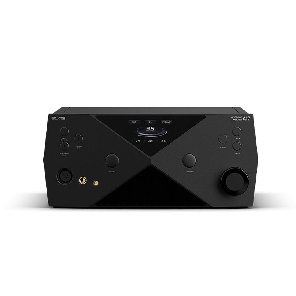

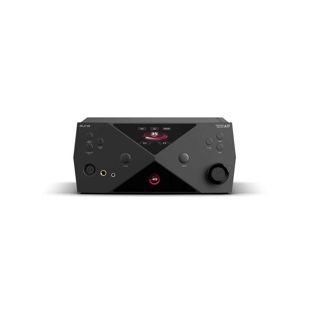

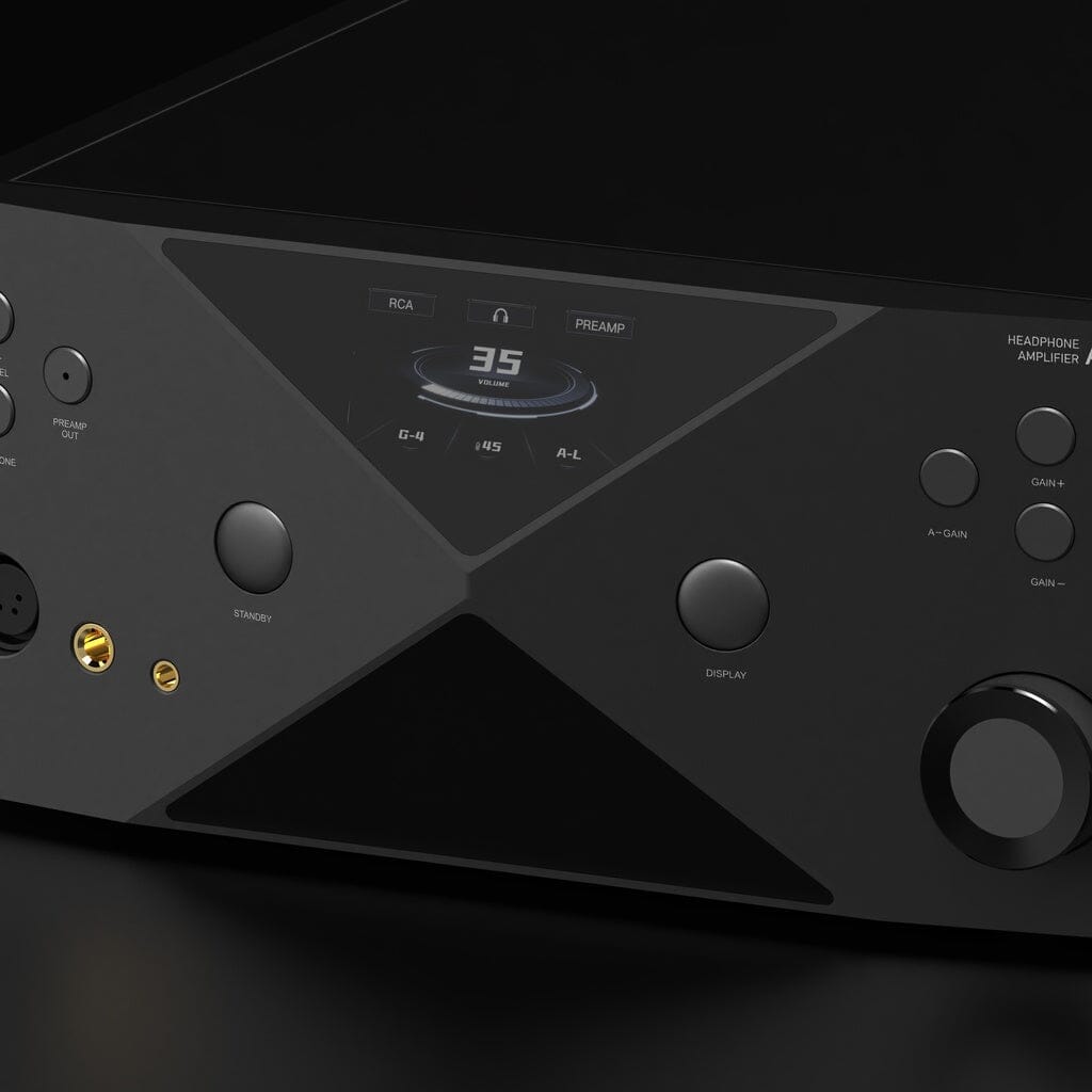

Four gain settings from 5.8dB to 13.5dB and two bias current settings, A-L and A-H, let you match the A17 to the headphone. Sensitive in-ear monitors on G-1 sit against a background under 7 microvolts, and flagship over-ears on G-4 get the full output. The upper display shows input, output mode, gain, volume, and current setting. In A-H both displays turn red, and the lower one shows the internal temperature.

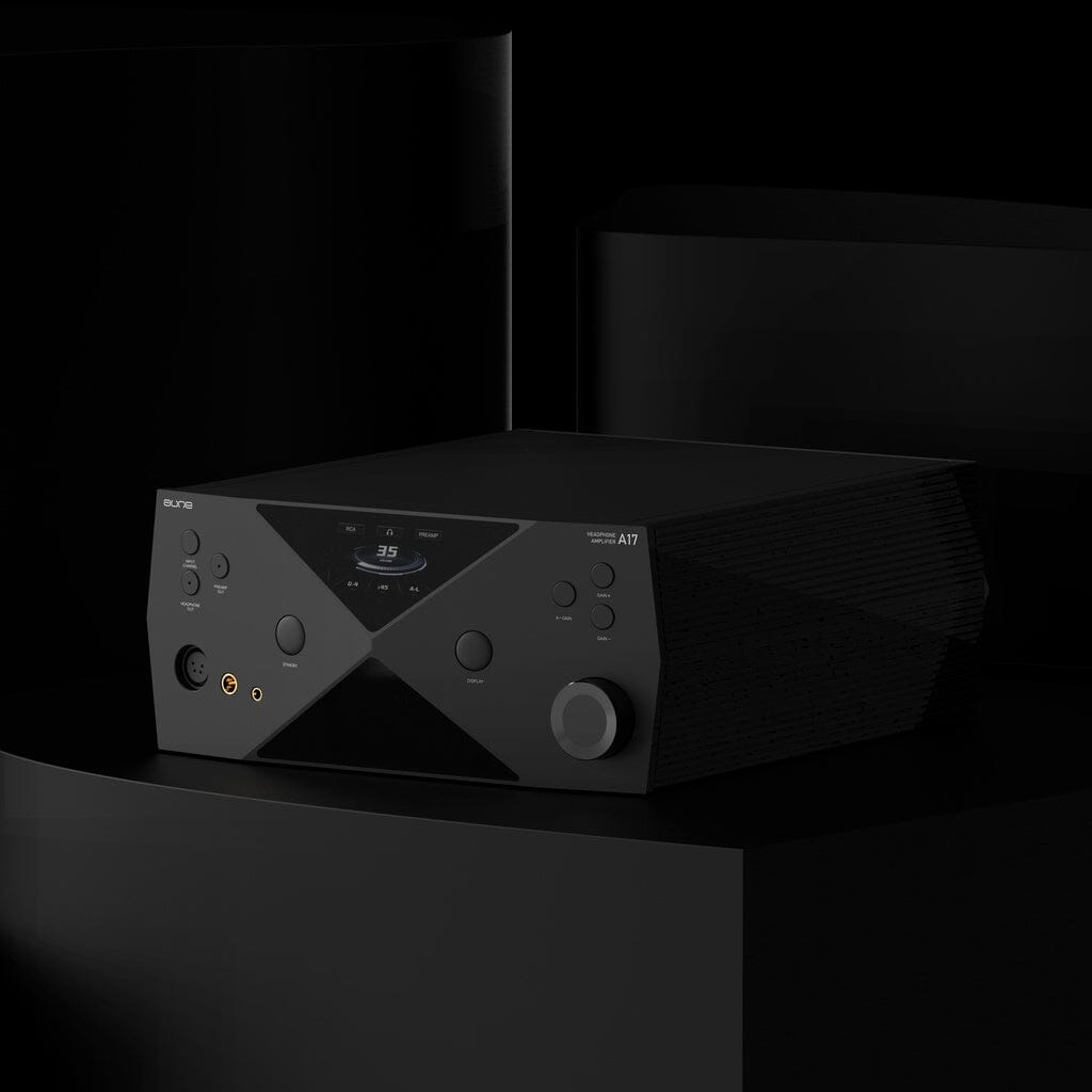

The chassis is thick pure aluminum with a multi-tiered internal heatsink structure that draws heat away from the circuit and spreads it across the case. The A17 runs warm, so give it open space on the desk or rack. Every function has its own physical button, and the included remote mirrors the front panel.

  • Four gain settings (5.8dB to 13.5dB) and two bias current settings (A-L / A-H)
  • Output noise under 7uV; THD+N below 0.0005%
  • 4-pin XLR, 4.4mm balanced, and 6.35mm headphone outputs
  • RCA and XLR inputs; RCA and XLR preamp outputs
  • Dual-display interface with temperature readout
  • One-button-per-function controls with remote
  • Ultra-thick pure aluminum chassis with tiered internal heatsinks
