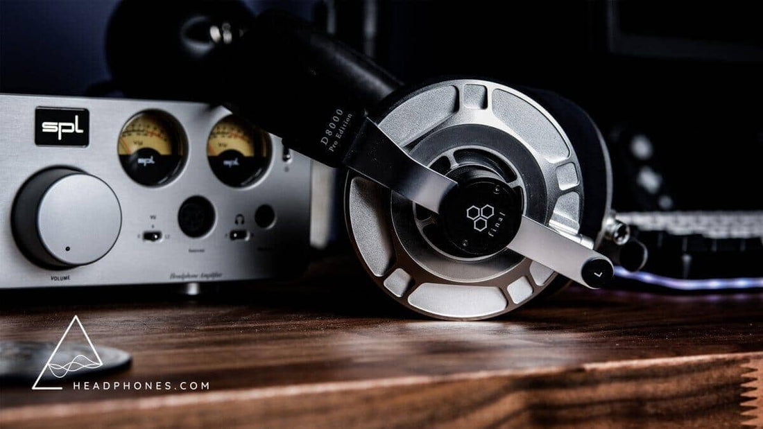

The build on the D8K Pro is outstanding, and undoubtedly one that I think is fitting for a headphone with the “Flagship” label. Its chassis consists primarily of an aluminum-magnesium alloy that is very precisely machined, which gives the feel of a headphone that’s sturdy and has certainly been made with both top-notch materials, and the utmost care in its assembly.
Now, I will mention that although I really doubt that any issues will arise from the D8K Pro’s build, I commend Final Audio for designing their headphone with longevity in mind, as every part on the headphone can be disassembled and easily repaired or replaced.
As for comfort, I think that the D8K Pro is one the more comfortable headphones I’ve had the opportunity to try out recently. Weighing in at roughly 523g they’re on the heavier side for headphones, so if you’re very sensitive to a headphone’s weight these may not be the ones for you. However, I personally didn’t find them to be that heavy when actually wearing, and I think that this is due to the pads and headband being very efficient in distributing the headphone’s weight. I do have one gripe with the D8K Pro, though, and that is that the earcup height adjustment is on sliders, so every single time I took them off and back on, I had to readjust them to the setting that was comfortable for me.
