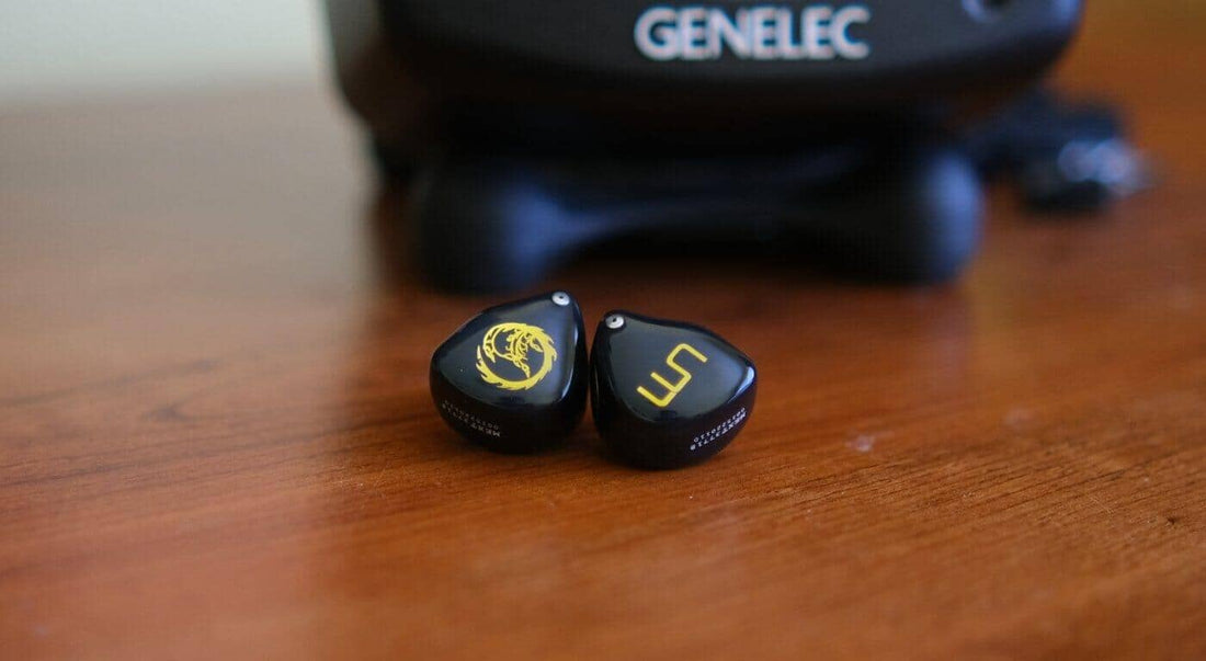

The MEXT itself is noticeably larger than the MEST MKII, as can be seen in one of the above photos. It has a pitch black faceplate that is complimented by the UM logo in gold and what appears to be a plant of some sort. At the base of the IEM's shell, one can also see the new bone conduction driver. I'd be remiss to mention that, visually, this appears to be almost identical to the one used in the Empire Ears EVO (and there's some spicy drama on these similarities if one peruses the Head-Fi forums). In any case, do be aware that the MEXT is not a small IEM although I personally didn't run into any issues with fit or comfort.
