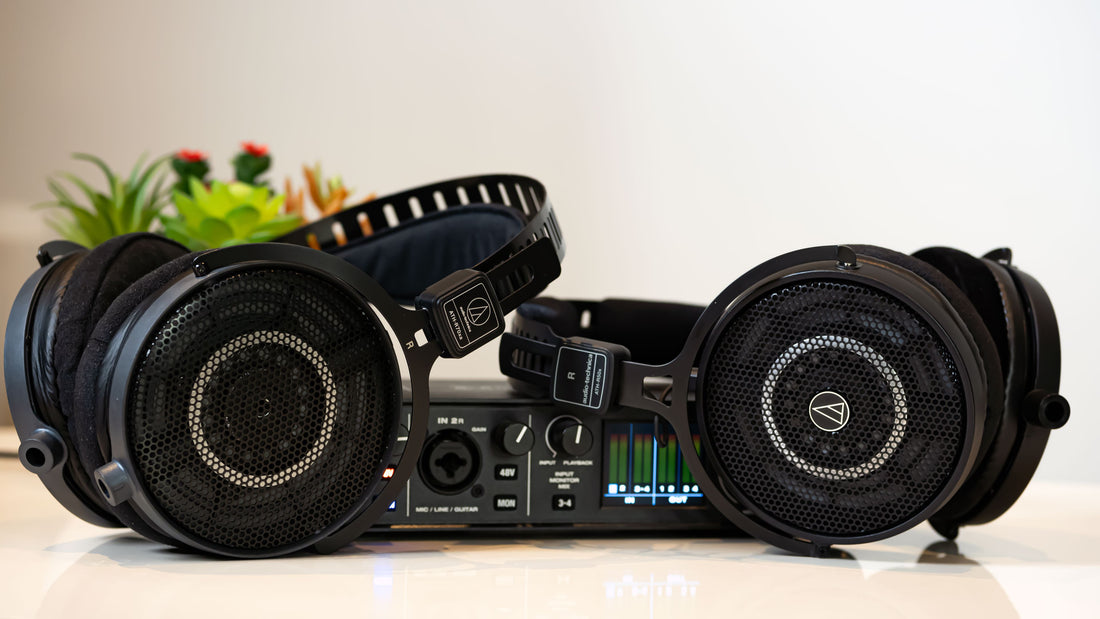

On January 23, 2025, Audio Technica announced three new headphones to their R-Series line-up of headphones. The original R70x will be replaced with the new R70xa ($350), while the R50x ($200) and R30x ($100) will be added as new entry-level options.
Fc-Construct gives us his thoughts of these three headphones in two reviews over at  The Headphone Show along with measurements and other comparisons. A brief bullet-point form summary of these reviews is provided below.

  • The new R70xa suspension strap headband is unfortunately not very good. There's an uneven seal where the bottom has a bit of a gap. The clamp force is quite weak.
  • The R50x rigid headband in contrast is quite good. I wish they used this design for the R70xa.
  • The pads of these headphones are the same size as the original R70x. Meaning if you had fit issues with that, you'll have it here. But R70xa is not 100% identical to the R70x. There's minor differences for the tuning. The R50x uses different pads altogether, with a velour feel and really nice foam density.
  • These headphones are very light. About 200g for the R70xa and 210g for the R50x.
