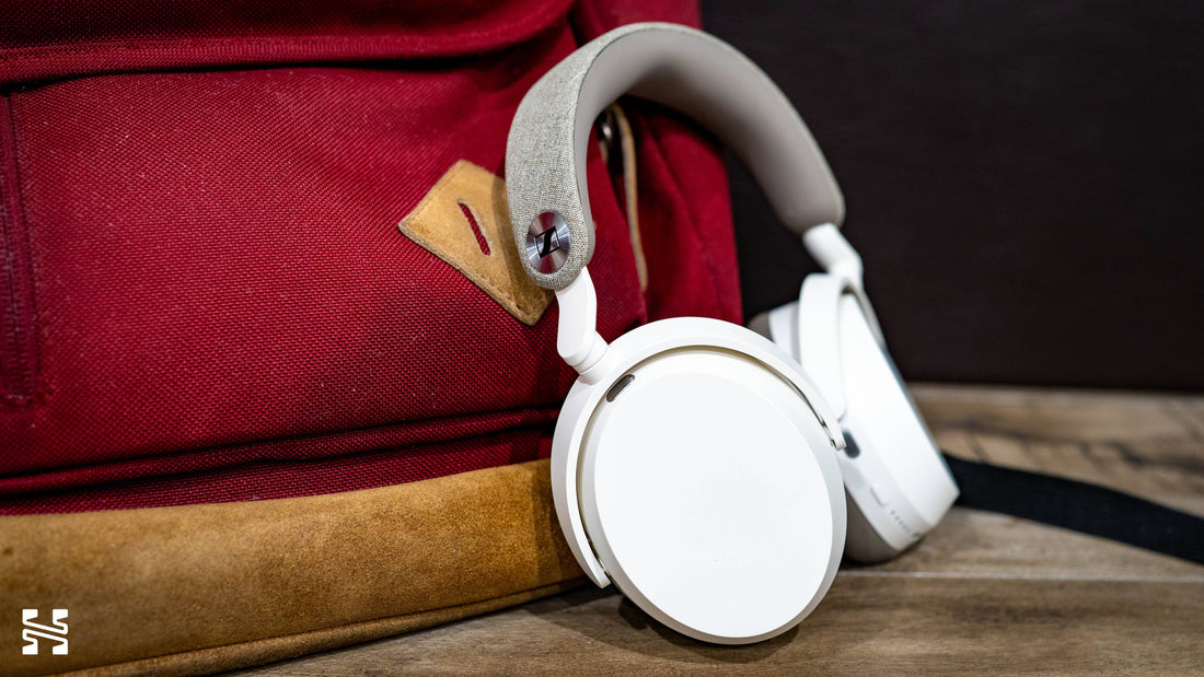

Build and Comfort
The build of the Momentum 5 is similar to the Momentum 4 and the HDB 630, though not identical given some of the different tech inside. It’s functional, but I’ve never loved it as I find them to feel a step behind Sony/Apple/Bose in quality. It’s just not as premium-feeling. It also seems slightly more plasticky than the HDB 630. Though to be fair, the Momentum series is cheaper than its competitors. And I do like the fabric-like material on the top headband though. It’s nice.
The fit and comfort are similarly OK. Like many wireless headphones designed to be slim and compact, there isn’t much space within the ear cups for those with larger ears. It measures roughly 60 mm tall by 42 mm wide and 14 mm deep. It fits my ears just fine, though the tips of my ears lightly touch the inside of the cups. The clamp force is on the lighter side which helps comfort but also means that excessive head movement will cause it to slide off more often than not. Of course, this will depend on your head size.
The one thing I’ll applaud Sennheiser for is the newly designed carrying case for the Momentum 5. It’s one of the flattest, slimmest cases I’ve seen and I can easily slip it into a backpack. It also properly lives up to the name carrying case as it features a handle-like groove at the top where the headband is nested. Very handy (pun intended).
You also get two cables for wired connections: a standard USB-C charging cable and a 2.5 mm to 3.5 mm cable. Like many wireless headphones these days, the Momentum 5 does need to be turned on even when wired. It cannot play passively. Presumably this is because it needs to activate its DSP.
