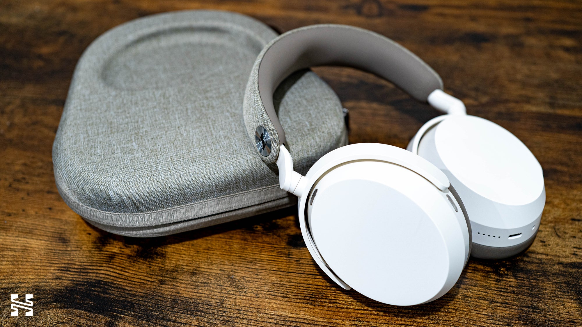

Build and Comfort

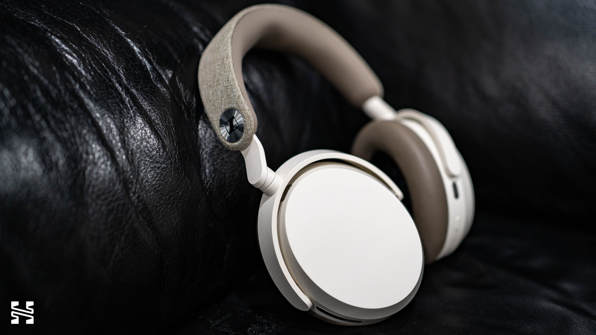

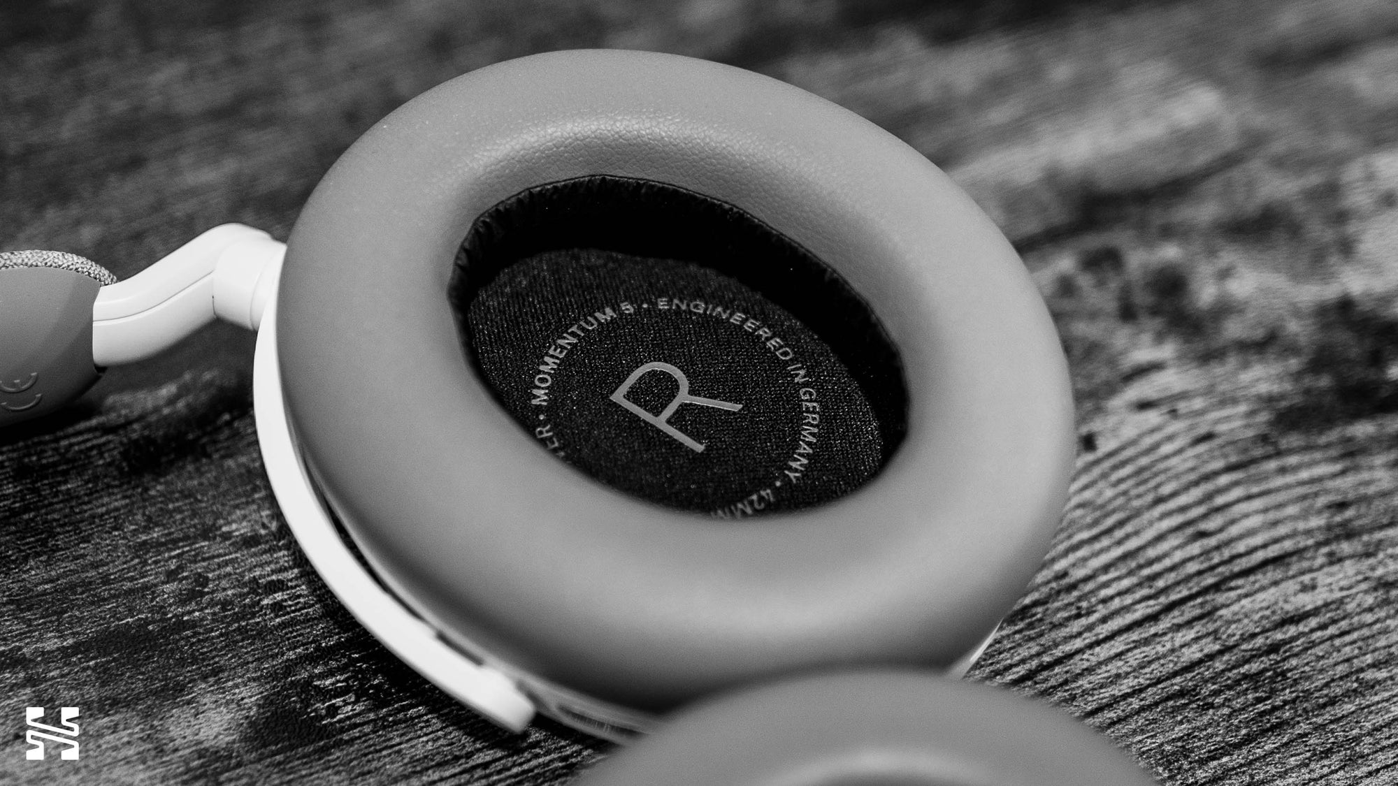

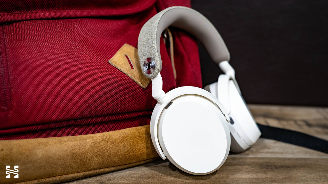

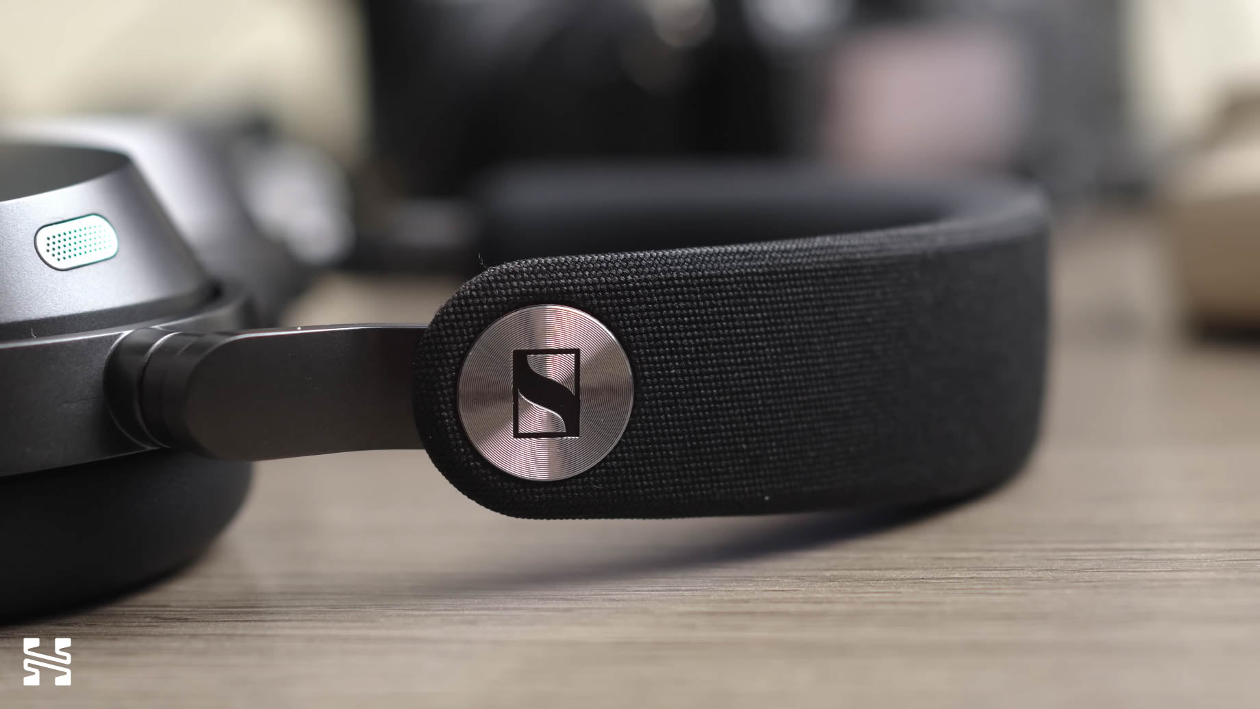

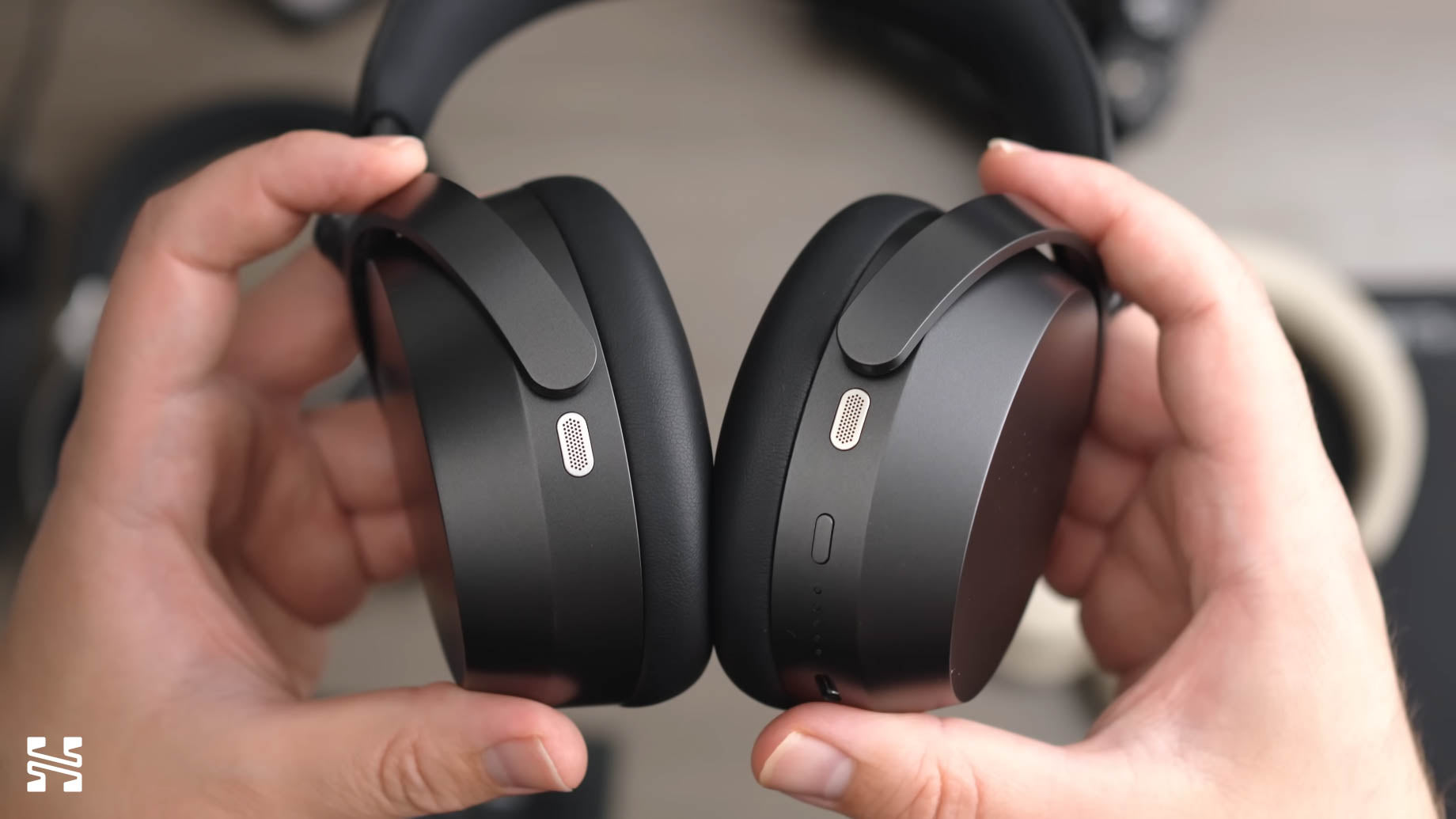

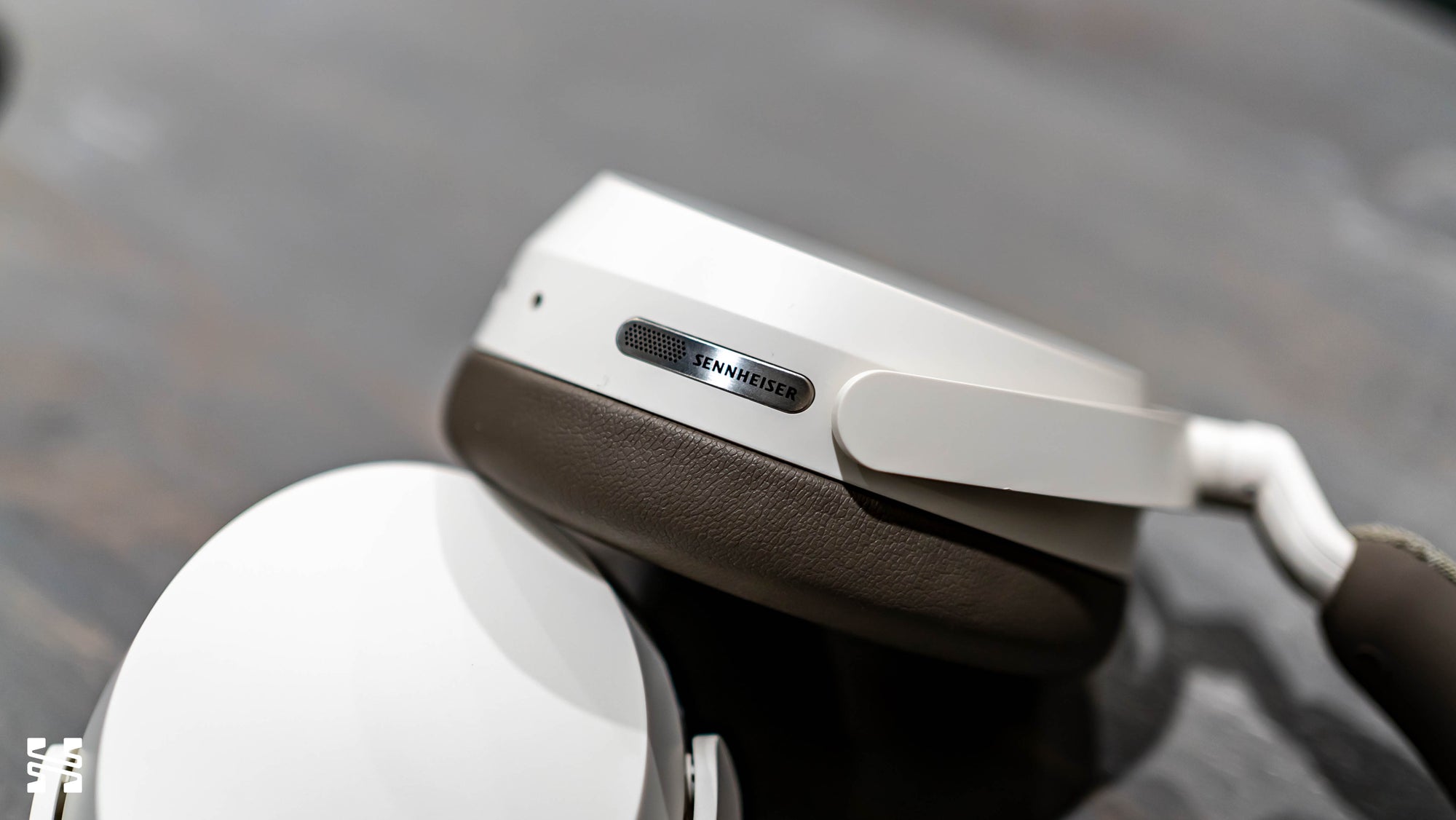

The build of the Momentum 5 is similar to the Momentum 4 and the HDB 630, though not identical given some of the different tech inside. It’s functional, but I’ve never loved it as I find them to feel a step behind Sony/Apple/Bose in quality. It’s just not as premium-feeling. It also seems slightly more plasticky than the HDB 630. Though to be fair, the Momentum series is cheaper than its competitors. And I do like the fabric-like material on the top headband though. It’s nice.
The fit and comfort are similarly OK. Like many wireless headphones designed to be slim and compact, there isn’t much space within the ear cups for those with larger ears. It measures roughly 60 mm tall by 42 mm wide and 14 mm deep. It fits my ears just fine, though the tips of my ears lightly touch the inside of the cups. The clamp force is on the lighter side which helps comfort but also means that excessive head movement will cause it to slide off more often than not. Of course, this will depend on your head size.

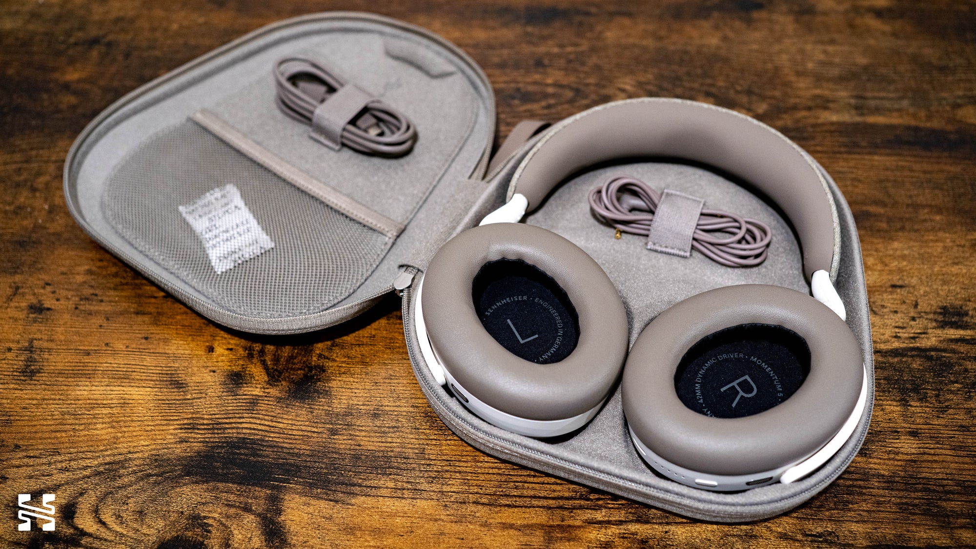

The one thing I’ll applaud Sennheiser for is the newly designed carrying case for the Momentum 5. It’s one of the flattest, slimmest cases I’ve seen and I can easily slip it into a backpack. It also properly lives up to the name carrying case as it features a handle-like groove at the top where the headband is nested. Very handy (pun intended).
You also get two cables for wired connections: a standard USB-C charging cable and a 2.5 mm to 3.5 mm cable. Like many wireless headphones these days, the Momentum 5 does need to be turned on even when wired. It cannot play passively. Presumably this is because it needs to activate its DSP.

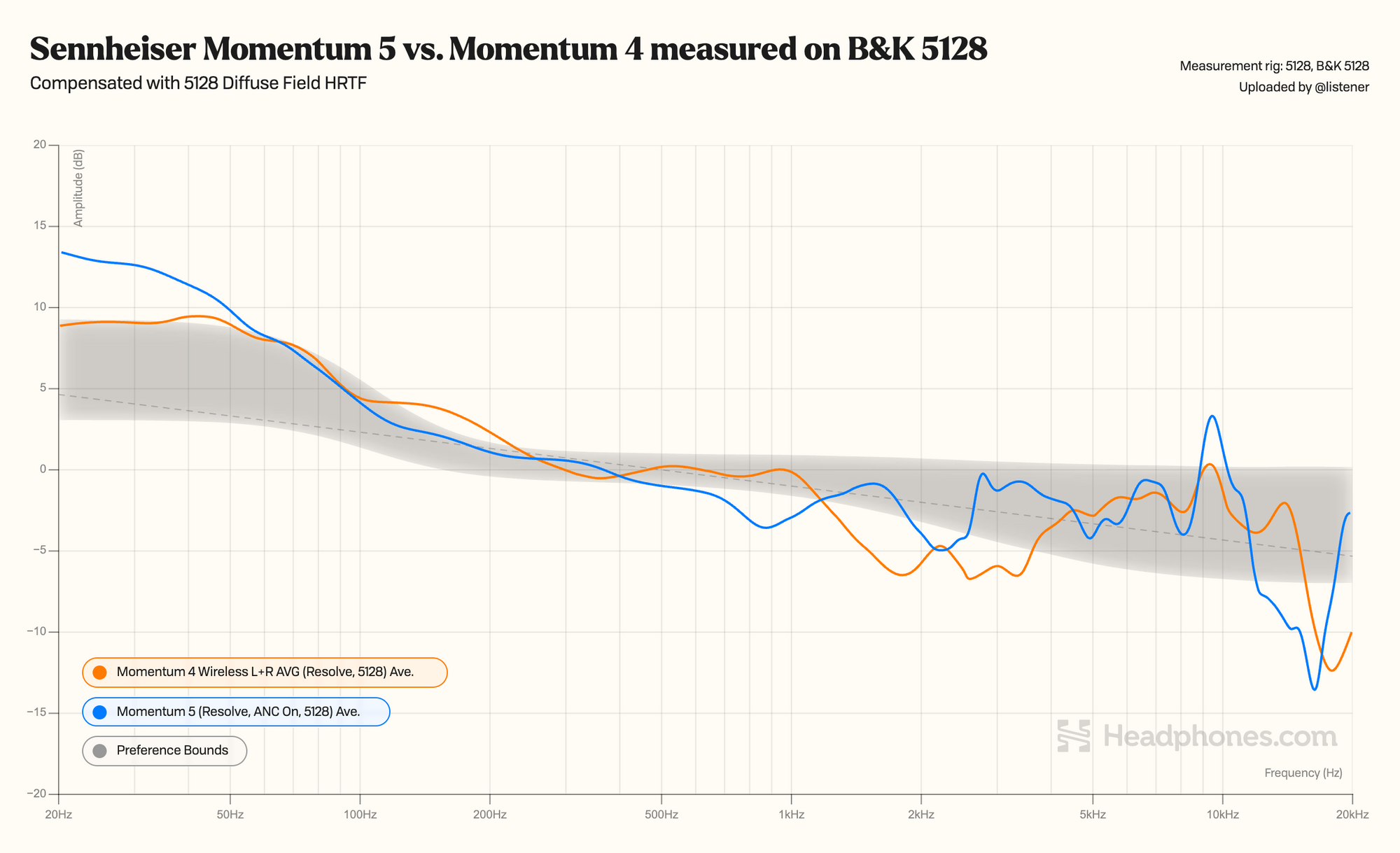

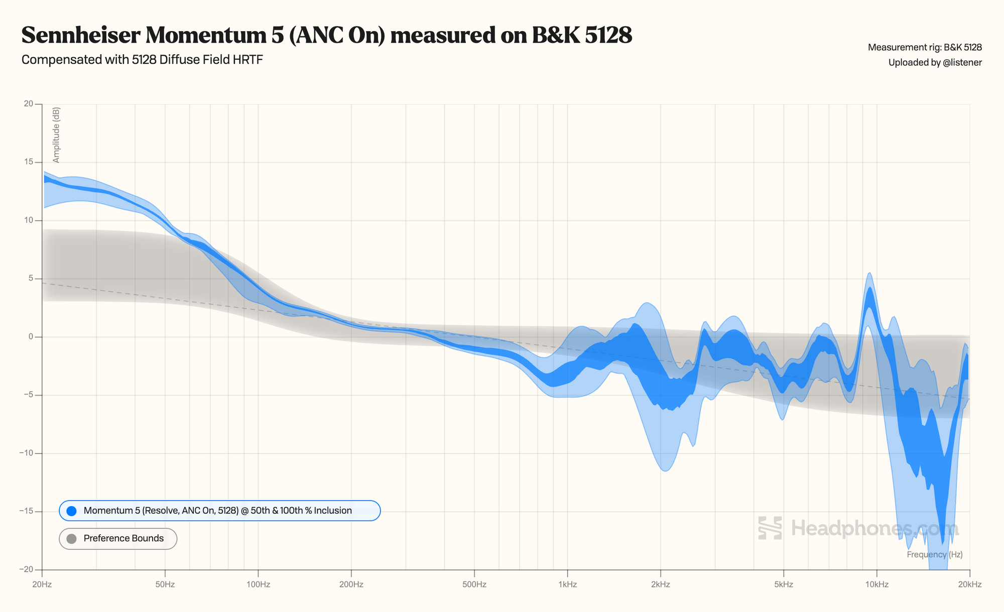

Here are my thoughts on the Momentum 5’s stock tuning (ANC 100%, Neutral preset) as if I were reviewing a regular headphone. However, it must be emphasized that wireless headphones are NOT regular headphones. There are many, many factors that will affect sound quality and overall value, which I’ll touch on in other parts of this review.
The Momentum 5’s stock tuning is generally competent if a bit boomy in the subbass. It’s the type of sound I can accept for my wireless headphones but won’t be particularly excited about. Like an “Oh, that’s it?”. We’ll get more into it below, but first here is the frequency response measurement of the Momentum 5 measured on the B&K 5128.

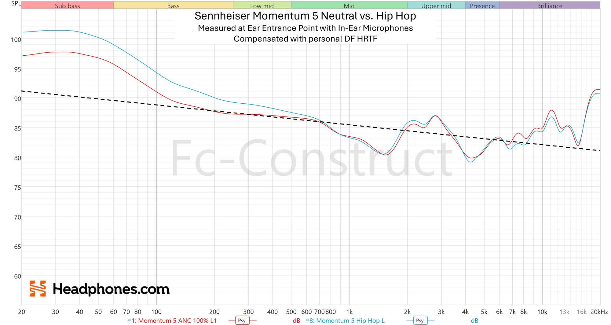

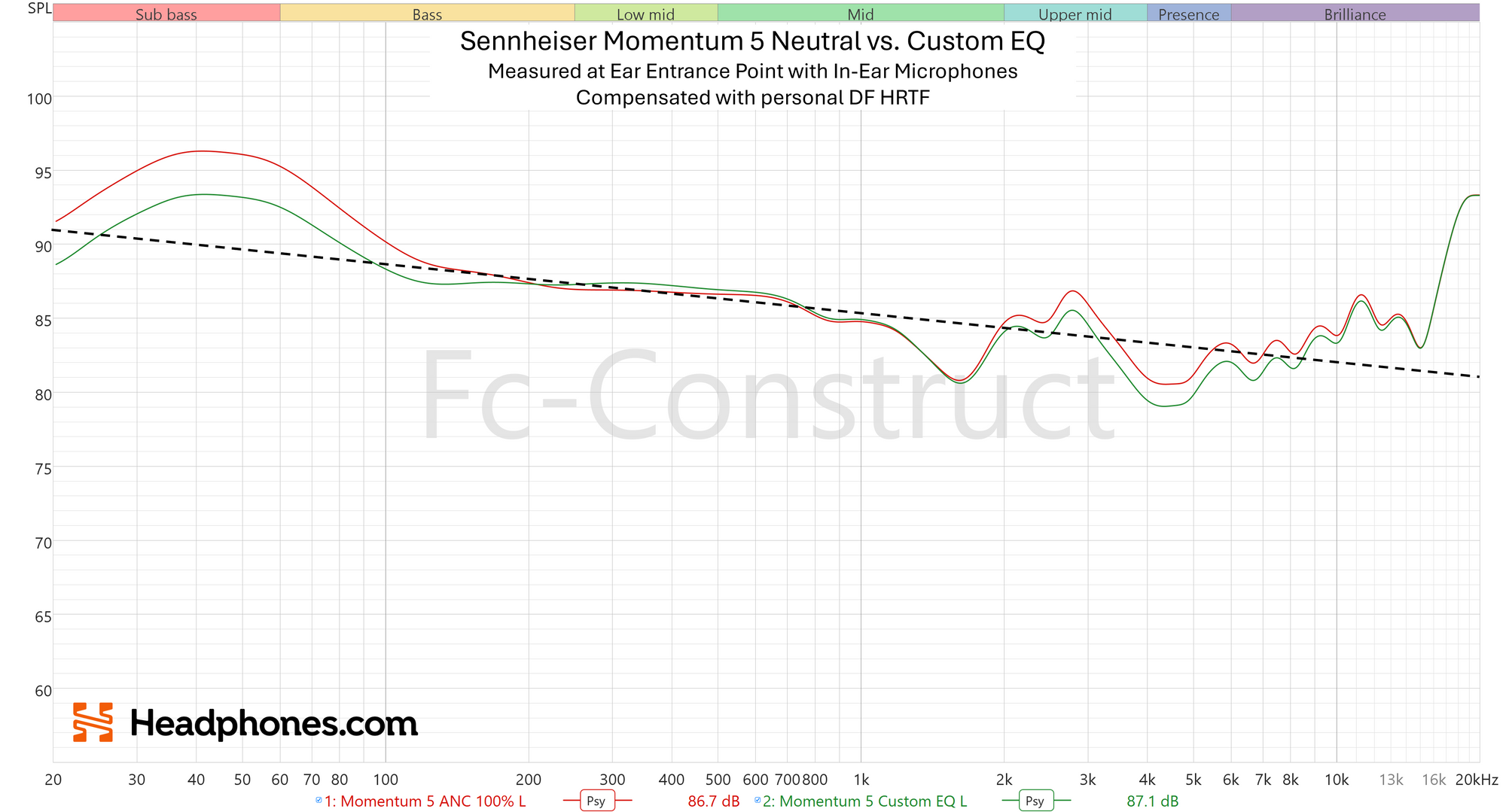

For those who are unfamiliar with graphs, here’s how you read it in extremely simplified terms. If the frequency response (the line from 20 Hz to 20 kHz) is within the grey region, it’s likely to sound balanced. If it’s above the preference bounds, that region could be described as e.g. too bassy or too bright and vice versa. Light blue and dark blue parts show the range of variation a headphone’s sound could have on a person’s head.
Preference research suggests that the average person prefers sound that is balanced with an approximate 10 dB downwards slope from the bass to the treble (i.e. within the grey region). That said, 1) You are not an average person; and 2) There’s no reason why you can’t enjoy multiple types of tunings. These graphs are a way to help us understand how these audio products may be colored relative to what the average person would consider “neutral”.

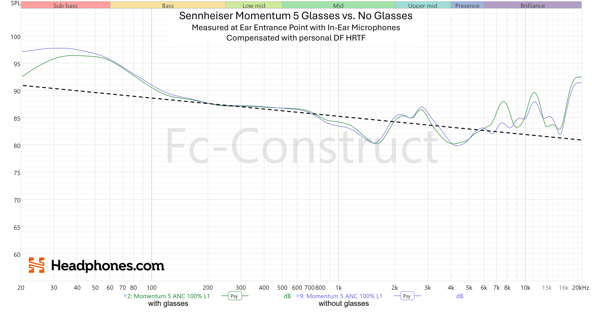

Now, I do wear glasses, so here are measurements taken with in-ear microphones calibrated specifically for me right at the ear entrance comparing the Sennheiser Momentum 5 with and without glasses on.
Essentially, this is a very good representation of how these headphones perform on my own head. Don’t read too deeply into all the tiny peaks and valleys and wibbly-wobblys. Focus on the overarching trends in how they compare relative to one another. As I talk about the sound below, I’ll be referencing this graph.

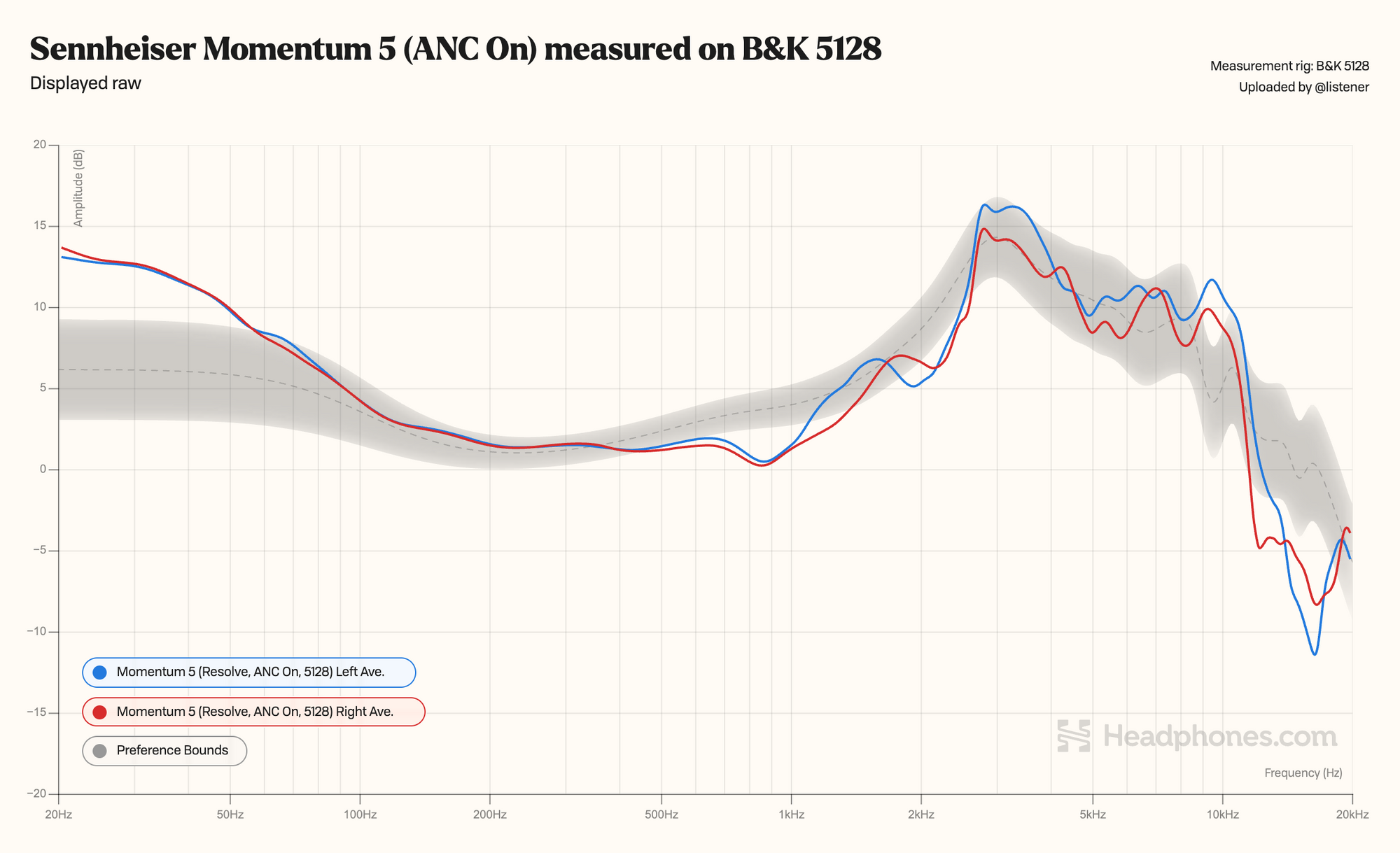

From the graphs, we can see that the Momentum 5 has a strong subbass presence below 60 Hz. On its own, it can be a good coloration for deep rumble. However, on my head when I’m wearing glasses, we can see how there is a break in the seal at the lowest octaves below 40 Hz, so there is a fair amount of roll-off which diminishes that rumble.
As a result, because of my glasses the bass isn’t quite as excessive as it may appear to look on the B&K 5128. However, I still do find the bass here to be a bit loose and boomy. Bass articulation and note dynamics are blurry. While there is physical oomph and body, it’s not a tight, deep, weighty note that lands with impact and finality. It’s more representative of bass quantity than quality.
I’d say the bass-to-mids transition is well done. I don’t really get a sense of bloat in the lower mids. It’s really that subbass/midbass area that has an extra bit of loose boominess.

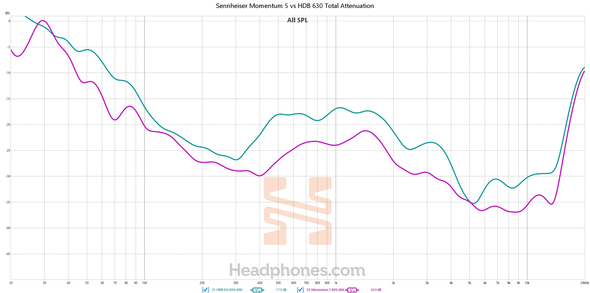

The ANC of the Momentum 5 is quite good. Or at least, it doesn’t feel like it’s significantly behind its peers like Sony, Apple, or Bose as it used to be. More crucially, I don’t get too much of that airplane cabin pressure effect like I do on some other ANC implementations. At 100% ANC, I do feel it a bit, but it’s very manageable and I don’t notice it when music is playing. I’m glad to see Sennheiser has caught up to the industry leaders when it comes to ANC.

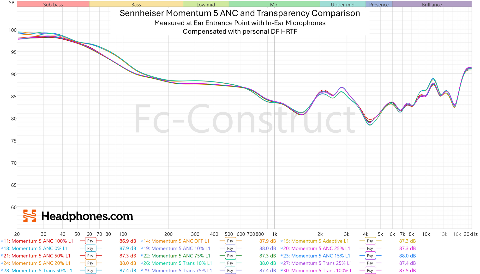

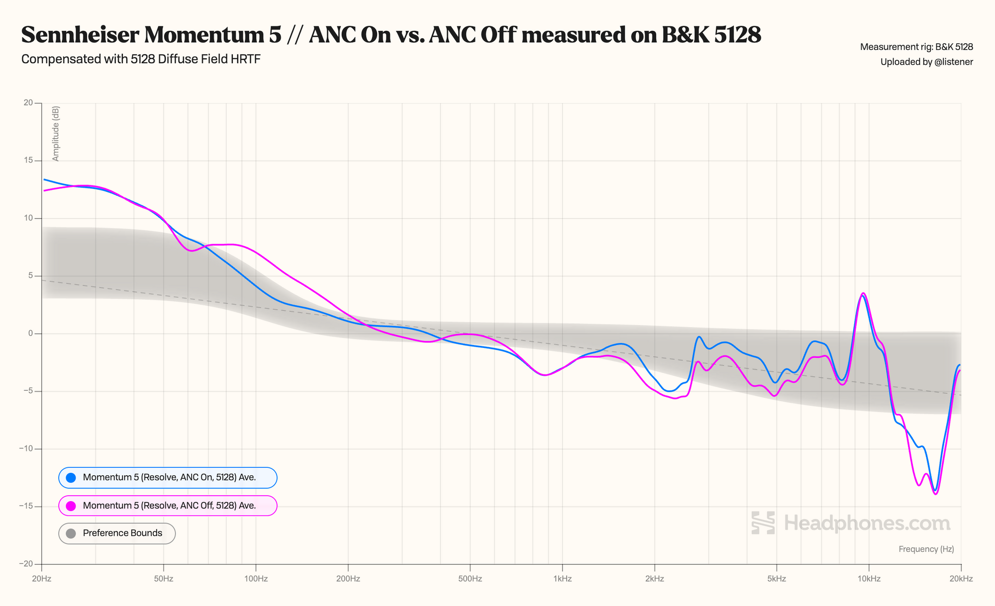

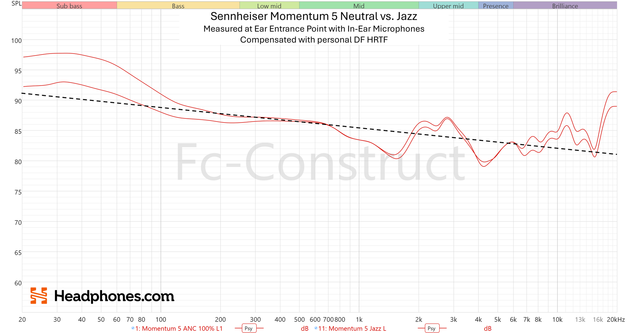

Interestingly, there seems to effectively be two base tunings depending on the setting you have. The first is what I would call the standard Neutral tuning - ANC ON at 100%. This is what I expect the majority of people to be using the majority of the time. This tuning is also the same if you’re using Adaptive mode, which is basically ANC mode but the app chooses the strength for you.
The second is the ANC OFF mode. However, this doesn’t only apply when ANC OFF. It actually appears if you are below 25% on either the ANC or Transparency mode. You can actually hear the DSP deactivate if you bring the adjustment slider low enough. Otherwise, it doesn’t matter if you’re using ANC or Transparency at 25%, 50%, 75%, or 100%. They all have the same frequency response.
The takeaway here is that you should set ANC to 25% if you want as little of it as possible while still retaining the stock tuning. Personally, I just leave ANC on at 100%. There is an interaction with the ANC turning off and that tuning that it starts to sound kind of weird. Either way, I just don’t use it.

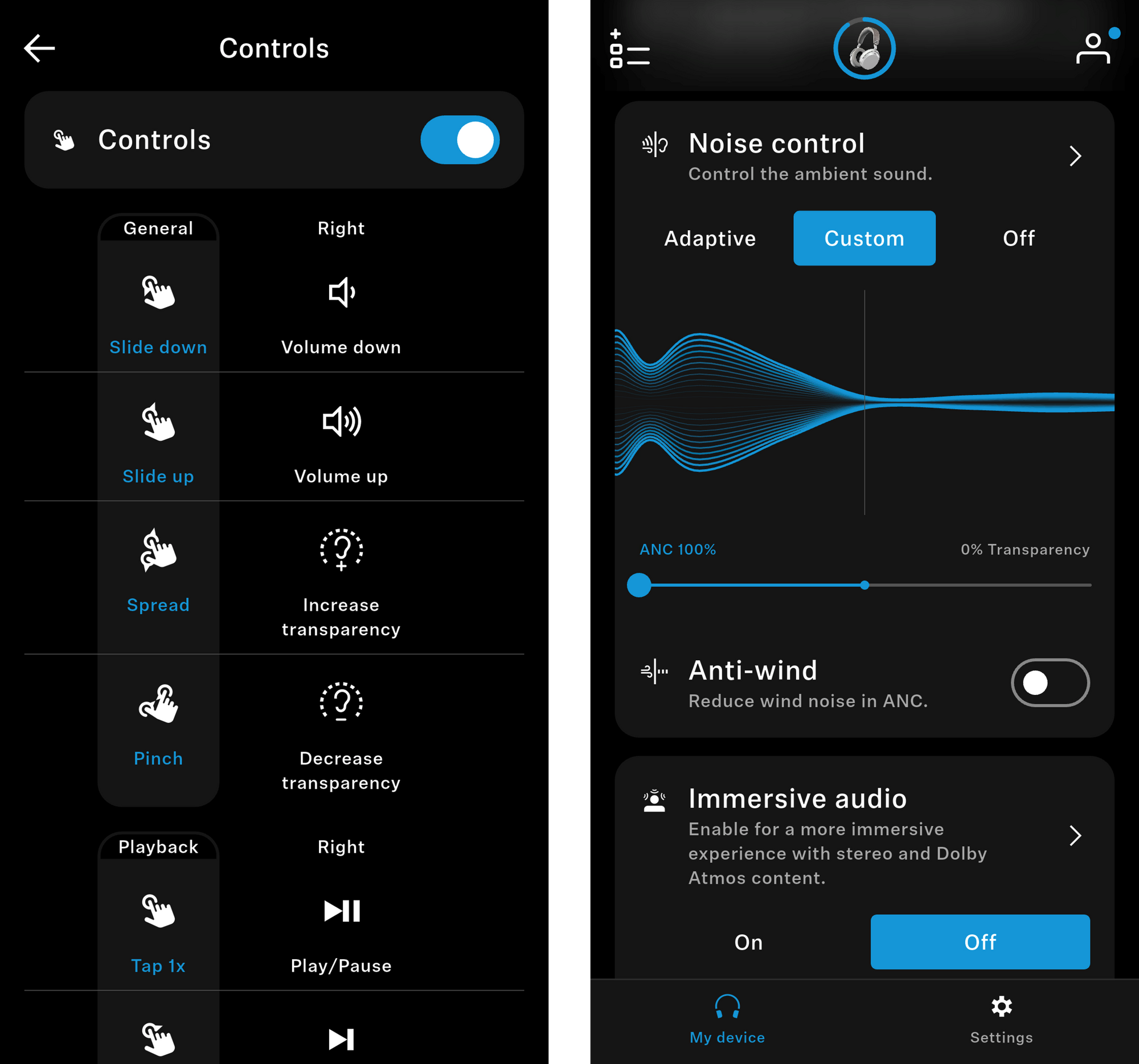

The SmartControlPlus App

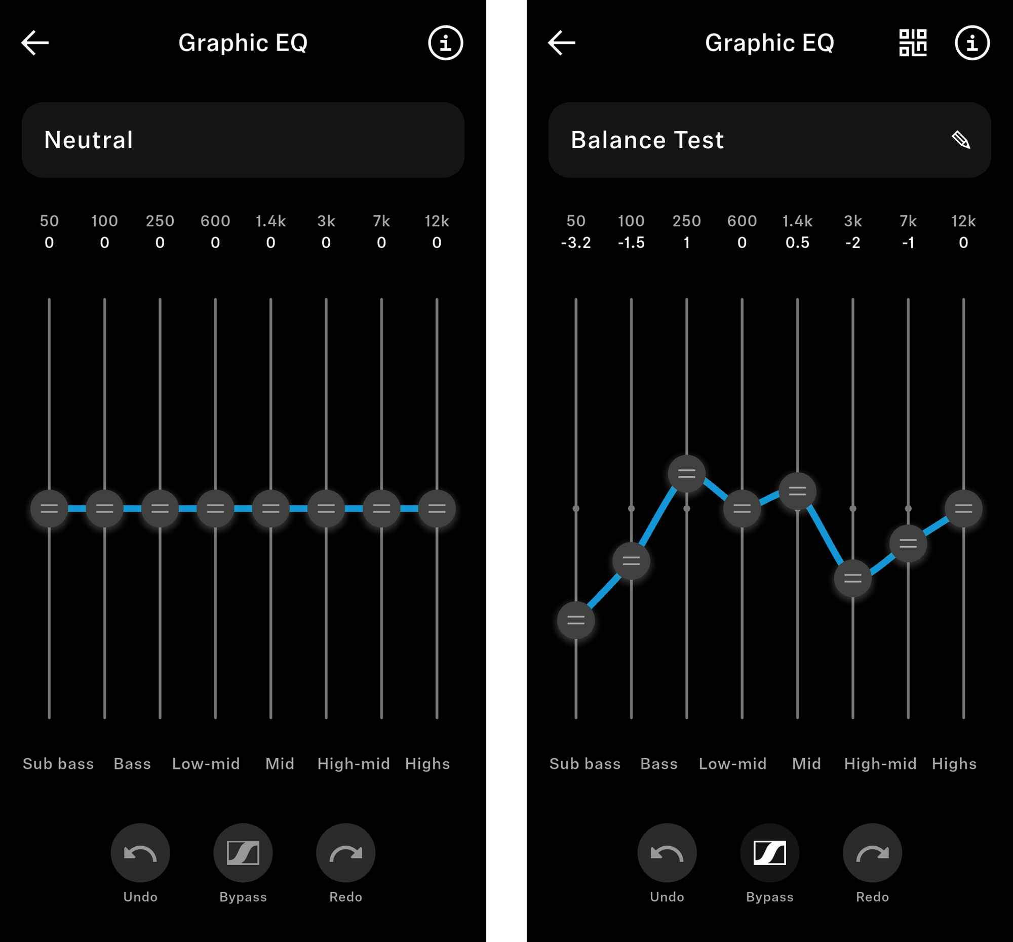

EQ
Unfortunately, the Momentum 5 does not have PEQ. This is a bit of a disappointment compared to the HDB 630 where they debuted it. Supposedly, this is a hardware challenge as you need certain chips for headphone PEQ.
Instead, we get an 8-band GEQ. The interface is slick and reactive with a very handy bypass feature. It even auto-adjusts the overall based on your settings. However, beyond the standard limitations of GEQ (no frequency or Q value adjustments), the SmartControlPlus’ EQ only allows up to +/- 6 dB of adjustment. For most, this should be sufficient.
Presets

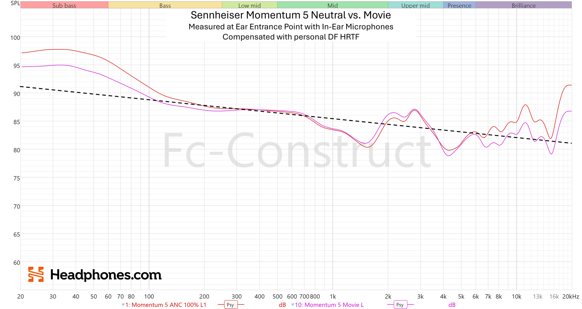

Along with the EQ, you get a wide variety of presets. These presets are actually preset EQ values designed by Sennheiser’s audio team, so you could technically recreate them yourself if you wanted or use them as a base and adjust it as a new custom preset if you want.
That’s what I did. Turns out, there is one EQ setting I thought was rather decent. That is the Movie preset. It pulls down both the bass and treble by a few decibels to hide some of the Momentum 5’s deficiencies in those areas. From there I adjusted it some more to get roughly what I thought sounded balanced.
See the Appendix for all the presets.
Sound Personalization

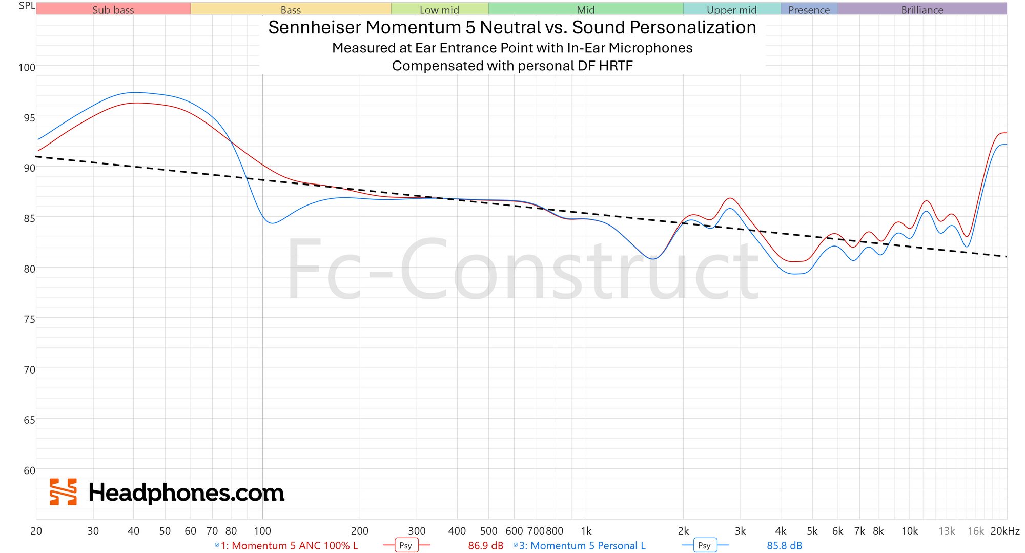

One last interesting thing that Sennheiser has in the app is the Sound Personalization program. Many companies have their own version of this. Sennheiser’s process is interesting. The app plays strings (violins), then layers on bass and then drums while you continuously choose how much volume you want of each. Here’s what I ended up with after a quick session without any fine tuning.
There are some similarities to my custom EQ where it pulls the bass and treble down. However, the way it dips the bass at 100 Hz can only be achieved with a high Q value. Which means there is a possibility of more unique Q values that we don’t have access to.
Anyway, I’d say it works OK. I prefer it a little more than the Neutral stock tuning. With some fine tuning it could be better but I decided to stick with my Movie-adjusted preset as it was good enough for me.

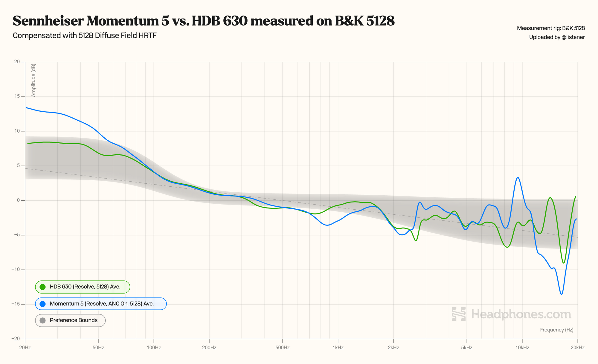

And if you could stretch your budget, look to the HDB 630. The sound out of the box is genuinely good, particularly in the bass and treble. You also unlock PEQ functionality in the app so you can really dial in the sound quality. You do sacrifice some ANC performance however.

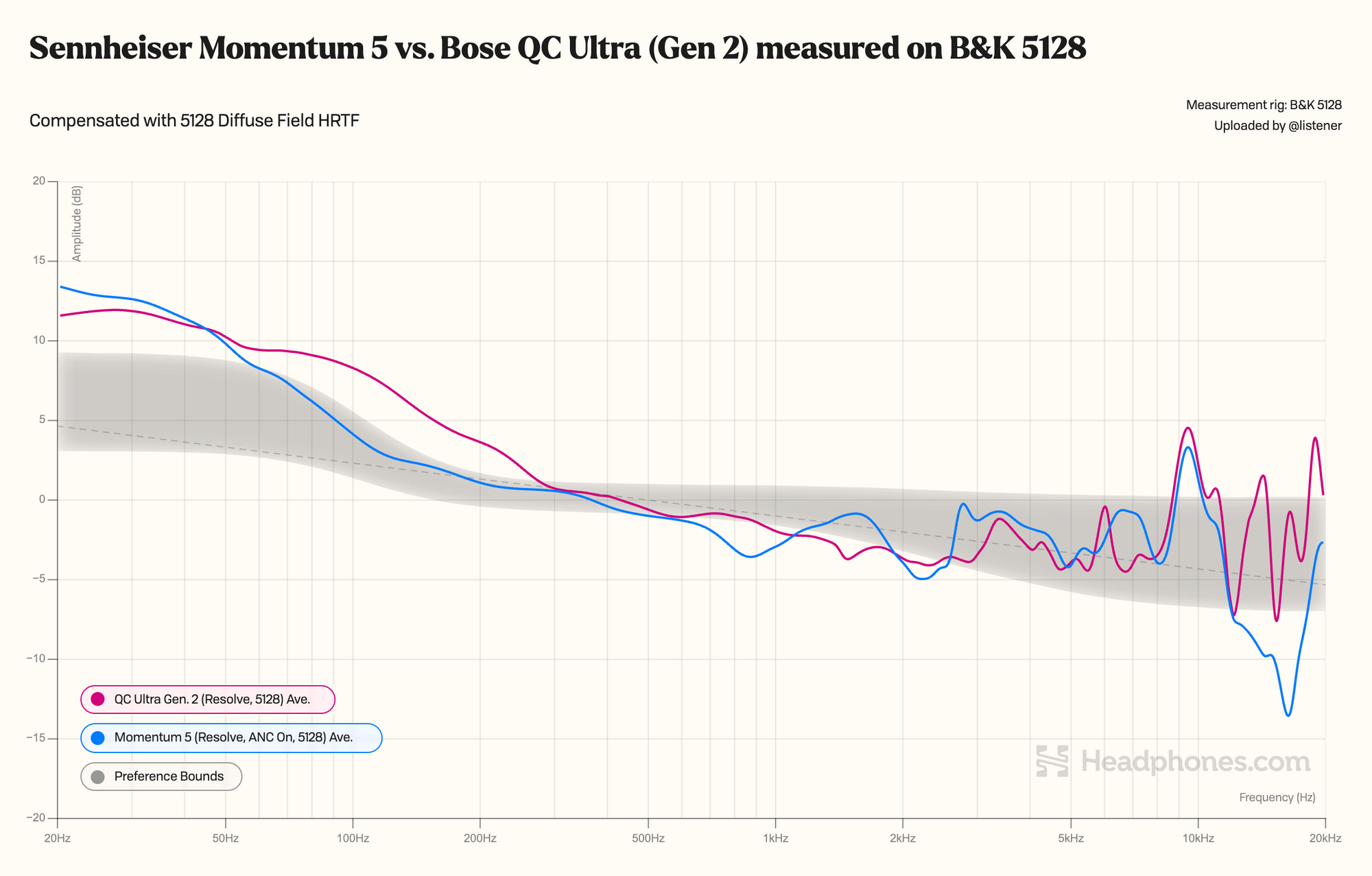

The Bose QC Ultra Gen 2 is probably the toughest competitor to the Momentum 5. It costs $50 more, but it does feel more premium all around in its build and design. Sound wise, it’s even bassier but makes up for it with a cleaner midrange. It also has a priming function to ensure better acoustic consistency in the mids every time you put it on, which is very cool.
It is limited in its customizability with only 3 bands in its EQ, however. But if all you need is a simple bass and treble adjustment or have alternate methods of EQ, then the Bose QC Ultra Gen 2 starts to become the more compelling option. Especially as it’s been out for a while and often goes on sale.
