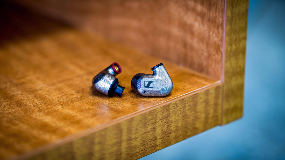

  6. The IE 600 itself, made with a 3D printed “resilient AMLOY-ZR01 amorphous metal housing”. It’s a zirconium alloy.

The acoustic design of the IE 600 is quite different from that of the IE 900. While they both have a single dynamic driver and share Sennheiser’s 7 mm TrueResponse transducer, the IE 600 uses a dual two chamber absorbers (D2CA) system instead of the IE 900’s X3R transducer system. I presume that the reason for this difference is that the 3D printed alloy nature of the IE 600 precludes the X3R system which was milled directly into the shell of the IE 900.

Ergonomics and Shell Design
The shell of the IE line-up is rather small and would look like it fits very well, being modeled after stage IEMs. The problem however is the size and angle of its nozzle relative to the body of the shell. I find it fits in at a bit of an awkward angle and isn’t quite as natural to insert as other IEMs I’ve used to. I’m not able to get it to fit in as deeply as I would like. With the IE 900 specifically, if I push it in further for a deeper fit, the milled body of the shell starts to dig in against my ear and become uncomfortable. Sometimes even painful. Some people might not have an issue with the fit, especially when trying it on quickly at a demo shop, but it’s something to be aware of.
