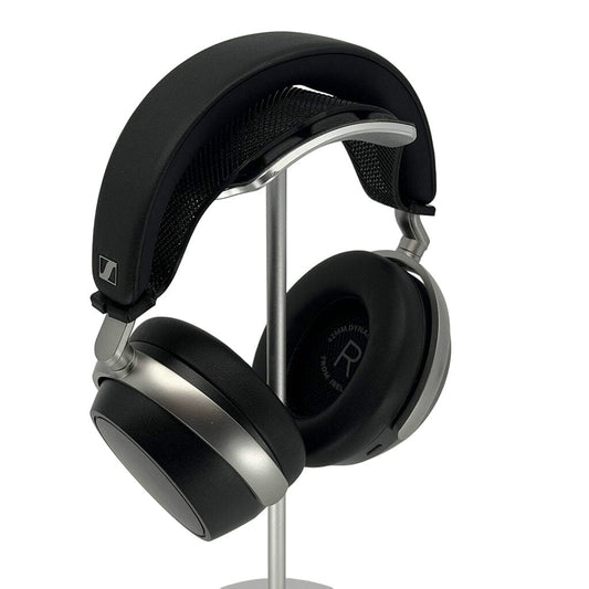

Visually, the HDB 630 strikes a clean, modern look: silver yokes, matte black shells, and a restrained, professional aesthetic. Build quality feels solid, and the headphone offers full cup swivel for portability.
Interestingly, the cup swivel actually may be too much—since even slight asymmetry when worn can affect tonal balance, it would be nice if the design were a bit more stable and consistent in how it can be worn.
Comfort—for me, at least—is improved over the Momentum 4 thanks to reduced clamp force and better weight distribution, but large-eared listeners may still find the small-ish earpad openings too tight.

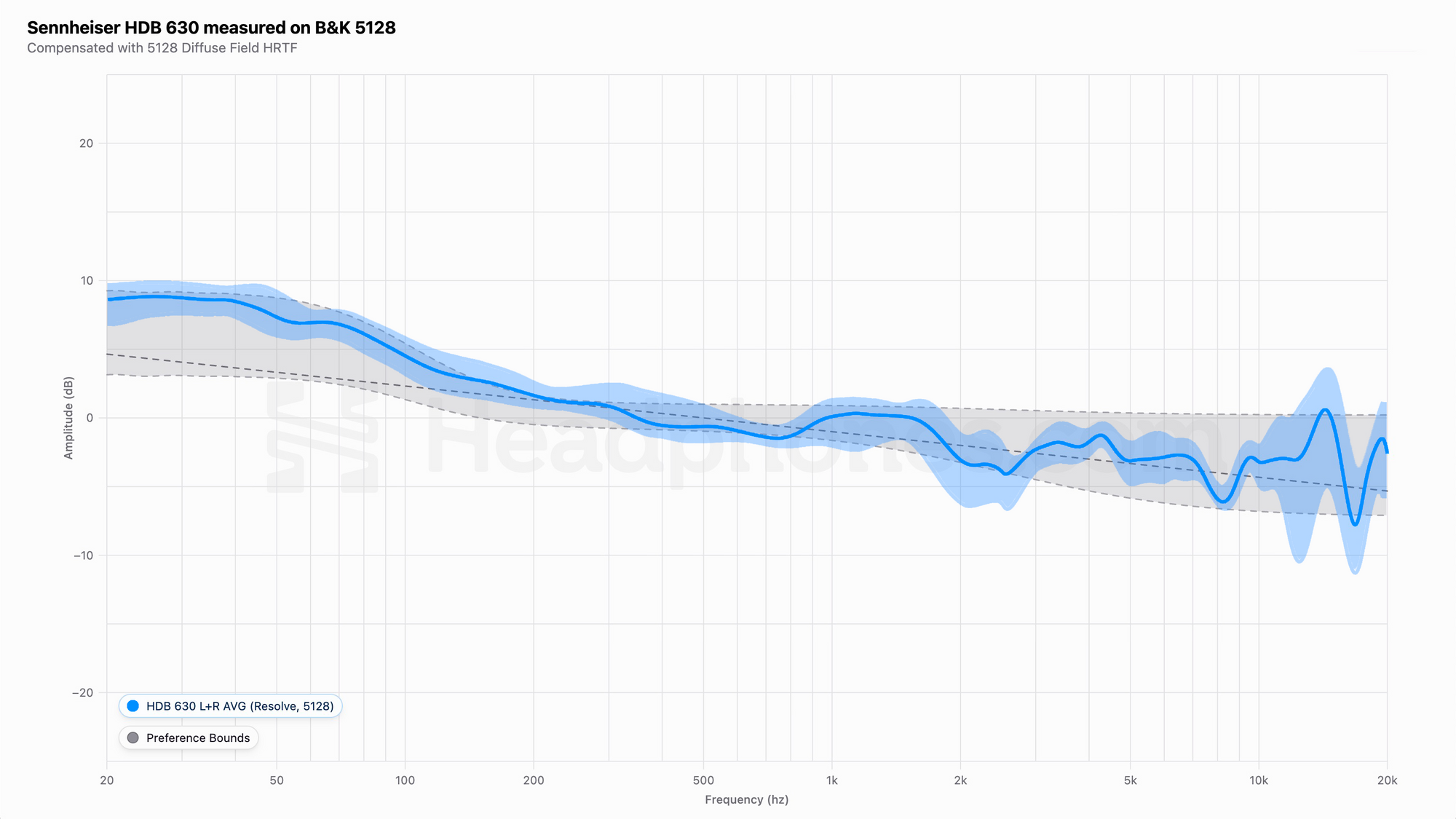

Measured on a B&K 5128, the HDB 630 shows excellent wideband balance with a few quirks.
Bass is its standout strength—tight, articulate, and physical without boom or bloat. Compared to the Momentum 4, it’s punchier, quicker, and more neutral overall. Additionally, because of the use of active feedback systems for the ANC, listeners are likely to get a very similar response under 800 Hz or so to what they see on the measurement.
The mids are generally natural, though a mild forwardness between 1-2 kHz and low-treble energy around 3-4 kHz can make vocals and snares sound slightly shouty. The former 1-2 kHz area is also prone to significant variation based on the coupling/orientation/clamp of the headphone, so people should be aware that if they want to use the included EQ in this region that adjustment by ear will be absolutely necessary; do NOT just blindly follow measurements in this region for this headphone.
Treble is where opinions are likely to diverge with any headphone, and it’s where the HDB 630 ended up disappointing me a bit. There’s a lot of upper-air “sparkle,” but a dip through the mid-treble further highlights this forwardness while also leaving the presentation a bit closed-in and stuffy feeling.
Even though this is a subtle issue within an otherwise refined tonal balance—one that may even be specifically bad for me vs. others—Sennheiser still gives users full control to fix them, by including the thing audiophiles have been asking for forever: parametric EQ.
