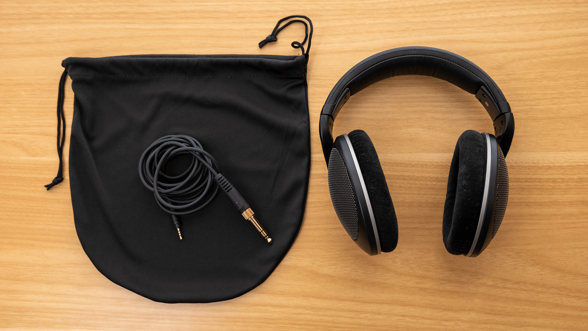

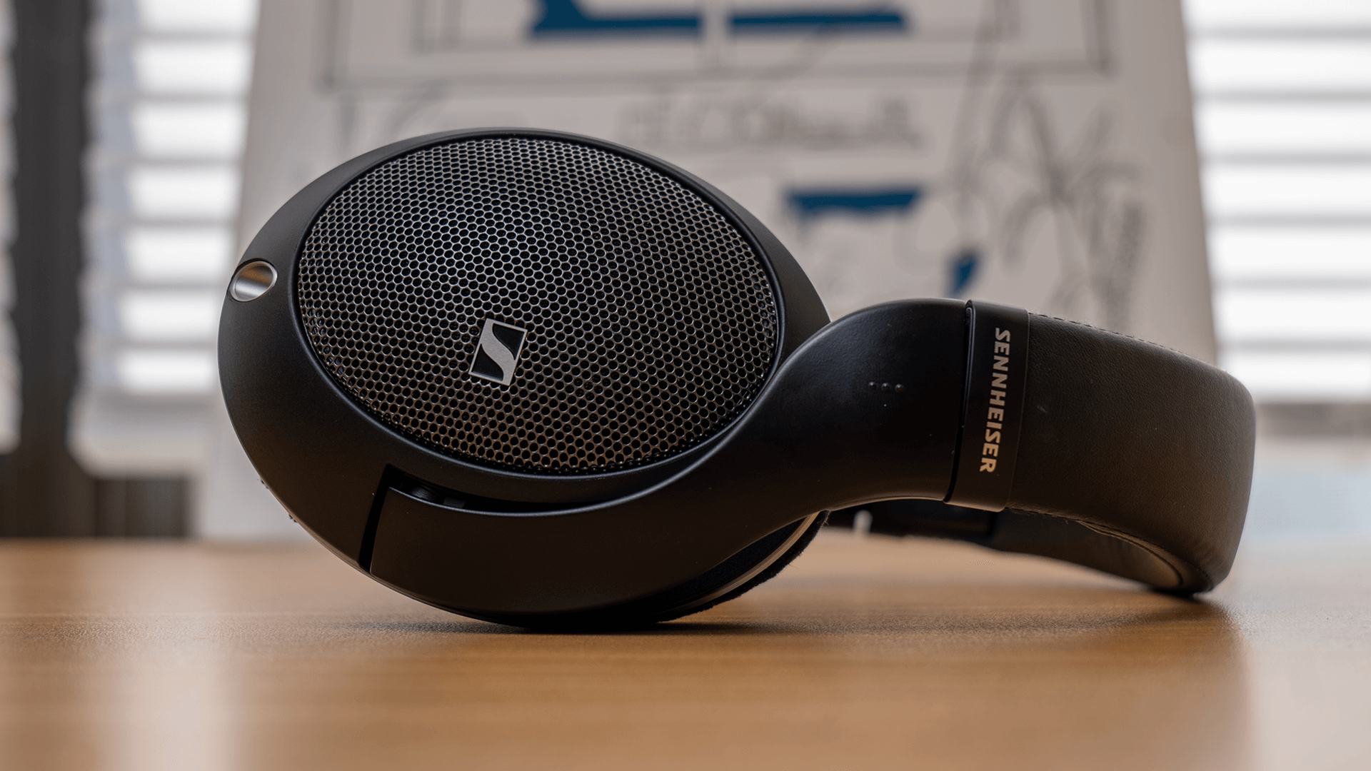

I’m going to keep this brief because the comfort and accessories are literally identical to the HD 505 that I just reviewed, so if you want all of the details, feel free to check out that review. HD 550 shares the same chassis as far as I can tell, the same pads, the same headpad, the same cable, and the same bag.
Touching on visuals, to be honest I prefer the look of the HD 505. This more muted grey and black probably works better for the people who want their headphone to be minimally distracting, but it also (partially due to the swirly single yoke design) looks much more dated and austere than the HD 505. Even if it doesn’t necessarily make me want to use it less, the HD 550’s somewhat drab visual design may well have that effect on others.

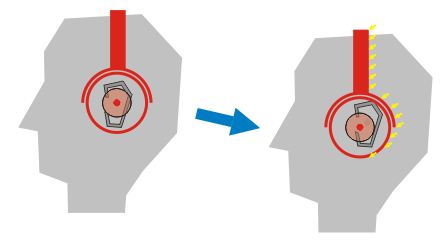

All of my notes on comfort from the HD 505 review could be pasted here with no changes, though. I actually kind of like the ear comfort of this chassis now that the clamp has been reduced, but I really dislike the headband pad. No notch in the center of the headband and insufficient padding make it among the less comfortable “lightweight” headphones I’ve tried for comfort.
I will note here that I wear the HD 550 the same way that I wear the HD 505: pushed as forward and low on my head as possible, which involves the flange of my pinna tucking underneath the backside of the earpad slightly. This has been a common recommendation for as long as I’ve been in the hobby, and it’s also how I measured the headphones to best reflect the response I may have gotten when wearing them.
Credit to Meier Audio
Unfortunately though, not everyone is going to find this position comfortable or natural, and as a result other people may get a different (likely brighter) sonic result listening to HD 550 than I get. All I can do is review the headphone as it naturally sits most comfortably on my head, so apologies to those who feel this review doesn’t accurately reflect their use condition with the headphone.
The HD 550 doesn’t do anything revolutionary here—especially given the last headphone I tested was identical in more ways than one—but it’s still an overall solid package that I think a majority of people will find eminently usable in their day-to-day listening. It’s just not as comfortable as I think it should be given how lightweight it is.

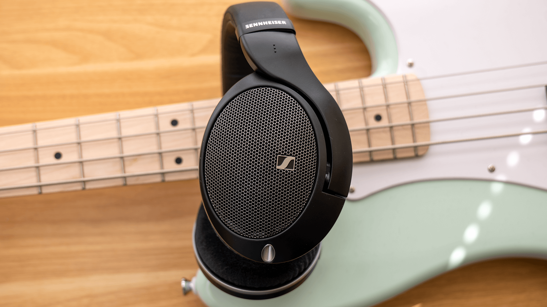

The bass extends better than most of the Sennheiser open backs I can remember testing besides maybe HD 800S, but it’s not “sub-bassy” by any stretch. It’s adequate enough for things like modern pop or electronic music to not sound like something is terribly amiss, while not being quite at the level of planar bass for how well fundamentals are represented in the bottom octave relative to their harmonics.
Because of the rolloff there’s a minor tilt towards the first harmonics of bass guitars that is noticeable as a slight puffiness, but I actually tend to prefer this approach to bass over the alternative; sub-bass emphasized considerably over mid-bass tends to sound more incoherent and sluggish to me.

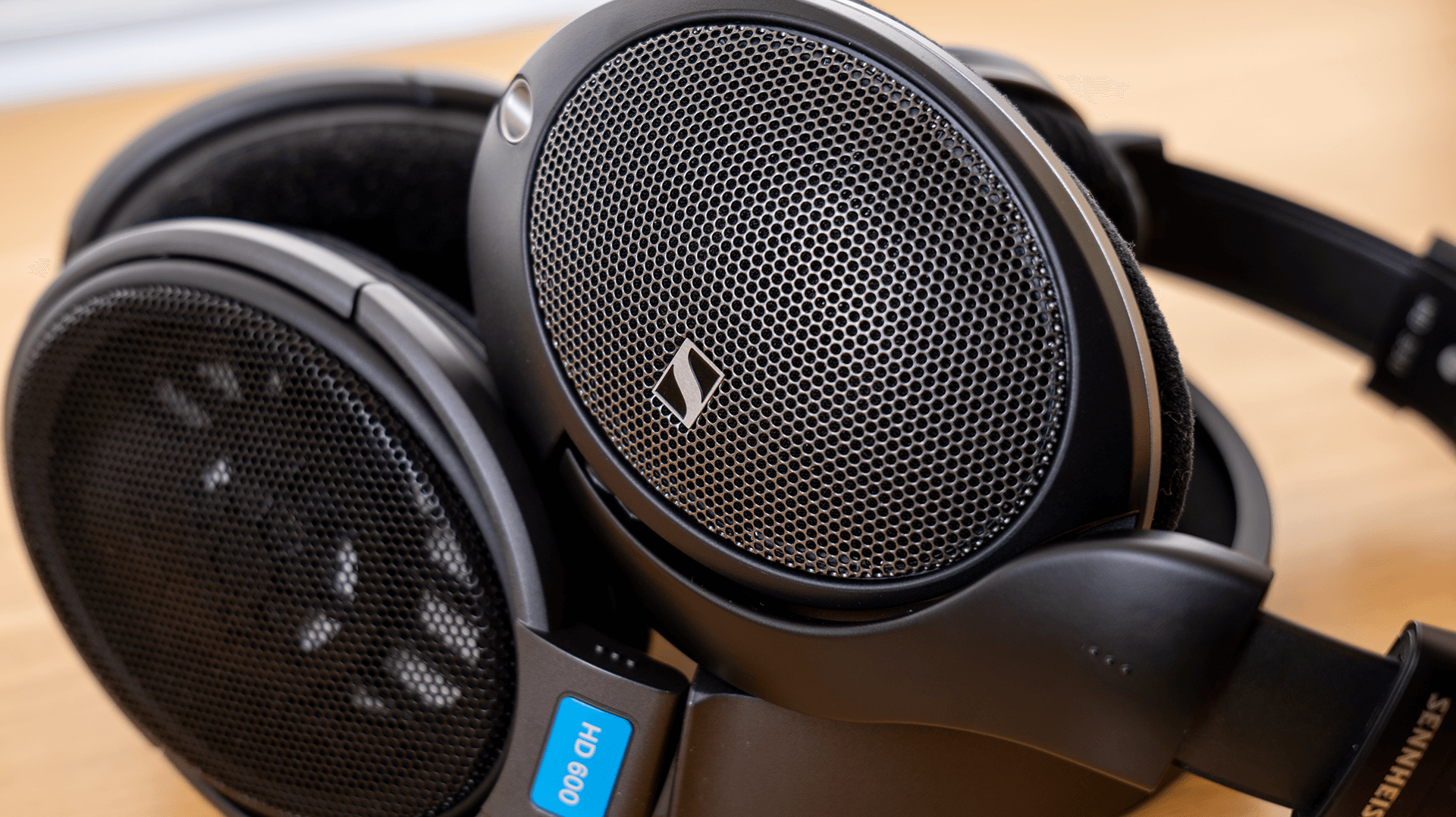

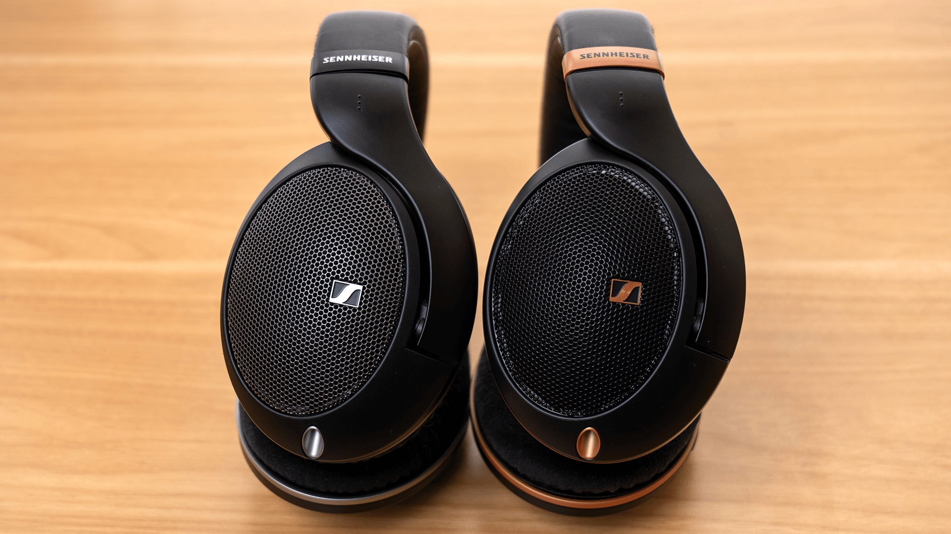

HD 550 on the left, HD 505 on the right

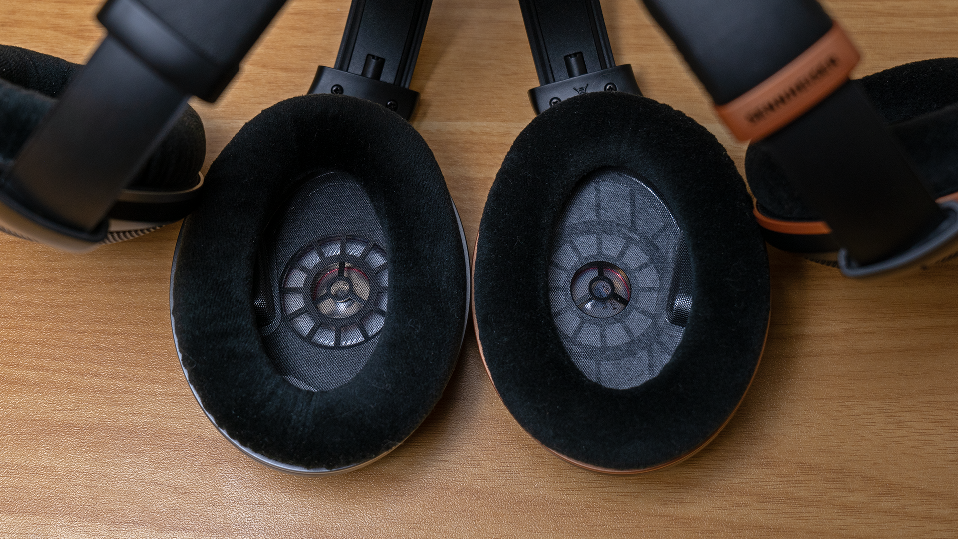

The HD 550’s baffle seems purely based on visual inspection like it may be a more restrictive / higher acoustic impedance material overall, but it also leaves more of the driver area exposed, whereas the HD 505’s baffle seems more permeable / lower acoustic impedance, while covering up a bit more of the outer circumference of the driver front.
You can’t really go too wrong with either, but I do think the HD 550 is my preference between the two since it represents a particularly well-rounded offering that is pretty hard to beat. Speaking of which…
