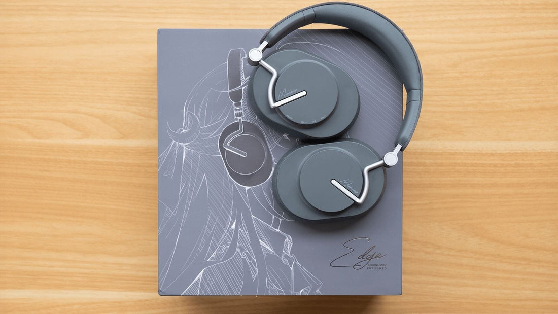

Build, Comfort, Design, and Accessories
Starting with accessories, there’s really not much of note in the box. Just the headphones, necessary charging cables, and a leatherette pouch that frankly I kinda hate. I’d never put any headphone in a thin strapless bag like this for transport, and would much rather a hard case that takes advantage of the fact that Moondrop EDGE has a decently collapsible/transportable design.
In terms of the visual design, I actually quite like the look. It reminds me of a slightly more rectangular/hard-edged take on the design language from more expensive brands like Bang & Olufson or Bowers & Wilkins. The fact that it comes in monotone grey as well as a more bright white & gold colorway is a nice touch that I frankly wish was more present on audiophile headphones. More color/aesthetic choices please!
Moving onto the build, while this does feel like a headphone that is under $100, that doesn’t necessarily mean it won’t hold up over time. It’s a very light (good) but slightly noisy (bad) design that has a bit of ricketiness and lacks minor refinement to the feeling in hand. The edges are just a bit less rounded off in certain places than I’d like, but overall it feels well enough put together for the price and it has survived being thrown into my backpack a few times without the bag.
Unfortunately the headband is a pain point regarding build, as it’s responsible for most of what I perceive as “cheapness” here. There aren’t well-defined notches for adjustment, only a soft “lock” notch of sorts at the bottom of the adjustment range and then no defined notches I can feel after that. For those who are a bit Type-A about making sure the headphone’s arms are extended symmetrically, this may prove annoying—it did for me.
On the bright side, the cups do swivel enough to lay the headphone flat on a desk or table, which does make me hate putting down the headphone on a desk or couch much less than designs where this isn’t able to be done.
Onward to comfort, the earpads are lovely and I wish more over-ear headphones took this approach to earpad design, both in size and shape. The overall comfort of this headphone kind of reminds me of the Austrian Audio Hi-x60, which people who’ve followed my reviews for a while will remember is the only good thing about that headphone. The Moondrop EDGE’s pads fit completely around my ear and leave enough room for my ear to only lightly graze the generously padded baffle.
This is different from most other headphones of its price and class that often have pads that are much too small to fit my ears inside completely, as well as much too shallow for my ear to rest in the earpad comfortably, so Moondrop deserves some points here.
In fact, they get even more points because the pads are easily removable, and ShenzhenAudio has made it clear that they intend to make replacements available. This is a big step towards ANC products like this being less “disposable,” especially so for such inexpensive headphones, so big thumbs up to Moondrop for this.
The comfort downside is that the headband isn’t quite well-padded or “wide” enough to avoid a top-of-head hotspot for me, even though this design has a considerably tight-feeling clamp force.
While clamp is often a downside for many designs, here I think it serves a function, and it actually works well: unlike many ANC headphones, I actually get a seal around the bottom of my ear/back of my jaw. I tend to be fairly clamp-tolerant since my head is on the narrower/smaller side, so while this may be a bit uncomfortable for those with larger/wider heads, this is one of the better feeling wireless ANC designs for me.
