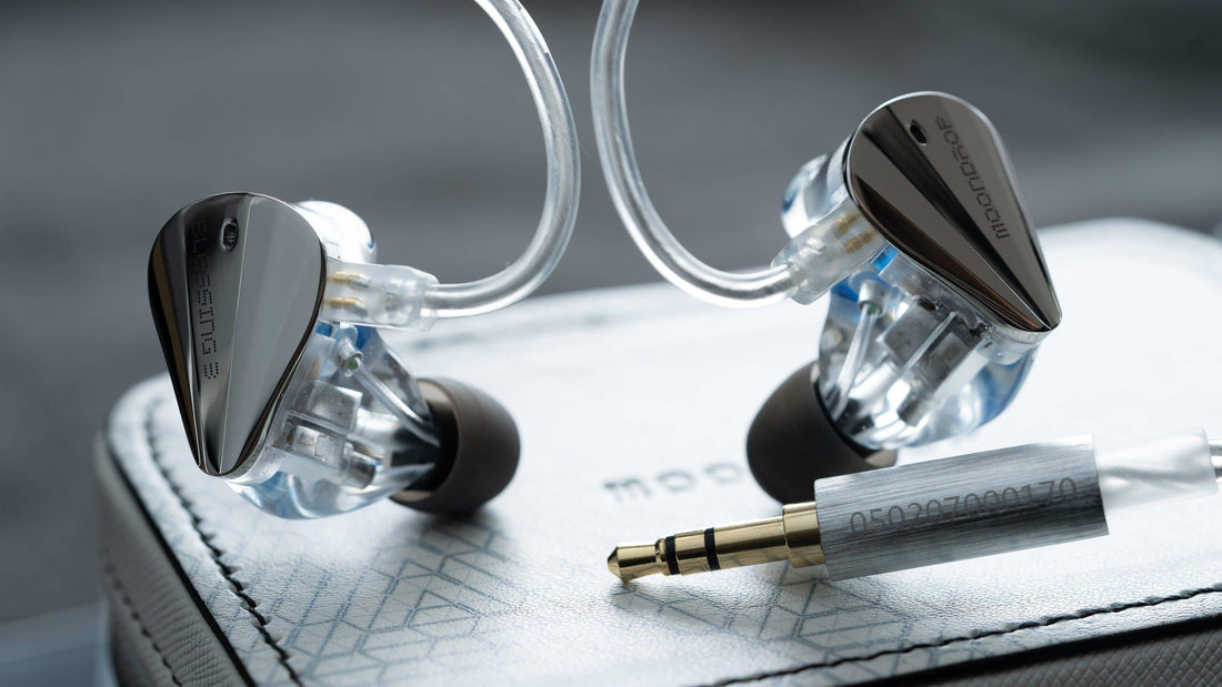

The case that comes with the Blessing 3 is similar to the Blessing 2. It’s on the slightly larger side meaning that you wouldn’t pocket it with jeans, but it might fit into a hoodie or cargo pants pocket. The case’s structure is rigid affording protection, and it opens via a zipper and inside the lid there is a mesh slot to store accessories. Overall, I’m not a fan of the aesthetic, but this case gets the job done.
Little has changed about the overall design of the Blessing 3, but it takes on a more futuristic look with added contour and polish to its stainless steel faceplate. The text font has also been superseded by something reminiscent of the Nothing Ear earphone’s font. A minor consideration is that the new faceplates will pick up finger smudges more easily. Now, something more important is the comfort of the Blessing 3. Many listeners will attest to the Blessing 2’s poor comfort; in fact, I struggled slightly with the fit too in my early days of the hobby. Most of this issue was a product of its large nozzle diameter. The Blessing 3’s nozzles are slightly slimmer which might alleviate this problem - slightly. I didn’t find much else to have changed between the IEMs ergonomically.

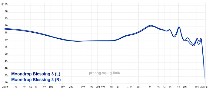

The measurements below were taken using a clone IEC-711 coupler. There is a resonance peak at 8kHz; as such, measurements after this point should not be considered entirely accurate. If you’d like to compare the Blessing 3 to hundreds of other IEMs I have measured then please see this link.
Right out the gate, the Blessing 3 makes a statement with excellent technical performance. The resolution on the Blessing 3 is excellent - and not just for $300 - with a crisp attack and a slight texture to decay. Imaging is sharp with a particular emphasis on vocals and instruments that token the lower-treble: think honing in on the position of the initial crack of a snare or a finger snap. In general, it’s clear that the Blessing 3 is a solid upgrade over the Blessing 2 in the technical department.
I see the upgrade as being predicated on a few key tuning distinctions:
  • Increased contrast in the midrange due to a thinner lower-midrange and stronger presence in the 3kHz region. This makes vocals and instruments “thinner” sounding and leaves the impression that they are in more distinct positions on the soundstage.
  • Increased energy past 10kHz. A criticism I had of the Blessing 2 was its treble, which had a “sandpaper-y” texture due to a peak at 6kHz and a lack of extension past 10kHz. As an aside, these qualities are synonymous with what many would associate as “BA” timbre. With increased treble extension, though, the Blessing 3 exhibits a stronger sense of micro-detail when it comes to the trailing end of notes in the midrange and treble.
The bass on the Blessing 3 has also seen a notable improvement. It has some more punch, some more bounce behind it due to a stronger focus on sub-bass, although some listeners might find themself longing for more “thump” in the mid-bass.
But if it sounds like case-closed for the Blessing 3 being an unequivocal upgrade to the Blessing 2, I would exercise caution. Technicalities that pop on first listen, especially in a conventional manner, often come with a (negative) kickback which I think is somewhat the case here. For context, the Blessing 2 is an IEM that I find already toes the line when it comes to its tonal balance. Make no mistake: it’s very well-tuned for $300, but it can come across a hair shouty for some listeners and, as I alluded to above, it has its share of timbre issues stemming from the treble.
Then there’s the Blessing 3 which basically cranks things to 11. The midrange is even thinner on it, to the point of which I would deem it anemic. This is less important within the context of string plucks which come across incredibly delineated, or female vocals (for which there is a reasonable subset of listeners who prefer a thinner presentation). However, it sounds like male vocalists are lacking a lot of soul to them, and I’m still not sure if I’m sold on the Blessing 3’s upper-midrange tuning. I think pulling off this magnitude of forwardness at 3kHz often requires a smoother slope off into the lower-treble. And unfortunately, as I alluded to above, the treble can run slightly hot at around 6kHz.
For my sensibilities, then, the Blessing 2 sports the more appealing tuning between the IEMs. The Blessing 2 is a tad warmer and more forgiving; it seemingly works for the majority of the music I listen to. On the other hand, I find that my listening sessions with the Blessing 3 tend to be cut shorter despite its excellent technical performance.
