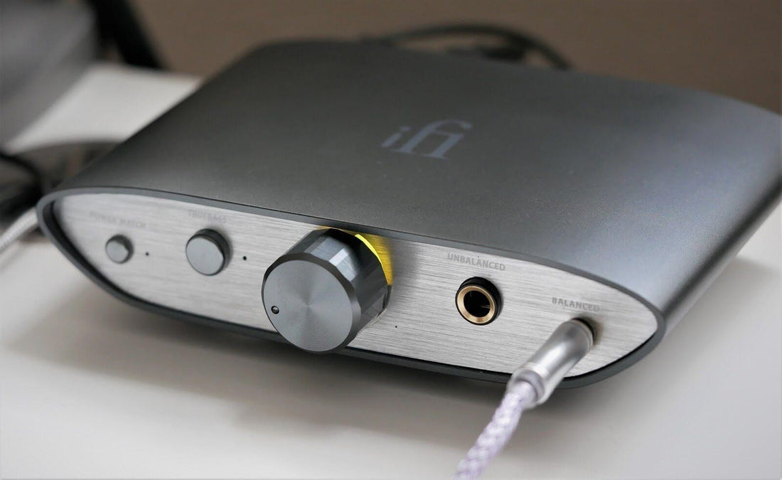

The iFi Zen DAC is a $129 Digital-to-Analog (DAC) converter and headphone amplifier that is bound to get some interest for entry-level audiophiles and people looking for a small unit to use at work or to take with them on the go. The small unit takes on a new look than previous industrial looking iFi small DAC/Amp setups, with a smooth round boat/pagoda look and dark blue metal finish.
The Zen DAC features a Burr Brown DAC that comes with two filter options, with the second option available through a firmware update available on iFi’s website. This GTO filter is the same used on iFi’s Pro DSD set, and is available for most iFi DAC units. The amp comes in both a single-ended 1/4 inch standard output, as well as the 4.4mm Pentaconn balanced output, which is not seen often on a desktop amp at this price. Most devices that feature this connector are either mid-to-high tier digital audio players or amplifier setups, so finding something at $129 is pretty nice!
Also on the front of the unit is a Power Match button which essentially toggles low and high gain, a True Bass function which adds a 10dB Bass Shelf starting around 300Hz, and a good sized analog volume knob. Behind the knob is an LED indicator light that tells the user which music type is being decoded.

The volume knob, being analog, does have a little bit of channel mismatch at the very lowest turn. This is pretty normal for an analog volume control, and this goes away at about 7 o’clock on the dial. Turning the knob is easy and works very well.
I elected to add taller feet at the bottom of the my device to give me more room to turn the volume controls and just lifting it off the table for aesthetics. The buttons have a solid click when you press them in, as does the 1/4 and 4.4mm jacks.
