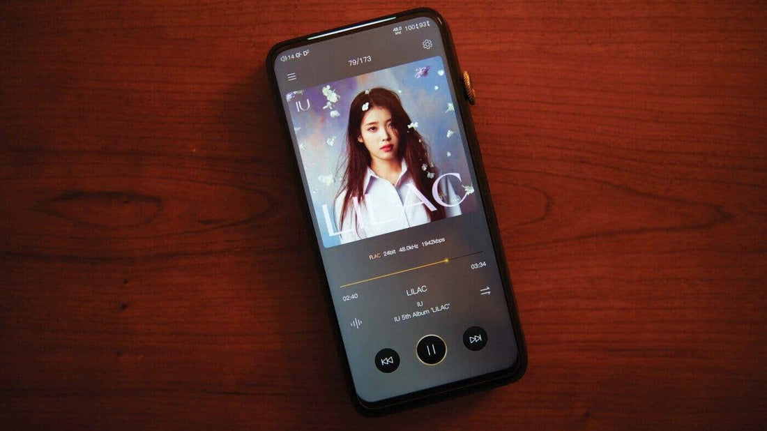

The DX320 is a beefy DAP, clocking in at 162mm x 77mm x 17mm and 300 grams. For reference, that’s my iPhone X stacked twice over and with a larger screen to boot! Luckily, there’s some added benefits, namely the screen. The screen to body ratio on the DX300 bests even a lot of smartphones I’ve seen. Just think about it: All of your album artwork in juicy, high-definition and an easy-on-the-eyes display that, unlike most other DAPs, doesn’t make it feel like you’re wearing gloves while navigating. I can certainly get on board with that, and the DX320's screen colors are noticeably more vivid than the DX300's which actually look washed-out by comparison. At the top of the screen, you also have a cool LED strip that shows when music is playing and when the DAP is charging.
Other hardware features include, on the right side of the DAP, a silver, metal volume knob (which also controls on/off) and three thin, rectangular buttons for pause/play and moving the track forward/backward. The knob is of high quality with zero play; there are slight ridges for catching your finger and it presents a pleasant tactile feedback. To the left, you have a single slot for a Micro-SD card. At the top, you have a USB-C charging port and Coaxial 3.5mm input. At bottom, there are ports for 2.5mm, 3.5mm, and 4.4mm, so you’re covered in all the most common terminations. Finally, the build quality of the DX320 itself is, of course, excellent and inspires a sense of confidence in-hand.
