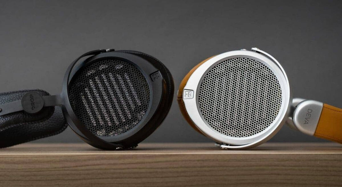

To begin with, let's get the obvious out of the way - the HE5XX and the Deva use a different color scheme and have a different headband. For me, I find the Deva's headband more comfortable, but I like the look of the HE5XX more. The real question we're here to answer is whether or not we should expect these headphones to be acoustically identical to one another, and for all of the rest of the housing structure, cup and yoke design, visually they're identical.
For the sonically relevant question - whether or not we should expect them to sound the same - let's take a look at how the HE5XX and the Deva measure for their frequency response. While frequency response isn't everything, this will give us a good indication as to whether they have a similar or indeed identical tonal balance.Ā The following is how both the HiFiMAN HE5XX and the wired HiFiMAN Deva measure on the GRAS 43AG standardized measurement rig relative to the combined Harman target curve (Harman 2013 bass but Harman 2018 mids and treble).
