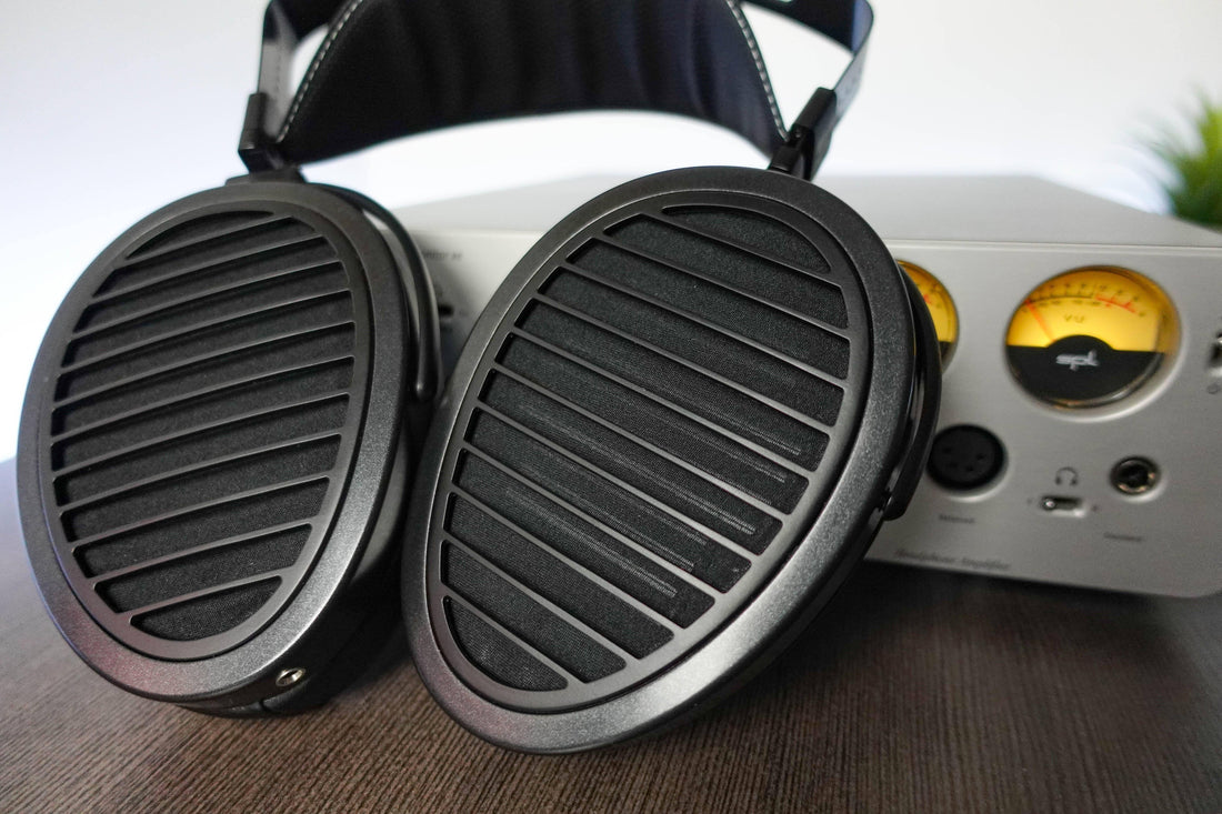

As mentioned earlier, the Arya’s design is based off that of the HE1000v2, with the same suspension-style headband system, and the unmistakable, HiFiMan elongated ovoid ear cup shape–albeit in all-black finish.
The Arya, for me personally, doesn’t particularly feel or look like the most premium headphone out there, especially when compared to others in its price bracket like the highly-refined Focal Clear, tank-built LCD-X, or precision-designed HD 800 S. Nonetheless, I feel like the construction that HiFiMan used here is a very practical and rugged one that’s been reinforced compared to older models and should not fall apart or easily deteriorate under the stress of extensive, daily use.
For comfort, I think that the Arya is one of the most comfortable headphones I’ve personally tried. Despite their large form factor and full-size planar magnetic array, the Arya is remarkably light 404g, which keeps them from becoming fatiguing or tough to wear in prolonged listening sessions. As you’d expect from the giant ear cups, they provide a lot of room for your wears to fit in, as the pads are deep, angled and they provide plenty space in their inner diameter. Additionally, because it’s using the HE1000-style headband, the Arya distributes weight very nicely and has ear cup swivel; a feature that was somehow absent on the Sundara and Ananda. If I have any complaints for comfort, though, it’s that the ear cups, because of their size, occasionally feel like they reach a little too far down and put a bit of pressure on my jaw. By no means does this apply a painful amount of pressure, but it can apply enough to make it noticeable and a bit distracting. One last thing I should note is that the sports-clothing-like mesh used on the pads might irritate some users, particularly those with facial hair.
