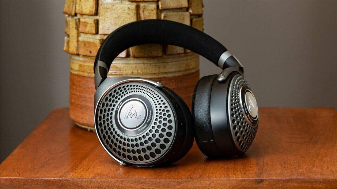

With the release of their first wireless ANC headphone, the Bathys, Focal seeks to bring the high end sound quality they're known for to the ANC domain.
Focal Bathys demo unit provided by Focal for evaluation.

When it comes to comfort, I think those who aren't used to full-sized high end headphones may still find the Bathys to be a bit bulky, but I suppose the Airpods Max is already in that territory as well. So if you found that to be acceptable, the Bathys will likely be just fine. I did find there to be a bit of clamp for my large audiophile head, but it was also less clampy than Focal's passive closed-back headphones, partly due to the changed headband design.
The Bathys pads are also some of the nicest feeling pads on any headphone I've come across, and the foam deformation is highly compliant, taking the brunt of the clamp pressure and conforming nicely to the side of the head. The thing to consider there is that because of how sound varies significantly based on coupling, you want to make sure the wearing situation is even on both sides to get it to sound right.
