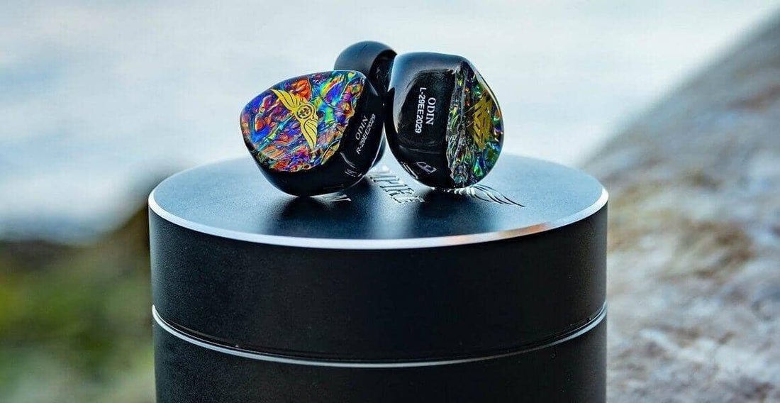

The Empire Ears Odin uses their typical Acrylic shell design, which I personally like a lot. This isn’t something that’s going to show chips over time like certain other painted IEM shell designs. I also find the Odin to be quite comfortable as a result. There are no jagged edges or anything to create issues with the outer ear, and while the nozzle is slightly on the larger side I don’t have any issues getting a good fit and seal.
For aesthetics, the Odin is admittedly a bit much for my taste. It’s extremely eye-catching, and I generally prefer a more understated look. I suspect the aesthetic design was inspired by Norse mythology in keeping with its namesake ‘Odin’, revealing the multi-colored blending of the colors of the Bifrost. Keeping in mind that IEMs are also used portably out in public, maybe there will be those of us who really love the flashy look, and this could serve as ear jewelry as well.
For accessories, you get a hard carrying case - which I typically find to be a bit big and heavy to carry around. I much prefer softer cases, but I imagine it will be well-protected. The Odin also comes with a number of tips of different sizes, and I find these to generally work quite well. You won’t have to worry about getting aftermarket tips, comfortable and easy to get a good fit. The Odin’s cable has a 2.5mm termination, and uses the 2-pin style connectors. It’s lightweight, tangle free, looks and feels great, and it’s not microphonic. My only criticism is that the splitter is a bit on the large side, looking a bit like an old timey bolo tie.
