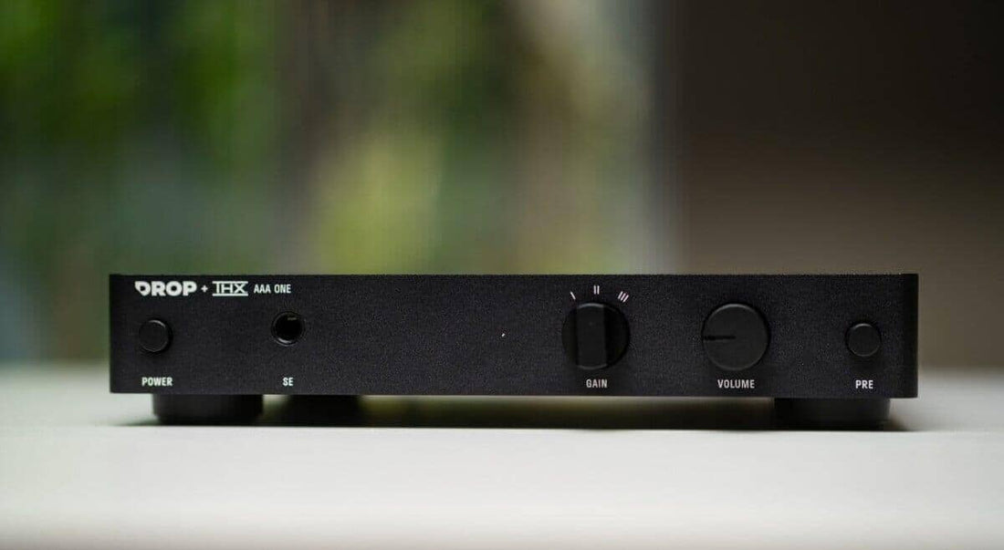

The $200 Drop + THX AAA One comes hot on the heels of the very popular THX 789, that many listeners have enjoyed over the past several years as a reference style balanced amplifier. In fact, the 789 was so popular that used prices started to get dramatically inflated, simply due to lack of supply and increased demand. Drop has since done additional runs and even reduced the price to keep up with the competition for this style of amplifier, now coming it at a mere $299.
But, there are still a number of listeners who have no use for the massive 6W the 789 has on tap, nor do they have need for its balanced output. For the majority of headphones, this is an absurd amount of power output. Couple this with headphones getting more and more efficient these days, and for many there really hasn’t been much reason to look into any of the THX AAA amps… until now.
What It Is
The Drop X THX AAA One is a $200 single ended linear headphone amplifier. This is essentially the little brother of the well known, more expensive THX 789, which is a balanced amplifier. In general, this is a good thing, since it uses the same AAA topology, which promises ultra low intermodulation and crossover distortion. Specs aside, the THX AAA One has three gain stages, -12, 0 and +12, making it extremely versatile for both full-sized headphones that take some power (2.7W @ 32 Ohms), and highly sensitive IEMs like the Campfire Andromeda. Moreover, the THX AAA One has a low output impedance of less than 0.1 ohms, meaning that for the Andromeda, or other output impedance dependent headphones and IEMs, the THX AAA One won’t change the frequency response. Lastly, the One also has preamp functionality on the back that can be used for speakers or other parts of a system.

The One uses an aluminum chassis, and feels reasonably sturdy and well-built - apart from its somewhat cheap feeling buttons. The gain switch and volume knob feels comfortable to use, however, and I have no complaints about the general useability of the amp. There are rubber feet on the bottom of the amp as well, meaning that it’s not going to scratch something underneath it.
For look and feel, the One has the same kind of no-nonsense design that the 789 has, just slightly slimmer. Personally, I like this design. It’s sleek, professional, and my favorite kind of ‘extra regular’. It may lack a bit of flare or contours that others may be after, but this kind of non-flashy aesthetic works well with my general lack of personality, so I’m into it. No distractions from the music or the task at hand!
My main complaint about the form factor is that compared to other budget amplifiers, the One’s footprint is a bit on the large side. Now, for me it’s not a problem, but I can imagine for those who are space constrained on their desks, the One would be a less attractive option. For anyone wondering, the chassis dimensions are roughly 8.5” x 8.5” x 1.3”.
As mentioned, the THX AAA One doesn’t get hot at all - meaning if you live in a hotter environment, you won’t have to worry about extra heat generated from your source. I typically can’t use my Cayin IHA-6 in the summer because it gets way too hot. Moreover, I can’t use it at the bottom of a stack because of the heat output. With the One, this is again something you don’t have to worry about - and it fits in a stack quite well.
