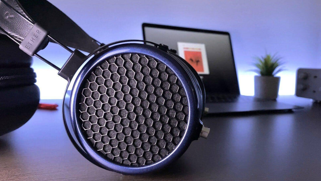

It was not too long that I had the opportunity to spend some time with Dan Clark Audio’s AEON 2 headphones, of which build really impressed me. With their lightweight, compact build, AEON 2 challenged my view of planar-magnetic headphone designs, which I traditionally associated with being bulky and heavy; thankfully, a similar design philosophy can be observed on the Ether Flow 1.1.
Dan Clark Audio Ether Flow 1.1
The Ether Flow 1.1 features a blend of materials resulting in a build that feels very sturdy, premium, and remarkably lightweight for a full-size planar-magnetic headphone. Aside from the yokes having just a little flex to them, I really struggle to flaw the build and design on the Ether Flow 1.1-- it really is phenomenal. Comfort, similarly, is a standout feature of this design, and I think it may just be the most comfortable headphone I have personally ever worn.
The pads feature an unusual, rectangle design, but they are extremely spacious and never made my ears come in contact with the driver or inner sides of the pad itself. Additionally, the already-low weight is distributed very well by the headband’s suspension straps and ear cups, making these very easy to wear for day-long listening sessions. Altogether, I think it is safe to say that if comfort is your priority, then the Ether Flow 1.1 is a great option for you.
