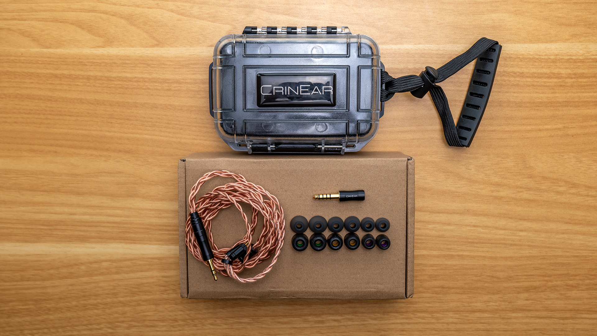

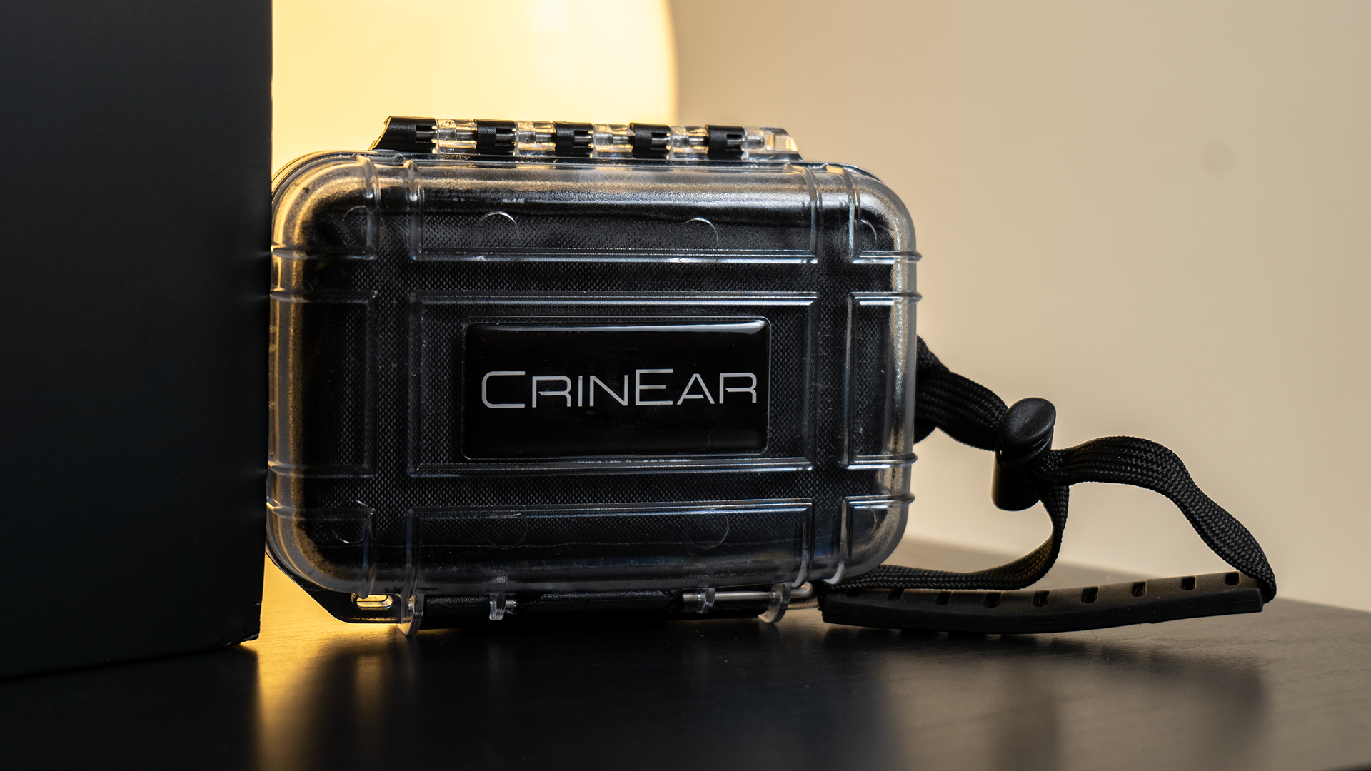

Starting with accessories, the Project META comes with a Pelican-type case, 4W braided cable with swappable 3.5mm TRS stereo and 4.4mm TRRRS Pentaconn terminations, two types of eartips, and the IEM earpieces themselves.
Touching on the case first, it’s exactly the same case that comes with the Hisenior Mega5EST but without the “custom” foam cutout inside for the IEM earpieces and cable. I actually greatly prefer the spaciousness of the case that comes with the META, as it means I don’t have to be quite as perfect with my cable wrapping/placement to fit into the cavity.
I quite like this case, but it must be said that it isn’t pocketable at all due to the size. Thankfully I’m almost never holding IEMs in my pockets, instead opting to put them in a sling bag I usually keep on my person, and for that this case is excellent, among my favorites of IEMs I’ve reviewed.

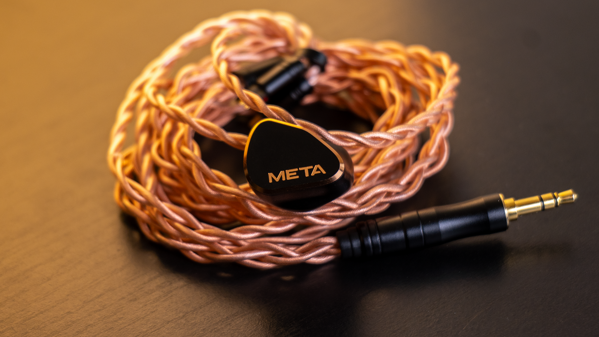

I also quite like the included cable, as it’s an appropriate length, decently (though not incredibly) soft and compliant, and not especially microphonic. Additionally, it coheres visually very well with the shell design such that the cable and IEM together look like an exceptionally pretty pairing. The swappable terminations also work with much less fuss than other modular cables that require threading to attach/swap, however I do worry about the fit stability/longevity for the terminals since they’re friction-fit only and may wear over time.

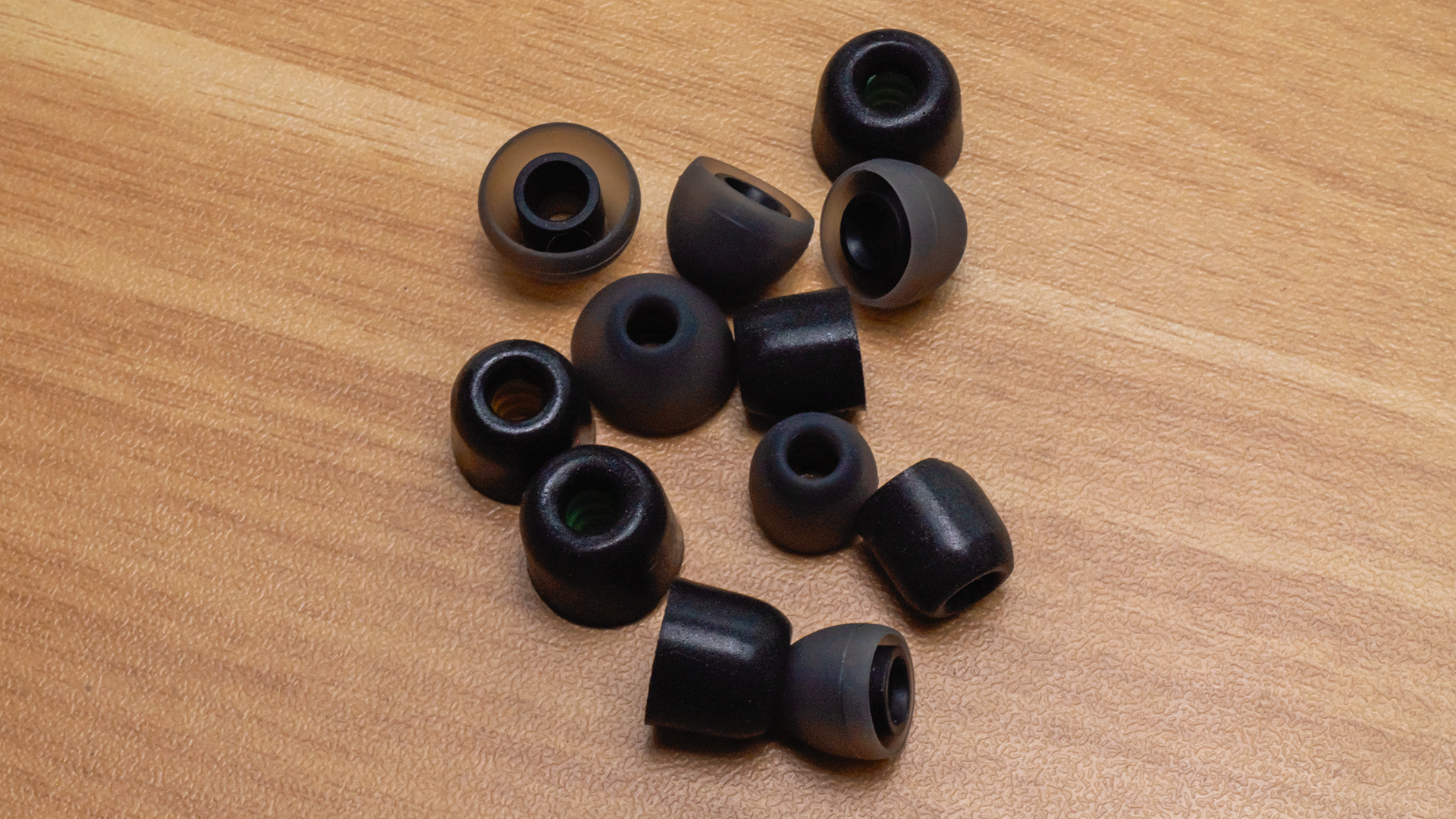

The one thing I don’t love about this accessories package is the lack of another type of silicone eartip, as Project META only comes with one type of silicone eartip and one type of foam eartip. In my last review of the Zero: BLUE 2 I lamented this exact same choice: I wish the IEM came with at least one other silicone eartip of different construction, either with a shorter core, wider bore size, or both.
This is because eartips can significantly affect both sound quality and comfort. Because I hate foam tips and the silicone tips weren’t ideal for me (sonically or ergonomically), I had to try all of my other aftermarket eartip options to get a result I felt better about, which ended up being a very similar tip to the included black/grey silicone tip, but with a shorter core which allowed for deeper insert and more snug fit.

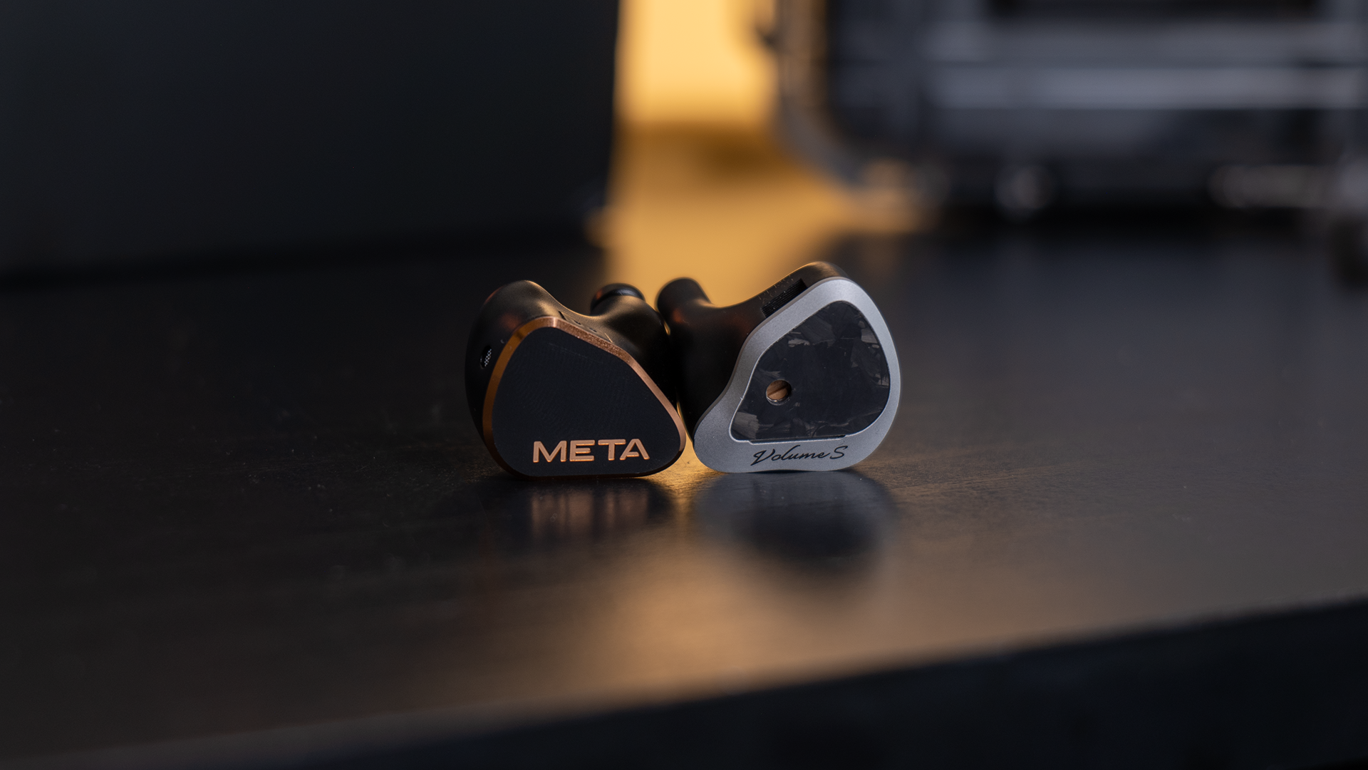

Vs. Softears Volume S
Right away I should make it clear, in terms of midrange performance Project META eats Volume S for breakfast. It’s a much more natural sound on vocals especially, and it’s immediately apparent.
However, that doesn’t mean it’s overall better. In fact, I’d take Volume S over META handily, and honestly doing this review has really served as a good reminder of just how important bass and treble level are for an overall judgment of preference.
While Project META has a more linear midrange, it still sounds considerably less coherent and well-integrated than the Volume S does for me. As far as I can tell, this is because the Volume S doesn’t have the same scoop between upper bass and low midrange causing the disjointed behavior, and importantly doesn’t have nearly the magnitude of treble elevation.
