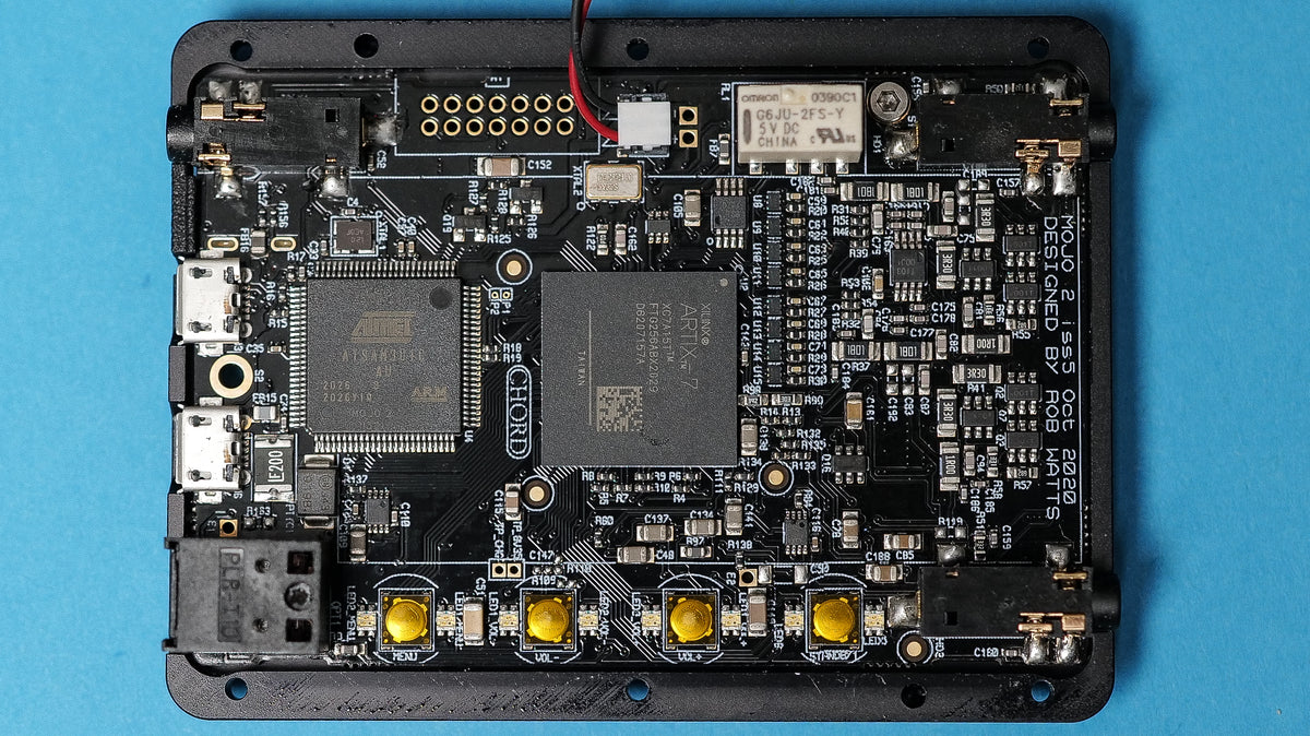

The inside of the Mojo 2 shows an impressive amount of compute power for such a small device, with an ATSAM3U1C microcontroller and an ARTIX-7 FPGA.
The microcontroller is likely acting as the USB receiver, with the ARTIX-7 FPGA handling the oversampling and DSP functionality, as well as controlling the pulse array converter itself, which can be seen just to the right of the FPGA. This is what is outputting the analog signal, it does not come directly from the FPGA.
This pulse array then feeds the output stage nested between the two 3.5mm jacks. It’s a common misconception that Chord DACs don’t have an output stage, this is not the case.
The engineer behind Chord’s DAC designs, Rob Watts, tried to keep as few components in the signal path as possible, but they do indeed have an output stage.

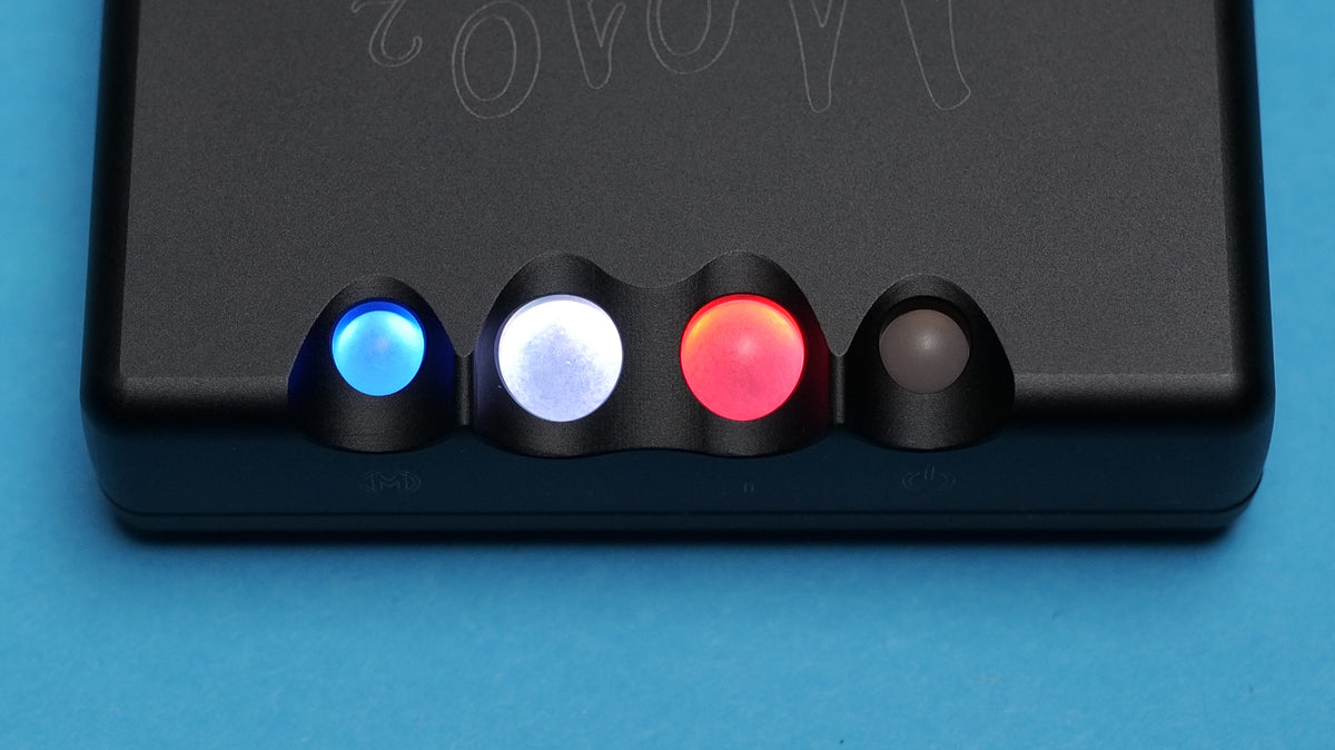

The Mojo 2 is controlled using the four RGB illuminated buttons on the front. The aesthetic of this is going to be polarizing, but it fits with the rest of Chord’s line-up.
I personally found it quite tricky to remember how to configure things for the first couple days, and had to have the manual constantly to hand, but after a while you do get used to it. It would have been nice to have a slightly more intuitive control scheme especially given the multitude of options to configure on the Mojo 2.

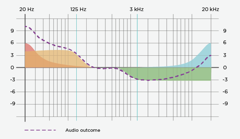

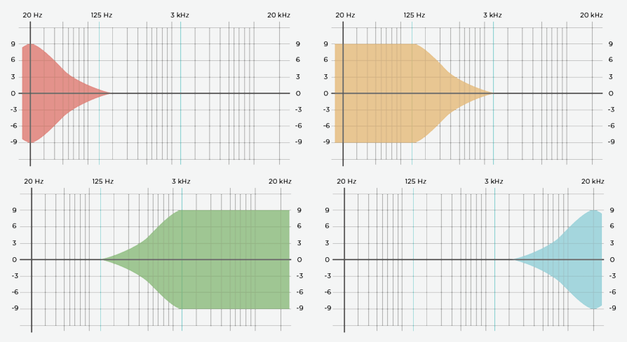

There are four configurable EQ options which are adjustable upto +/- 9dB in 1dB increments.
mojo 2 has four adjustable EQ presets. A bass shelf, a subbass adjustment, a treble shelf, and an upper treble adjustment
mojo 2 EQ bands can be used in conjunction to create more complex adjustments

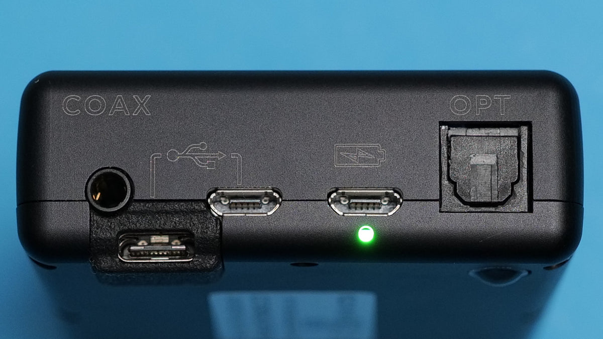

The I/O is a bit on the polarizing side too.
The Mojo 2 does thankfully include both a USB-C and Micro-USB port for data, so you should have no issue connecting this to any device with whatever cable you have to hand. However, you can only charge the Mojo 2 using the secondary micro-USB port.
There is also no charger in the box, so you need to ensure you have a micro-USB 5V charger with at least 2A capability before you will be able to charge the device.
The layout has been kept similar to the original Mojo so that the Chord Poly can be used in conjunction with it.

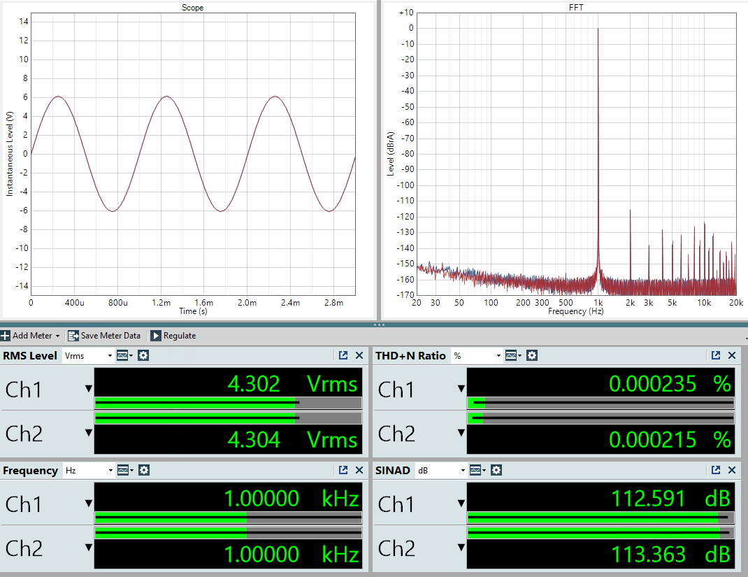

THD+N / SINAD
1khz 0dBFS Sine, 4.3V output (max level without clipping):
mojo 2 sinad at maximum output of 4.3 volts is 113.3 decibels

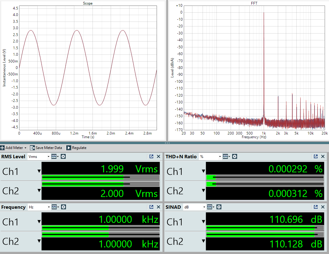

1khz 0dBFS Sine, 2V output (RCA Line Level):
mojo 2 SINAD at 2V RCA line level is 110.7 decibels

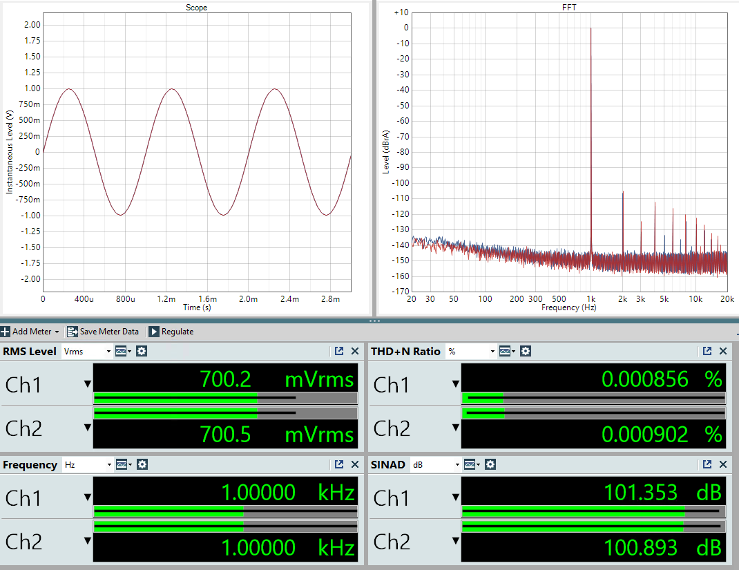

1khz 0dBFS Sine, 700mV output (Headphone Level):
mojo 2 SINAD at 700mv headphone listening level is 101.3 decibels

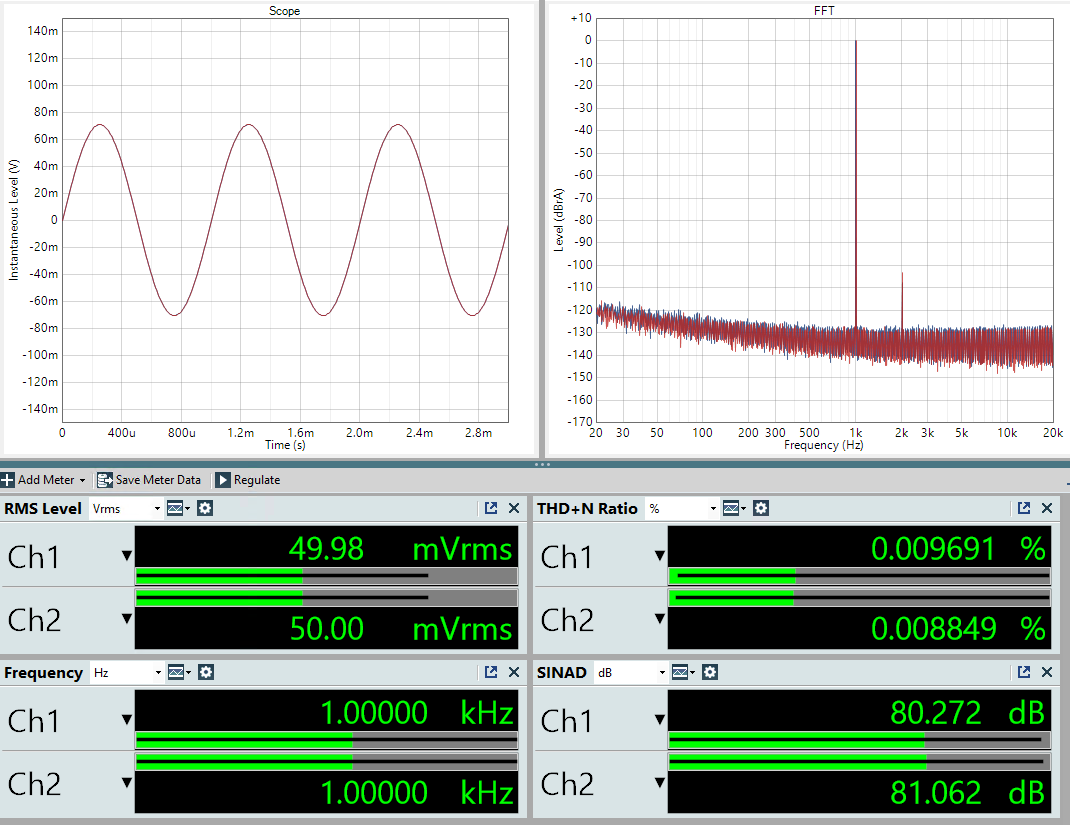

1khz 0dBFS Sine, 50mV output (IEM Level):
mojo 2 SINAD at 50mv IEM level is 81 decibels

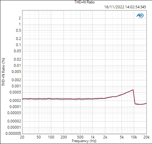

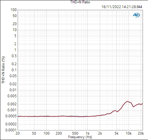

THD+N vs Frequency
Mojo 2 shows a slight rise in distortion at higher frequencies
(AES 20khz filter applied on the analyzer. Provides more relevant THD+N values at lower frequencies as noise above 20khz is ignored, but causes dips in THD+N readings at higher frequencies because harmonics above 20khz are ignored. After 10khz, all harmonics are above 20khz and are therefore ignored.)
(96khz bandwidth used on the analyzer. Provides less relevant THD+N values at lower frequencies as noise above 20khz is factored in, but shows a more accurate profile of rising distortion if present, as harmonics above 20khz are still counted.)
The mojo 2 does have some small amount of rising THD into the higher frequencies. This persists regardless of level.
Whilst from an objective standpoint, lower THD is better, from a subjective standpoint, this can contribute to a subjectively ‘sweeter’ or ‘warmer’ presentation which many people like. This is much less drastic on the Mojo 2 than some other devices, and combined with the fact that the Mojo 2’s distortion profile is almost entirely 2nd order unless outputting very high levels, and therefore more easily masked by the fundamental, it’s very unlikely to be audible.

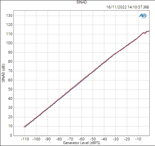

THD+N vs Output Level
Chord Mojo 2 shows clean and mostly linear distortion vs output level with no drastic changes

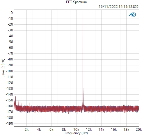

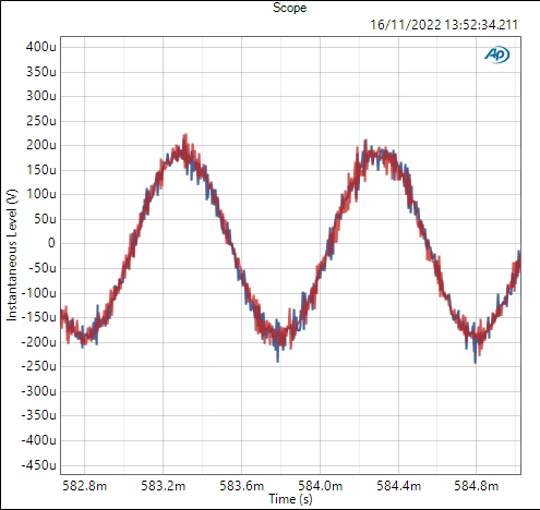

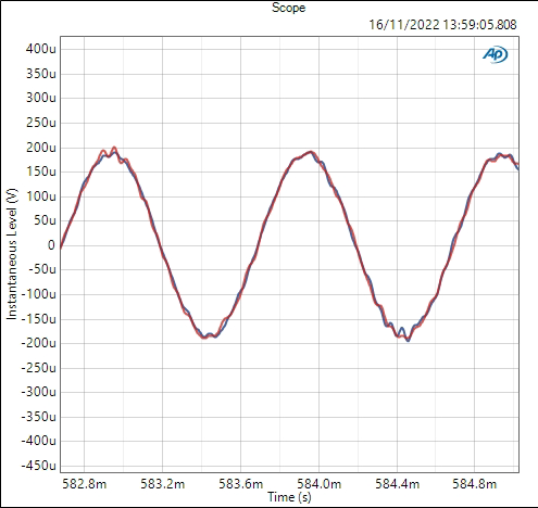

Low Level Signal Output
-90.31dBFS 1khz sine played through device
Chord Mojo 2 outputs a relatively clean low level signal. With very little unwanted noise or distortion
96khz capture bandwidth

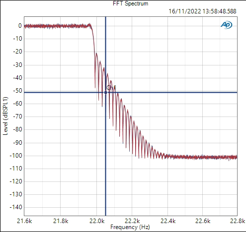

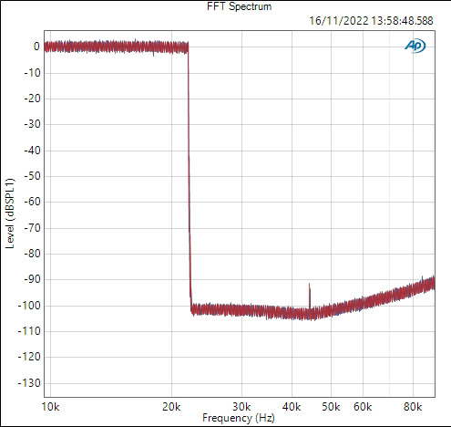

Reconstruction Filter
White noise at 44.1khz sampling rate played through device
Chord Mojo 2 has one of the steepest oversampling filters available
10khz to 96khz shown
Chord Mojo 2 has one of the highest performance oversampling filters on the market. Beginning attenuation shortly before the nyquist frequency at 21.97khz and fully attenuating by 22.4khz
Zoomed to more clearly show area around the nyquist frequency

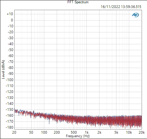

Noise When Idle
Chord Mojo 2 shows very low noise when idle

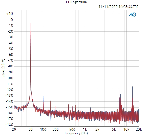

IMD
Chord Mojo 2 intermodulation distortion shows good results. Falling behind some competing products but still performing well

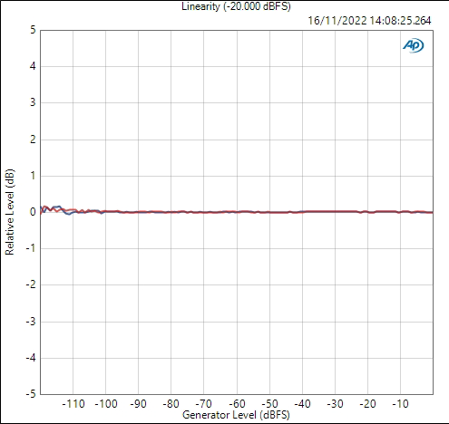

Linearity
Mojo 2 has excellent linearity down to and past -120 decibels, able to resolve low level signals cleanly

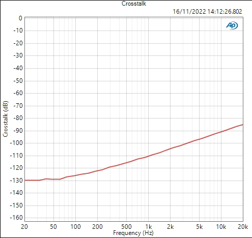

Crosstalk
Mojo 2 crosstalk increases the higher in frequency you go, beginning at -130 decibels at 20hz, and increasing to -85 decibels at 20khz

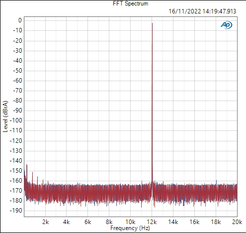

Jitter
Chord Mojo 2 44.1khz jitter performance is nearly perfect with almost no measurable jitter whatsoever
USB input, 44.1khz
Chord Mojo 2 48khz jitter performance shows near perfect results with almost no measurable jitter
USB input, 48khz
Jitter shown is when using USB input. Though both SPDIF inputs were equally excellent. The Mojo 2 has practically perfect jitter performance. This is another thing that Chord DACs do REALLY well and is seemingly an inherent benefit of the pulse array design.
They are not ‘immune’ to jitter, but are immensely resistant to it.
Even when putting it on optical and deliberately adding 25nS of 1khz sine jitter to simulate a truly awful source device, the Mojo 2 still had very good jitter performance.
You can be certain that regardless of the source you use, jitter performance on the Mojo 2 will be excellent.

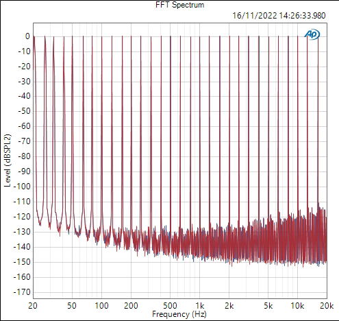

Multitone
Chord Mojo 2 multitone test showing excellent performance with a slight rise in distortion into the higher frequencies

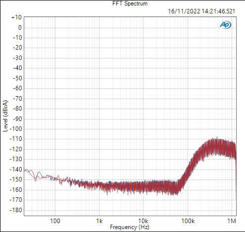

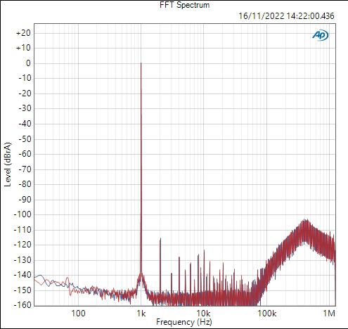

Wideband Noise & Distortion
mojo 2 shows some ultrasonic noise, rising to about -110 decibels at 400khz
Idle
mojo 2 shows some ultrasonic noise, rising so about -105 decibels at 400khz
Active (-3dBFS 1khz Sine Playing)
