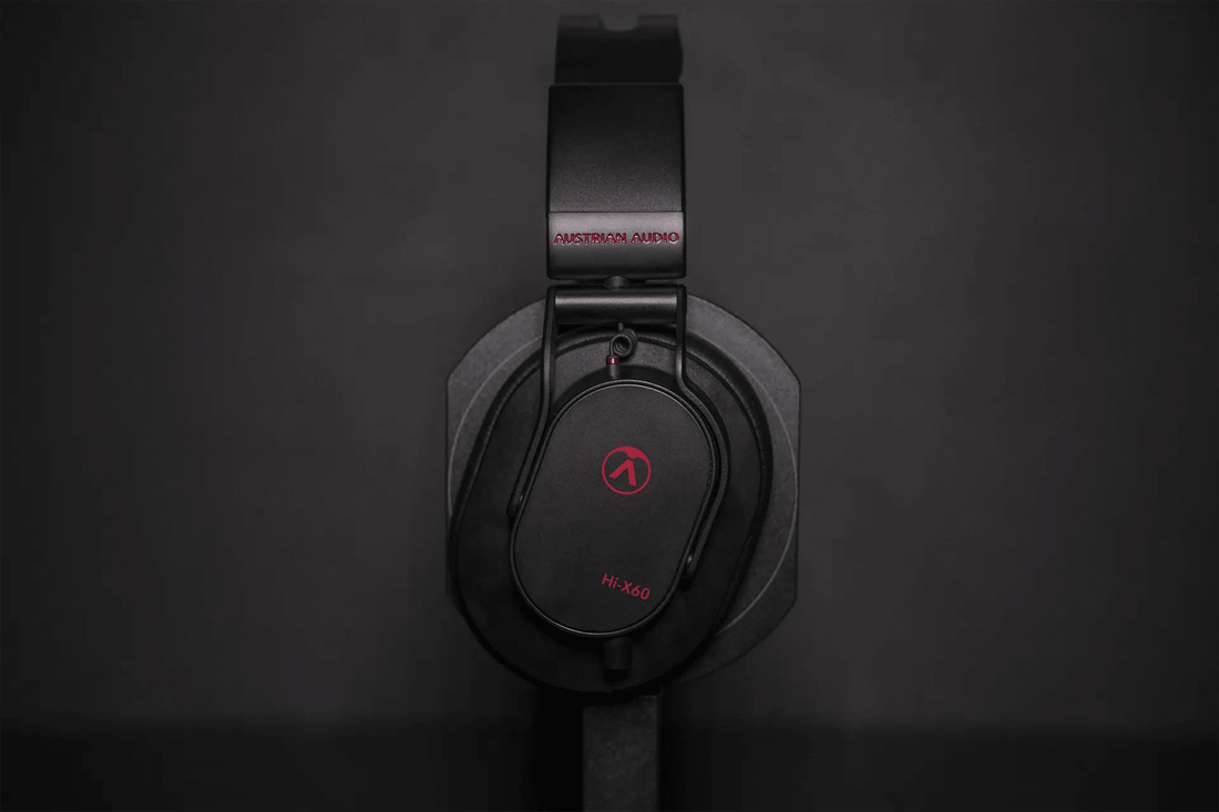

When opening the box, buyers are met with two straight cables (short and long), a threaded 3.5mm-6.3mm adapter, a velour carrying pouch, and what looks like an Hi-x55 if it were custom made for Kylo Ren.
I love the look of these. The red accents are perfectly balanced, giving exactly the punchy splash of color this design needed, decisively elevating it over the original.
I find the build quality, industrial design, and comfort are all basically identical between Hi-X60 and Hi-X55. This is the best possible outcome, to be clear, as the latter was absolutely class-leading in these regards. No complaints about anything here at all, as it seems they only made improvements. Two big thumbs up.
