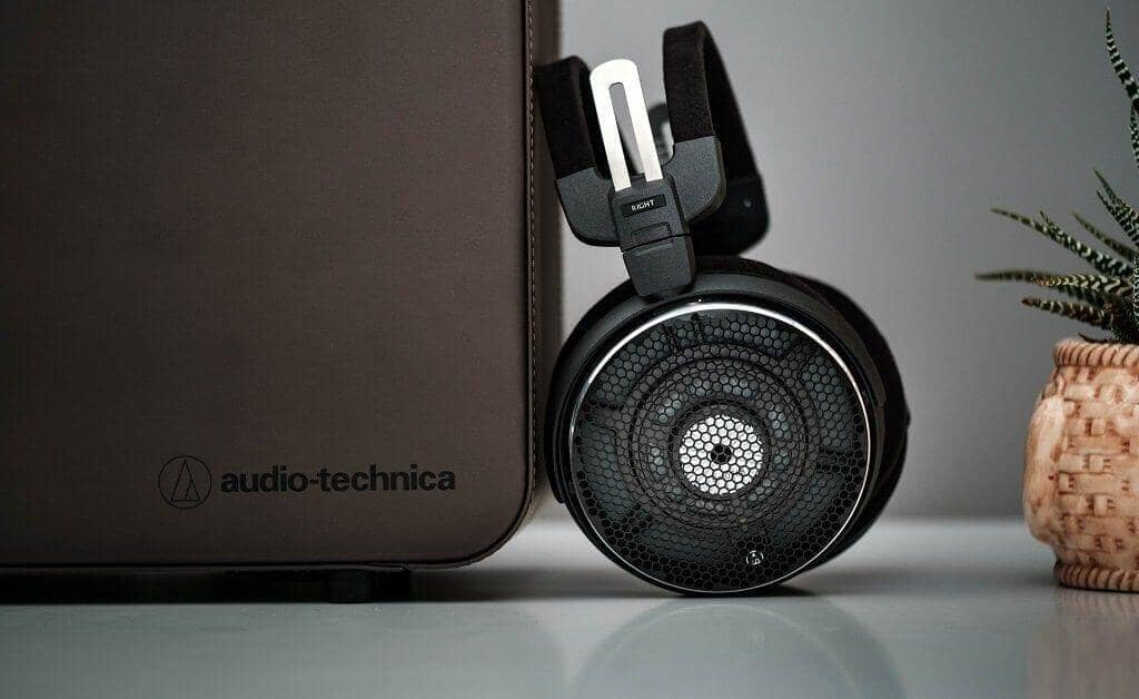

While the ADX5000 doesn't look and feel particularly premium, especially when you compare it to other similarly priced headphones like the Sennheiser HD800s, the materials feel sturdy and durable. The outside of the cup is a honeycomb grille that completely reveals the driver inside. The arms are made of metal but the yoke structure has a bit of plastic on it. The top headband piece feels like a felt-like material, and so all in all I have no significant complaints about durability and headphone build quality.
The ADX5000 is also extremely lightweight, coming in at a mere 270g, and with a headband design that causes it to just float on your head. I do feel that the clamp force for this headphone is a little bit tight, however this may lessen over time. I feel a bit of pressure at the top of the pads where they come into contact with my temples, and this is particularly noticeable while wearing glasses. But if you're able to get over the first 15 minutes, the cushions start to set in place a bit and it's wearable for long periods of time. I had no problems getting through a full day of work wearing the ADX5000.
