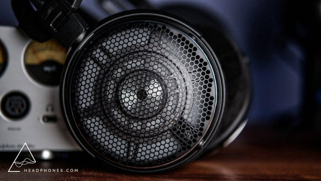

With its industrial, professional design, the ADX5000 is admittedly not the flashiest or particularly eye-catching flagship out there. However, I sincerely appreciate the design choices made for this headphone because it makes for a practical build that is sturdy and unbelievably comfortable.
The use of magnesium for the headphone’s frame makes for a chassis that is extremely lightweight at 270g. Additionally, the use of Alcantara makes for pads that are soft on the skin and resistant to heat build up. For users with larger ears, the inner diameter of the pads might be a little bit on the smaller side and may cause contact, but overall I think that this is one of the most–if not the most–comfortable headphones I’ve personally had the opportunity to wear.
The ADX5000 is intended to be a reference-listening, high-end, personal audio headphone that creates a faithful image of your music. To this end, the ADX5000 combines its 58mm dynamic driver, tungsten diaphragm, baffle and magnetic circuit into a single unit that is set on Audio Technica’s Core Mount Technology to optimize airflow and reduce unwanted vibrations.
