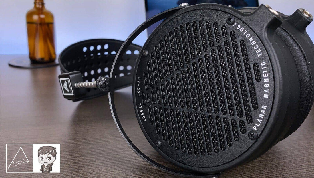

The LCD-2 Classic ($799), which I will be referring to as “LCD-2C,” is the current introductory model of Audeze’s full-size LCD family of headphones. The LCD-2C is essentially a simplified version of the iconic LCD-2, as they share various design aspects and driver technologies. The LCD-2C retains the LCD-2’s Neodymium N50 magnets, as well as the same magnetic structure; albeit without the inclusion of Audeze’s Fazor waveguide technology.

The LCD-2C is built using Audeze’s traditional full-size LCD design, but it features black nylon rings in lue of the usual wooden rings. Aside from the nylon rings, ear pads, and headband strap, the LCD-2C is composed entirely out of metal and it feels very sturdy. The use of nylon for the rings does come with some added benefits. Despite feeling very solid, the nylon rings reduce the headphones overall weight when compared with the wooden rings; and unlike wood, Nylon will not need any special maintenance or precautions to keep them in their best shape. My only complaint is the same one I had with the LCD-GX, and that is that the synthetic leather used on the LCD-2C makes the headband stretch very easily and I think it will need replacement not too far down the road.
Comfort on the LCD-2C was, at least to me, very good. The pads are–in usual Audeze fashion–gigantic and deep; providing ample room for your ears to fit in. While they remain relatively heavy at 550g, and are not as light as the magnesium-chassis LCD-GX, I still found the LCD-2C to be very comfortable and had no issues wearing them even in prolonged listening sessions. Clamp force out of the box was not particularly bad either. I still think that they will need some easing-in, but they did not put as much pressure on my jaw as the LCD-2; which had a pretty vicious clamp in the first couple of weeks of use. My only real complaint for comfort is–again–the headband strap’s stretching. The stretching of the suspension strap can cause the metal headband to come in contact with the user’s head; applying some pressure.
