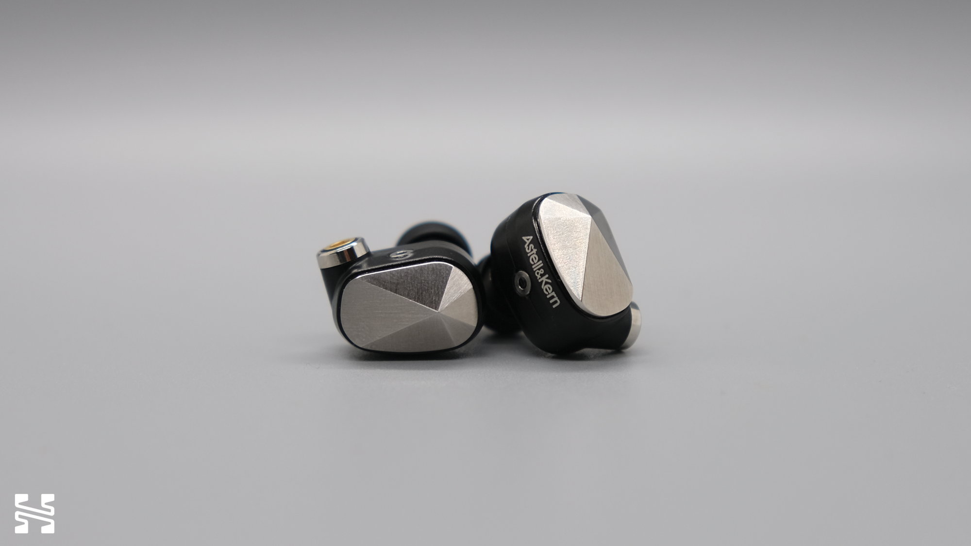

The Pathfinder is a medium-sized IEM that I personally had no issues with for fit or comfort, although this is always subjective to the end listener. It has an aluminum shell that appears to have been anodized. There is a slight notch where the two halves of the shell meet that catches on a fingernail; I would have preferred for this to be more seamless. The addition of a brushed stainless steel faceplate lends a slight heft to the IEM and a sense of more premium construction. The nozzles are slightly elongated in typical Campfire Audio fashion, although the grills of old (which sported parallel vents) have been replaced by a grill that has eight circular holes.

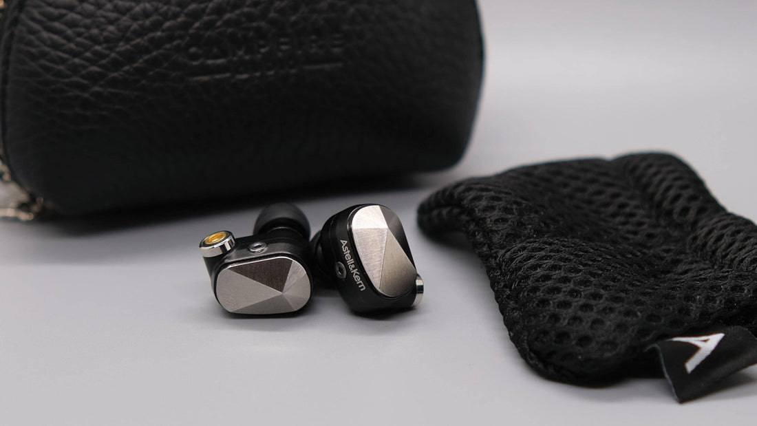

Frankly, I am not a fan of the Pathfinder’s cable. It is rather unwieldy to use, as it sports four individual lines of wire side-by-side. For those who might be unaware, this is highly reminiscent of the type of cable that is sometimes included with budget manufacturer KZ’s IEMs. Likewise, the hardware on the Pathfinder’s cable would benefit from improvement - it does not feel as premium as I’d like. The most positive thing that I can say on this front is that there are at least three cables (for all standard terminations) included with the Pathfinder.
