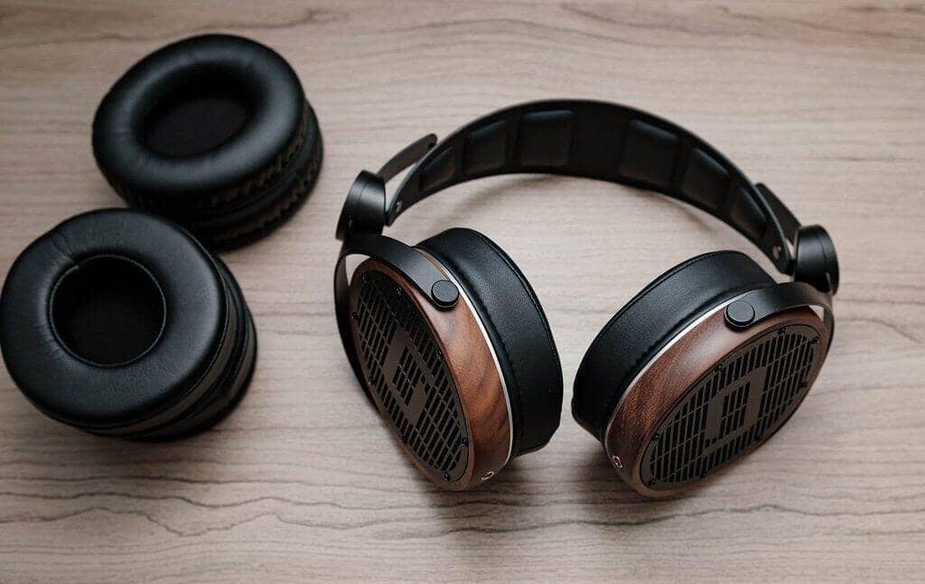

Build, Design & Comfort
The PM-50 has gone for a minimalistic design style and aesthetic, and this is something I really appreciate. There’s a sleek wood accent to the cups that feel sturdy - like I don’t have to worry about how carefully I put them down on the table. The headband and cup articulation is sparse for materials, and that’s likely to help keep the weight down as well. And so while it doesn’t look and feel as premium as its price tag might indicate, this is a design style I can get behind. There’s also a bit of cup swivel, which I find is a must for headphones these days in order to get it to fit properly for a wide range of head shapes.
Unfortunately, this is where the praise stops. The initial two sets of pads that came with the PM-50 were far too small even for normal ear sizes - so much so that Andover has sent out larger earpads because they likely got similar feedback. The good news is that the larger ear pads fit my ears much better, making the PM-50 overall a very comfortable headphone. The bad news, is that no matter which ear pads you use, the PM-50 is not a good sounding headphone to me.
