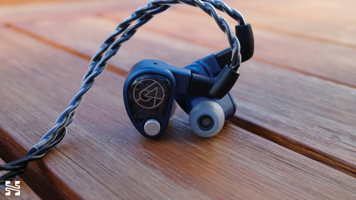

Moving to the U4s itself, the shell is milled aluminum and coated dark blue while the faceplate is gray/black with a meteorite-like texture. It has the teardrop ergonomic that characterizes 64 Audio’s other IEMs. Personally, I found comfort with the U4s to be excellent - I was able to wear it for hours at a time - but this is always subjective. It’s also worth noting that the U4s has a small vent at the back of the shell which is used to port the IEM’s dynamic driver. I found that I had to place the U4s slightly differently in my ear than their other IEMs (which I normally deep insert) to avoid blocking the vent.

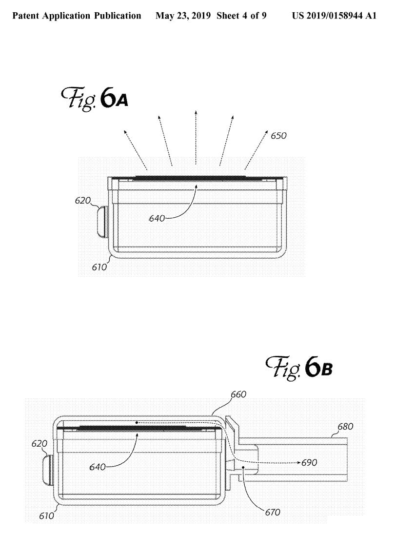

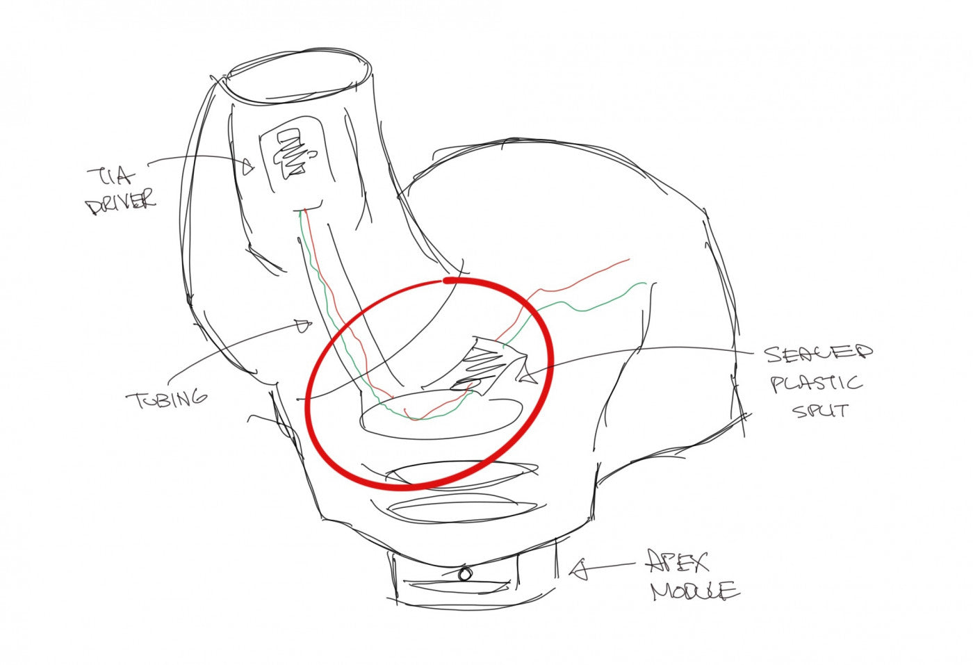

To understand the tia system, it helps to first understand how a standard BA configuration works. Usually, we see there are two mediums for which frequencies are carried from a BA driver: 1) a slot, a spout, or a hole at the driver itself, and 2) a connecting tube which then carries the frequencies to the ear. Ostensibly, this is how the other two BAs in the U4s are configured. But the disadvantage of using this typical configuration, particularly with a tweeter, is that these frequencies lose energy over the distance of the tube, resulting in less output (poor treble extension) and added resonance when the frequencies reach the ear.
The tia configuration circumvents these limitations by “opening” a BA, which is to say removing the aforementioned slot, spout, or hole at the driver and allowing the frequencies to radiate from the inner diaphragm of the driver itself. But this still doesn’t address the limitation of travel distance, so the next step - at least with a BA tweeter - is mounting the driver directly at the nozzle of the IEM itself. Then what do you do with the wire connecting to that driver because there's only so much room at the nozzle? If you're 64 Audio, you run it through the tube that connects to the orifice of the Apex module (see below) and have it pop out from a split of airtight plastic. Collectively, these differences translate to superior treble extension in their IEMs, albeit not without idiosyncrasies I’ll delve into later.

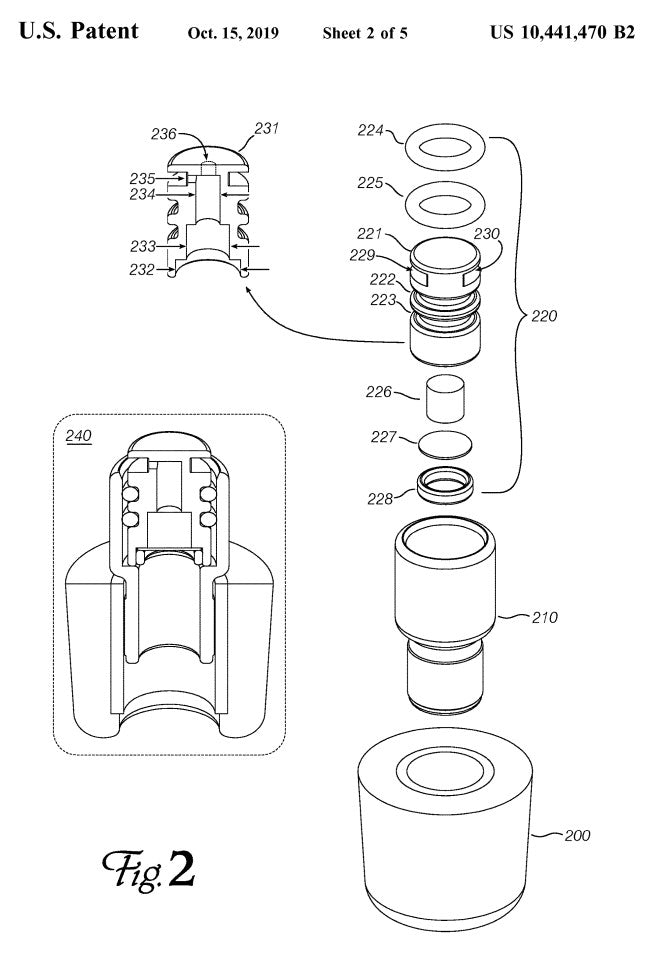

Speaking of Apex, there are a couple other patented technologies that 64 Audio uses in their IEMs. The Apex technology is basically a more fancy form of venting an IEM. While the patent encompasses different forms of venting (see the Trio and Fourté, which have the technology but do not have the cylindrical module seen on most of their IEMs), this is usually achieved via the visually distinctive Apex modules.

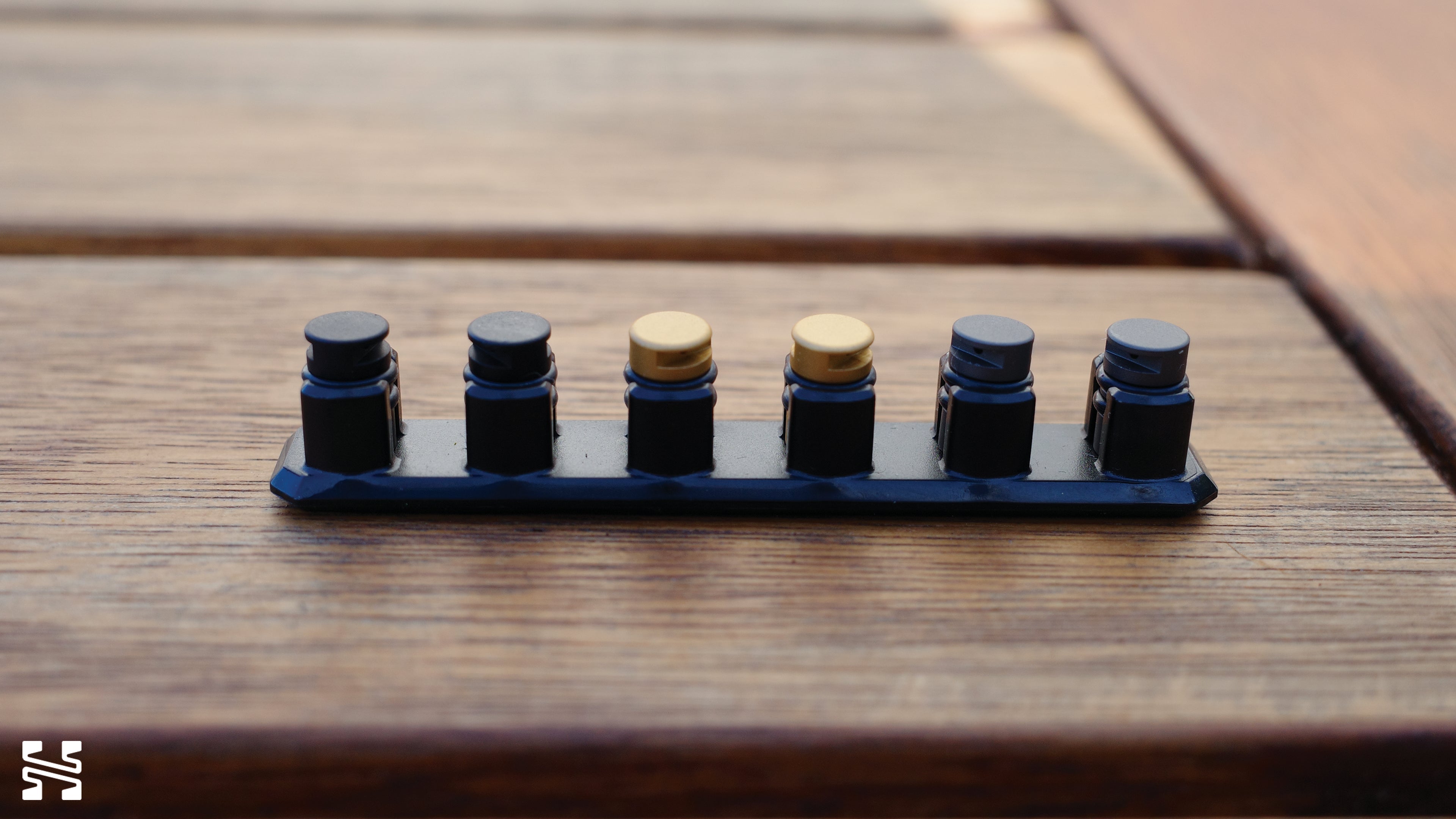

The Apex modules are cylinders composed of aluminum that are plugged into an orifice at the faceplate of the IEM which, in turn, is connected directly to the nozzle via a tube. Ridges are present around the module and outfitted with O-rings to achieve an airtight seal. Air travels through a filter and viscoelastic foam within the module to control the exchange of air pressure; air exits the module through a small hole that rests between the finger notches of the module. This is also a simple but clever solution to mitigating wind noise, as the module can be inserted in the IEM at an angle to have wind pass by.
The Apex modules are aluminum cylinders composed that are plugged into the faceplate of the IEM
There are two prime advantages that come to mind when considering the Apex system. First is the pressure-relief it provides. With a traditional sealed IEM, sound waves build up against the eardrum, causing discomfort over longer periods of listening.
Naturally, Apex relieves some of this pressure, thus preventing the onset of this reflex. But the less obvious advantage of the Apex system is its usefulness as a tuning parameter, as it introduces a known source of leakage which can be controlled. Incidentally, BA earphones are also more prone to involuntary leakage (relative to dynamic drivers). In theory, the leakage from the Apex port overwhelms this involuntary leakage and allows for tuning superior bass extension. This is more relevant in the case of 64 Audio's UIEMs than their CIEMs; either way, it's likely partially responsible for the “special sauce” many listeners would attribute to their BA bass.
Of course, no system is perfect, and here the Achilles heel is isolation. It’s a vent, so it simply cannot match the standard -26dB isolation created by a sealed IEM. This is reflected in the naming of the modules; the M20 module provides -20dB isolation and so on and so forth for the M15 and MX modules. However, this limitation is not necessarily glaring in practice, and I would suggest that isolation with the U4s’ stock M20 module is adequate to protect hearing in most any loud environment.

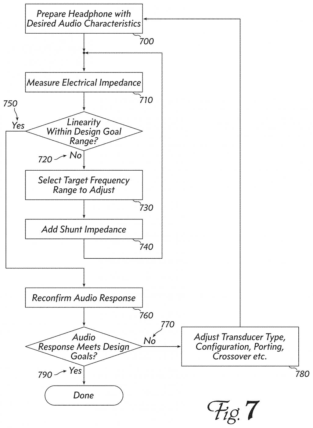

Finally, LID is 64 Audio’s technology for counteracting differences of sensitivity between individual drivers and how they interact with a given electrical load. Traditional multi-BA IEMs will usually exhibit changes in frequency response depending upon the output impedance of a source; the (in)famous Campfire Audio Andromeda is an example of this. It sounds brighter with higher OI sources, vice versa with lower OI sources. LID ensures the U4s’ frequency response is consistent regardless of source OI. In truth, though, there isn’t necessarily a “one method solves all” approach for achieving linear impedance and the approach must be adapted based upon the individual IEM. Their pending patent for LID more or less confirms this, as it is broad and outlines multiple methods (for which I’ll spare covering in the interest of brevity) for achieving linear impedance.
Perhaps a less considered advantage of LID is that it is ideal for source comparisons because it removes the impedance variable from the equation. Assuming that one believes in differences of sound between sources, any differences that a listener observes between sources using the U4s should be the result of source coloration alone.

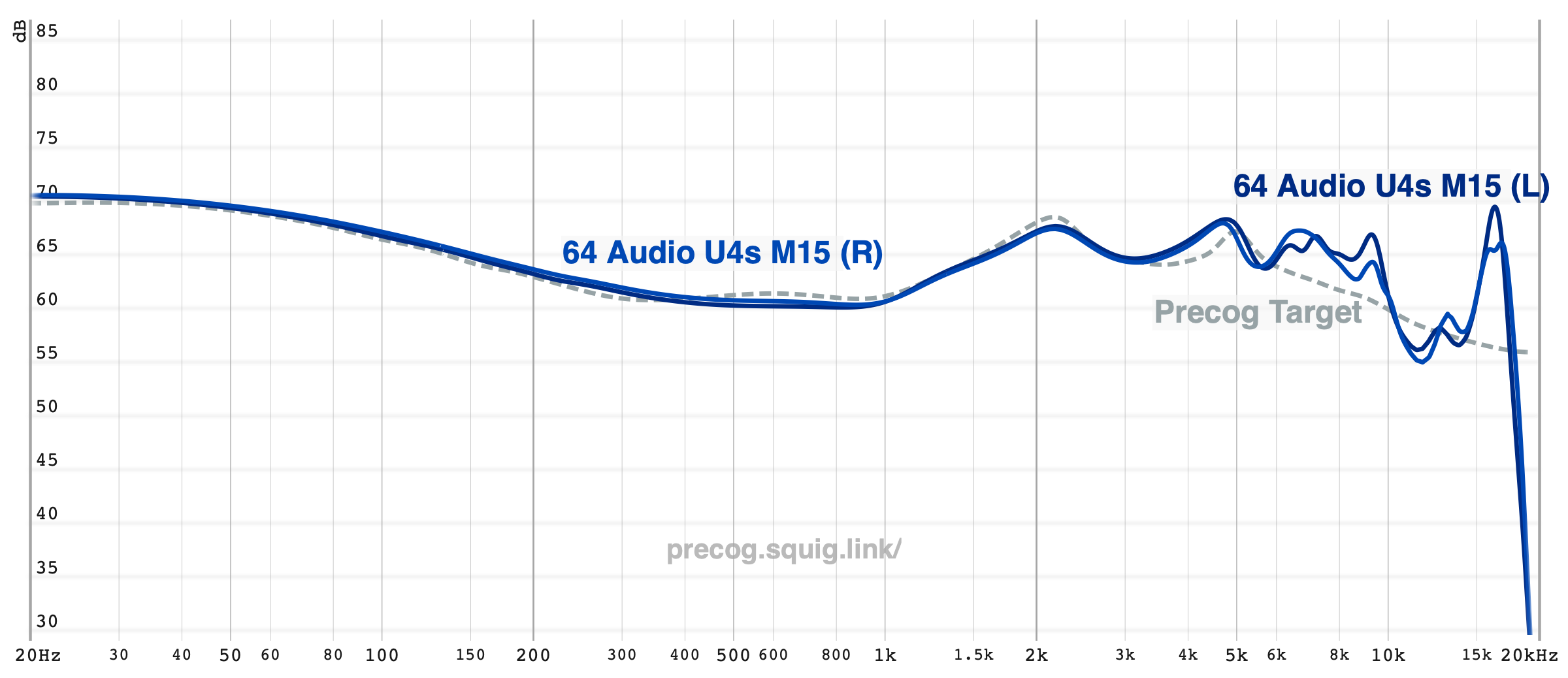

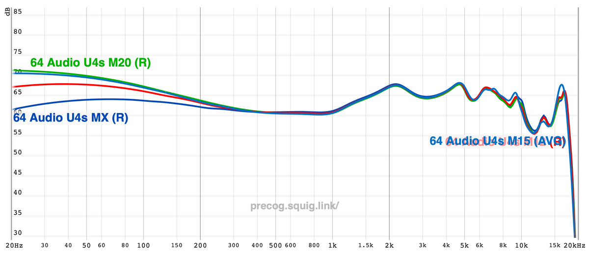

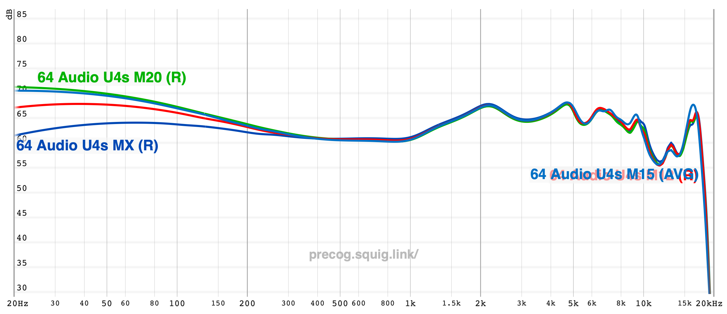

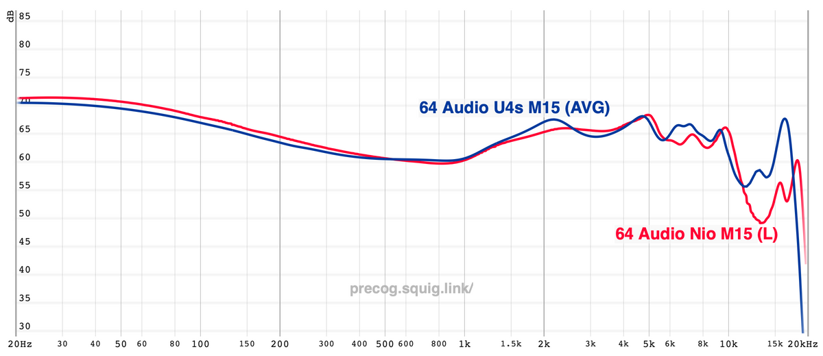

The frequency response below was taken using a clone IEC-711 coupler. Measurements after 8kHz should not be considered entirely accurate. If you would like to compare the U4s to hundreds of other IEMs I have measured, then please see here.
64 Audio U4s vs Nio Frequency Response Graph Measurements
Before talking about the U4s, let’s take a step back to the 64 Audio Nio, one of their hybrid IEMs derived from the “OG” N8 IEM. In my early days in the hobby, I fondly recall this being one of my favorite IEMs: simply pounding bass, a lush, thick midrange and reasonably spacious sounding to boot. It was impressive enough for me to fork over my own hard-earned cash on a pair. But time went on; I eventually sold my set due to finding it somewhat too sloppy in the transients, too tame overall. You might imagine my surprise to finally hear the U4s and find it to be pretty much everything the Nio was - and possibly more.
Like the Nio, the short reason why one considers the U4s is the bass response. It is sub-bass focused with a dash of mid-bass that slopes off just past 300Hz. This keeps it fairly clean; in fact, more so than the Nio. Nonetheless, a common criticism of the Nio is its somewhat “dirty” bass transients and ability to articulate texture past 200Hz. This sentiment still applies to the U4s wherein it sports a more pillowy characteristic to bass attack. But for a sense of authenticity to bass notes, the U4s certainly delivers with a meaty thickness and plenty of decay. Think of cookies: there are crunchy cookies with a lot of texture and there are softer cookies with more chew; the U4s is closer to the latter. Out of the few IEMs at a kilobuck with noteworthy bass, this is one worth indulging in.
It certainly doesn’t hurt that there’s a decent amount of fine-tuning afforded by the Apex modules. The U4s basically has three distinct flavors of bass. The M15/M20 modules produce the most bass and the character that established the Nio as a noteworthy basshead IEM. The MX module will produce nearly dead-neutral bass with a slight roll-off. Then, new for 2023, the M12 module will produce something of a happy medium; there’s something for everyone now. Between choosing from the MX to M20 modules, one can expect the U4s to go from brighter to darker sounding accordingly.
Interestingly, while using the MX and M12 modules does clean up the U4s’ bass, it retains a slight softness to its bass attack. This is an interesting phenomenon that I believe stems from other parts of the U4s’ frequency response: specifically the midrange tuning. They have a few variants of midrange tuning (some less desirable than others) that they use in their IEMs; thankfully, the U4s follows what is their safest formula. This is realized through flat lower-mids from 400Hz to 1kHz, then a more reserved pinna compensation and presence region. Consequently, the fundamentals of vocals are maintained while female vocals, especially sopranos, are presented further back in the mix and more reserved. This could be good or bad depending on individual preference. But for me, it’s a boon given that I listen to a lot of more shouty, possibly shrill music (read: K-Pop).
Moving back to the Nio, one of my main qualms was its treble response. Although it made use of 64 Audio’s tia driver, I couldn’t help but find it a tad dark in the upper-treble and, in tandem with its massive bass shelf, somewhat plodding overall. This doesn’t apply to the U4s. The U4s is more U-shaped than L-shaped (a term usually used to describe a bassy and dark IEM like the Nio), meaning that it has more energy concentrated in the treble. While the U4s’ 5kHz peak might look possibly concerning on paper, it has the benefit of more crunch from 6-10kHz, and more upper-treble energy, to balance out that initial peak. Snares, cymbals, and other instruments sound zingy, vibrant, and have excellent definition.
Granted, this is not quite a natural sounding treble response. Those with more sensitive ears might find the U4s too bright, possibly pesky at louder volumes. For this reason, I certainly prefer the M12/M15/M20 modules for the benefit of masking some of this brightness. And treble aside, there are a number of other tuning decisions that some listeners might be predisposed to take issue with like the more muted upper-midrange. But ultimately, these are all nitpicks. I have a predilection for IEMs that are more colored and that are colored tastefully. As far as I’m concerned, there are few IEMs on the market that walk this line as masterfully as the U4s does.

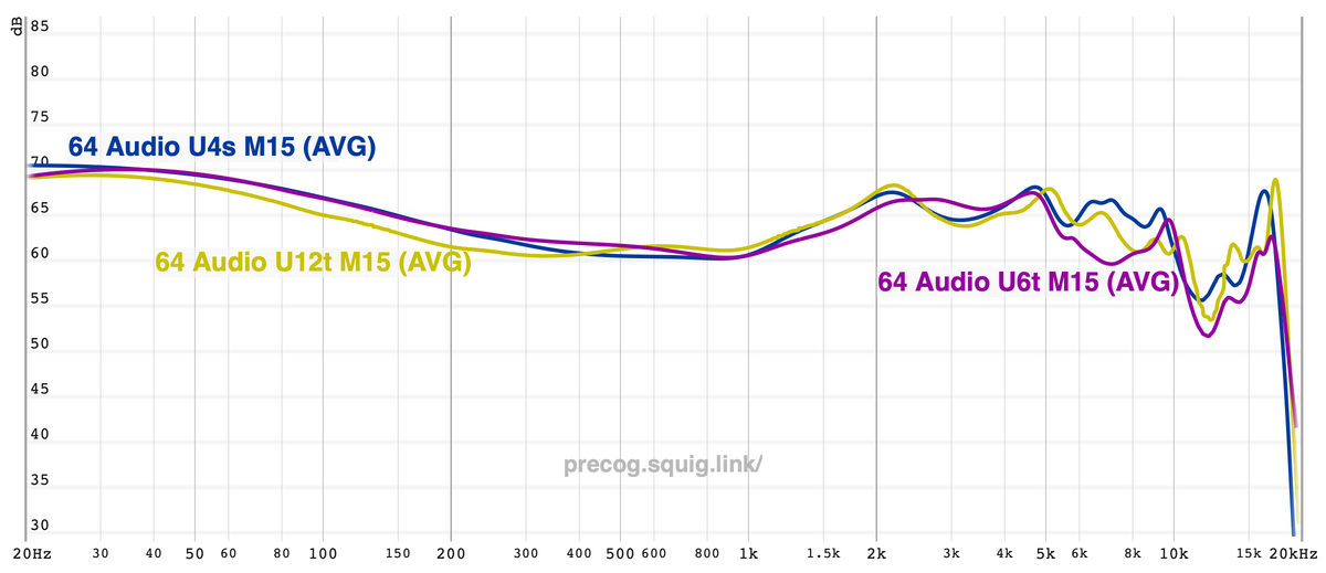

As an aside, I did say that the Nio was one of my favorite IEMs in the past and the personal preference curve I made a couple years ago illustrates this. My preference curve is basically the U12t with some added mid-bass, courtesy of my experience with the Nio, and more mid-treble. While I don't necessarily subscribe to my own target these days (frankly, I didn't put much thought into it when I made it), it's pretty neat that the U4s is the closest IEM to realizing it.

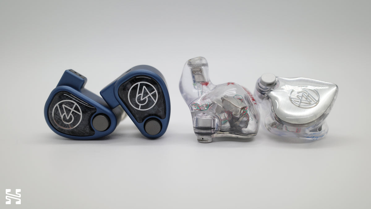

Compared to the A4s CIEM

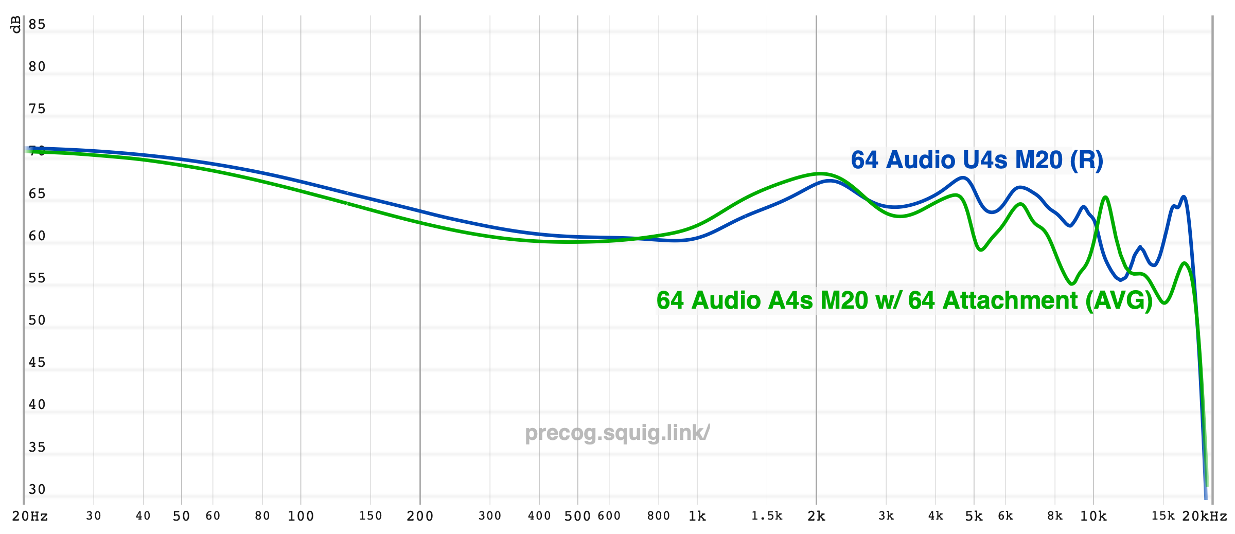

The frequency responses of the U4s and A4s cannot be strictly compared 1:1 because of differences in insertion depth on the coupler. The A4s was measured using a specialized attachment provided courtesy of 64 Audio.
Fortunately, courtesy of 64 Audio, I happen to own the CIEM version of the U4s: the A4s. This puts me in the unique position to write about some of their differences.
Interestingly, the bass response of the A4s is slightly cleaner (with less mid-bass) than the U4s. But this is a benign consideration compared to their discrepancies in treble. My suspicion is that the increased insertion depth of the CIEM models shifts the resonance peaks of the tia driver, to the extent of which it creates a more “feathery” treble response. More critically, though, I find that it negatively affects timbre on the CIEM versions and sounds plasticky and smoothed over. This is an observation that I’ve found consistent between not only the A4s, but also my A3t and a couple of A12t units that I have force-fitted and measured.
I wouldn’t rule out 64 Audio’s CIEMs entirely. After all, they do have the benefit of increased isolation and comfort, plus way more customization. To be clear: if you prioritize sound quality, the universal versions are the way to go.
