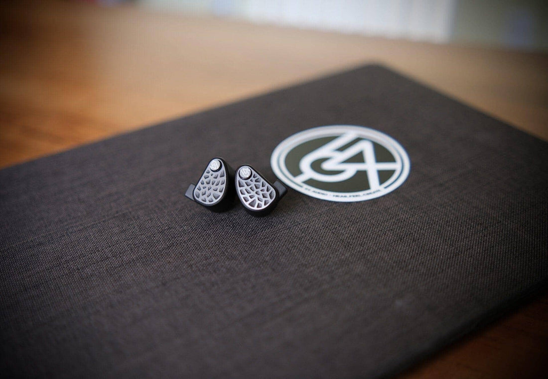

New for 2021, the U18S sports a shell and faceplate that is distinct from the company’s past models. Using a pair of calipers, I measure the width of the U18S’s shell at 0.54’’ relative to the U12T’s width of 0.48”. Because of this, the U18S does feel a tad more insecure in my ears especially when making abrupt movements, although I did not experience any issues with overall comfort. The faceplate itself is quite cool and sports a milled pattern that is inspired by “natural formations”. Y’all know by now that I’m not too picky about this stuff; I think it strikes a good balance between being understated and aesthetically pleasing.
