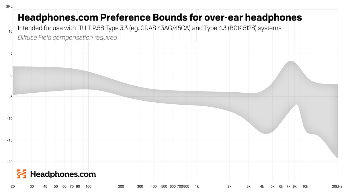

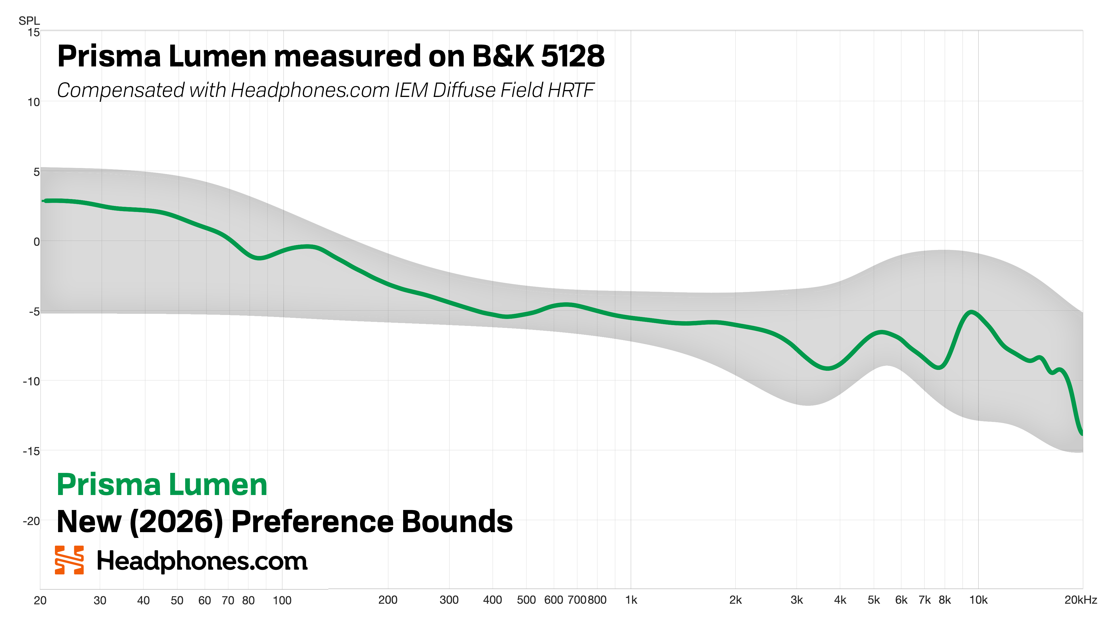

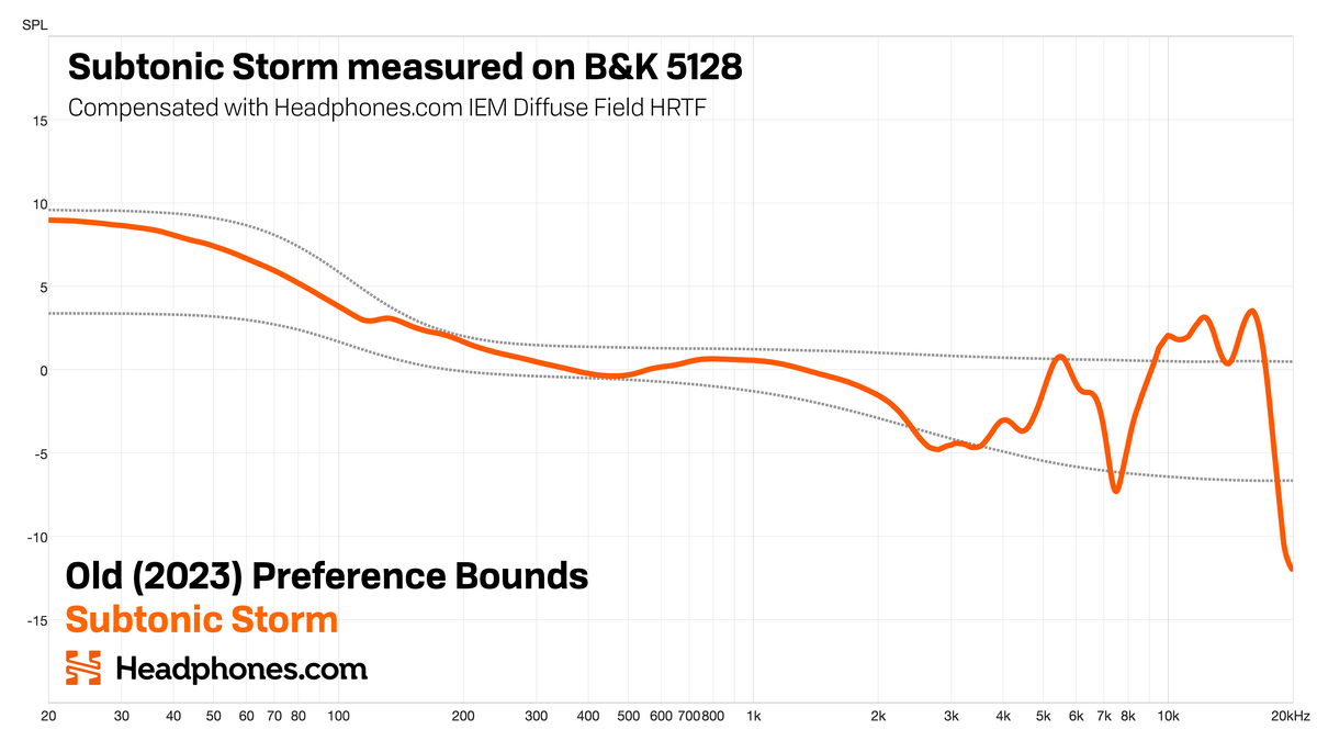

Then we’re going to share our solutions for this problem: our new Preference Bounds for use with the B&K 5128 & GRAS 43AG/45CA test fixtures, as well as our new measurement database, GraphWorks.

- II: Introducing Our New Preference Bounds

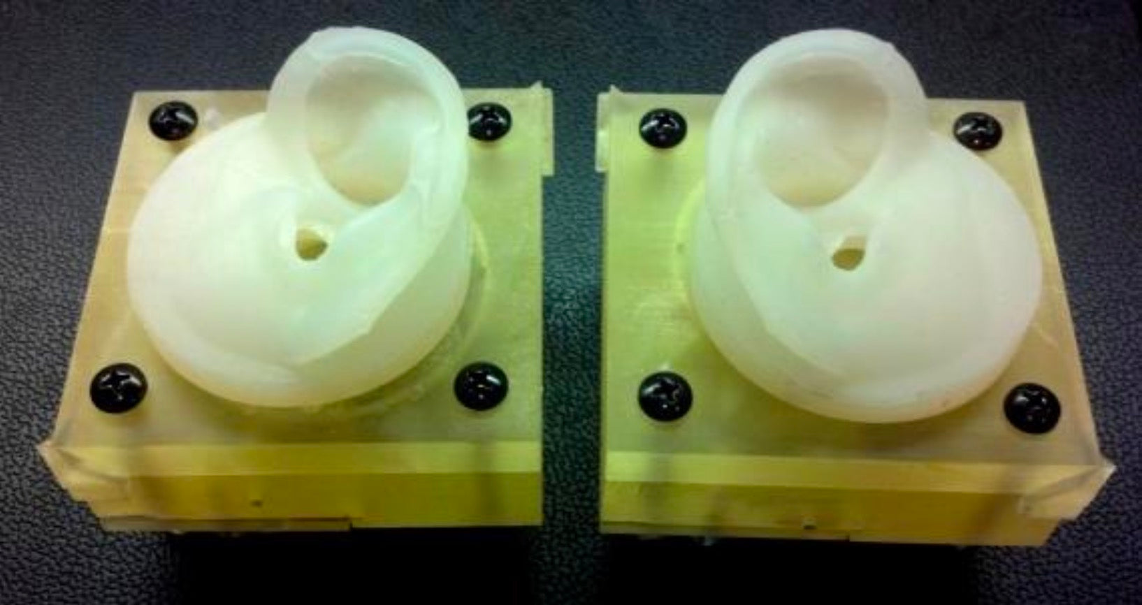

In 2015 Todd Welti at Harman made modifications to the test fixture they’d been using—a custom set of pinnae (Fig. 2)—for collecting the headphone measurements. They’d identified that test fixtures produced meaningfully different measured bass responses compared to humans measured in equivalent circumstances, so they produced this new ear to make the test fixtures produce a bass response more similar to what humans would get(2).
Fig. 2: Todd Welti’s modified IEC 60318-7 pinna, modified to be softer & to make the pinna flange sit closer to the head, injection molded with Shore 00 35 silicone.

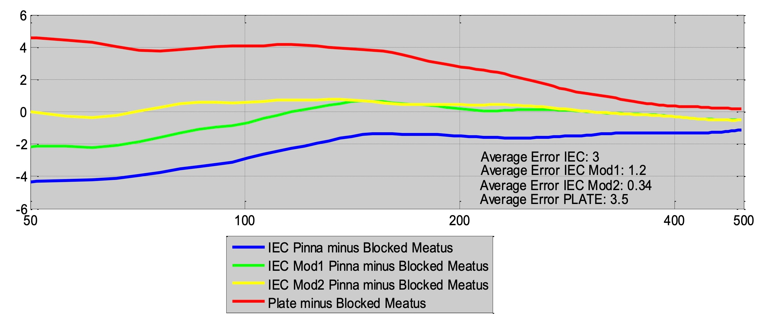

To combat the latter problem in particular, Welti produced his own silicone ears based on the same standard as the KB007x, but with a few modifications. It was made with a softer silicone, so its deformation characteristics were closer to that of a human ear, which helped specifically on-ear headphones seal on the test fixture.
This new “Welti” pinna was also flattened a bit in its geometry, brought in closer to the sides of the head overall. This again, made it easier for headphones to seal on the test fixture, because they protruded less from the head.

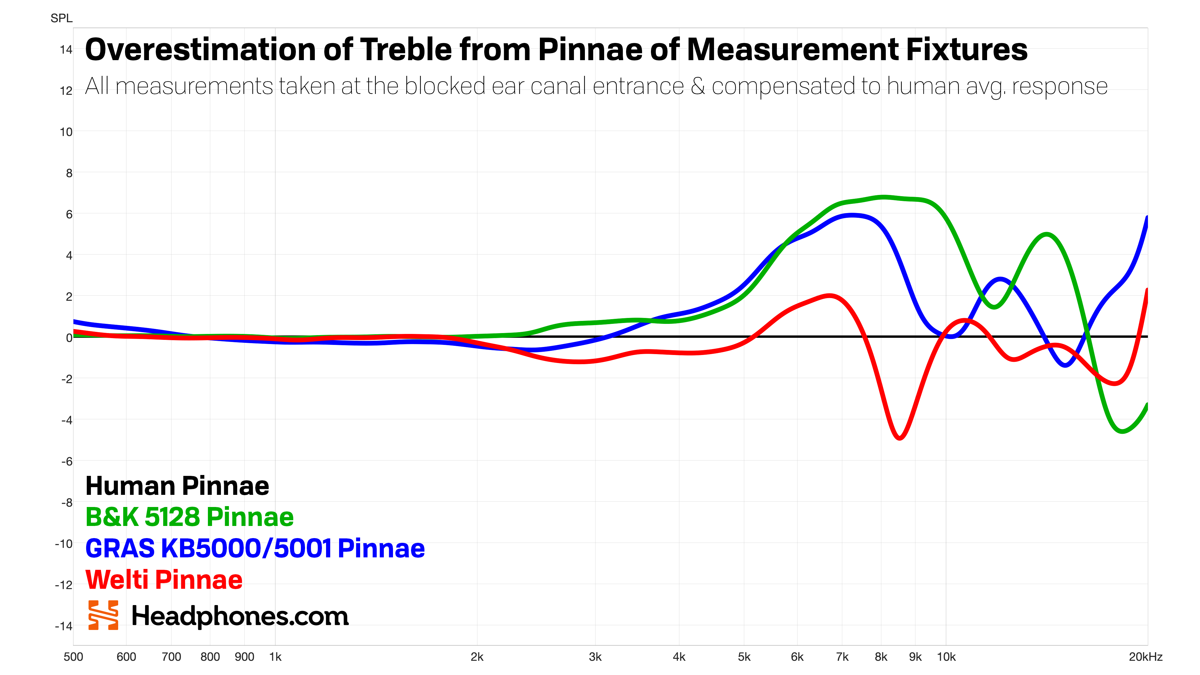

Fig. 3: Frequency response measurements of headphones taken at the blocked ear canal entrance on GRAS KB007x in blue, “Welti” pinna v1 (flattened, but harder silicone) in green, “Welti” pinna Final Version in yellow, flatplate system in red. All traces are compensated to the average of measurements on humans, to show error vs. the human results.
The result is that the discrepancy in bass between humans (0 dB line in Fig. 3) and their new Welti-modified test fixture (yellow line in Fig. 3) was narrowed enough for them to feel confident moving forward with using this ear for their future listening tests, and these tests include the 2018 paper that produced the most popular Harman AE/OE 2018 Target.
This is also where one of the first issues arises. Not necessarily with the research itself, but with how people use it.
While the problem of leakage estimation of test fixtures vs. humans was a smart thing to identify and attempt to control, the new pinna produced meaningfully different treble responses for headphone measurements than the ears people ultimately ended up using when utilizing Harman’s target to evaluate headphone frequency responses.
This wasn’t necessarily the researchers’ fault; this paper was primarily focused on bass, and because it was prior to the popularity of GRAS’s KB5000 series anthropometric pinnae (which is what everyone used after Harman concluded their over-ear headphone research), they simply were not able to get a sense of how the difference in treble between the Welti pinna vs. other pinnae would affect the future use of the research’s output.
But because this treble discrepancy wasn’t really mentioned at length in any of the papers, many of the voices best known for using Harman’s work in our community didn’t know that the Welti pinna was the one used for the 2018 paper, and didn’t know how dramatically different the headphone measurements they produced were.
Which meant for more than half a decade, everyone was actually using the wrong ear with the Harman target… and most of us still are. This matters a ton because the measurements of headphones, and their behavior, is significantly dependent on the ear that it's placed on.
The difference in headphone responses produced by the Welti pinnae and the common, erroneously-used-with-Harman GRAS KB500x pinnae are different enough—in isolation, as well as how they compare to measurements on human ears—that this is not an error that can be ignored.
Fig. 4: The average of 11 headphones measured at the blocked ear canal entrance of GRAS 45CA with KB50xx pinnae (blue), B&K 5128 (green) and GRAS 45CA with Welti pinnae (red). All results are compensated to the average of those same headphones measured on humans at the blocked ear canal entrance (black line), to show the difference between these rigs and the same headphones on humans.(4)
We can see that the two most common fixtures—the GRAS with KB50xx pinnae, and the B&K 5128—overestimate treble above 4 kHz quite dramatically relative to what humans (0 dB line in Fig. 4) are receiving, when measured at the same point. The Welti pinna, by contrast, is much closer to what humans receive in the treble, though it still underestimates treble in certain places.
This magnitude of difference between 5128/KB50xx and Welti means that, for the 2018 target curve made on the Welti ear to be replicated accurately on GRAS KB50xx equipped fixtures or the B&K 5128, we would need to account for the fact that both of these fixtures’ pinnae strongly overestimate the treble above 5 kHz, relative to both the Welti pinna, as well as human ears.

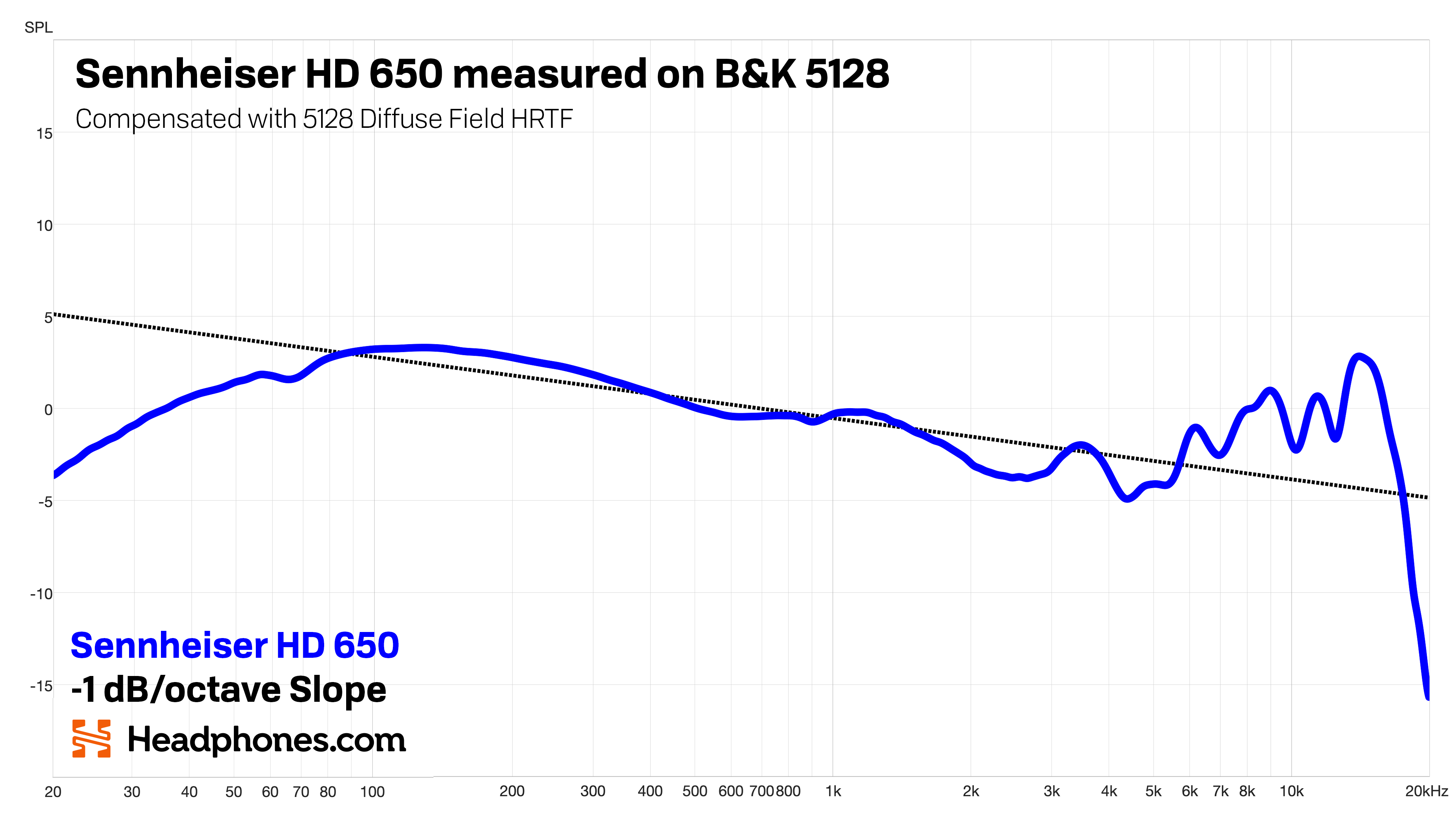

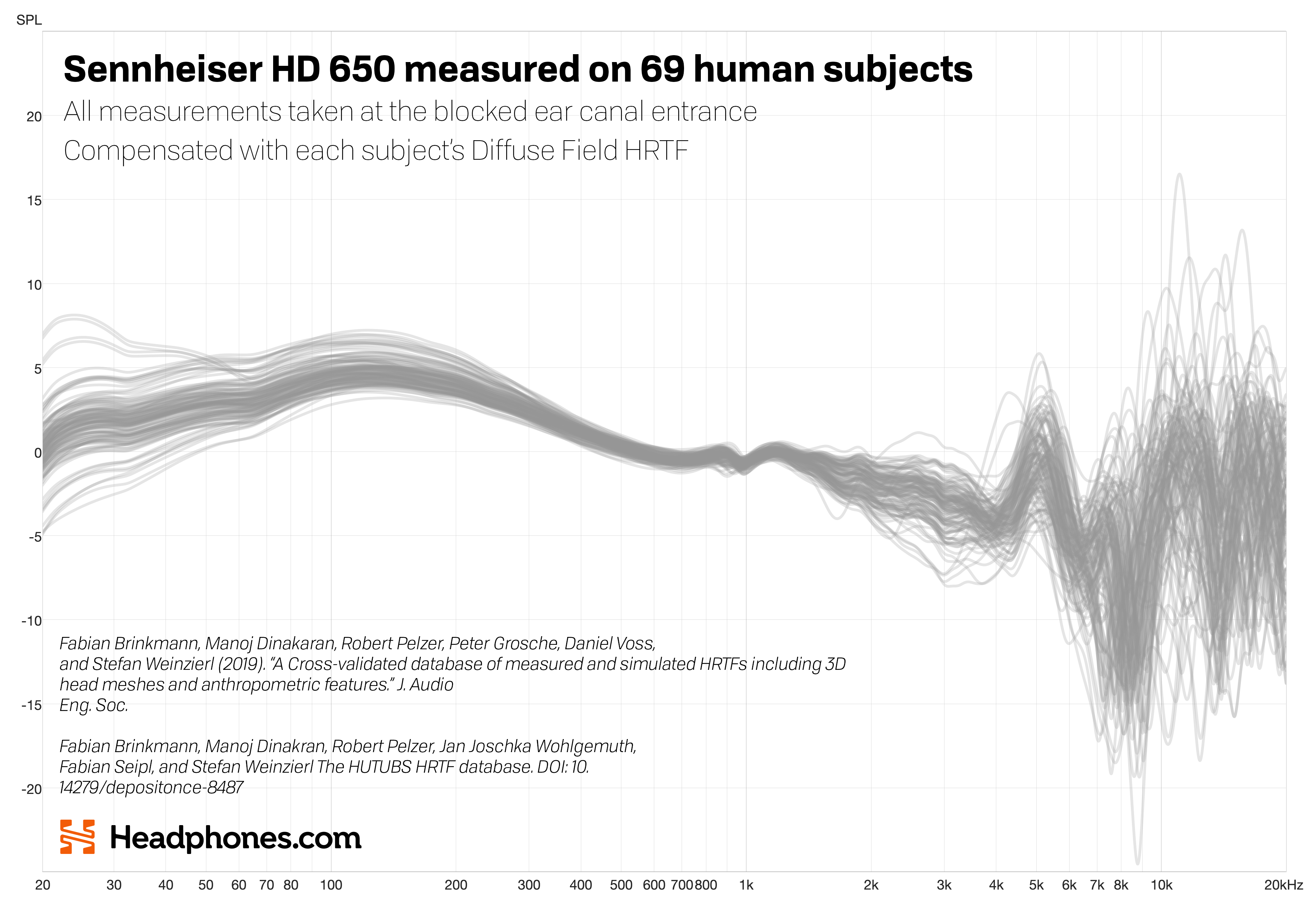

Interestingly, because the Welti ear produces headphone measurements closer to the humans in this dataset, it’s possible that EQing to Harman using headphone measurements done with this rig may have also addressed a commonly-occurring dip in the 6-9 kHz region that tends to pop up on measurements of headphones on human heads(7)(8).
Fig. 5: Sennheiser HD 650 as measured & Diffuse Field compensated on 69 human subjects at the blocked ear canal entrance (Credit: HUTUBS Database)(7)(8)
This is pure hypothesis on my part, but it is an interesting coincidence that many of the highest rated headphones in this study (including the target) were likely to have the most energy added in this oft-dipped 6-9 kHz band. While further verification is absolutely required to test this hypothesis, comparing this data against human database measurements like HUTUBS above revealed an intriguing correlation.
Regardless, this difference in treble alone between the Welti pinna vs. the others has many implications for responsible use of Harman’s work.
This means the Harman target and its associated model cannot reliably be used with measurements made on ears other than the Welti pinna… and 99.9% of the measurements we see posted in the wild will not have been measured on the Welti pinna.

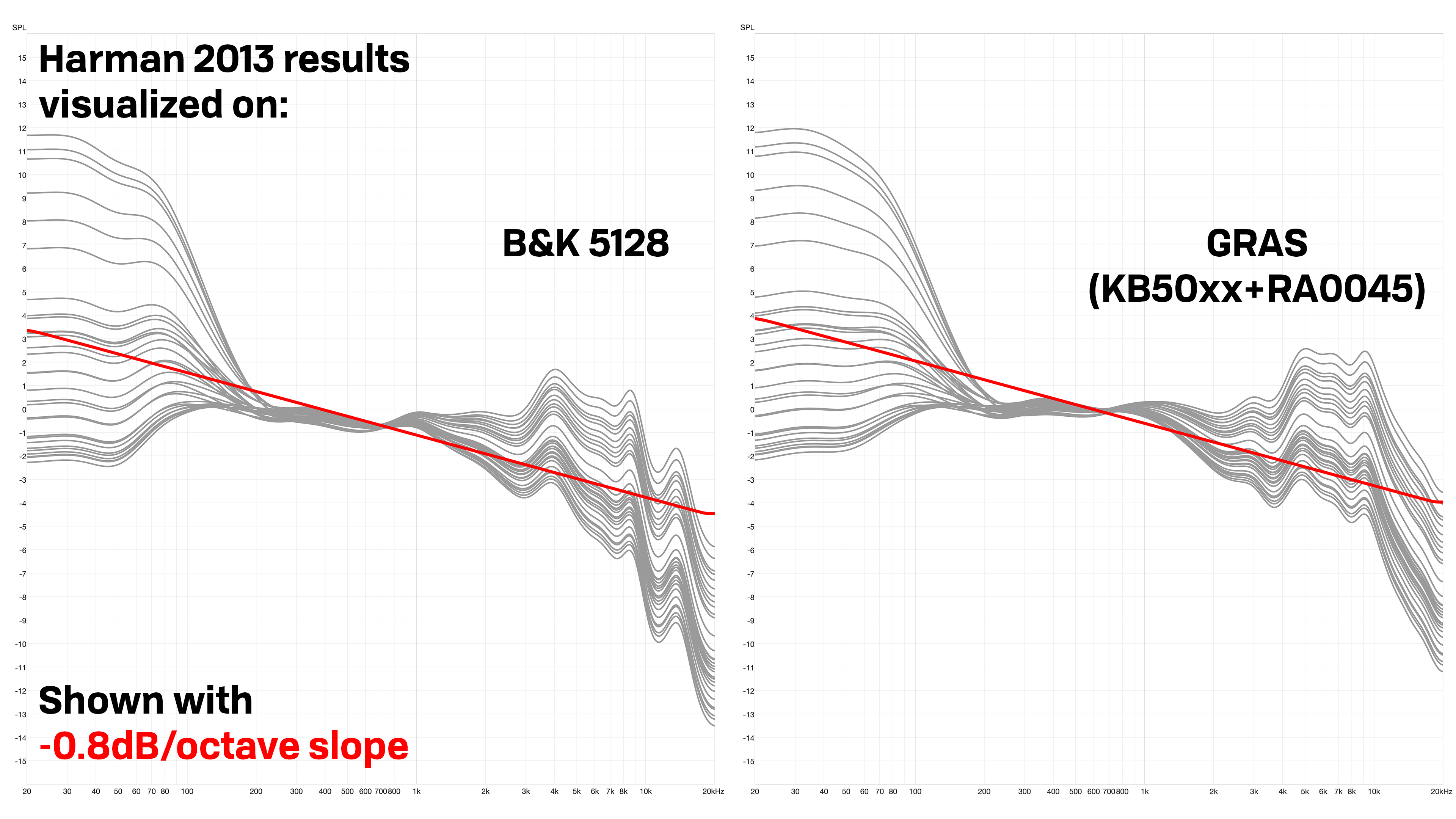

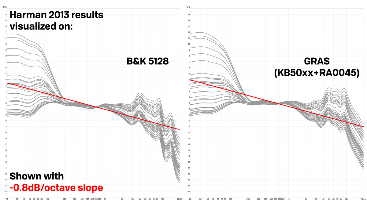

In 2013’s Listener Preferences for In-Room Loudspeaker and Headphone Target Responses(5), Harman made use of their “replicator headphone” methodology for the first time since validating its efficacy(3), and it worked quite well for eliminating non-sound factors from the pool of biases that would influence the preference results they got.
Harman’s researchers used a Sennheiser HD 800 for this study, where they measured it on their test fixture (GRAS 43AG-4 with KB007x ears), equalized it to the in-room response of that same test fixture when measuring a “flat in-room” pair of speakers, and allowed respondents to tilt the response to their preference by controlling the level of bass and treble.
Fig. 6: Frequency response of the Sennheiser HD 800 equalized to the “flat in-room” response of speakers measured on Harman’s test fixture (2013)
The use of the HD 800 for this specific task of being a “replicator” headphone ended up being one of the best choices they could’ve made for this study, but we’ll get to that. For now, here are the totality of the preference results when applied to the HD 800 measured & Diffuse Field compensated on the B&K 5128 and GRAS 43AG-7.
Fig. 7: Adjustments made by subjects in the 2013 Harman paper, but measured, EQed with the same EQ profiles, and Diffuse Field-compensated on the B&K 5128 and the GRAS 43AG-4 with the KB50xx ear, to see what these results would look like ported to newer systems. Results are ½ octave smoothed.
Note: Both of the pinnae used on these fixtures overestimate the treble between 4-12 kHz vs. what a human would receive on average. Diffuse Field compensation, which is applied here for each fixture using its own Diffuse Field HRTF, is not subtracting away these effects because is overestimation is a characteristic of the Headphone-to-ear Transfer Function (HpTF), which is distinct from the far-field transfer function of a Diffuse Field HRTF.
Regardless of what rig we display the spread of preference from this study on, we seem to get a fairly consistent look into the preferences of their test subjects, and this data would likely be replicable by other people using the same type of headphone. We can see a clear broad strokes trend—people preferred more bass and/or less treble than a strictly flat (Diffuse FIeld) response.

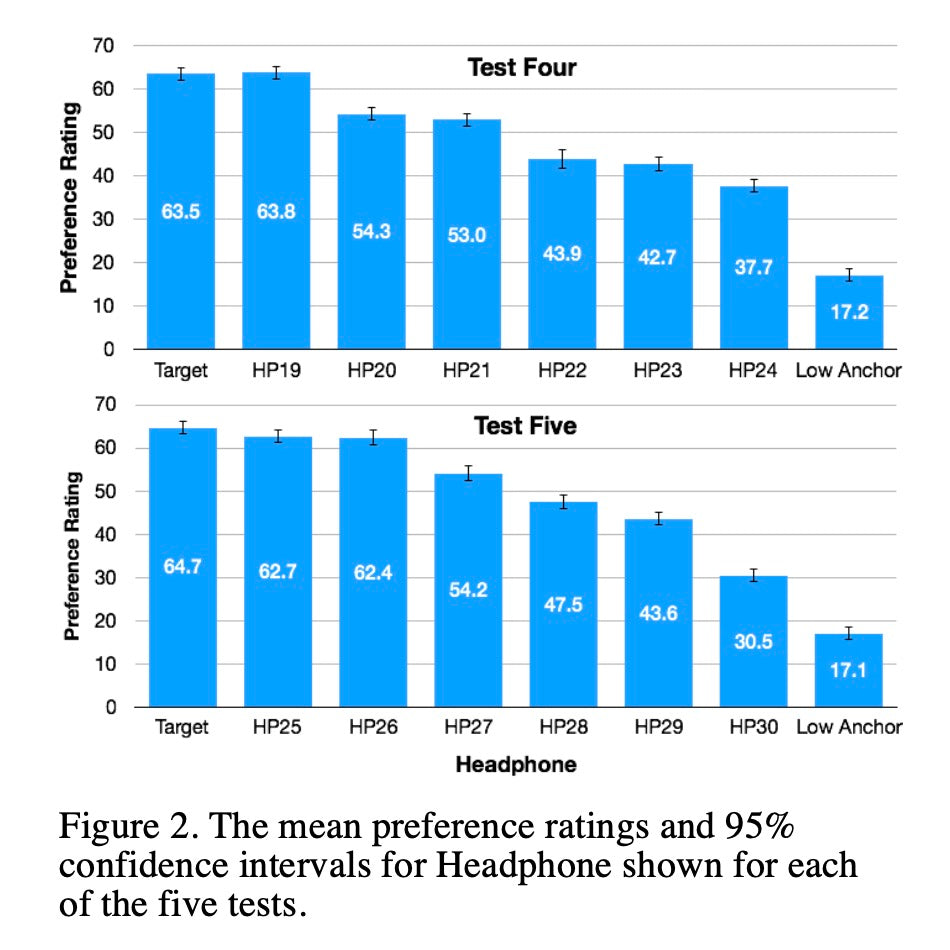

Additionally, while the target was obviously the highest-rated response on average, it was also not always clearly separated from every other response in every test run. It certainly was not the case that people thought Harman sounded good, but everything else sounded bad.
For example, while the target was ranked towards the top in every aggregated panel, it was statistically tied with HP19 (Shure SRH-840) in Test Four and with HP25 (Philips Fidelio X1) in Test Five.
Fig. 8: Averages & 95% confidence intervals of listener preference ratings for Test Four & Five from A Statistical Model that Predicts Listeners’ Preference Ratings of Around-Ear and On-Ear Headphones (2018)
This gives us some evidence that while the target was a very strong performer, it was not the only response listeners enjoyed.
Furthermore, when comparing all of the subject’s responses across tests without anchor-based rescaling, there were a good few other headphones that scored well, quite closely to the Harman Target, despite not being the #1 choice.

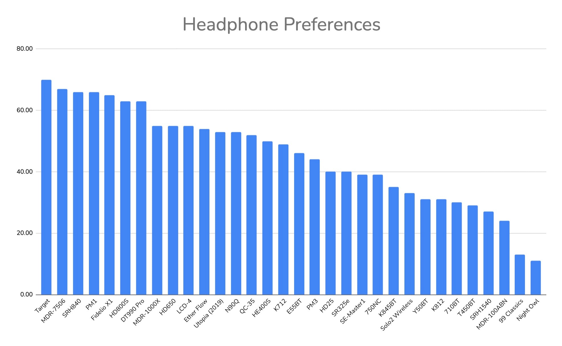

Test subjects were able to rate the virtual headphones on a 100-point preference scale, but they generally avoided the extreme ends of that scale. The Harman target averaged between 63.5 and 71.2 across the five tests, while the low anchor (Meze 99 Classics) averaged between 17.1 and 20.5.
This left the researchers with a 100 point scale where only ~54 points were being used. Rather than treat the test subjects’ use of the scale as the final preference scale, they opted to linearly expand the ratings to occupy a full 0–100 range between Low Anchor and Target, respectively.
The authors described this as a correction for contraction bias, and that is a reasonable thing to try and account for. People are often hesitant to use the very top or bottom of a rating scale, particularly in a comparative listening test where the listener is asked to judge multiple responses together.
While the Target & Low Anchor scored near or at the top and bottom respectively in all cases, their reported means and rankings still varied slightly from panel to panel. Some headphones scored higher than the Target, or lower than the Low Anchor. This meant the scores were free to travel over 100 or under 0 into the negatives after the results were re-scaled.
And again, this is where more issues arise. While scale normalization & anchor-based rescaling are standard statistical procedures used to correct for scale-use variability across test blocks in studies like this, the issue was not that they normalized for contraction bias, but that their specific choice to use linear anchor-stretching distorted the relative preference distances between top-performing headphones.
In other words, their rescaling exaggerated the degree of difference between top-performing headphone curves, making alternatives to the target look worse on paper than they were in the actual listening test results.
To restore the true relative preference distances, we reverted the anchor-stretching math to display the raw, un-rescaled preference ratings for Class 1, keeping the relative placement of the preference results intact, and what we get is this:

Harman was still the best curve tested on average, but right below it there are headphones that still tested rather well compared to Harman, and more importantly, compared to the rest of the headphone responses tested in this study. This group of “enjoyable, but maybe not as enjoyable as Harman, on average” headphones is also quite clearly separated from the next lowest group of headphones.
Class 1 gave the Harman Target a mean preference rating of 70. It also gave six non-Harman Target response profiles quite high ratings. While the original paper states that four headphone responses were equally preferred to the Target, we would say that these seven responses were closely grouped enough to be treated as “similarly good to one another”:
- Harman Target: 70
- Sony MDR-7506 - 67
- Shure SRH-840 - 66
- Oppo PM-1 - 66
- Philips Fidelio X1 - 65
- Sennheiser HD 800S - 63
- Beyerdynamic DT 990 - 63

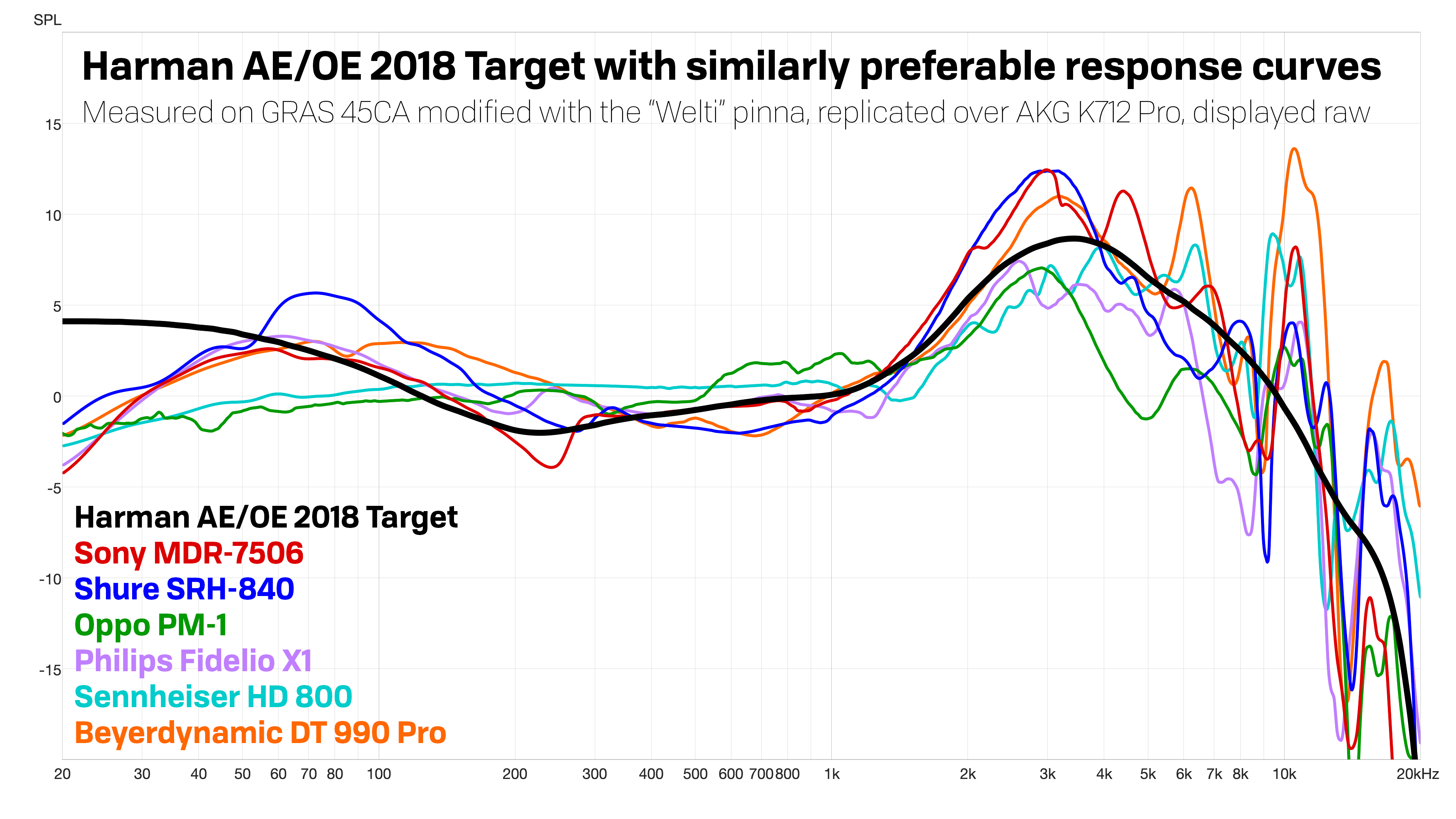

And if you actually look at these curves, while there are certainly differences, the overall trend is fairly obvious:

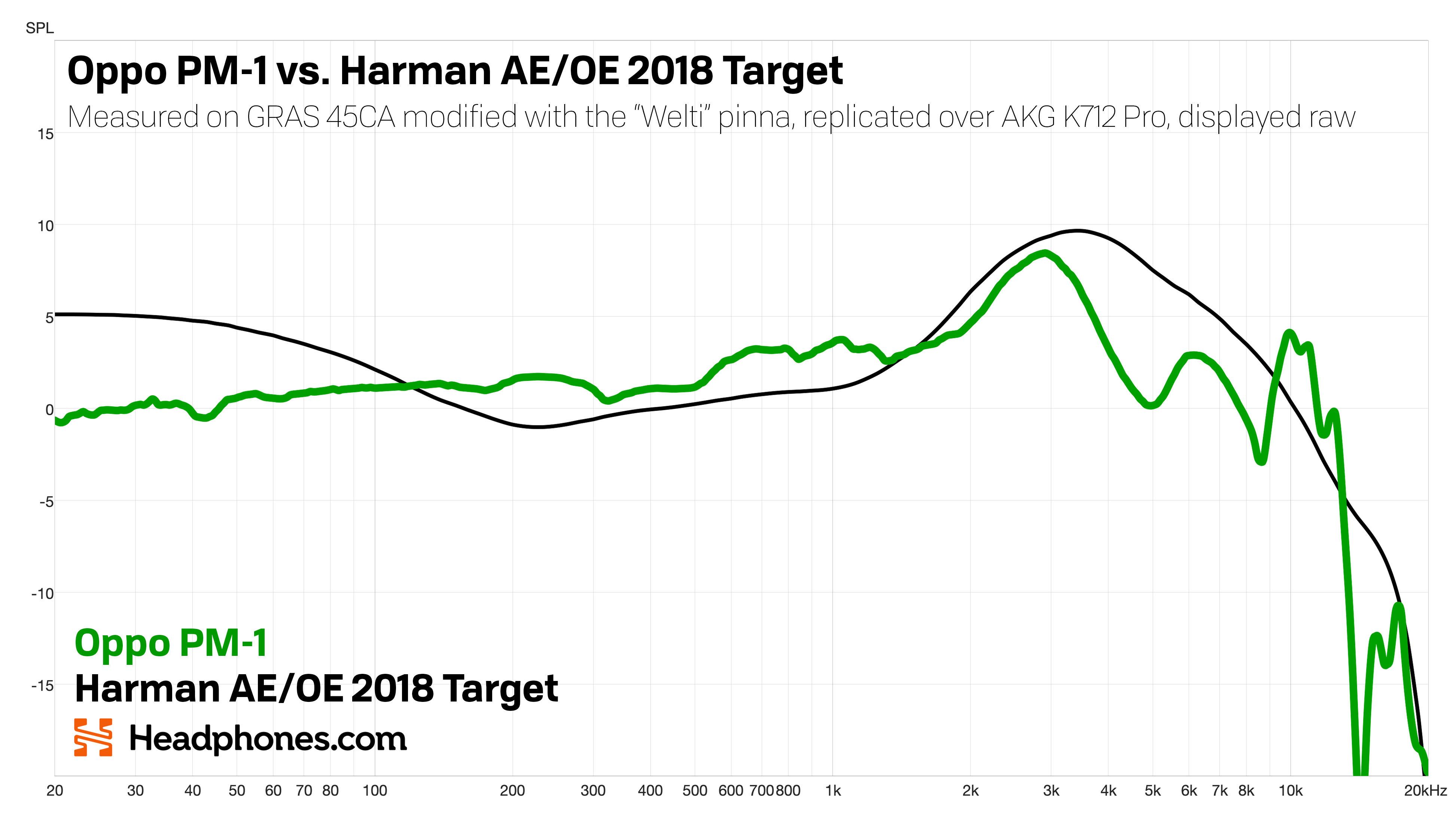

Fig. 10: The Harman 2018 AE/OE Target, with the six other similarly preferable curves.
While there are things in here that look meaningfully different than the Harman target, notably the Oppo PM-1 with its flat bass response & reduced 3-6 kHz region, the overall trend is that things that share the hallmark features of Harman’s target (HRTF-like shape, with more bass and less treble) tend to be quite well received by listeners.
These headphone curves are close enough to the target—both in score, and in frequency response trend—that it feels imprudent to use this fairly wide grouping of profiles to describe these listeners as simply “The 64% that prefer the Harman Target.”
Even if they like Harman, they like other things too, and this is the case with almost any listener. Nobody enjoys only one frequency response every time they’re tested, and Harman’s own research reflects this too.

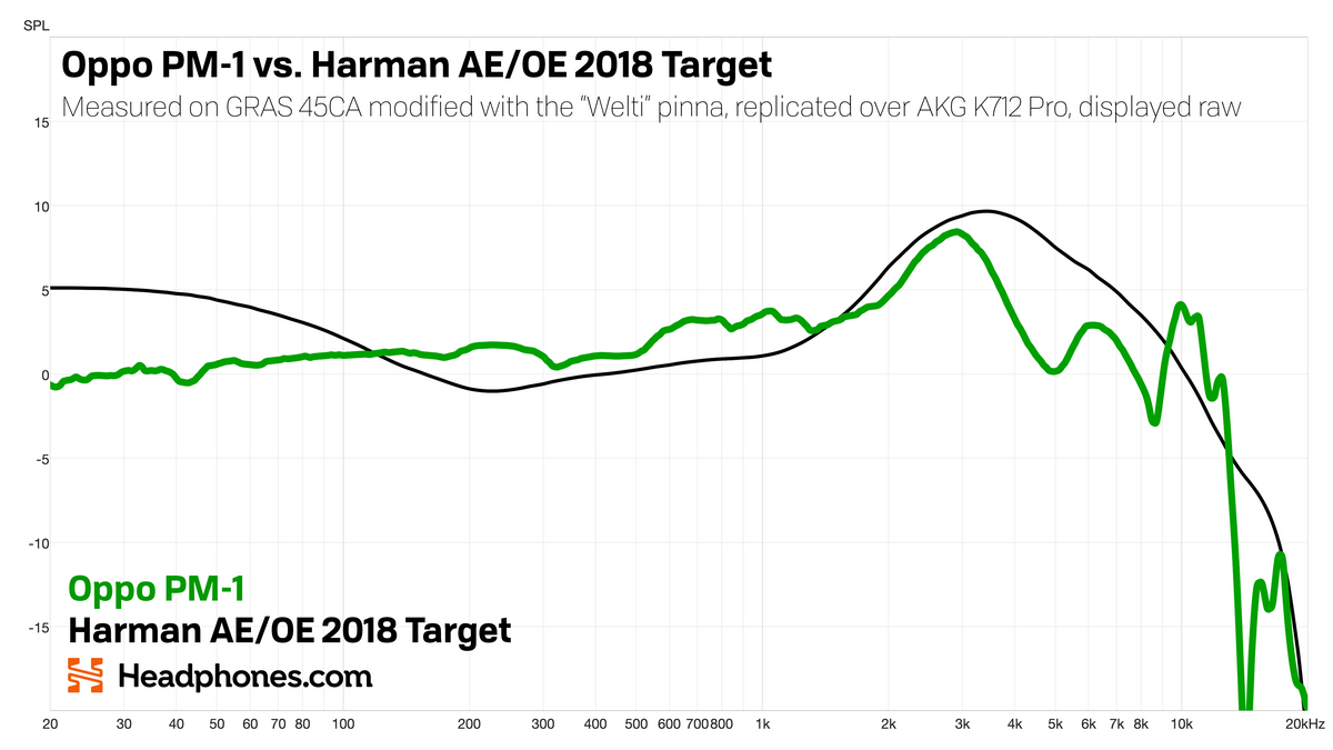

Fig. 11: Oppo PM-1 vs. the Harman target, illustrating that two extremely different frequency responses can be similarly preferred by the same people
Now, this isn’t meant to imply that every listener would be equally happy with every curve. But we do think that because even starkly different curves, like the Oppo PM-1, are within such a small distance score-wise, it makes sense to re-examine how we as a community think about this research.
Because the dominant class was not narrowly attached to one response, and most listeners aren’t either, we need to leave space in our discourse and interpretation of measurement data that accommodates more than one single target line as “good”.
Not only that, but this work also gives an inkling as to what sort of “non-Harman” response curves may be a defensible thing to aim for if you’re trying to maximize sound quality for a large segment of the population!

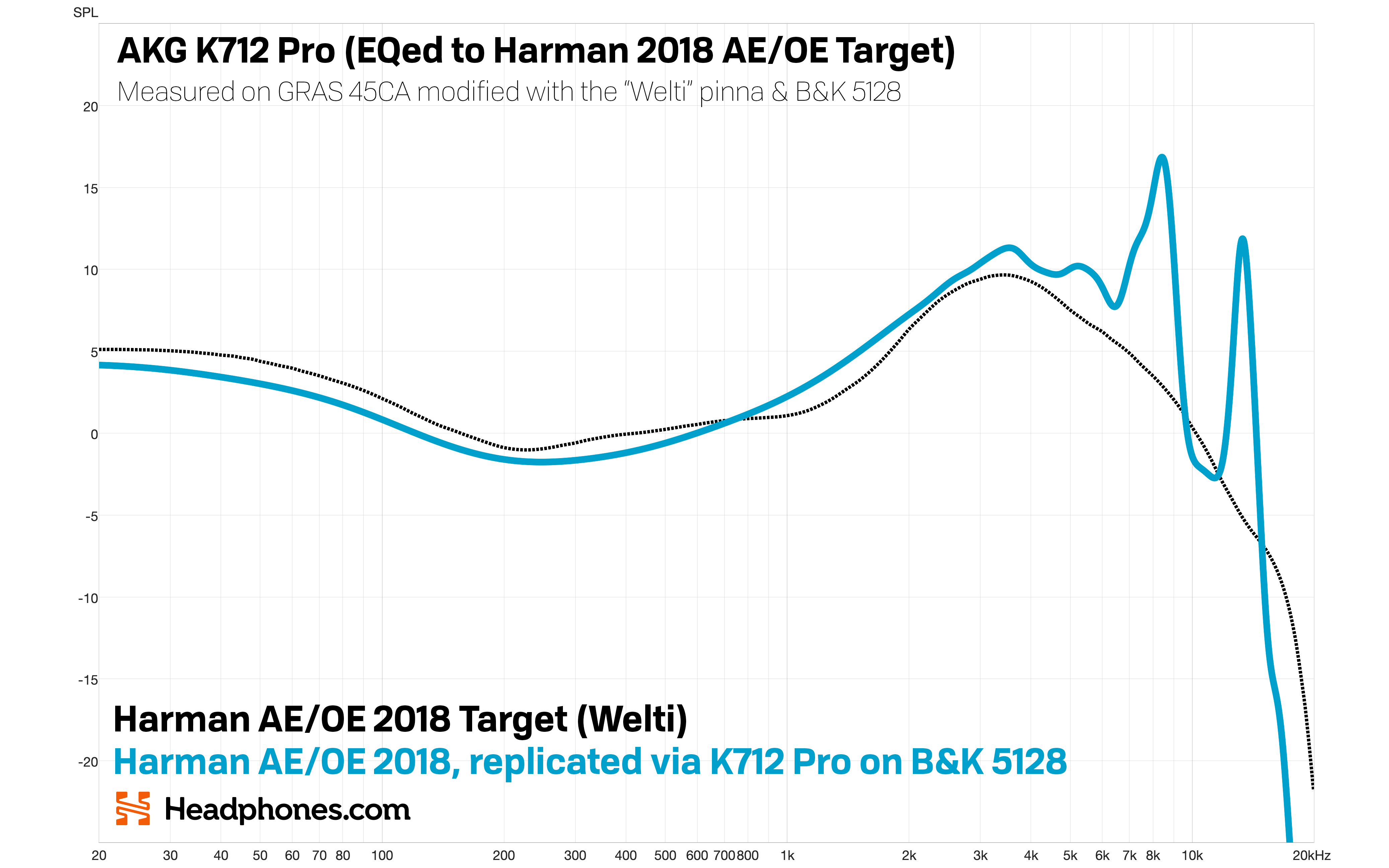

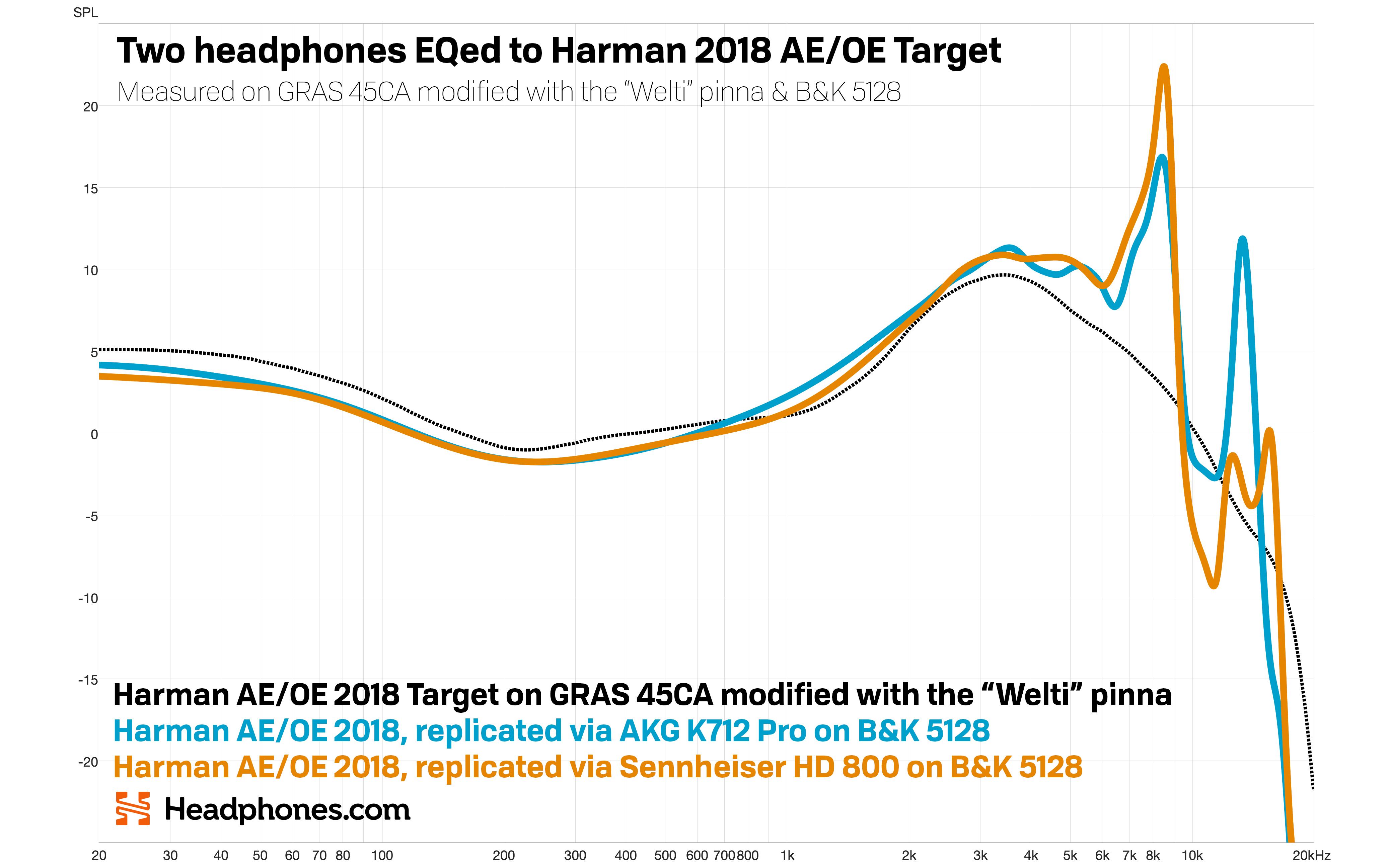

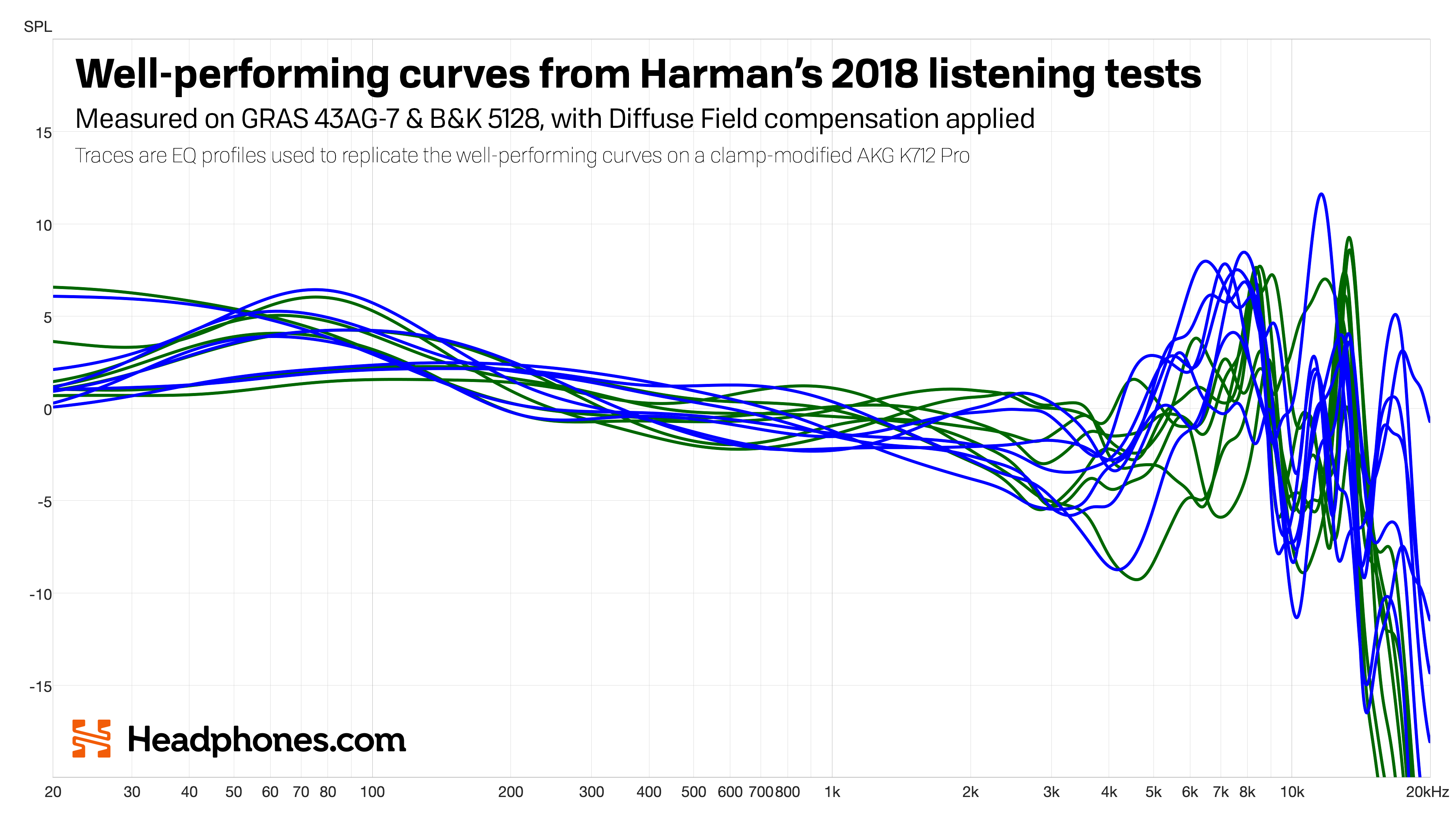

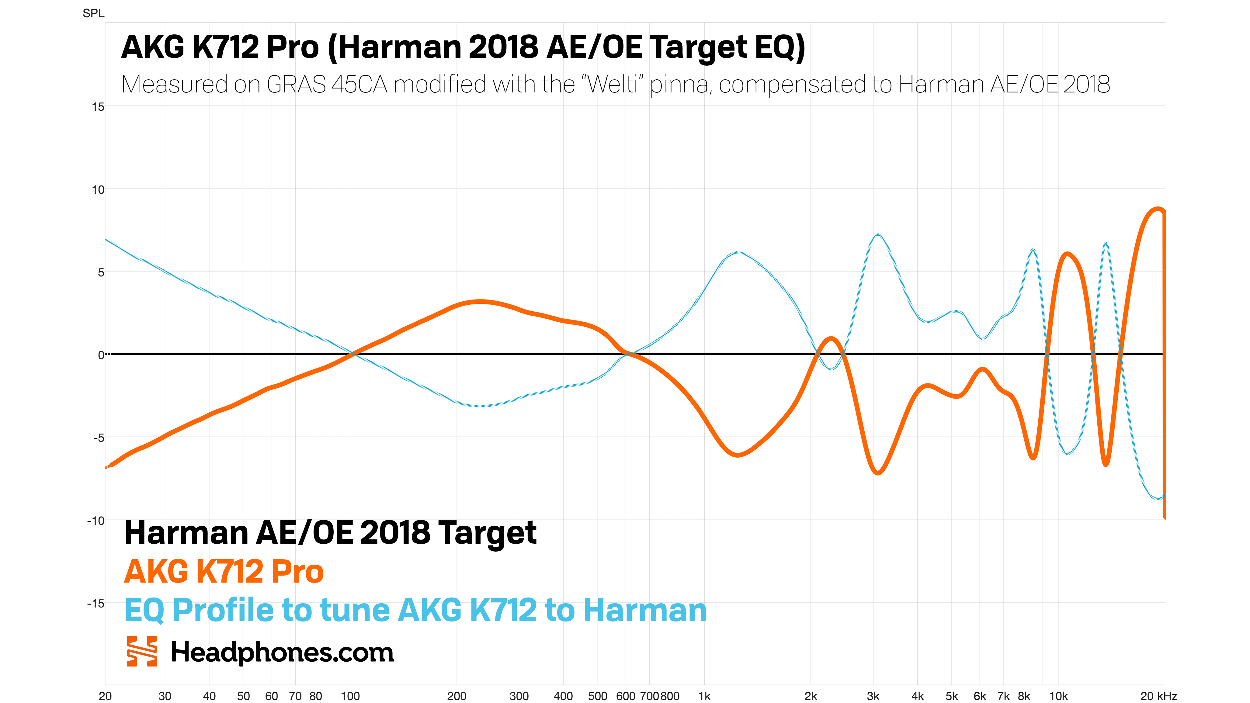

As we touched on in Problem 2: The Replicator Headphone, headphone targets from this era are almost always measured frequency responses of headphones, with smoothing applied.
But headphone measurements aren’t just headphone measurements: they’re measurements of the full acoustic system composed of the headphone and the ear it’s placed on. Which means the headphone and the ear both need to be known/quantified before making any assessments of how that measurement will relate to an actual listener.
This means that prior efforts to replicate the sound of this 2018 Harman AE/OE target using different replicator headphones on different fixtures were starting from a faulty premise(10). Because the interaction of headphone geometric & load behavior is headphone-specific and ear-specific, any attempt to replicate the results of this study would absolutely need to start with the AKG K712 Pro.

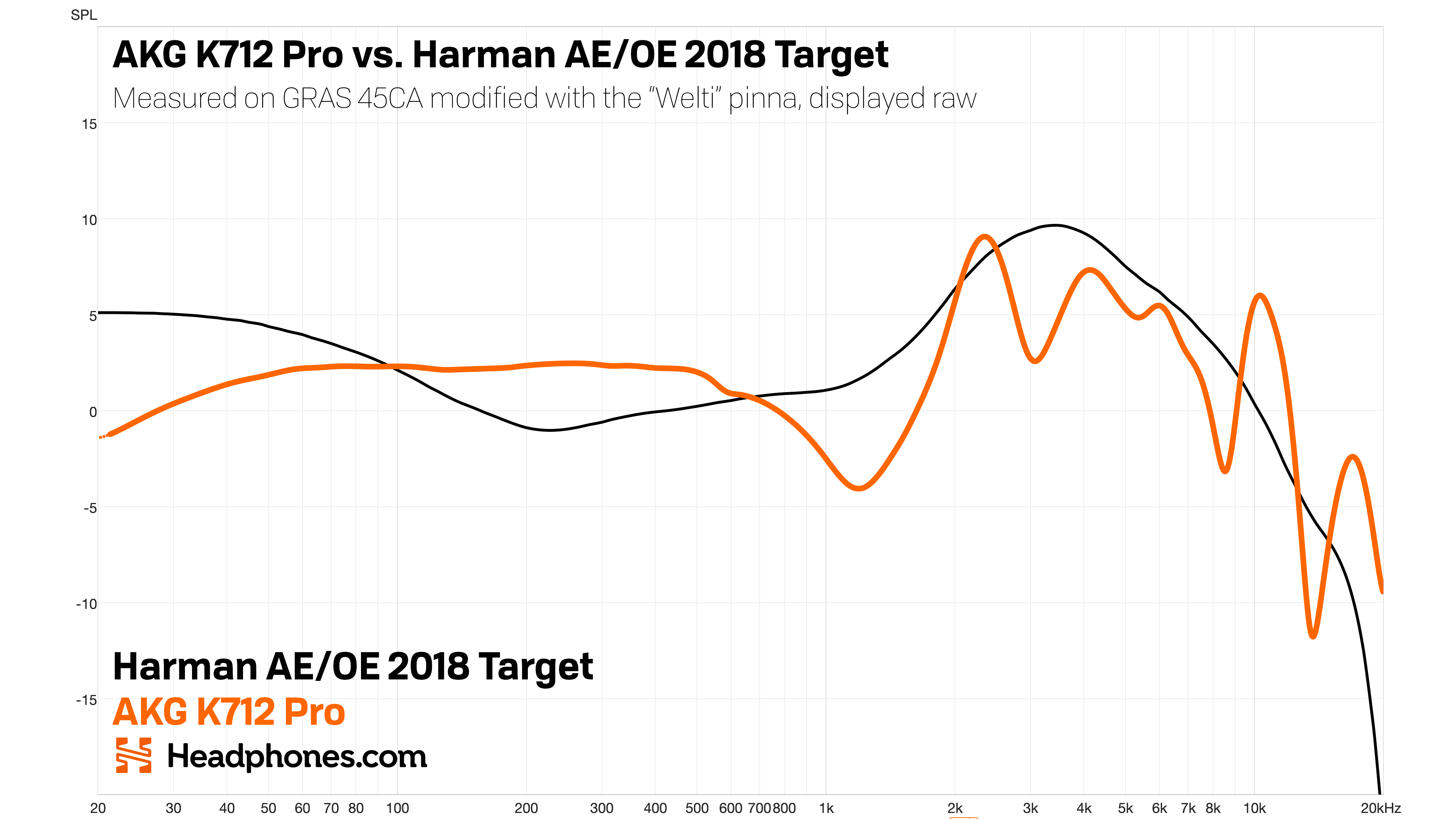

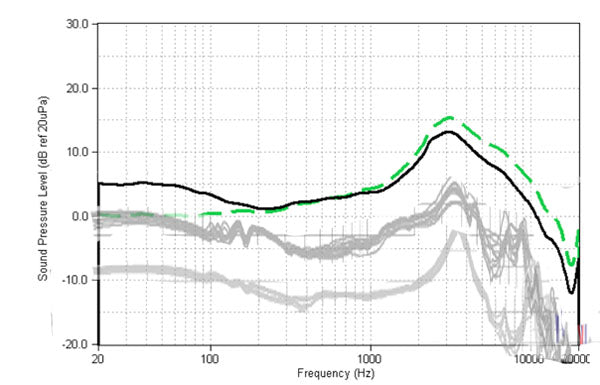

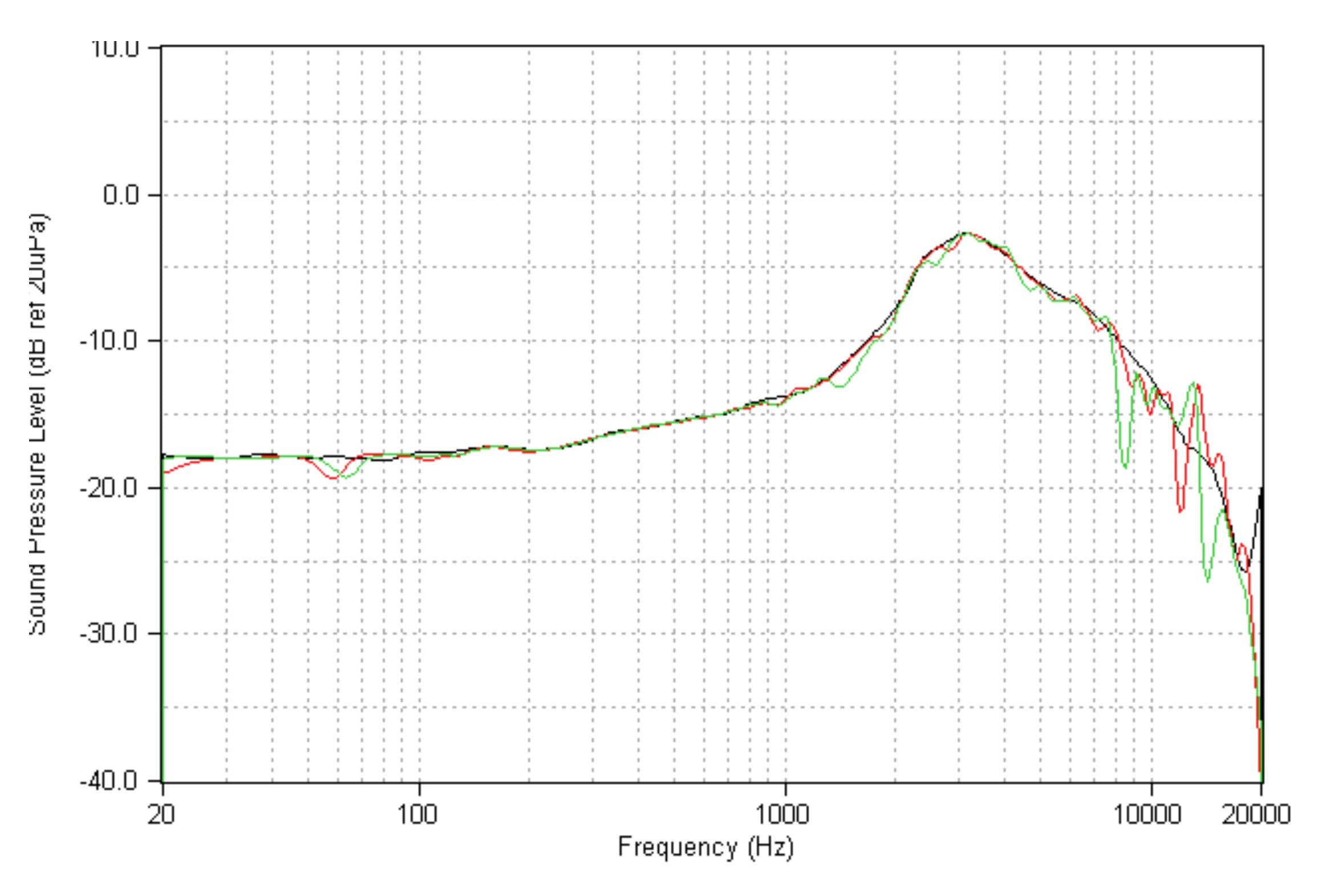

So let’s consider the AKG K712 Pro (smoothed to 1/6th octave) measured on the Welti ear versus the Harman 2018 target.
Fig. 12: Sean Olive’s original measurement of the AKG K712 Pro from A Statistical Model that Predicts Listeners’ Preference Ratings of Around-Ear and On-Ear Headphones (2018), plotted against the Harman AE/OE 2018 Target
Obviously, the K712 Pro is not very adherent to the Harman target, so to get this headphone to replicate the response of the Harman target, corrections needed to be made.
For this headphone to match the target, the sub-bass needs to be lifted, the low midrange needs to be reduced, the upper midrange needs serious reshaping— the ~1 kHz and ~3 kHz areas need a lift, while 2 kHz needs a slight reduction—the low treble and mid treble needs a lift, especially around 8 kHz, while the upper treble needs to be cut around 10 kHz, etc.
Fig. 13: Sean Olive’s original measurement of the AKG K712 Pro (orange) and the error curve relative to the Harman target used for equalization, from A Statistical Model that Predicts Listeners’ Preference Ratings of Around-Ear and On-Ear Headphones (2018)
This is where the nature of making narrow-bandwidth adjustments to a “smooth” target on a test fixture comes back to bite us. Even if these narrow-band adjustments are not what we’d ordinarily recommend for correcting headphones, that is what was used in the original study. In other words: The Harman 2018 AE/OE headphone target is the sound of the specific AKG K712 Pro used in this study, with the EQ profile above (dotted blue line) applied to it.
This means even the narrow band, ear-specific and headphone-specific adjustments—like the 8 kHz dip being filled in, the 11 kHz peak being notched out, the 13 kHz being boosted dramatically—are still adjustments that reflect exactly what people heard when listening to this target response and reporting their enjoyment.
Because this headphone—and every other headphone in the study—has specific features when measured on the Welti pinna, these features affect what frequency response features were ultimately heard by the subjects in the listening panel.
But since different ears commit different treble response filtering on input, the frequency response measured on other ears is likely to look a little weird, since doing so is essentially replicating the inverse of the ear-specific effects from the original ear that aren’t likely to show up on the second ear.
For example, when you apply the same EQ to the same type of headphone, an AKG K712 Pro with an extra clamp modification, and measure it on a different fixture like the B&K 5128, you get quite a different result:
Fig. 14: AKG K712 with a clamp modification measured on the B&K 5128 with the original filtering as derived from the measurements on the Welti pinna equipped fixture to make it adhere to the Harman 2018 AE/OE Target
And as an example of the interactions being, well, headphone-specific, if we do the same thing for a different headphone—the Sennheiser HD 800, also measured by Sean Olive on the Welti pinnae-equipped fixture—we get a different result:
Fig. 15: AKG K712 with a clamp modification and Sennheiser HD 800 measured on the B&K 5128 with filtering derived from their measurements on the Welti pinna-equipped fixture to make them both adhere to the Harman 2018 AE/OE Target
Early on in the time of 5128’s adoption, many people in the headphone science community tried doing something like this. However, because our understanding of inter-fixture relatability at the time was flawed/incomplete, most thought this to be something that obviously can’t represent the sound of the actual Harman target. After all, look at those massive treble elevations! Where is the inviting visual smoothness of the Harman target we love so dearly?!
This denial was based on erroneous ways of thinking about measurements and targets. As said, headphone targets up to this point had predominantly been headphone measurements with generous smoothing applied, but if you move a headphone that is EQed smooth on one ear, to a different ear, it will be producing meaningfully different high-Q features in the treble that will cause what was “smooth” on one ear to look quite “unsmooth” on another, even if they sound the exact same to an actual listening test subject.
The fact remains: the above measurement of the AKG K712 Pro with extra clamp, EQed with the same filters from the original study, measured on the 5128, is likely the closest we’ll ever be able to get to transposing the 2018 Harman target to the B&K 5128, as it is the most direct method possible to do this.
But now that we know that the target was not the only likable response for the dominant class of people, and we know that different headphones EQed to the same target even on the original measurement rig will produce different results when measured on another rig, it’s worth asking:

So we recreated all of the well-performing profiles—the Harman Target, Sony MDR-7506, Shure SRH-840, Oppo PM-1, Philips Fidelio X1, Sennheiser HD 800, and Beyerdynamic DT 990—but we did it in a way that we feel is more defensible than prior efforts.
We measured the clamp-modified AKG K712 Pro on the GRAS 43AG-7 with KB500x ear and the B&K 5128, adjusted them using the same exact EQ profiles applied to the AKG K712 that would’ve been used to simulate the other curves in the original 2018 study, and then compensated all of the responses with each fixture’s Diffuse Field HRTF.
Some may argue that porting the 2018 filter transfer functions onto modern 5128 and GRAS fixtures is an interim step until new double-blind tests are conducted natively on these rigs, and we agree. However, laying a static Welti target curve directly over a KB500x or 5128 measurement without accounting for pinna transfer functions is simply incorrect. Synthesizing the underlying 2018 filter transfer functions onto the ear geometries/impedances that are actually producing most of the data in our space is the most scientifically rigorous bridge available today if we want to use this research (and of course, we do).
The below graph shows the actual field of preference variation among these “good” curves, including the Harman target, across both of the industry-standard measurement fixtures we use.
Fig. 16: Measurements of the AKG K712 Pro measured on GRAS 43AG-7 (blue) and B&K 5128 (green) replicating the frequency response EQ curves for the Harman 2018 AE/OE Target, Sony MDR-7506, Shure SRH-840, Oppo PM-1, Philips Fidelio X1, Sennheiser HD 800, and Beyerdynamic DT 990. All curves are compensated with the Diffuse Field HRTF of their respective test fixture, and progressively-smoothed with a self-developed smoothing algorithm (1-octave smoothing until 2 kHz, to 1/3 octave at 3 kHz, 1/6 octave at 4 kHz, continuing to 1/12 octave at 10 kHz.)
And what we get may look surprising, but remember what we went over in the prior sections:
- These rigs overestimate the response in the 4-12 kHz band, which means it likely shouldn’t look like the oft-discussed “linear downslope” used as a proxy for the broad conclusions of Harman’s work (ie. “people prefer less treble and more bass than speakers that measure flat in a room”).
- While the field of results here very clearly has a strong 8 kHz peak and 10 kHz dip, this is a result of the K712 Pro measured on the Welti ear producing a strong 8 kHz dip and 10 kHz peak when measured on these specific fixtures. Regardless of how it looks, this is the best characterization of what the listening test subjects ultimately received and preferred would look like on these systems.
- The results between the two fixtures do not perfectly agree, because they have different geometry—which affects the results above 3 kHz quite strongly, even after Diffuse Field compensation—and because they have different input impedances, which has effects across the entirety of the frequency response.

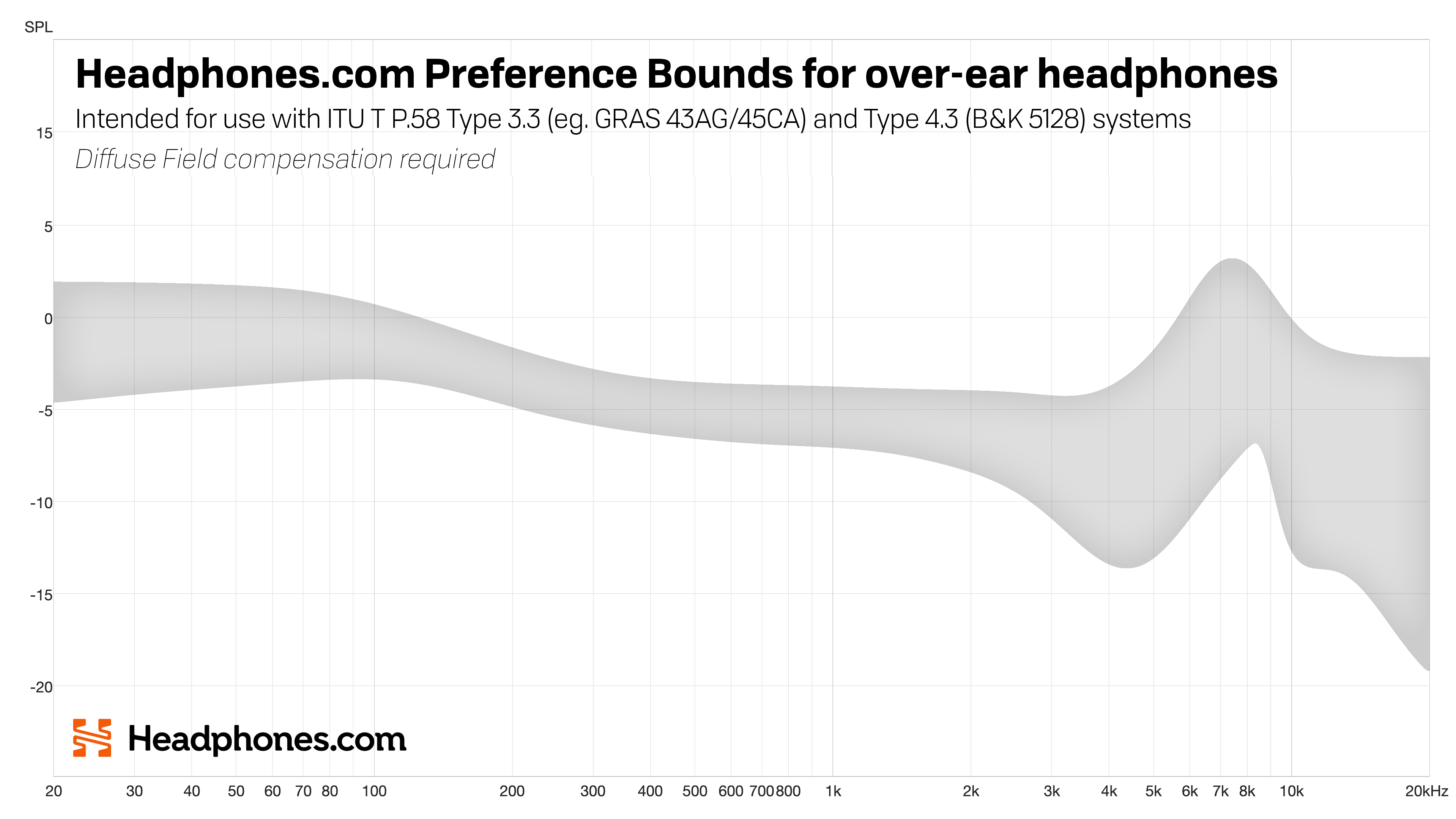

To turn this field of curves into a properly usable Preference Bounds space, we reject the outermost 10th percentage of results to eliminate any obvious outliers, while also making a judgment call similar to the original research not to put too much stock into fine-grained features above ~10 kHz or so (especially those that show up in only one headphone response’s measured result).
And the result is this, our new Preference Bounds for ITU T P.58 Type 3.3 (GRAS) and Type 4.3 (B&K 5128) fixtures, meant solely to be used with Diffuse Field compensated measurements of over-ear headphones:
Fig. 17: Headphones.com’s new Preference Bounds for ITU T P.58 Type 3.3 (GRAS) and Type 4.3 (B&K 5128) fixtures, meant solely to be used with Diffuse Field compensated measurements of over-ear headphones
The above may look strange at first glance (particularly in the treble), but this field of variation contains the best possible transposition of the totality of the preferable results from Harman’s 2018 paper to the fixtures we and our community use, and we hope just looking at this provides people with context they have been missing from prior visualizations of Harman’s output for years now.
Keen readers may have already expected it to look like this, because for a long while now we’ve been looking at Diffuse Field compensated headphones measured on, for example, the B&K 5128, that have shown behavior in the treble that seemed at odds with what people were actually hearing.
And there's a good reason for that: As mentioned prior, Diffuse Field compensation alone does not account for the overestimation of treble when these rigs are measuring headphones, because the closely-coupled earfield interaction of a headphone is both of a different directionality of source and of a meaningfully higher collective acoustic impedance than the far-field interaction of measuring speakers around the head in a Diffuse Field.
This disconnect, as well as the Headphone-to-ear Transfer Function on the ears of these fixtures overestimating treble, is why you'll often see a large 8-9 kHz peak even on headphones that (can) actually dip strongly in this region on human heads, like the Sennheiser HD 650 we looked at human measurements for earlier.

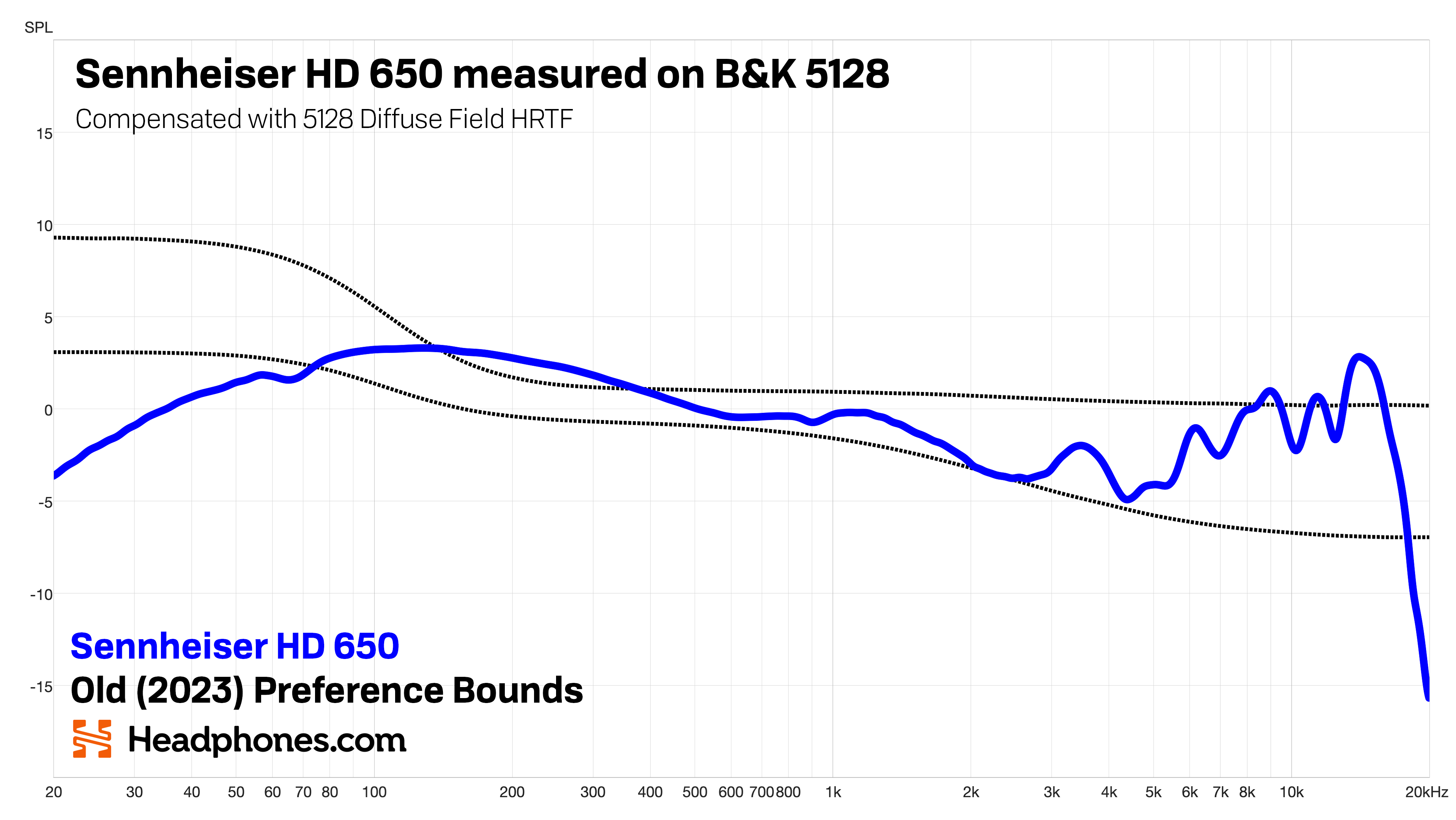

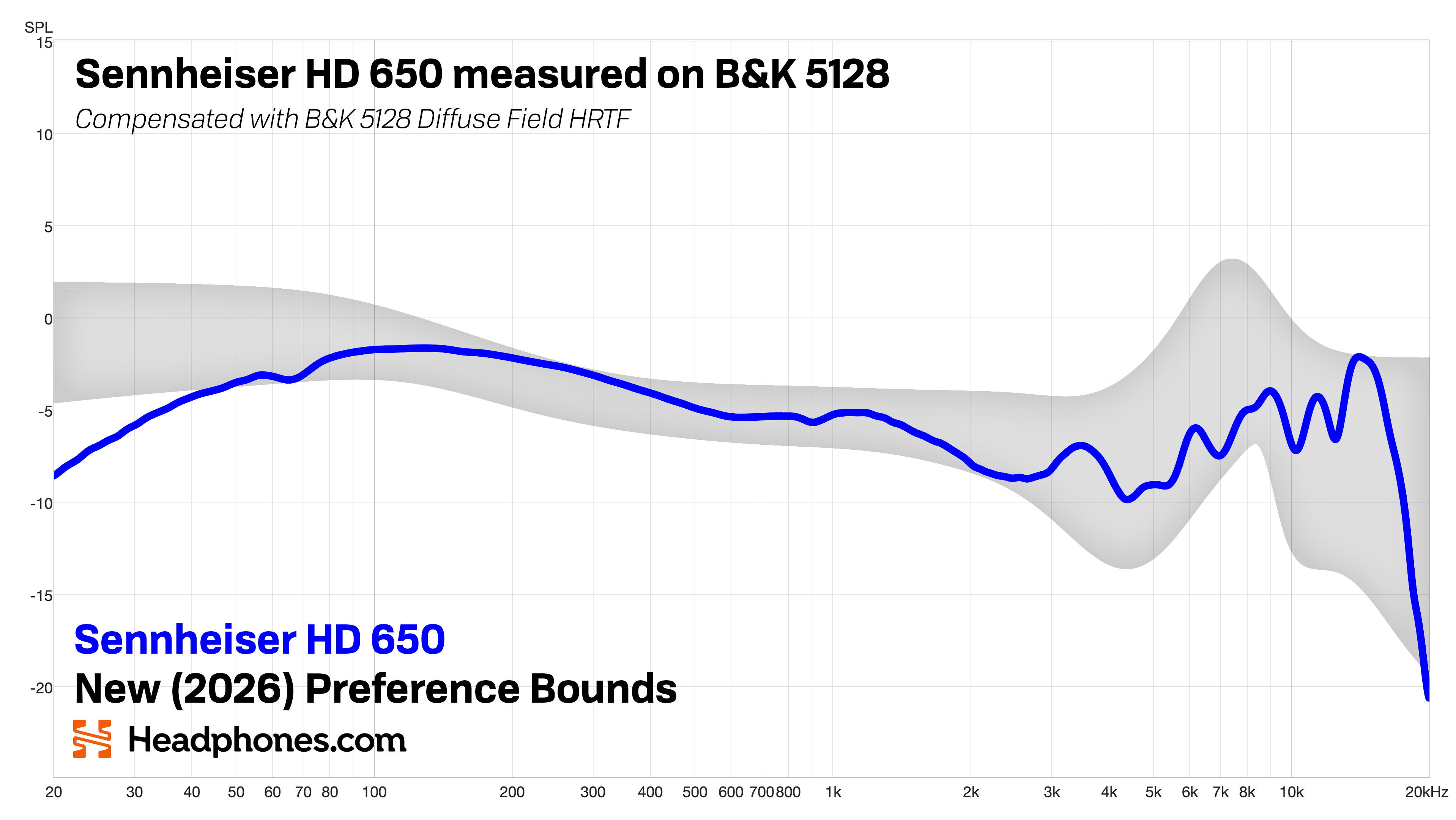

Fig. 18: Sennheiser HD 650 measured & Diffuse Field compensated on the B&K 5128, displayed against a -1 dB/octave downslope
Our 2023 Preference Bounds directly lifted the method-of-adjustment filters from Harman’s 2013 paper. While faithful to that specific experiment, that study's adjustments were constrained by a fixed second-order 105 Hz bass shelf. This created a pronounced 200 Hz 'bass tuck' in the Preference Bounds that overestimates how problematic this area of the response would actually be for people.
In faithfully reproducing the treble adjustments solely through their adjustment values (using a first-order high shelf), the exact shape of the frequency response is also not quite as accurate as it could be for actual headphones measured on the systems we use (as seen in Fig. 7).
Fig. 19: Sennheiser HD 650 measured & Diffuse Field compensated on the B&K 5128, displayed against our old Preference Bounds
Over-indexing for this specific shape of low-shelf boost can make HD 650 seem too “warm” in the midrange, despite many enthusiasts and recording professionals finding it one of the most accurately-produced midrange tunings in the entirety of the headphone sphere. Over-simplifying the frequency response in the treble to simple shelf filter shapes underestimates the magnitude and complex shaping of the treble that headphones measured on our fixtures would actually produce.
So unlike this older approach, our new Preference Bounds now account for both the idiosyncratic treble behavior of headphones measured on the rigs people currently use, while also accommodating a wider breadth of preferable bass elevation shapes.
And as a result, the HD 650’s compliance to what most would call an “excellent-sounding midrange and treble presentation” is much more obviously laid out, while aspects most people would object to like its bass rolloff or its mid-treble being a bit on the relaxed side, are shown much more clearly.
Fig. 20: Sennheiser HD 650 measured & Diffuse Field compensated on the B&K 5128, displayed against our new Preference Bounds
For these reasons, we think our new Preference Bounds are a serious leap ahead of prior visualizations of headphone measurement data done on ITU T P.58 Type 3.3 and 4.3 systems, including our older Preference Bounds, as well as the Harman Target itself.
This does implicitly mean that the “Diffuse Field + flat slope” method that has been used with over-ear headphones up until now by many (especially on sites like squig.link) should probably fall by the wayside, at least when it comes to measurements on these fixtures. The flat slope was only ever a crude estimation of the general trend of bass-to-treble delta that people in the speaker and headphone literature prefer, but as we've talked about, people tend to take anything that looks like a target and treat it like one, even when it shouldn't.
So I'll say it here again: A simple flat slope does not account for the overestimation of treble that these modern industry-standard test fixtures actually have, so the "flat slope targets" people are using should probably be eschewed going forward.

We did in fact make new preference bounds for IEMs measured on the B&K 5128 based on Harman/Sean Olive’s work from 2016 to 2025, but there are a few things people need to know about this data before we go further.
The data we’re using is based on Sean Olive’s measurement of the Sennheiser Momentum IEi taken from the Brüel & Kjaer Type 5128. IEMs measured in this fixture tend to portray two artifacts that don’t show up in human measurements:
- There is a “rocking mode” between 100-200 Hz that arises due to a spring mass resonance being formed between the tension of the eartip in the silicone ear canal entrance of the 5128 + the mass of the IEM itself. This resonance gets excited by sine sweeps (the stimulus we use to measure IEMs) and the result is a little Z-shaped or N-shaped artifact that will be present around 200 Hz in some of the curves shown
- There is a slight (~1 dB) underestimation of the 400 Hz band for IEMs relative to what humans receive when wearing/listening to the same IEMs.(9)
With these idiosyncrasies in mind, let’s move to the data.

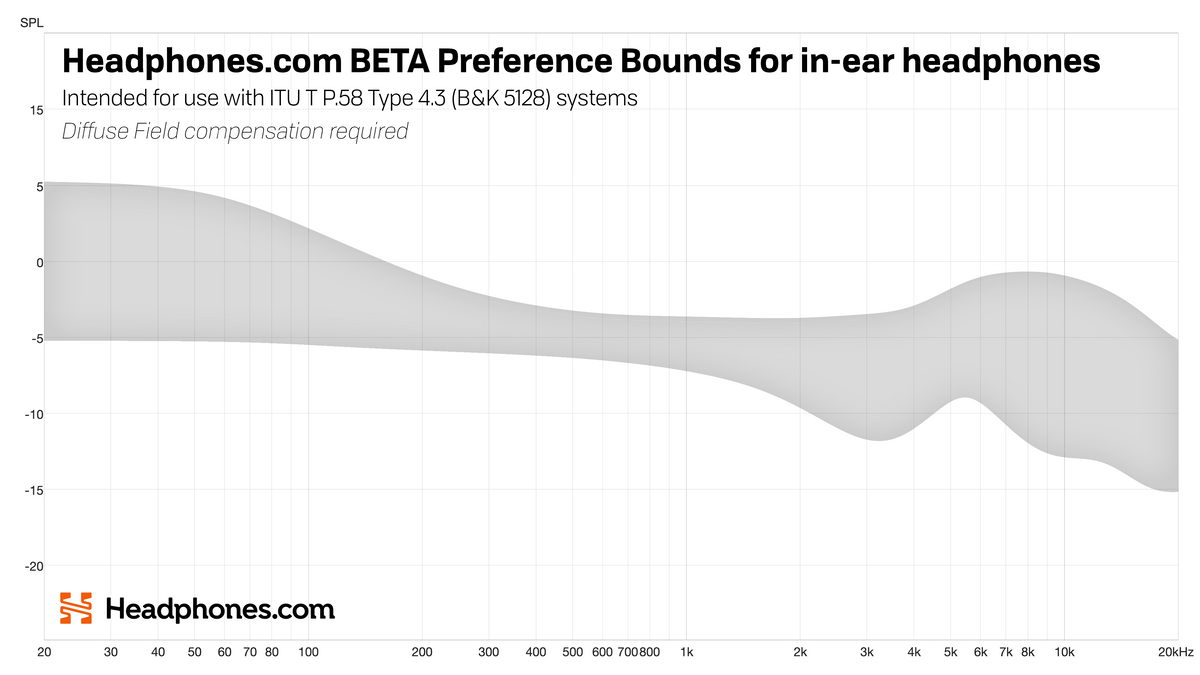

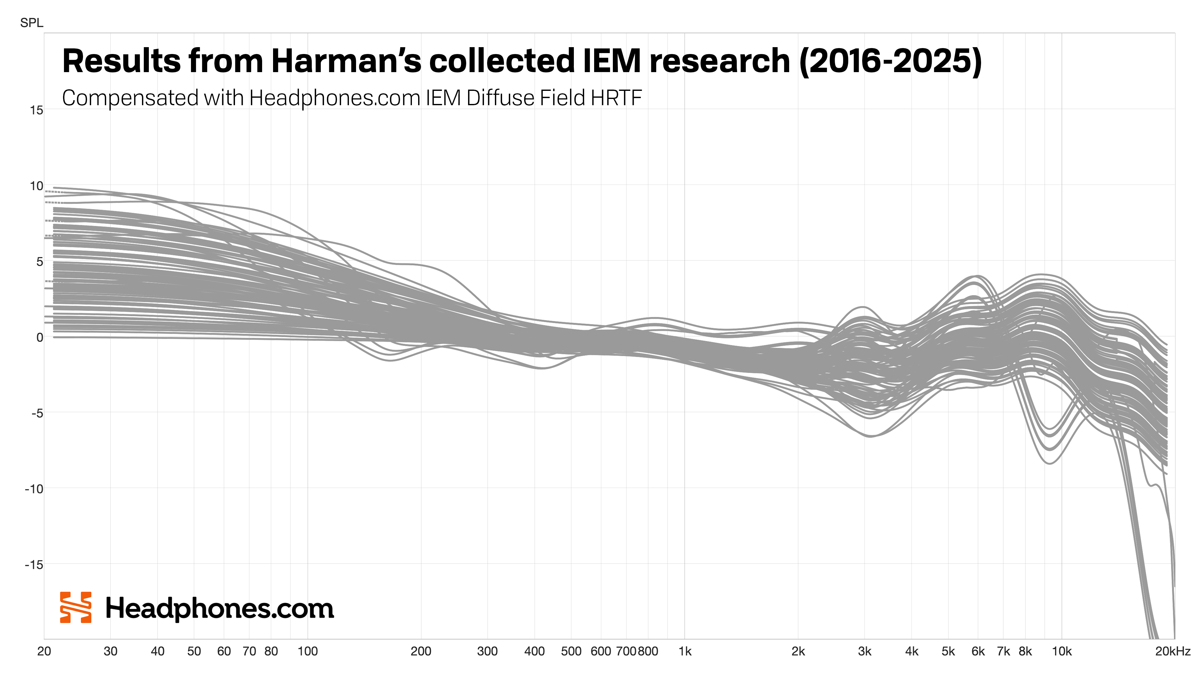

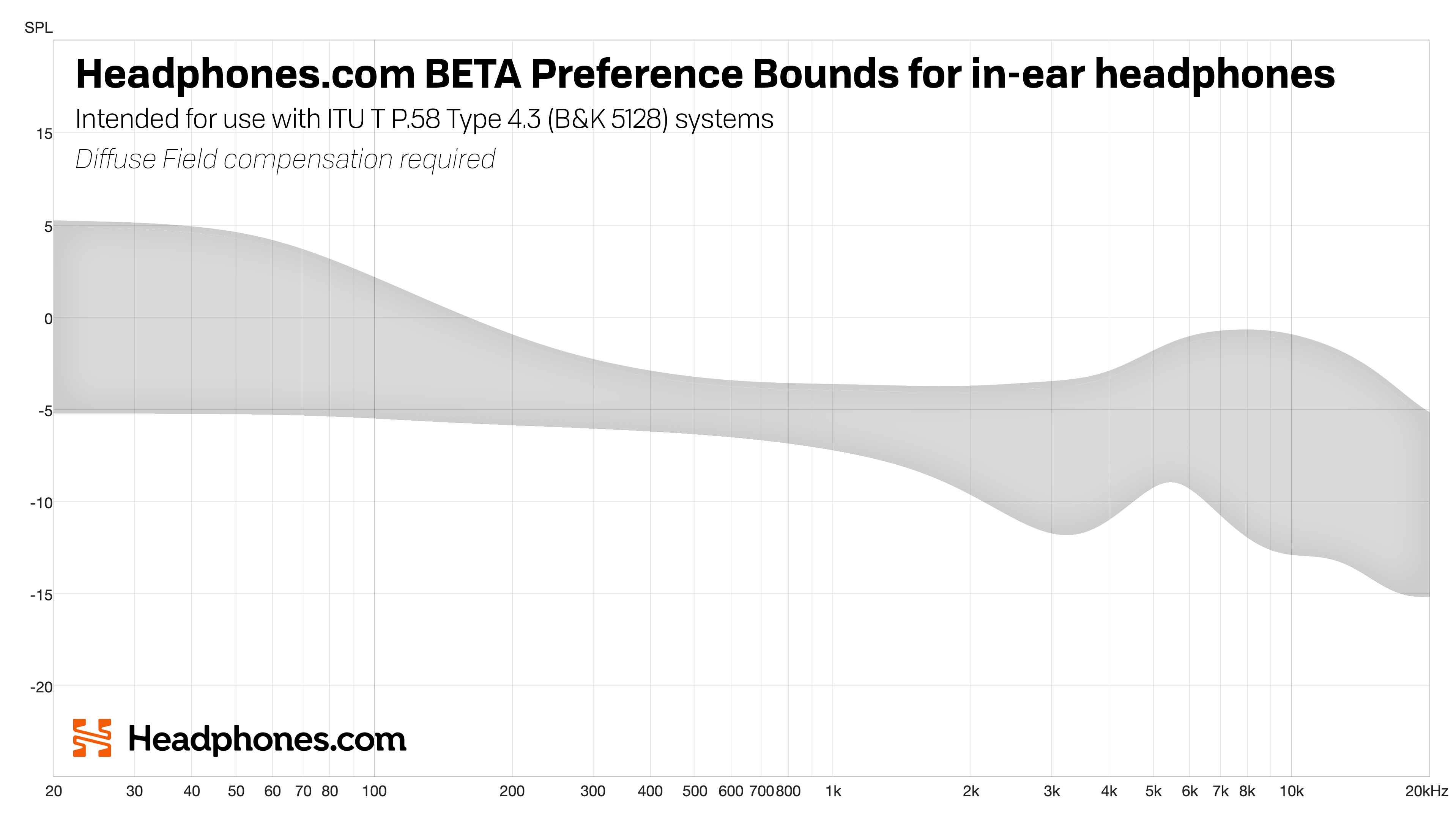

For the goal of making a boundary space to describe the range of listener preference in IEMs, we adopted a similar approach as before. We took Sean Olive’s measurement of the Sennheiser Momentum iei, applied all of the EQ profiles preferred in Harman’s aggregated work, and then used Diffuse Field compensation (using the Headphones.com IEM Diffuse Field HRTF) to see a full spread of what listeners actually prefer.
The below field of variation includes the totality of the preferred responses from Harman/Sean Olive’s work between 2016 and 2025, including of course the Harman IE 2019 Target and the SoundGuys target.
Fig. 21: All preference adjustment results from Harman’s IEM studies 2016-2025, as replicated on a Sennheiser Momentum iei measured on B&K 5128
Adding a boundary to encapsulate this field of variation (which excludes the two 5128-specific artifacts previously mentioned), we get our BETA Preference Bounds for IEMs measured on ITU T P.58 Type 4.3 systems like the B&K 5128.
Fig. 22: Headphones.com’s BETA IEM Preference Bounds for in-ear monitors measured on ITU T P.58 Type 4.3 Ear Simulators (B&K 5128)
Again, this might look a bit odd to people in the treble, but this is where, like headphones, IEMs have narrow-bandwidth deviations based on positioning, anatomy, and impedance, which mean what you see on a measurement may in fact sound surprisingly different to any given listener.
Because the research into IEM listener preference is relatively much less settled than with over-ear headphones (much smaller sample sizes in the listening test, and results that at times disagree with conclusions established in earlier research), and because we’re not 100% confident in what data to exclude to eliminate outliers, we’re releasing these bounds in Beta form, as a field that includes all preferred results, with the expectation that they will likely change in the future as more research becomes available.
Applying Preference Bounds derived from over-ear headphones to in-ear monitors as we've been doing up to now was always an imperfect, interim compromise necessitated by the lack of consolidated in-ear preference literature done on the newer fixtures. Now that we have that data and more, we get a glimpse into how acoustic coupling, the lack of pinna interaction, and ear canal volume/length variations contribute to slightly different preference results for in-ear monitors vs. over-ear headphones.

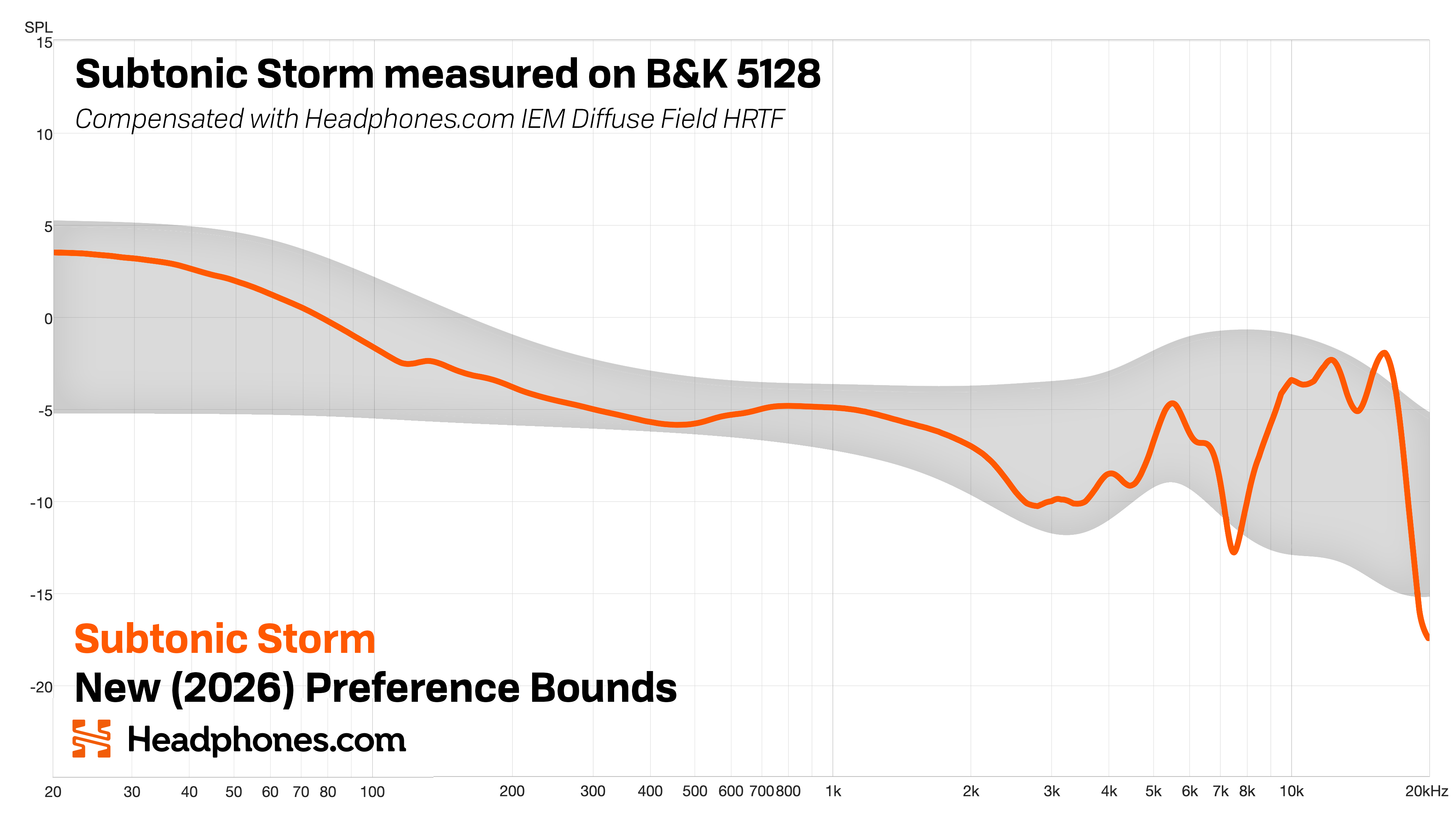

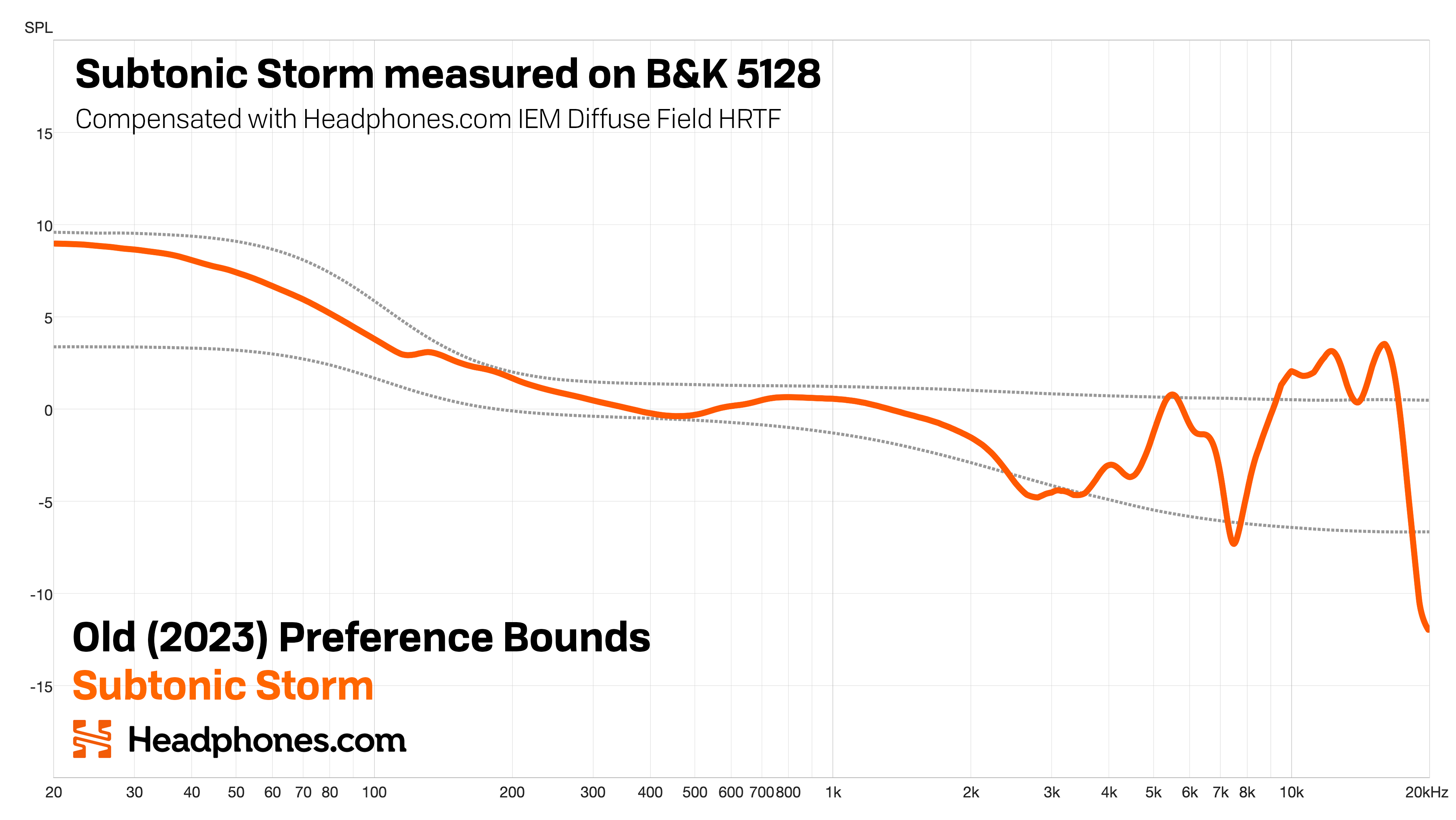

As an example of how these bounds differ from the old ones, let’s take a look at how one of the most well-liked IEMs out there looks against the old bounds vs. the new bounds.
Fig. 23: Subtonic Storm measured on B&K 5128 and compensated using Headphones.com’s IEM Diffuse Field HRTF, displayed along with our 2023 Preference Bounds
Compared to the old bounds, one would feel pretty confident in saying that this IEM, the Subtonic Storm, is likely to be too bright for most people starting around 5 kHz, because it’s right up to the edge of the boundary space there.
Additionally, one might say (based on the measurement alone) that Storm’s 2.7 kHz area may be a little too relaxed for the majority, because it’s actually veering outside the bounds slightly in that region.
However, fewer people actually have these complaints about the Subtonic Storm than this measurement visualization may suggest. Even though some people with darker-than-average HRTFs like myself, or people with long ear canals and HRTFs with a relatively relaxed 3-5 kHz region like Resolve find Storm a bit too intense around 5 kHz, many people really seem to love this IEM.
And when you look at it against the newer Preference Bounds, it’s pretty clear why:
Fig. 24: Subtonic Storm measured on B&K 5128 compensated using Headphones.com’s IEM Diffuse Field HRTF, displayed along with our new BETA Preference Bounds for IEMs
The added range in the lower-bound of the bass frequencies more firmly cements Storm as a “bass boosted” set relative to the range of potential preference in the literature, but this part, as well as the midrange, still look excellent and well within bounds.
But the 2.7 kHz dip is now properly contextualized as something maybe slightly relaxed, but unlikely to be a massive problem to most people, while the 5 kHz region actually looks like it’s almost exactly where a majority of people would want it to be.
While yes, Storm still flirts with the upper end of the Preference Bounds in the upper treble, it also gets near the top of the bounds in the sub-bass, which most people would say is a fairly common approach to balancing colorations when it comes to IEMs (“V-shaped”).
And here is my current favorite IEM (Prisma Lumen) vs. the new Preference Bounds:
Fig. 25: Prisma Lumen measured on B&K 5128 compensated with Headphones.com IEM Diffuse Field and displayed along with our new BETA Preference Bounds for IEMs
We can see that yes, it is still firmly a bass-boosted set, but the midrange and treble compliance is excellent across the board such that what people actually receive when listening is likely to be quite preferable, barring any anatomical variation in the treble (which will still mean that some people who hear Lumen will find it either too shouty, too relaxed, too dark, or too bright).
