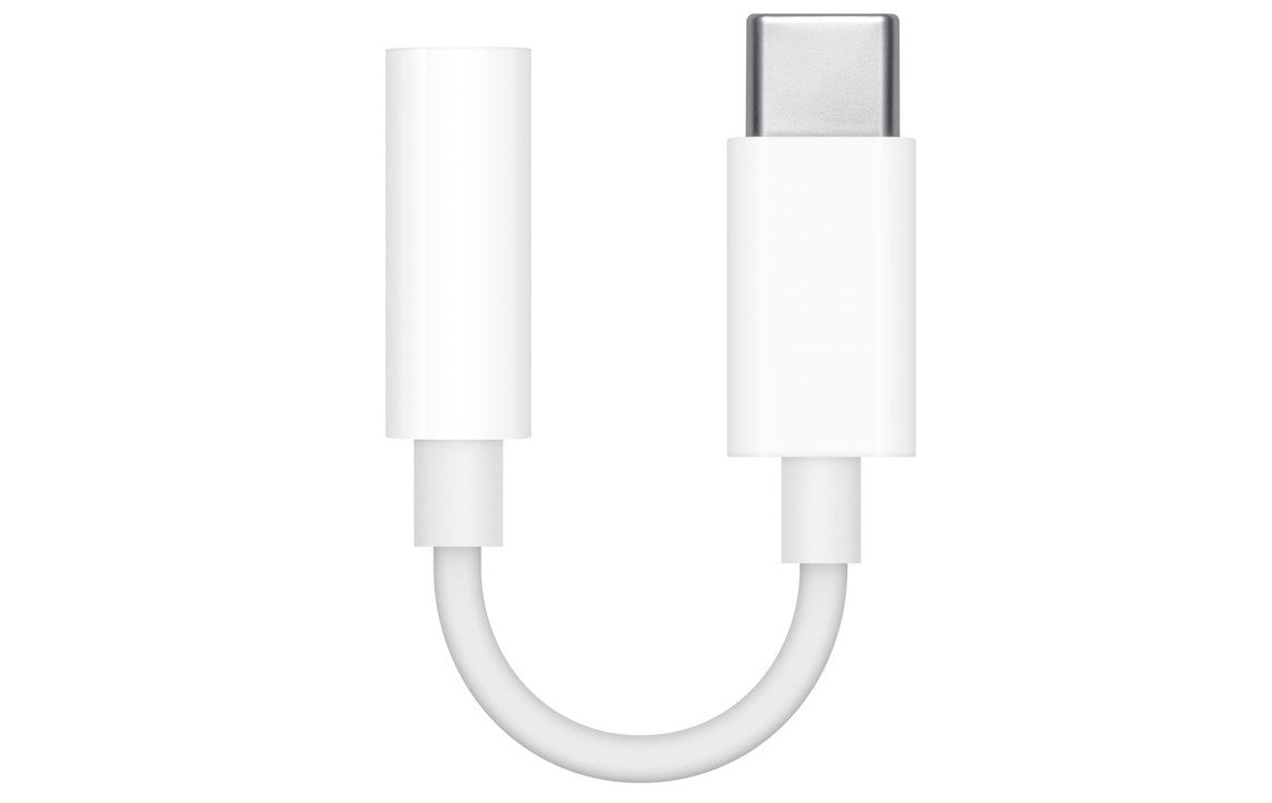

Personally, I’d go the easy route. Luckily, many modern source devices already have a low output impedance. For example, your phone might be around 1 - 10 Ohms. Most dongles and high quality headphone amplifiers are around 1 Ohm. Hence why you might never have come across this problem. Where you might see higher output impedance amplifiers is in professional audio gear such as audio interfaces or more commonly, computer motherboards which tend to average at around 75 Ohms. How low does your output impedance need to be? 1 Ohm or less will be good enough for pretty much anything, but a common rule of thumb is that it needs to be 1/8th of the impedance of your headphone (see Resources section).
Long story short, the cheapest, easiest way to ensure this isn’t a problem is to buy a $10 Apple USB-C dongle, and use that instead of plugging directly into your computer’s motherboard. With an output impedance of around 1 Ohm, you’re pretty much guaranteed to never have to worry about your source changing the frequency response (or tonality) of your headphone or IEM. It also has the nice bonus of having a DAC chip built in, so it’s a convenient all-in-one source device.
The Apple USB-C dongle is one of the best starter DAC/amps you can get.
Note however that this is absolutely NOT to say that the Apple USB-C dongle is the only DAC/amp you need. There are many other considerations to properly powering your gear, so as you upgrade into more demanding headphones, you might need more powerful equipment. But thankfully, the Apple USB-C dongle has been measured to be quite competent and will serve as an excellent baseline for many of the headphones and IEMs you’ll run into.

Note: I give the Apple USB-C dongle as an example because you can walk into any mall and pick it up for $10. But there are other great dongle options under $50 such as the FiiO KA11 or MoonDrop Dawn Pro.

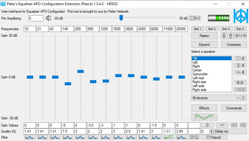

Now, it should be said that you can achieve the coloration effects of high output impedance through the use of EQ software. It takes out all the guesswork as you can surgically apply any tonal changes you want. To some extent, playing around with output impedances to match specific amplifiers with specific headphones or IEMs may be seen as a form of hardware EQ.
Peace Equalizer + Equalizer APO is the most popular method for EQing on Windows.
However, that doesn’t mean using high output impedance is entirely moot. EQ is a bit harder to set-up than simply plugging your audio gear in. It’s also not quite as universal as software isn’t always cross compatible between devices, nor is it free from glitches. Plus, part of the fun of being in this hobby is the audio journey itself - exploring different combinations and trying different things to find what you enjoy. It’s all up to you how you want to experience things.
