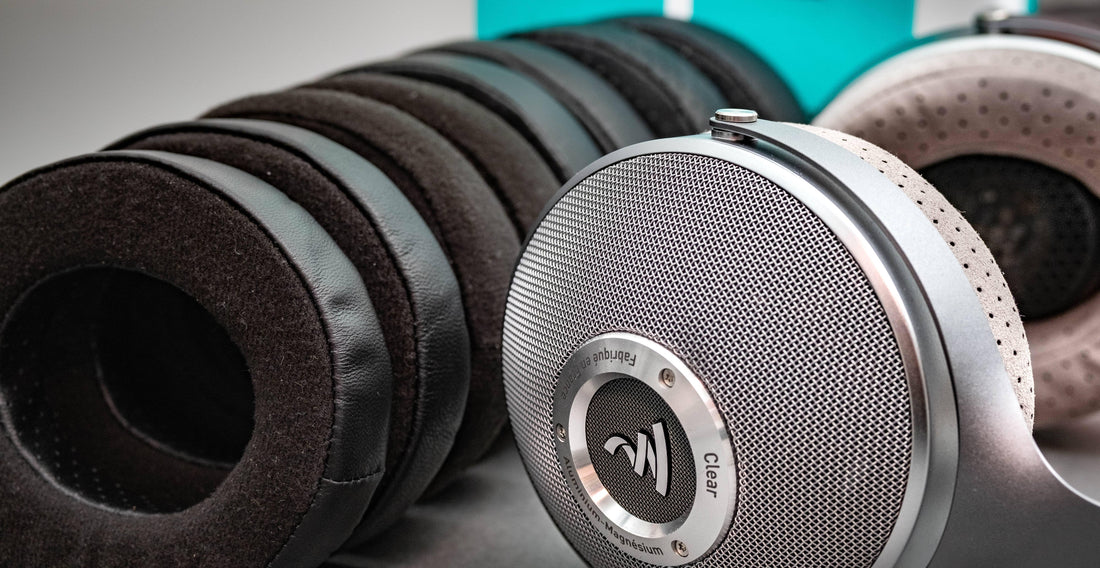

I normally don't recommend pad swapping for most headphones, with the exception of some cases like with ZMF headphones where the manufacturer has specifically developed different pads for different tuning flavors. I generally don't recommend pad swapping because in most cases the replacement pads will impact the frequency response, and this makes the headphone not sound like the engineer intended. But there are also a number of good reasons to do it, especially when the pad manufacturer has paid close attention to the effect of their pads on the headphone's frequency response. Dekoni has produced a number of pads for the open-back Focal headphones, namely the Elear, Clear and Utopia (they would work on the Elex as well). They've produced alternative pads for a number of other headphone brands as well, but for this article, I'll be focusing on the effects of Dekoni's Elite pad series for the Focal Clear specifically.
Let me begin by saying that the Focal Clear already has an excellent tonal balance overall, and in my opinion it's an easy to love headphone without any significant need to swap pads out to change the sound. But with that said, this is just one person's opinion, and you may have a different preference. Leaving comfort aside - because I already find the Clear's default pads to be quite comfortable, there are a number of additional reasons to consider doing this.
Why would you want to pad swap?
The first reason to pad swap on the Focal Clear specifically is if your default pads are damaged or worn out. Pads will generally deteriorate over time with use, and when this happens they should be replaced - however the official pads from Focal, while excellent, are also a bit expensive coming in at around $200. Because of this, it's worth considering what you lose/gain with alternative pads. Additionally, because the Clear's default pads are white, they can get a bit discolored over time and this makes them look a bit faded and not as aesthetically striking as they are out of the box.
The next reason to consider pad swapping is to potentially change the tonal balance, or change the flavor of the sound. Once again, I don't think this is necessary with the Focal Clear since its default tonality is already excellent. But I know there are some out there who prefer more bass, or a more relaxed upper midrange, maybe a warmer sound - and this is where pad rolling can make a difference to line up with those preferences.
Lastly, for those of us who like to get into tweaking things with EQ, pad swapping is still an interesting prospect because it may make the headphone easier to EQ. For the Focal Clear in particular, there's an occasional grittiness for certain elements in the treble, specifically a peak around 6khz and a peak around 8khz. This can cause consonant sounds to come across a bit aggressive at times and on certain recordings (this is such a minor nitpick but in my opinion this is the only weakness to the Focal Clear, it's just not as smooth in the treble as it could be). I personally fall into this last camp, and so for me I'm looking for ways of potentially making the Clear easier to EQ, without having to add narrow dips, and so my adjustments can be more gradual and more conservative.

As I mentioned at the beginning of this article, pad swaps have the potential to completely ruin a headphone's frequency response, and with all of the Dekoni options, this is thankfully not the case. I want to conclude by reminding readers that you do not have to pad swap on the Focal Clear, and it should come as no surprise that the default pads from Focal will likely still sound the best for many people. But for those who want an additional flavor to the sound, or need to replace their default pads, the Dekoni Elite pads are a solid, less expensive choice.
I find that while overall the tonal balance for these pads makes the Clear a bit warmer, a bit more relaxed in the upper mids, in some cases they smooth out some of the grittiness that can occasionally show up in the treble. They're not perfect, and for my purposes, I do still EQ this headphone with the alternate pads, but for anyone wanting to change the tuning or just replace the default pads due to wear or aesthetic damage, you can be confident that for the most part the Dekoni Elite pads sound just fine for the Clear.
