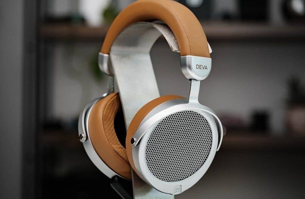

For the most part, the Deva feels well-constructed with solid materials. I think HiFiMAN have taken some of the criticism regarding build quality to heart, since the yoke structure for the Deva is all one piece. This means that there are fewer potential failure points. The one area where I have to still be critical is that the place where the arms connect to the headband feels flimsy as they wobble back and forth. I imagine this is actually intentional though because this also allows for a bit of cup swivel, alleviating one of my only complaints about HiFiMAN's excellent Sundara.
As a result, the HiFiMAN Deva is reasonably comfortable for long periods of time. The headband uses thick and comfortable padding, and while I normally prefer suspension style headbands, the Deva is lightweight enough that there are no issues. Well done HiFiMAN.
