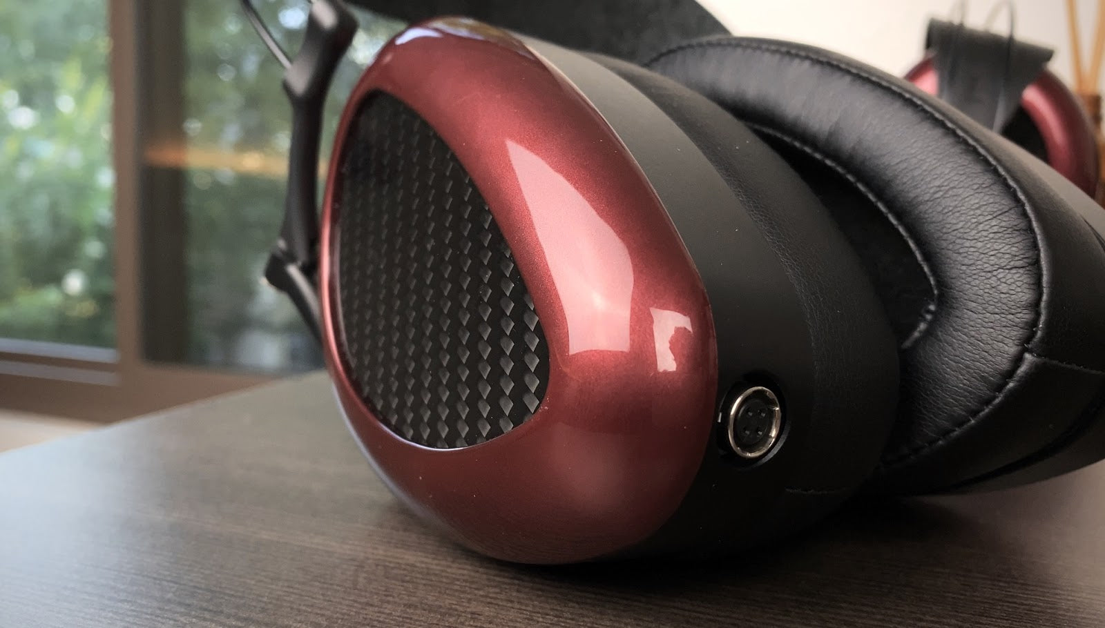

The AEON 2’s build is spectacular; both visually, and its construction. For a planar-magnetic headphone it is remarkably compact, lightweight (327g), and it also features a very good, collapsible, folding mechanism that further reduces its footprint. The earcups use a mix of metal and plastic, which gives them a light but very solid feel. The use of the metal alloy, nitinol, gives the headband a very durable structure all whilst remaining extremely light and flexible. I think the AEON 2 has one of the best builds and designs I have seen on a headphone, and I don’t really have any complaints about it; just very solid overall.
Comfort on the AEON 2 is also outstanding. The pads follow the shape of the ear, and whilst that makes them look a little narrow, I had no issues getting a good fit with them without touching the inner sides of the pads. They are also fairly deep, so I never found that my ears came in contact with the driver. The pads are wrapped in a very nice, protein leather that–in my experience–generated less heat build than I usually get when compared to lambskin pads. The only real issue I had was that the AEON 2 was a little bit on the clampy side, but they were definitely not as vicious as what you get with a Sennheiser HD 600-series headphone.

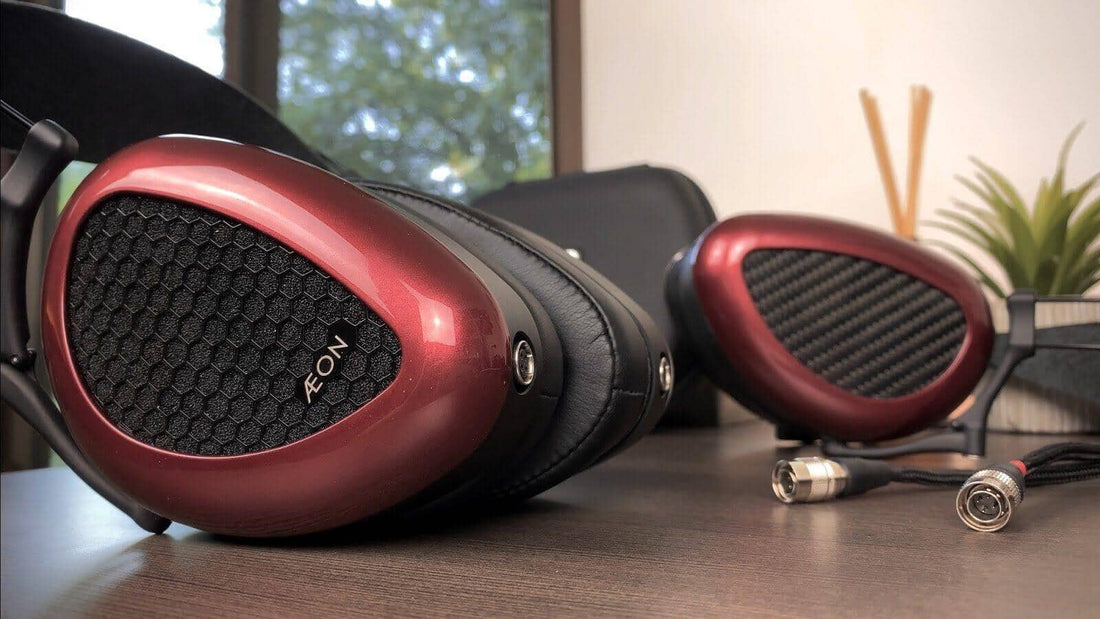

This is my first experience with Dan Clark Audio headphones, so I was not sure what to expect before listening to the AEON 2 Open and Closed. In each of their own, unique ways, the AEON 2’s really surprised me. Both headphones have similar traits, and the only visual differences are that the AEON 2 Closed has a carbon-fibre insert covering the area where the grills would be, and that the AEON 2 Open has partially-perforated ear pads. Yet, despite their similarities, one of these two nearly-identical headphones has me going “woah, I like that,” whilst the other has me thinking “woah, I really don’t like that.”

The AEON 2 Closed, by comparison, still has a touch of added warmth in the bass around 130hz, but it is a lot more subtle and tasteful; which I think makes it pretty enjoyable on some tracks, as it also adds a slight mid-bass punch without feeling like it really upsets any of the other frequencies in the mix. I still feel as though the upper-bass creeps ever so slightly into the lower mids, but–again–is nowhere near the same level as on the AEON 2 Open. This, to me, was actually quite surprising because I expected the AEON 2 Open to have a more balanced bass response, but it was actually the closed-back version that performed better in that regard; and of course it retains the great extension and detail that its open-back counterpart can present. Overall, I think that both the AEON 2 Open (after EQ) and AEON 2 Closed have very good articulation in the lows, but I still found the HiFiMan Ananda, LCD-2 Classic, LCD-2, and LCD-GX to be a little more refined and well-defined in this region of the frequency response.

I think it is strange that, in a way, the AEON 2 Closed feels to me like a refinement in every way when compared with the AEON 2 Open. From my experience listening to both, I was really hard-pressed to find anything that the AEON 2 Open offered over the AEON 2 Closed. They both offer a fairly energetic tonality, with accentuated highs and very present, warm bass; however, the AEON 2 Closed is able to present that sound signature in what I think is a much more tasteful and enjoyable way that does not sound oddly dark and shrill in the way that AEON 2 Open does.
Having said that, there are a few takeaways for me after listening to both of these Dan Clark Audio headphones. The first thing is that, knowing how the Closed-back performs and sounds, there is no scenario in which I would find myself recommending the AEON 2 Open; the AEON 2 Closed overall performs better and I find it to be significantly more enjoyable with or without EQ. The other thing I wanted to mention is that if you are looking for a planar-magnetic headphone in the $700-$1000 range, I truly believe that as long as you are willing to sacrifice some dynamics and soundstage the AEON 2 Closed should be a strong contender in your shortlist amongst headphones like the LCD-2, Ananda, and LCD-GX; as it offers the most unique package among them with great tonal and technical performance delivered in a comfortable, portable, lightweight, closed-back package.
