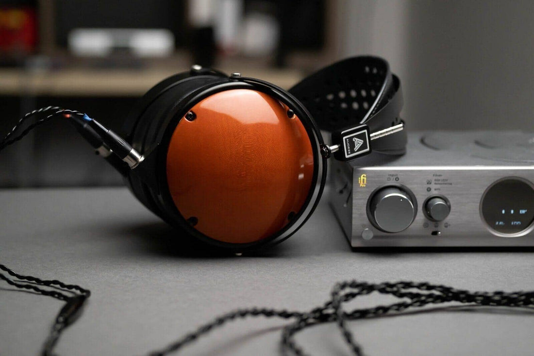

The LCD-XC is a wonderfully well-built headphone, using the same sturdy-feeling design that shows up in the LCD-X with the addition of gorgeous wooden backings to the cups. It should be noted that this unit I’m reviewing uses the maple wood cups, but there are also other backings available, like one from carbon fibre. From what I could tell, however, the maple wood backing is still the lightest at just under 700g. And, unfortunately, this is just too heavy for me.
It’s always my biggest complaint with high end full-sized Audeze headphones - that the weight is just such a dealbreaker, which is a shame because the rest of the comfort for this headphone is actually really good. It has enormous thick pads with a lot of give to them as well as a wide perforated suspension headband that alleviates any issues on top.
So apart from the weight, the LCD-XC is an exceptionally well built and comfortable headphone - prospective buyers should just expect to do some neck exercises to make long-term listening a bit more bearable.
