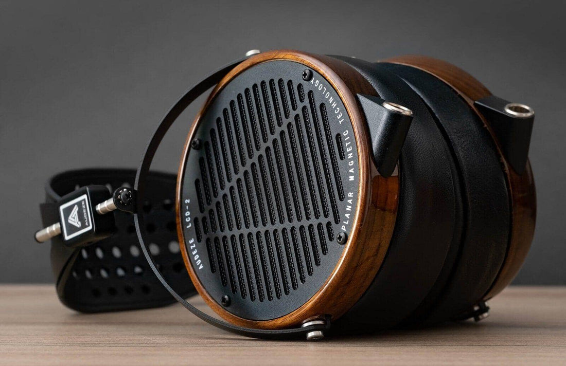

Build, Design & Comfort
I find the Audeze LCD-2 to be one of the best looking headphones period. I’m personally a big fan of design styles that use wood, leather and metal - not unlike the design language of ZMF headphones. Of course, the LCD-2 isn’t quite as boutique as the ZMFs, but at the same time the headphone does use a number of handcrafted components. This particular Audeze LCD-2 uses the Shedua wood, as opposed to the more commonly found bamboo wood.
For comfort, the LCD-2 is a big step up from older versions since modern ones use a redesigned headband with perforations for the strap. It also uses the iconic massive pads that Audeze’s higher end LCD headphones are known for. Unfortunately the LCD-2 is still quite heavy, this one comes in at around 640g with the cable. Still, I was able to get through a full day of wearing it, but my neck wasn’t too happy with me after about 5 or 6 hours.
