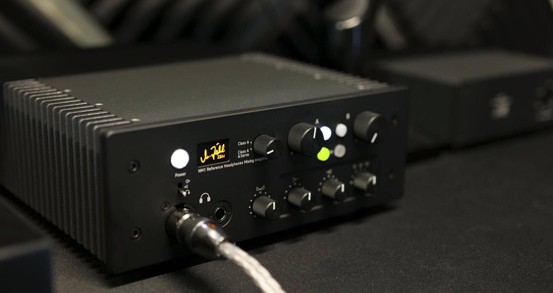

I first heard the Zähl HM1 at Munich High-End earlier this year. At the time I was only able to try it with the DCA Stealth and Abyss Diana TC headphones. But despite the limited selection of gear I was able to audition it with, and the short duration, I knew that this was truly something special, and almost immediately after placed an order for my own unit. At long last, it has finally arrived, and now having spent some proper time listening, testing with a variety of headphones in my own system, I can say that I am beyond impressed.
When you combine a truly impressive featureset, with an absolutely no-compromise design philosophy, as well as the extensive experience of Michael Zähl himself, what you get is quite simply the best sounding headphone amplifier I have come across. However sound quality is not the only aspect that sets the HM1 apart from the rest…..

The HM1 is separated into two units, the main amplifier itself, and a separate box containing the mains AC transformer. This is kept separate as the transformer itself is a significant source of interference when designing products, and as such having them physically separated and distanced from the signal carrying components can demonstrably improve performance.
Note that the separate transformer does not output DC to the amplifier like a typical PSU, but rather low voltage AC, to prevent any potential DC transmission loss. The Transformer can also be switched to a range of input voltages allowing it to be used worldwide.
Oh…and remember how I said ‘no compromise’ earlier? Well the first evidence of this is within the transformer itself. This is not just outputting a single supply to the main amplifier. Zähl wanted to ensure that every single part of the device that could be separated, was separated. There are independent, completely potential-separated windings for the left and right channels, both for the preamp and the headphone amp. As well as another independent winding for logic circuitry and front-panel indicators, so that they do not share power with the main amplifier itself. The rectification, filtering and voltage regulation for each channel is also completely separate, to ensure that sudden power demands from one channel do not impact the potential amount of energy available to the other channel.
The HM1 is a full class A amplifier, with a power rating of 4W RMS at 30 Ohms, though with a listed 7.6W peak at 30 Ohms, and also a burst of up to 18W for short durations/transients. On the vast majority of amplifiers, feedback (or sometimes other methods such as feed-forward) error correction is inherent to the design and cannot be disabled by the user. Feedback is a technique used to enhance the objective performance of an amplifier and almost all products use it to some degree.
However, various products with zero-feedback exist, such as the Enleum AMP-23R and many people subjectively enjoy or even prefer these designs. The HM1 offers the user a choice. It can run pure Class A with no feedback at all, or it can run Class A with feedback enabled, providing excellent objective performance (full measurements coming!).
The HM1 can also can serve as a preamplifier, offering both balanced and unbalanced I/O on the rear with two separate inputs, and a single output. Not only can the two inputs be independently switched on/off via the A/B controls on the front of the unit, but they can also be mixed together, allowing for two sources to be played back and mixed at once.
I personally have found this quite useful as it allows me to have my primary playback chain and DAC input to the ‘A’ input, and a separate DAC connected to my PC going to input ‘B’. This means I’m able to play music bitperfect or at a higher sample rate through software like HQPlayer to my main DAC, whilst still being able to hear windows system sounds, voice chat and other tools via the second input.
Another ‘extra-mile’ design element is hidden within the volume controls themselves. When either volume knob is turned down to minimum, a relay shuts off that input entirely to prevent any noise or residual signal level coming through and keep things absolutely silent. This is done via the use of a linear TKD potentiometer in a logic circuit, attached to the logarithmic TKD potentiometers being used to adjust volume. But Michael Zähl did not just put this linear pot onto the end of the balanced pot, oh no, that wouldn’t be good enough. Instead, the volume pots are modified to separate the left and right channels, and have the linear pot physically in-between them to provide just that little bit of extra channel separation. Cool stuff!
This wasn’t something mentioned anywhere in the product page, just something that Michael told me about directly. So I wonder how many other interesting design aspects such as this might be hidden in the HM1?
On the front of the unit, there are five other knobs besides the volume adjustments, which control various sound adjustment features. I’ll talk about these a little later on, but do want to quickly mention that these can be bypassed entirely (not just disabled) using the ‘direct’ buttons beneath each input selector.
