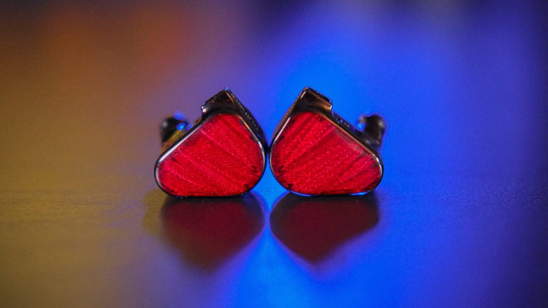

Build Quality / Comfort / Accessories
Those familiar with the original Zero won’t get many surprises here. The box contains the same pleather pouch, 2-pin to 3.5mm cable, and generous complement of ear tips. The anime mascot still makes an appearance on the front of the box, this time wearing red.
The main addition that makes Zero: RED’s unboxing unique is the inclusion of a 10 ohm impedance adapter. This adapter downtilts the tonality of the IEM by reducing the output of the midrange/treble driver relative to the bass driver. I chose to leave this out of my review, because it is a non-stock configuration and I preferred the sound without it. If you want more bass than stock, try the adapter. Frequency response measurements with the impedance adapter are available at my colleague Fc Construct’s review, or on my squig.link.
In terms of build, I have very few qualms here. The shell is made of a lightweight and reasonably solid feeling plastic. The cable is a good mix of flexible and lightweight, but can be somewhat prone to tangling. The faceplate is similar to the original, but with red ribbons instead of indigo swirls.
The biggest drawback in this equation, and possibly the biggest drawback of the Zero: RED overall, is that it shares the same larger-than-average nozzle width its predecessor had. Discomfort while wearing either of the Zeros begins around the 30 minute mark, and after about 3 hours I have to take them out and take a break.
Now admittedly I have smaller ears and don’t have a ton of tips laying around, so just because I haven’t been able to find my ideal fit doesn’t mean other enthusiasts won’t… but I think it’ll be an issue for a good few people, so look out for that.
While there’s not any categorical design improvement here, keeping the accessories mostly the same save for the impedance adapter is a net improvement to a package that was already very good for its price range on release.
