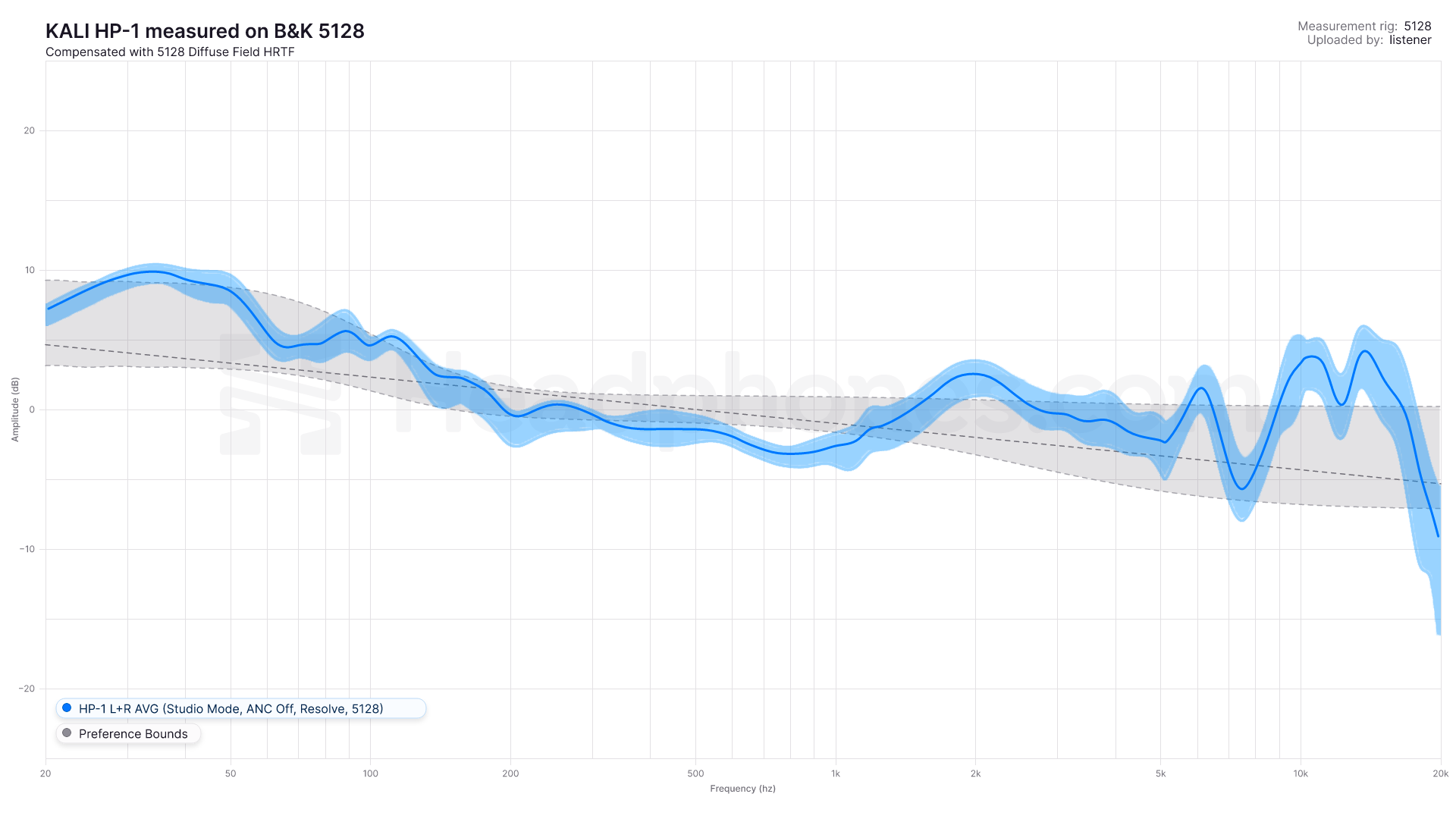

This is supposed to be the “reference” curve—Harman-like—but that’s not how we hear it. We measured on a B&K 5128 and, setting the measurement-rig debate aside, the result is a tonality that’s okay in overall bass–mid–treble balance yet riddled with localized issues: some extra energy in sibilant zones (S/F/T/sh), bass that doesn’t feel quite right, and a thinner-than-ideal midrange. The more we chase specific details, the more the presentation unravels. As a quick listen it passes; as a mixing reference it doesn’t translate confidently to known speakers or better headphones.

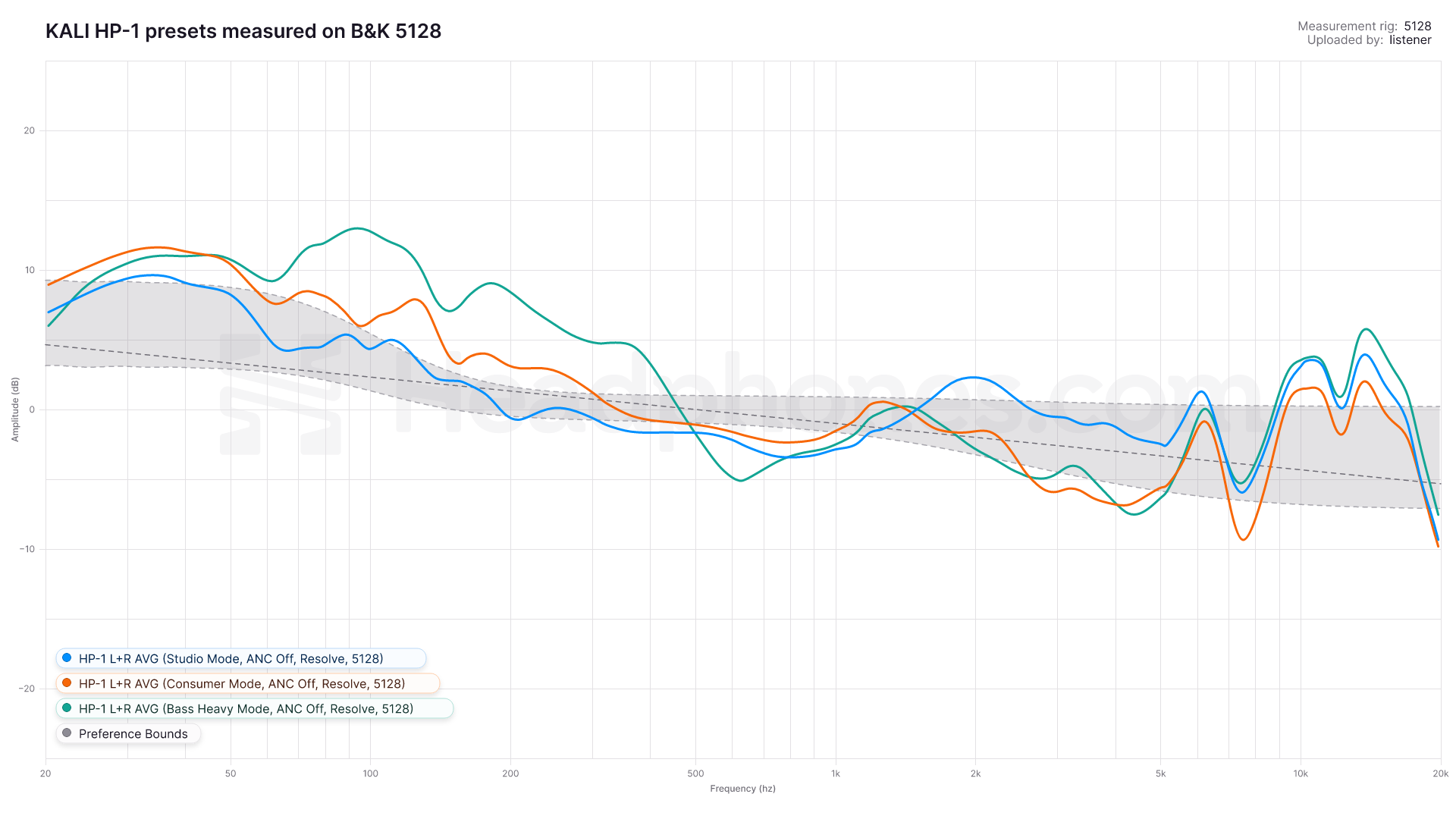

These emulate the kind of V-shape you find on popular consumer cans (think “store demo mode”). If your goal is to sanity-check how a hyped curve might exaggerate bass and sparkle, fine—but they sound rough and incoherent. We don’t recommend mixing to any of these profiles; at best, they’re perspective checks.

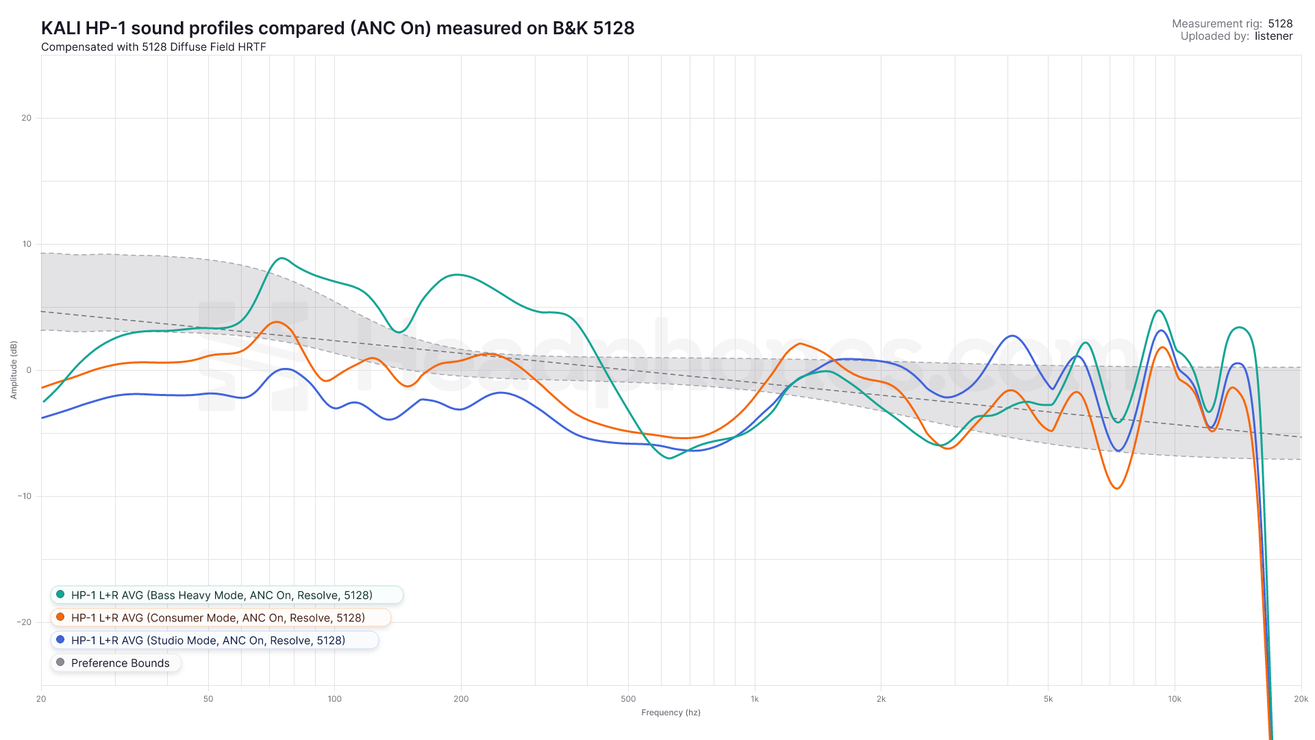

Turn ANC on and the tonality gets completely ruined, basically unlistenable on all modes due to massive attenuation below 1 kHz. If you need noise reduction for a podcast on a plane, maybe—but not for any critical work. Honestly, we’d prefer this headphone had no ANC at all if the trade-off is this level of degradation.

So let's, we should talk about now what the sound actually is. And so, you know, we've obviously measured this on the B &K 5 and 2.8. And actually this is an instance where the measurement rigs really do matter. But let's just talk first about like the default sound profile that you are intended to use this most of the time, which is again, studio mode with ANC off. So what does this sound like? It doesn't actually sound to me the way that Harmon sounds when properly emulated. But again, that's a bit of an open question. We don't need to get into too much of that here. But basically, the intention is for it to be Harmon. Harmon-like in some capacity, but I find that this is it's a bit different. The treble also has a couple of extra stabbies there for me in the in the sibilant range— so the s's, f's, and t's. The sh sound. And I'm not a huge fan of the way that the bass sounds with this either. But this is an instance where it's like, individually, every range is maybe not great for me, but the overall relationship between bass, mids, and treble is okay. At best, I would say it sounds okay.
Andrew Park
Then it's like, it's one of those things where it's like the more I listen for specific things, the more things sort of fall apart for me a little bit in that mode. I also think this is a bit of an issue to do with Harmon generally. When you're trying to essentially match a highly smooth target like that, you know, the reality is, is that these things are going to have various different resonances across different heads and ears. And I'm definitely getting some. So that's not great.
Griffin Silver
Yeah, I think it's the kind of signature where, at a glance, it's probably fine for a person—like, they'll hear you know prominent bass, clarity in the mids, and then you know maybe some wispiness in the treble. But I find a lot of listeners aren't really too bothered by that on a first listen. But I do think, if it's the kind of thing that's meant to be used as a tool, you're going to start noticing these issues pretty quickly once you start, say, comparing it to music you know really well or even your own music. Or when you're trying to use it as a tool and make decisions, and then those decisions have to translate to a reference speaker system, for example, you're probably not going to get very good translation with it, unfortunately. I'm not sure it actually does all that great of a job of emulating a likely speaker sound scenario or is something that is going to be consistent on a lot of the other headphones out there.
Andrew Park
It's probably closest to like a weirdly implemented 2.1 system.
Griffin Silver
Yeah, it's kind of got that incoherence and that really thin mid-range. It's not what I would say is what should be aimed for as the reference, at least this version of this sound. Like I think Harmon is a fine target, but I don't really think this sounds like what I associate with the sound of the Harmon target necessarily.

And this is the best version of the sound that you get for this because the other modes are, again, as a tool to emulate what maybe most people are going to be listening to. If you think most headphones, consumer headphones are pretty bad, yeah, they did nail that, I guess. But it's not one that you would ever want to listen to, right? So I think it's like you have to think of it as that sort of like secondary reference tool, right? Where you're swapping between the modes. The one that sounds like it's supposed to be normal and then the one that's like... This is with all the consumer flair and store demo mode at work. There's tons of bass in the weirdest of places.
Griffin Silver
And I think that's what they're going for. I think they understand that. Certain mix engineers will have an AirPods Max on their mixing desk for when they need to reference it against something you know everyone has heard or something like that and they wanted to make that just attainable on this single headset but yeah, the actual sound is still pretty bad. And I feel like, I think we both have issues with the practice of doing that in the first place, because it kind of creates its own little circle of confusion between, you know, three, between three bad sounding presets. Are you really supposed to trust any of them?

The sound quality also goes to hell when you turn on the ANC mode. So I feel like, as much as this is an ANC headset or headphone technically, it would have been better if they had not put the ANC in yeah and just focused strictly on the pro application— the studio use case. The reference side of it. Because I think that is really cool.
