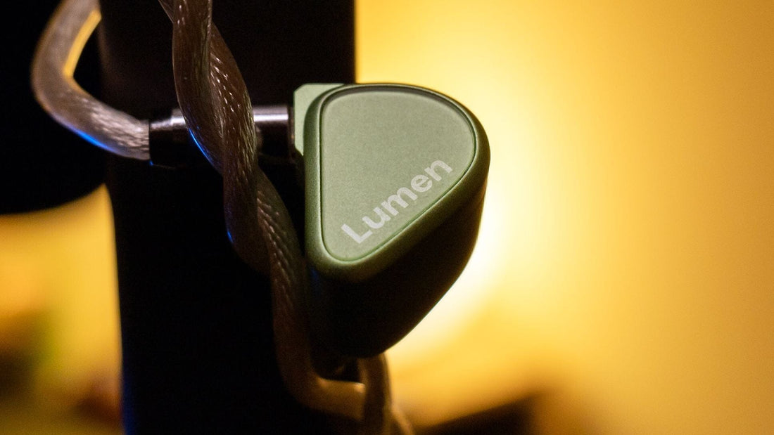

Right out of the gate, Lumen is the best looking audiophile IEM I’ve ever seen. Pale green and with gentle curves, the simple aluminum shell and smoky glass faceplate with near-imperceptible branding is an ideal remedy to the constant flood of sparkly rainbow vomit, gold-plating, ugly logos, and BOLD TEXT branding you’ll find on most other IEMs.
Visually, Lumen earns the highest praise I could give, which is that it looks like an Apple product—minimalist, with every contour screaming consideration for the fact that people are going to be seen wearing it. It’s one of the few IEMs I would not be embarrassed to be seen wearing in public.
Note for the readers, I was very meticulous with my photo-taking; Lumen’s faceplate text will not always be as clear as shown in this review. This picture is a more realistic representation of what it will look like at a random angle.

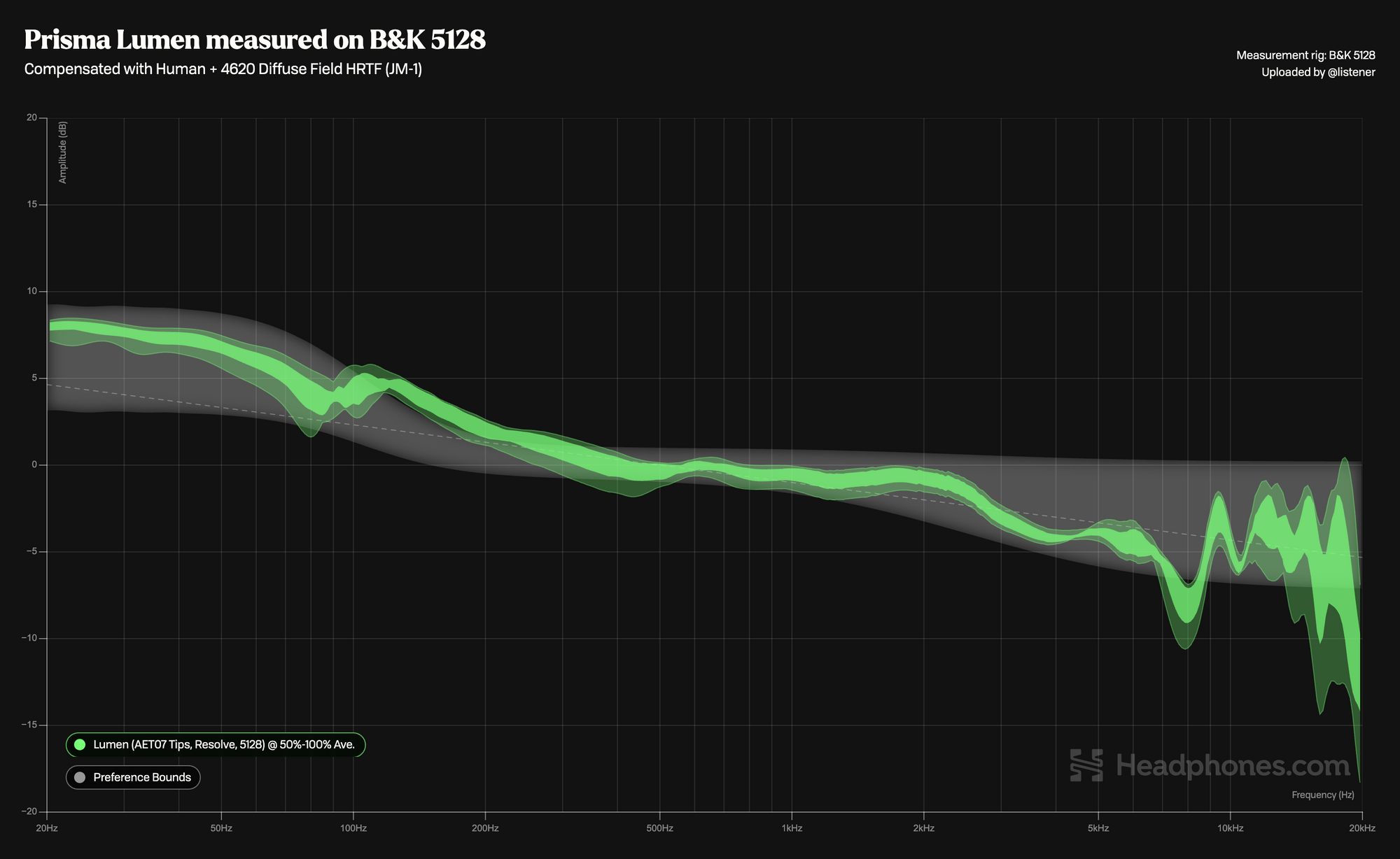

These measurements are taken the Bruel & Kjaer Type 5128-B, at multiple insert depths to reflect the effects of differing effective canal lengths.
Prisma is among the few brands taking targets based on “JM-1 Diffuse Field + preference tilt” seriously from top-to-bottom, and it absolutely shows in the measured performance here. This is easily the most “linear” IEM I’ve ever evaluated. That said, measurements on test fixtures aren’t everything; there are a few places where my perception and the measurement disagrees, so be aware, it does not and will not sound exactly how it measures above for everyone.
Touching on my minor qualms first, Lumen has a slight bass boost above what I’d call strictly neutral, but unlike most sets that sport a similar midrange tuning, it actually seems to understand the meaning of the word “balance.” No massive sub-bass or overblown mid-bass here, just a mild elevation that slightly highlights the fundamentals of bass guitars, and the size & decay of kick drums.
Even though it’s a touch warm for me, it’s among the best IEMs I’ve tested in terms of balancing bass quantity and quality. When testing my bass “disqualifier” tracks, I was shocked that it was the first time in recent memory when an IEM wasn’t absolutely swamping me with kick drum decay or bounciness, or mucking up the presentation with overly-plump bass guitar.

Now to the treble, where my issues almost always get to “dealbreaker” status with IEMs, causing me to put them down and never touch them again once I’ve finished writing the review.
Again. Best I’ve heard. And this time it’s not like the midrange where there’s a lot of close competition from less expensive options. Lumen is head-and-shoulders above the few other IEMs I would say have treble I actually enjoy (one of which I had to help tune myself). It is the most versatile, smooth, accurate treble I’ve encountered.
That said, it’s not quite perfect. It’s very close, but Prisma still has physics as its opponent, and not even those with limitlessly-deep pockets can overcome physics.
Because any IEM is functionally a speaker playing into a tube terminated with a membrane at the other end, it has peaks that arise based on standing waves corresponding to the length between the ear tip and the eardrum. As such, with Lumen I still get a slight length-based peak around 7.5 kHz. This peak is rather well-managed—nothing like on the Truthear Pure or Hexa where it adds considerable glare—but it is still technically there, and reducing it slightly with EQ does improve the sound a bit.
One note for readers is that if their ear canals are longer, this peak will shift down in frequency, and may leave in its place a bit of a dip. Some “longer canal’d” listeners did seem to find it too dark in the mid-treble for this reason, but I have no such issue.
That all being said, I cannot stress enough how small of a problem this peak has actually been when actually listening to music; I have had no desire to engage EQ to attenuate this peak.
Furthermore, the issues I usually have in the upper treble with IEMs are non-existent. Lumen hasn’t even a trace of the excessive glassiness on cymbals, grittiness on snare drums, wispiness on vocals, plastickiness on acoustic guitars, or papery creak on strings that I’ve come to expect with IEMs. I’ve not experienced even one iota of sibilance, harshness, or grain when listening to Lumen. Even if with some recordings I get a bit of chalkiness because the mix has a peak in the spot around 7.5 kHz, it’s still well within the bounds of manageability.
As someone who’s been begging for an IEM that stops capitulating to the trend of insane upper treble boosts, I’m extremely glad the first IEM I can say really, really works for me up there also has an exceptional midrange and bass balance. Because that means for all of what people call “technicalities,” Lumen is also fantastic, being well-balanced between all aspects with what I hear as minimal compromise.
