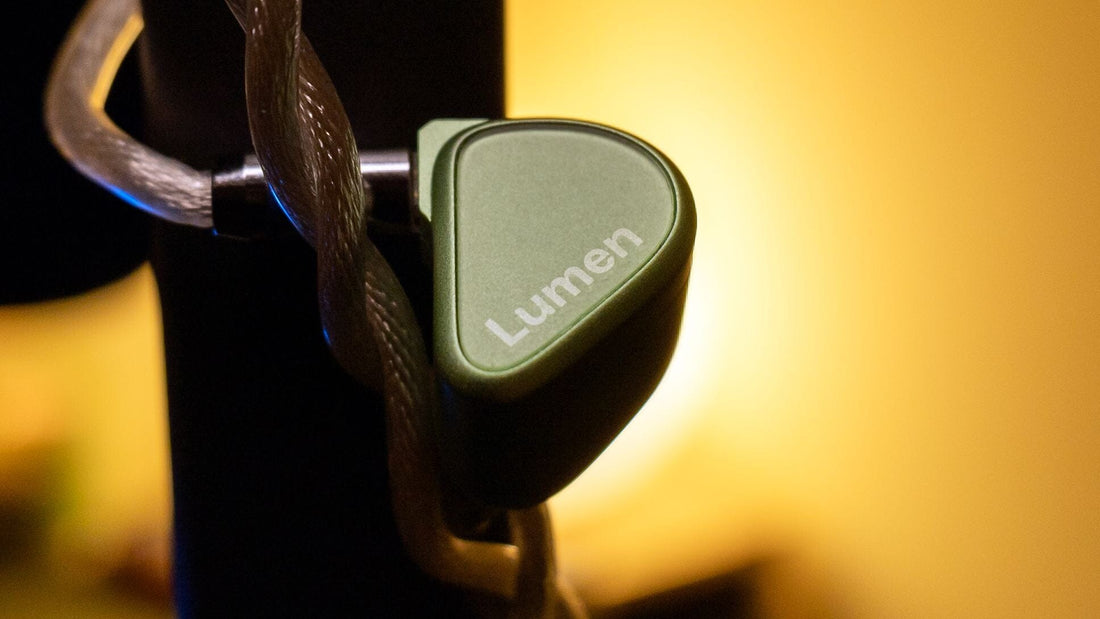

Build, Comfort, Design, and Accessories
Right out of the gate, Lumen is the best looking audiophile IEM I’ve ever seen. Pale green and with gentle curves, the simple aluminum shell and smoky glass faceplate with near-imperceptible branding is an ideal remedy to the constant flood of sparkly rainbow vomit, gold-plating, ugly logos, and BOLD TEXT branding you’ll find on most other IEMs.
Visually, Lumen earns the highest praise I could give, which is that it looks like an Apple product—minimalist, with every contour screaming consideration for the fact that people are going to be seen wearing it. It’s one of the few IEMs I would not be embarrassed to be seen wearing in public.
Note for the readers, I was very meticulous with my photo-taking; Lumen’s faceplate text will not always be as clear as shown in this review. This picture is a more realistic representation of what it will look like at a random angle.
Lumen is also one of the few products in this price range that looks and feels its price. Every facet of the construction looks and feels intentional; the shells are robust while not being overly heavy or bulky, and even aspects as simple as the flush-ness of the nozzle with the surrounding shell, the seamlessness of the shell and faceplate, and the placement of the venting all seem optimized to be minimally intrusive.

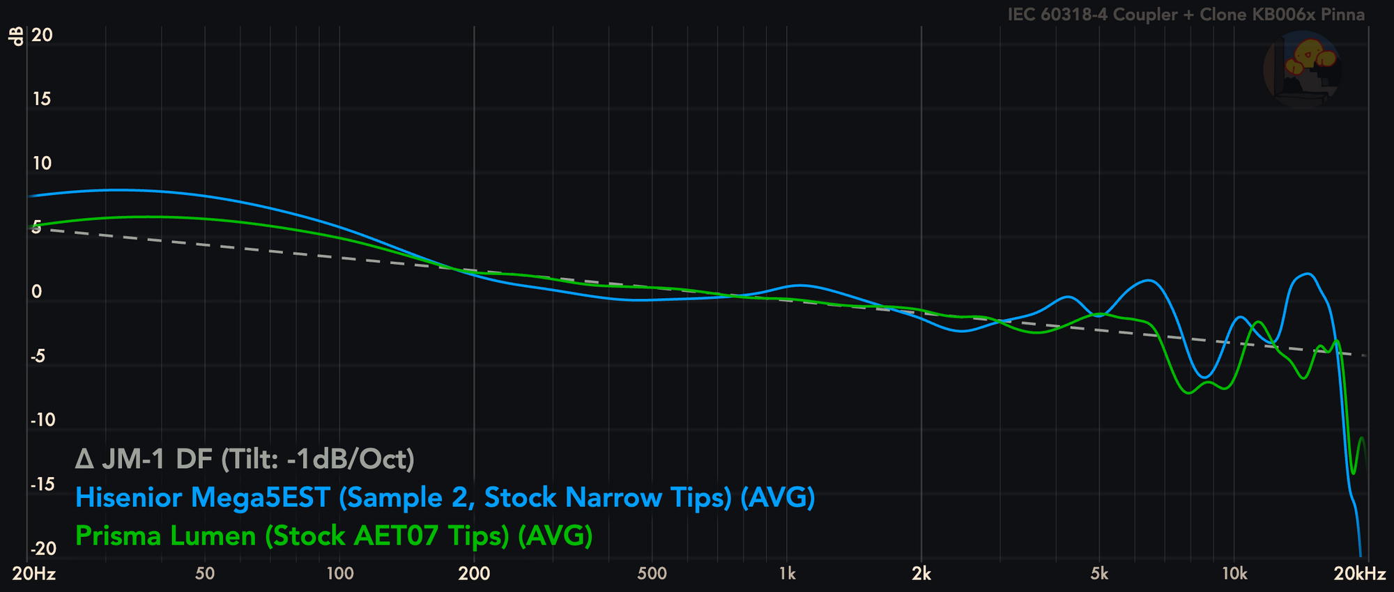

vs. Hisenior Mega5EST
Arguably the IEM that started the whole “New Meta” wave in earnest, and it’s an IEM I still have fondness for… but Lumen basically represents exactly what I would’ve changed about this IEM given the opportunity.
The shell is smaller, a cuter color, made of metal, free of any obtrusive branding (FEBOS!!!), and overall more in line with what feels like a premium product to me.
The sound fixes every issue I had with Mega5EST: the bass is better controlled and less lumpy sounding, the midrange is both sweeter and more accurate sounding, and the treble is free of the whispery sizzle that bothered me most about Mega5EST.
Lumen also hits harder, with better precision and detailing in the midrange and treble, and images much more cleanly as well. The only real loss Lumen takes in this fight is that Mega5EST has a bit more of a detached spaciousness thing going on, but I will gladly trade away the sleepy, distant presentation of the Mega5EST for the more immediate, punchy presentation of Lumen.
While Mega5EST represented a fantastic IEM at the time of its release (and it’s still solid), Lumen represents the true, honest-to-god evolution of that approach to tuning, fixing basically every issue while improving on the ergonomics and design massively. If you want a Mega5EST upgrade but with an even more normal tune… here it is. If you want something more similar to Mega5EST’s overall tune but still more refined, Lux is there for that type of listener too.
