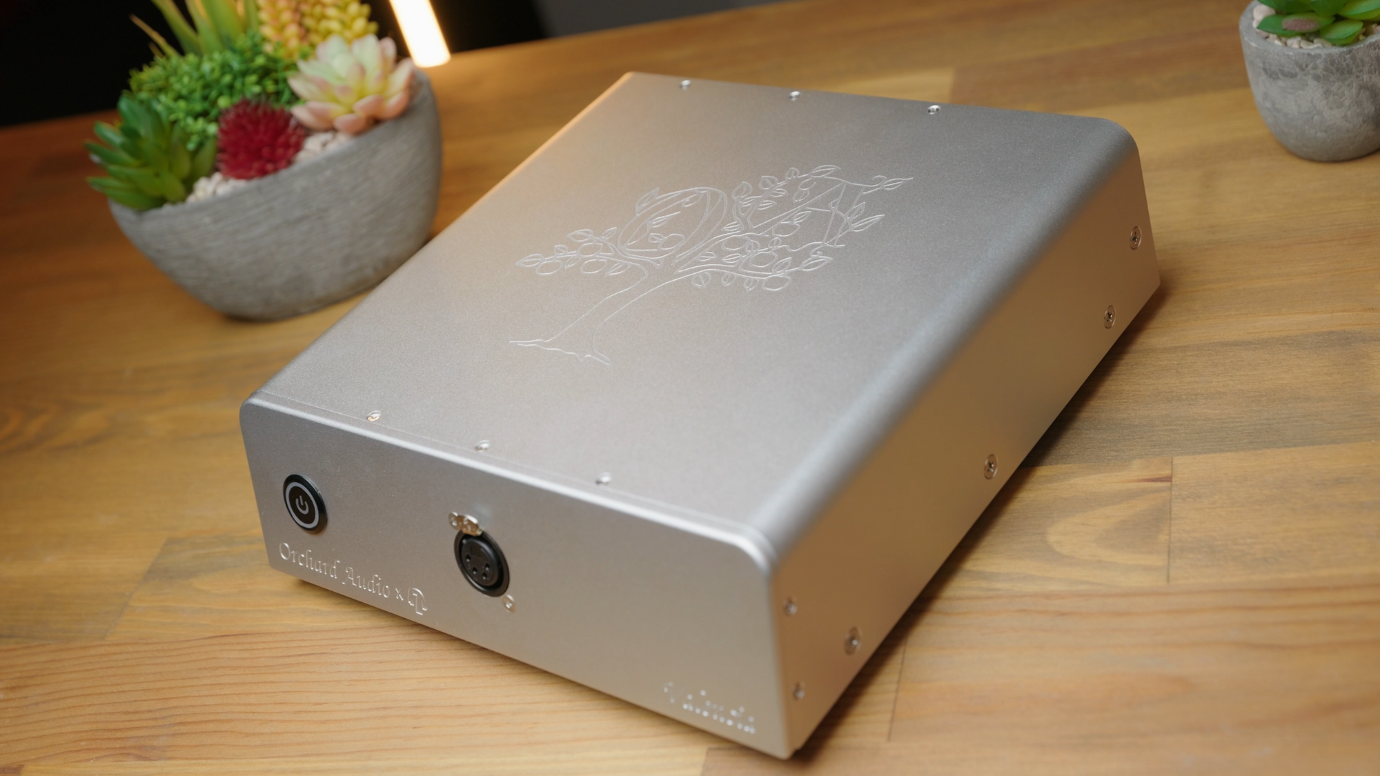

The Valencia’s external build offers a clean matte finish chassis with Orchard’s signature angled front-plate. The chassis isn’t quite as solid as some alternatives such as the Austrian Audio Full-Score-One or Holo Bliss, but is about on par with some similarly priced or even more expensive competitors such as both the Ferrum OOR and Chord Alto.
Engravings of the orchard audio logo on the top and the labeling on the front are a tasteful touch, and I have to say I am quite a fan of the angled aesthetic that Orchard is known for.

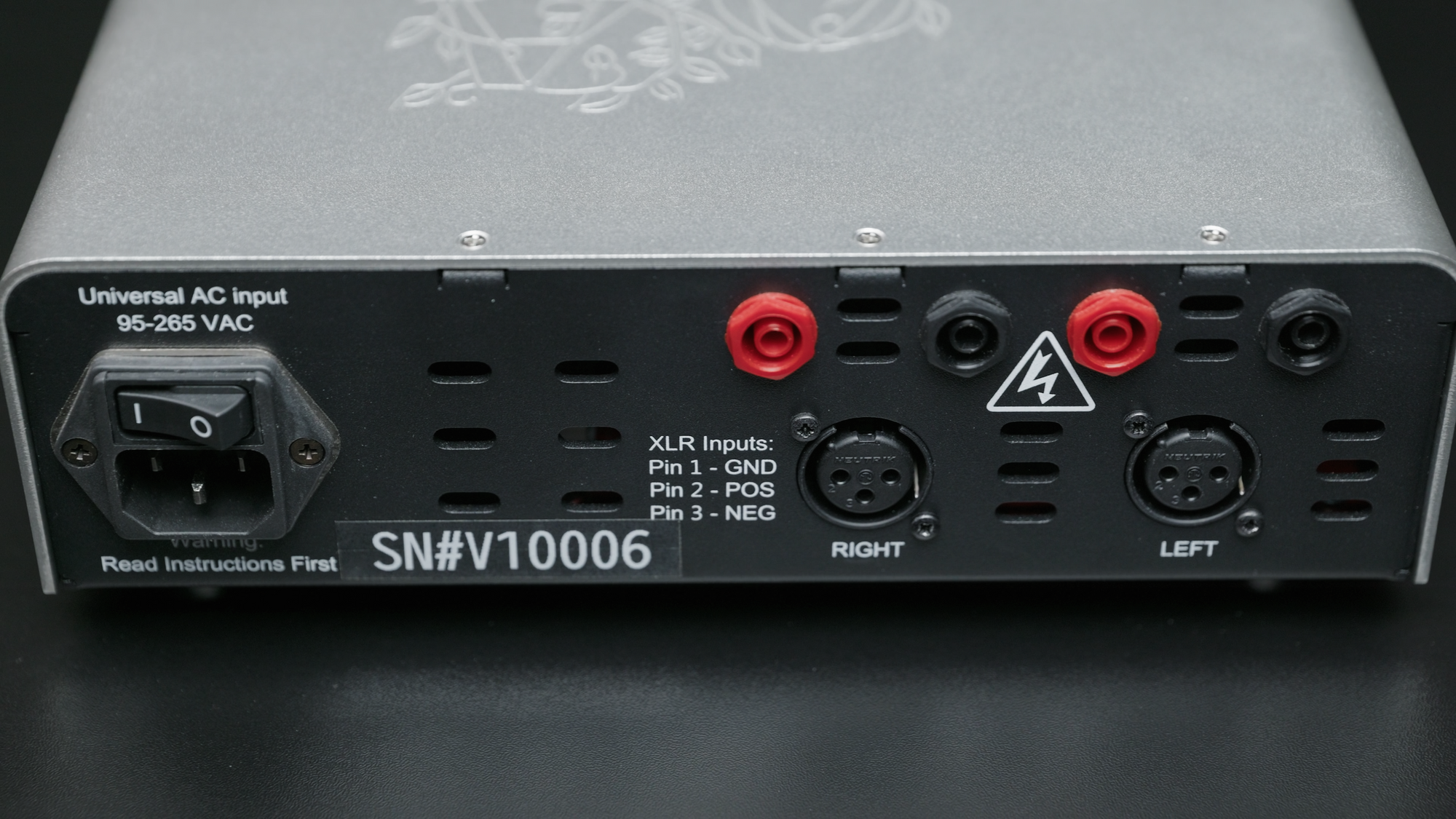

The rear of the unit offers the expected IEC inlet for the internal power supply, balanced XLR inputs, no RCA unfortunately though it is safe to passively adapt an RCA output to an XLR input if needed, and a set of speaker outputs as well. The Valencia can not only drive headphones but can also be but to use driving more sensitive speakers with its 8W @ 8 Ohm power capability. This could be quite a nice addition for those wanting to run this unit at their desk and drive both their headphones and passive bookshelves, although it would have been nice to provide the ability to select or switch between the two outputs, as currently playing to the headphones without playing to the speakers requires physically disconnecting the speakers. This makes it a bit less convenient for true dual use, though is still a nice feature to include.

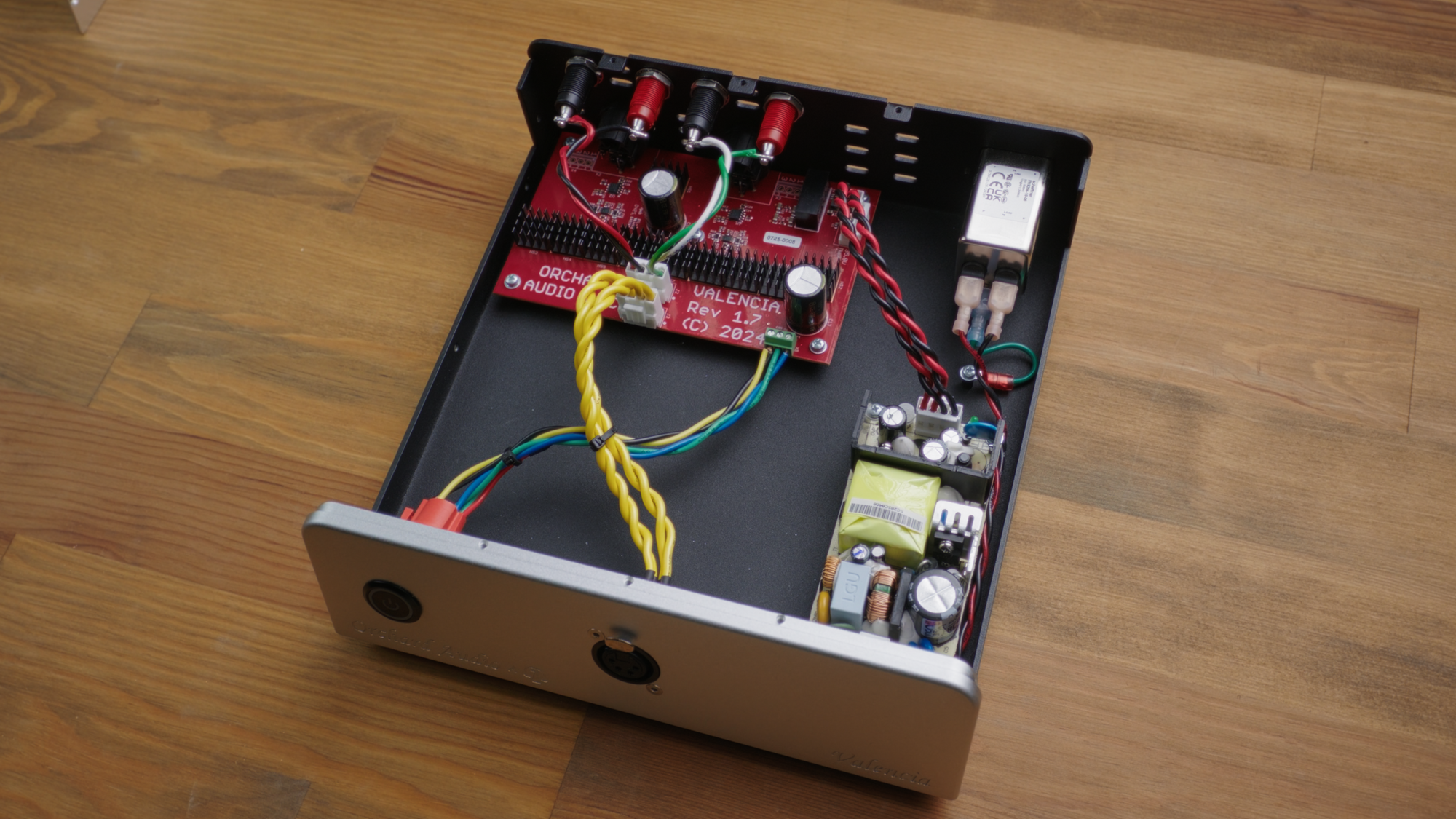

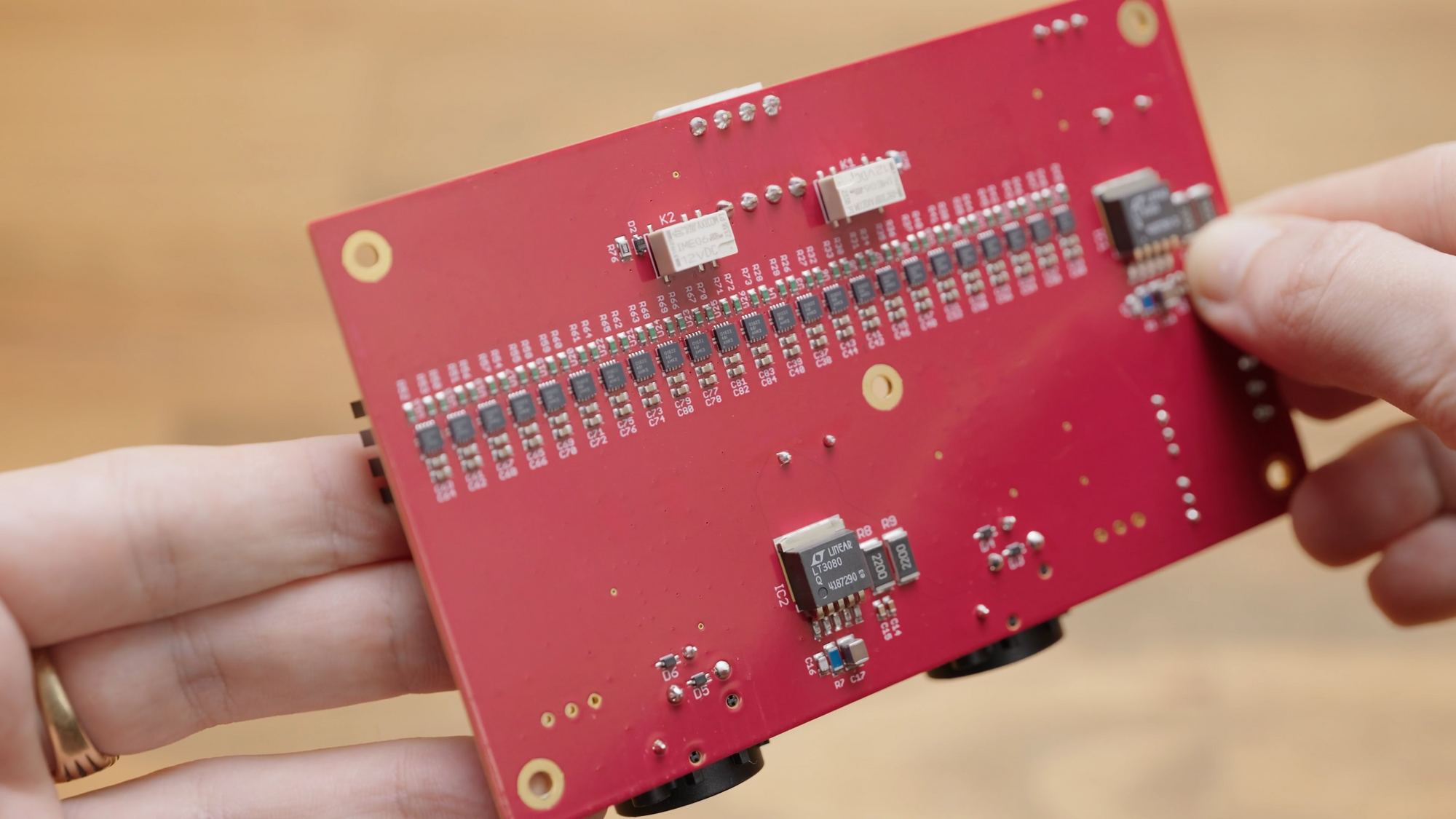

The internal is where things get a little interesting. There isn’t really any other way to describe it besides a little bit empty, and perhaps disappointing given the $2000 MSRP of this amplifier.
Some of that is simply due to the fact that many of the parts found in most amplifiers just aren’t needed here. No need for gain switching, no need for volume control, all that’s needed is the main fixed gain amplifier itself and the power supply.
There are also some deceptively expensive components, such as the 24 OPA1622 opamps hidden underneath the red mainboard.
But nonetheless, this is a very expensive amplifier considering what’s inside the box, and as such it better measure up to its competitors at those higher prices. So let’s have a look!

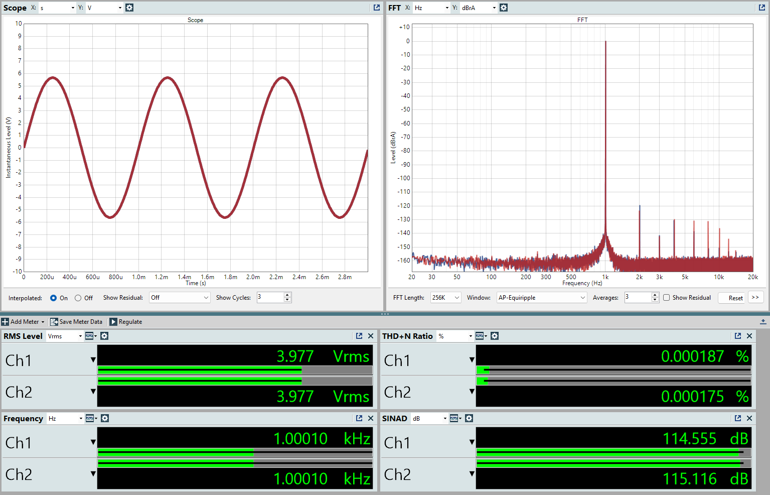

THD+N / SINAD
1khz Sine, 4V output (300Ω Load):
The Valencia has extremely low distortion and noise, yielding an impressive ~117dB SINAD figure at 1khz.
1khz Sine, 4V output (32Ω Load):
Switching to a more difficult 32 Ohm Load, distortion increases marginally as is common, though keeps to a rather ideal 2nd order dominated profile.

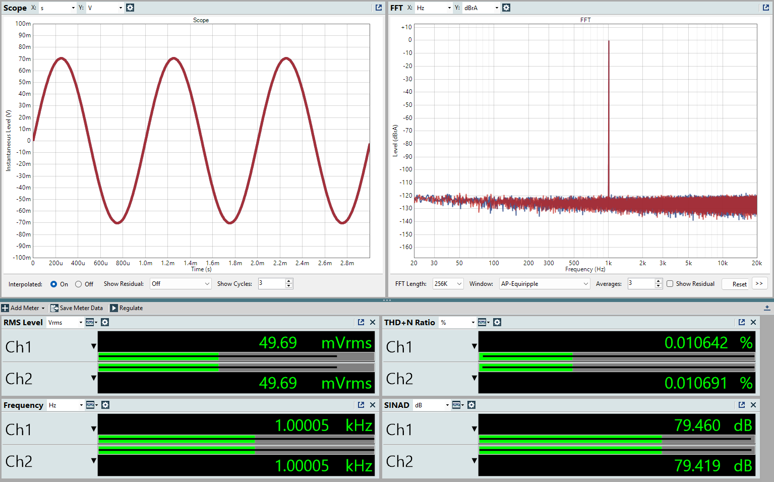

1khz Sine, 4V input, 50mV output (IEM Level, 12Ω Load):
The Valencia can also quite comfortably be used to run IEMs thanks to the low noise floor. There are better options available if you are primarily an IEM user, but there’s certainly little need to switch away from it if you did want to run them now and then. The primary concern when running IEMs is likely to be a limit of your volume control, not the Valencia itself, since with a 4V DAC feeding the Valencia, getting to 50mV requires over 50dB of volume attenuation. It is therefore very likely that in most instances you will be limited by the noise output of your DAC or preamp rather than the Valencia.

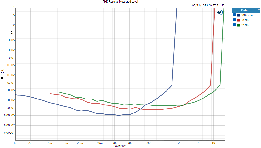

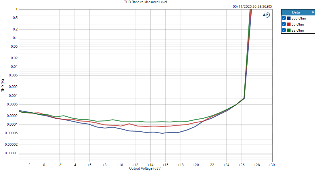

Power
THD vs Output Level in Watts
THD vs Output Level in dBv, 0dBv=1V
The Valencia delivers up to 17W into 32 Ohm, and a little over 20Vrms into high impedance 300 Ohm loads. 17W is certainly an enormous amount and means you’ll have absolutely no trouble driving demanding planars or ribbon headphones without any concern of pushing the amplifier even close to its limits. But it is worth noting that for high impedance yet demanding headphones like the Modhouse Tungsten, where voltage output is your limit, 20Vrms out is standard for a large portion of amps on the market, and so the additional power capability at low impedances is not going to be of any benefit here.

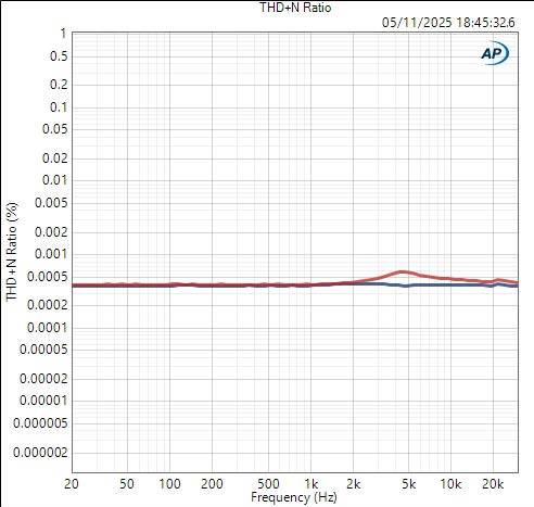

THD+N vs Frequency (96khz capture bandwidth)
(96khz bandwidth used on the analyzer. Don’t compare this directly to standalone audible band THD+N measurements as the measurement setup is not the same.)
One channel shows a slight increase in distortion around 5khz that is not present in the other, though very minor, and otherwise distortion vs frequency is extremely consistent.

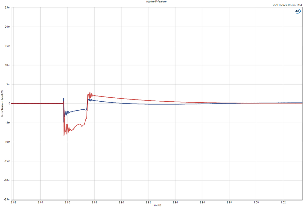

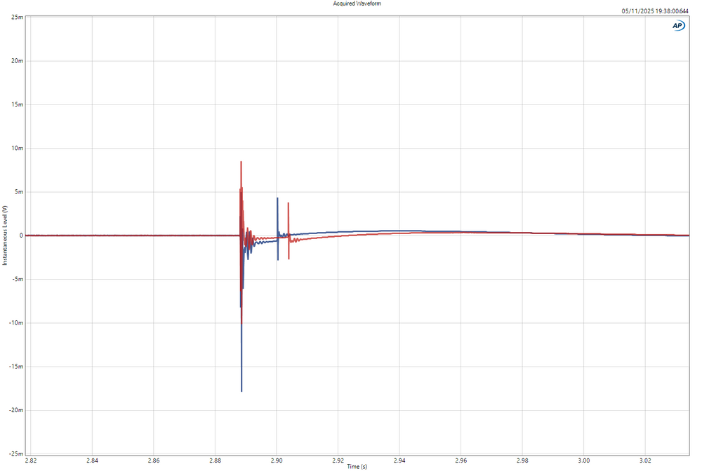

Power On/Off Behaviour
This test shows the output of the device when turned on/off, to check whether the output may put connected headphones at risk. Regardless of what this test may show, please ALWAYS disconnect your headphones when turning any amplifier on/off unless the manufacturer explicitly instructs you to do otherwise.
Turning on (from cold, 300Ω load):
Turning off (from warm, 300Ω load):
Activity when turning on or off does produce a spike of up to about 18mV, which is nothing of concern in most instances, however if running very sensitive headphones it is probably best to disconnect the headphones from the amp prior to powering it on or off.

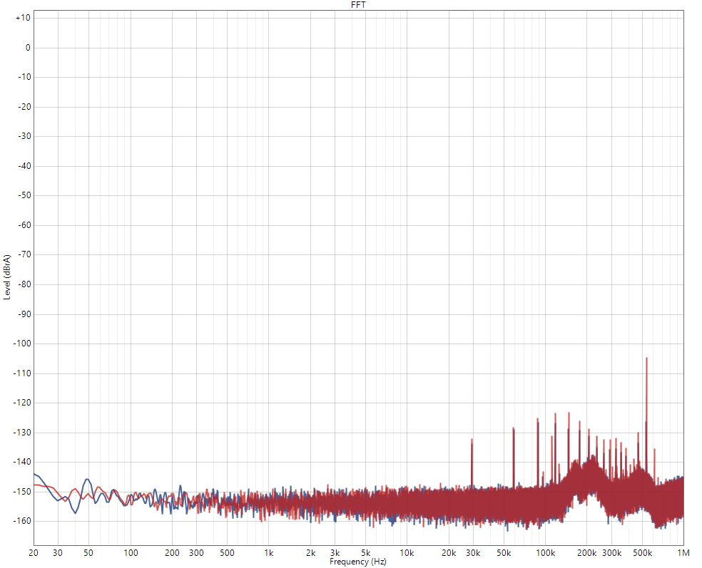

Noise (1M FFT, 3 Averages)
Balanced output
Noise is overall extremely low. Some switching noise remains likely from the SMPS power supply, and this would have been nice to see some additional filtering to remove. But very low overall and likely of little concern.

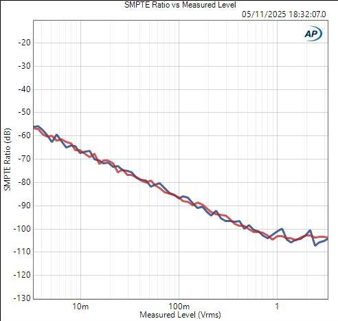

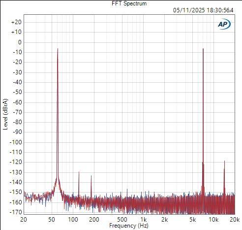

IMD
IMD is comfortably low.

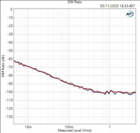

Dynamic IMD (DIM)
Dynamic intermodulation distortion also remains low and fairly consistent.

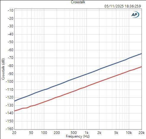

Crosstalk
Crosstalk performance is moderate, though does get a little high at higher frequencies. One channel seems to pick up slightly more than the other as well.

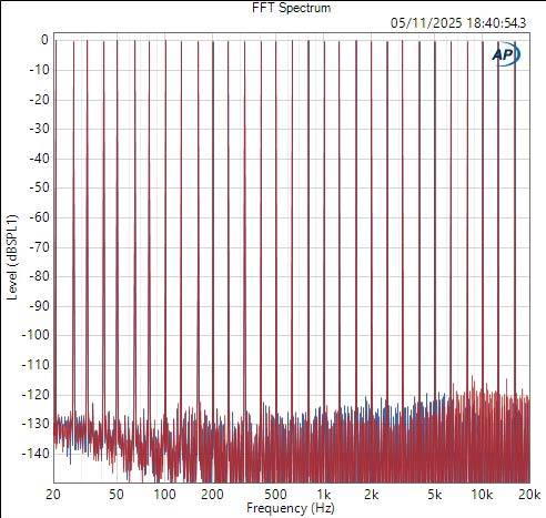

Multitone
Here we can see a repeat of that slight 5khz distortion increase, but with around 115dB of distortion free range, again it’s very likely your preamp or DAC will be the limiting factor in this setup.

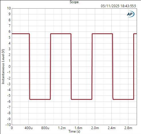

Square Wave Output
High bandwidth and DC coupling yields a clean square wave output.
